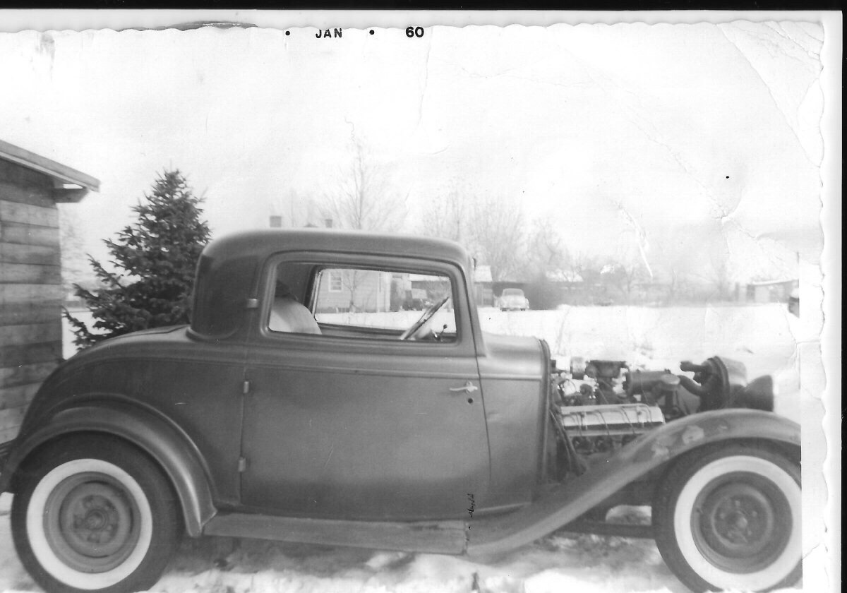

    You have the ultimate hot rod time capsule with the advantage of having your Dad to fill in all the details. My vote is for exactly as the 1960 pictures and go with an early Olds engines. I wish I had some of the old hot rods my Dad had built in his younger days. They weren't brand loyal back then, the biggest, baddest engine in whatever was the cheapest and lightest vehicle you could find. You are truly blessed to not only have your Dad, but, his old hot rod as well!!!! I'm subscribed and wish you and your Dad the best.

    I'm with the "Buy a running Olds, throw it in there and have fun" camp. Those pictures from your dad are awesome. I wouldn't change a thing.

    I believe I’d go with a 1000-1500 dollar Olds engine too. But the Pontiac is also good.
    Now if those bumpers in the above post is on your dads car, do not. And I mean do not change them.
    They are cool as hell.
    Sure you’ll find all kinds of cool do dads on other 32’s.
    Nothing and I mean nothing is as cool as the stuff hanging off your car. It is a literal time capsule that everyone else is trying to emulate.

    A: this pic is awesome!
    B: it reminds me of @Roadsir ‘s “Just Steve” 3w
    Although his it not channeled you could be doing this before you know it. So keep on chugging.

    Another vote to "restore" the car to it's 1960 greatness! If you start changing up character stuff like the bumpers, add disc brakes, etc., it'll start to look like all the 32 3/w's on the road. If you go a step or two further and drop a SBC in it, people will ***ume it's another all new (Brookville) build, plus we'll tar & feather you!
    The car, pictures absolutely rule. Get a decent runner engine, then look for a rebuildable core. Do all the work yourself (minus any machine work). These 5 figure engine build prices are ridiculous.
    The garage rules too. Dorman hardware drawers to the ceiling. I'd never come out of there.

  18. How could you not put it back just like those pictures???
