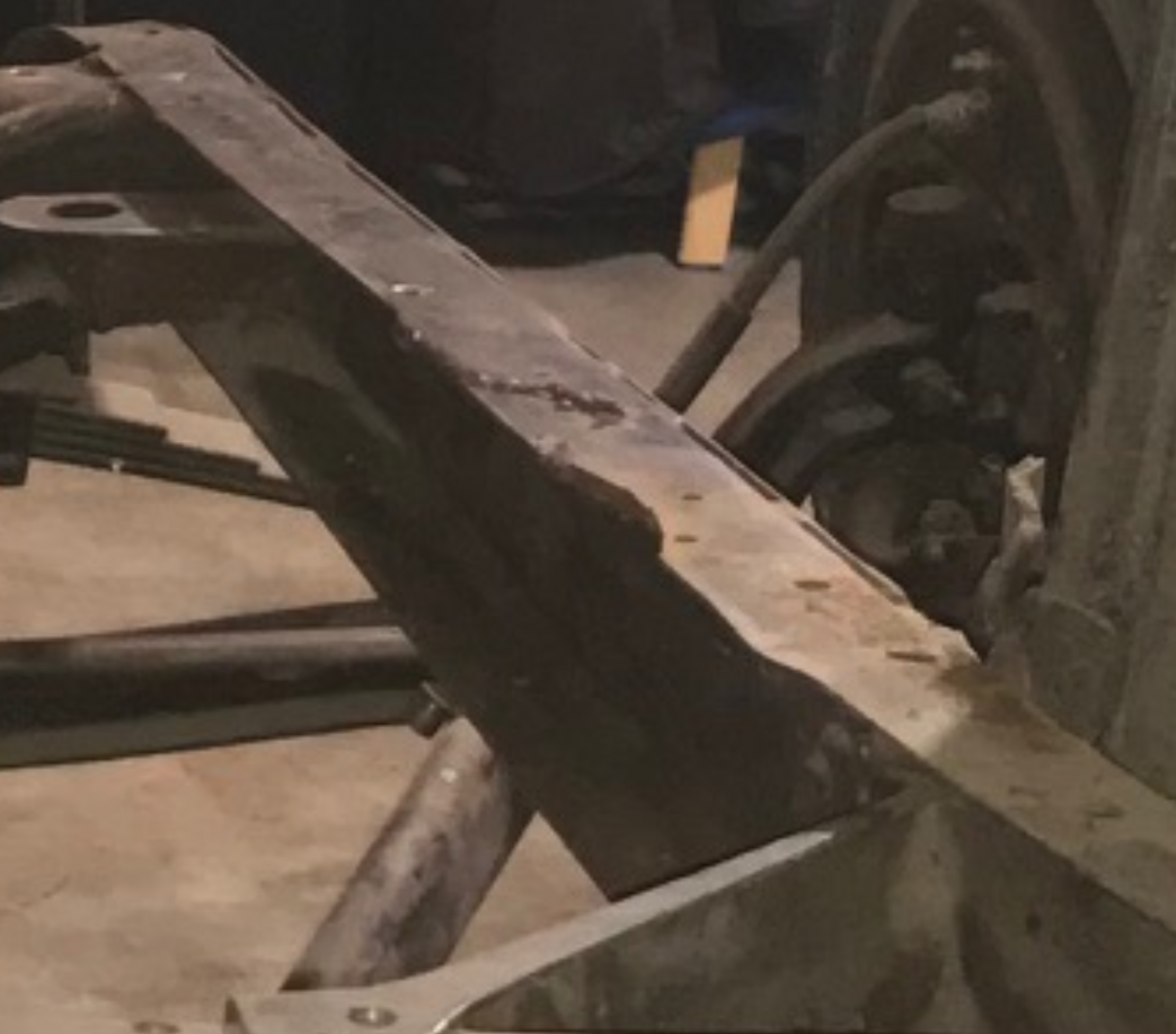

  1. Curious about the plates s***ch welded to the outside of the front rails.
    As to why they were put on.
    I don't see anything that isn't fixable, but, if you have to pay someone else
    money to do that, it becomes a tipping point for decision.

    I have an ideal that the plates were put on the outside to stiffen up the rails rather than box them. There was a lot cut away around the steering box. Ken doesn’t have the fabrication experience to do that himself.

    That Pontiac 389 will definitely put out more horsepower than the original flathead v8 would have. Those plates welded on the outside of the frame most likely were the equivalent of boxing the frame. So if you remove that outside plating you probably will have to box the frame. Since your running fenders, running boards, and its channeled the frame is really covered up anyway. Is it possible to clean up what is there so it looks nice ? It could be a way to keep the strength/history of the frame and at the same time would allow you to keep the original frame and save all the labor/expensive of removing all the plating.

    That frame is NOT hacked by any means. I could show you worse that's driving on the road today.
    Yove got an amazing piece of family history there. I'd lean to rebuilding whats there, motor trans and rear. Keep the frame. Just finess it and finish it a bit more.

    That frame is not all that bad peel off all the old scabbed on plates, blast it and get it to a good shop with a good frame jig and someone that really knows what they are doing and they can bring it around fairly quickly. You are not building a show car. As long as the frame is structurally sound and dimensions out right you will have a good reliable base to build off of. I don't know what your shop's rate is but from I am seeing you should be able to save that frame for much less that trying to use a repop. A lot of shops want to take the easy way out. Personally I would save that frame!

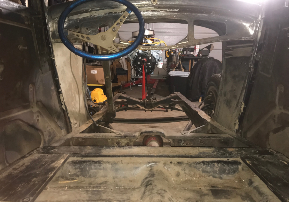

    I have seen the frame in person and since it is channeled no one is going to see the frame we could spend a bunch of time fixing it up to be safe or build a new frame that is strong and safe that poncho motor will have no problem tearing up that old frame keep the frame hang it on the wall as a memento but if it was me I would use the good pieces like the front and rear cross member and let the shop build a good strong frame so you can hammer on the car and drive the hell out of it with no worries

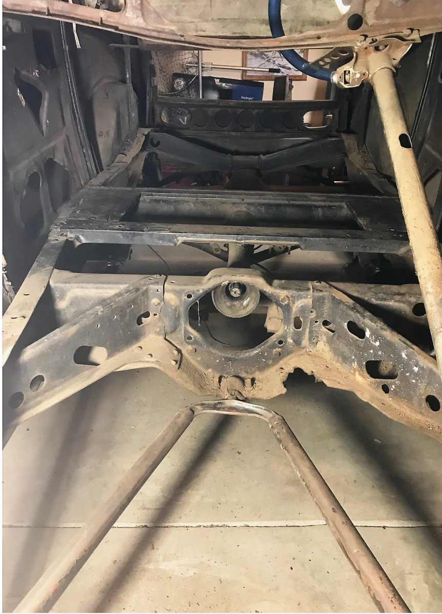

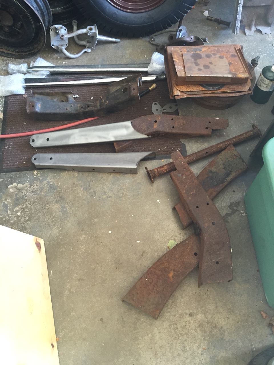

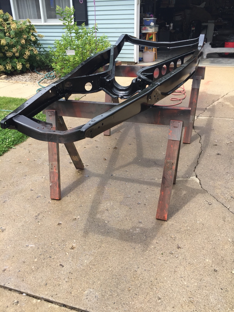

    If you need to be shown one more reason to keep your frame. Now be warned some guys reading your thread have seen these pics plenty already but...
    I want to slap these to far to be saved clowns.
    Here’s my 32 frame beginnings
    Then a trip through my subdivision tri-level turd garage
    I’m not trying to steal up this sweet thread or show off. It’s just that these original frames deserve saving.
