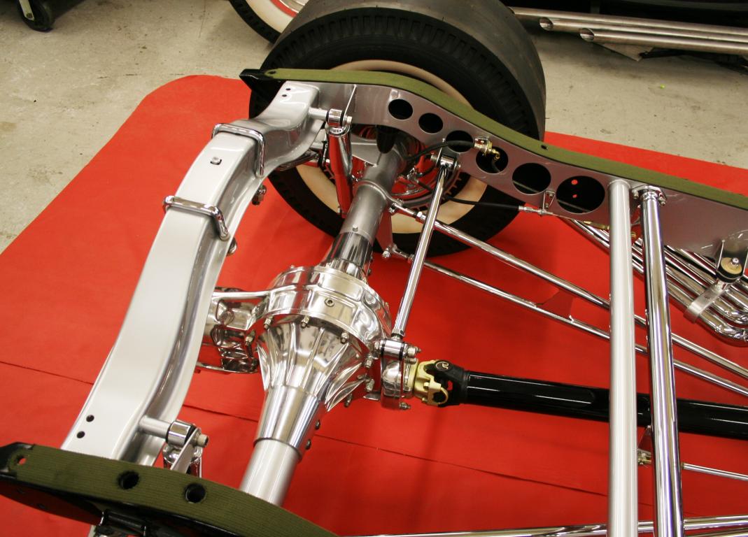

  5. Nice looking car - really like it! Do you have any pictures of the rear cross-member and QC setup? I'm putting a Frankland in my 34 coupe - wanting to see where others have mounted the A cross-member and also wondering how wide the spring hanger bushing centers are? Appreciate it if you have the info . . . have a great day!

    Heres a few shots of the rear

    The tear drop theam is carried throught the car...

    Hope you don't mind a couple of safety-related observations:
    If the bolt on the top of the pitman arm was longer, the nylon on the inside of the self-locking nut would have something to do.
    A hex-head Grade 12 bolt would be safer than that Allen bolt anchoring the Heim joint on the hairpin. Heads on Allen bolts have been to pop off.

  21. Actually Dave, the saftey item is the lack if a washer on the hiem.

    I'm thinking those little safety items were probably corrected when the car was ***embled for the final time.
