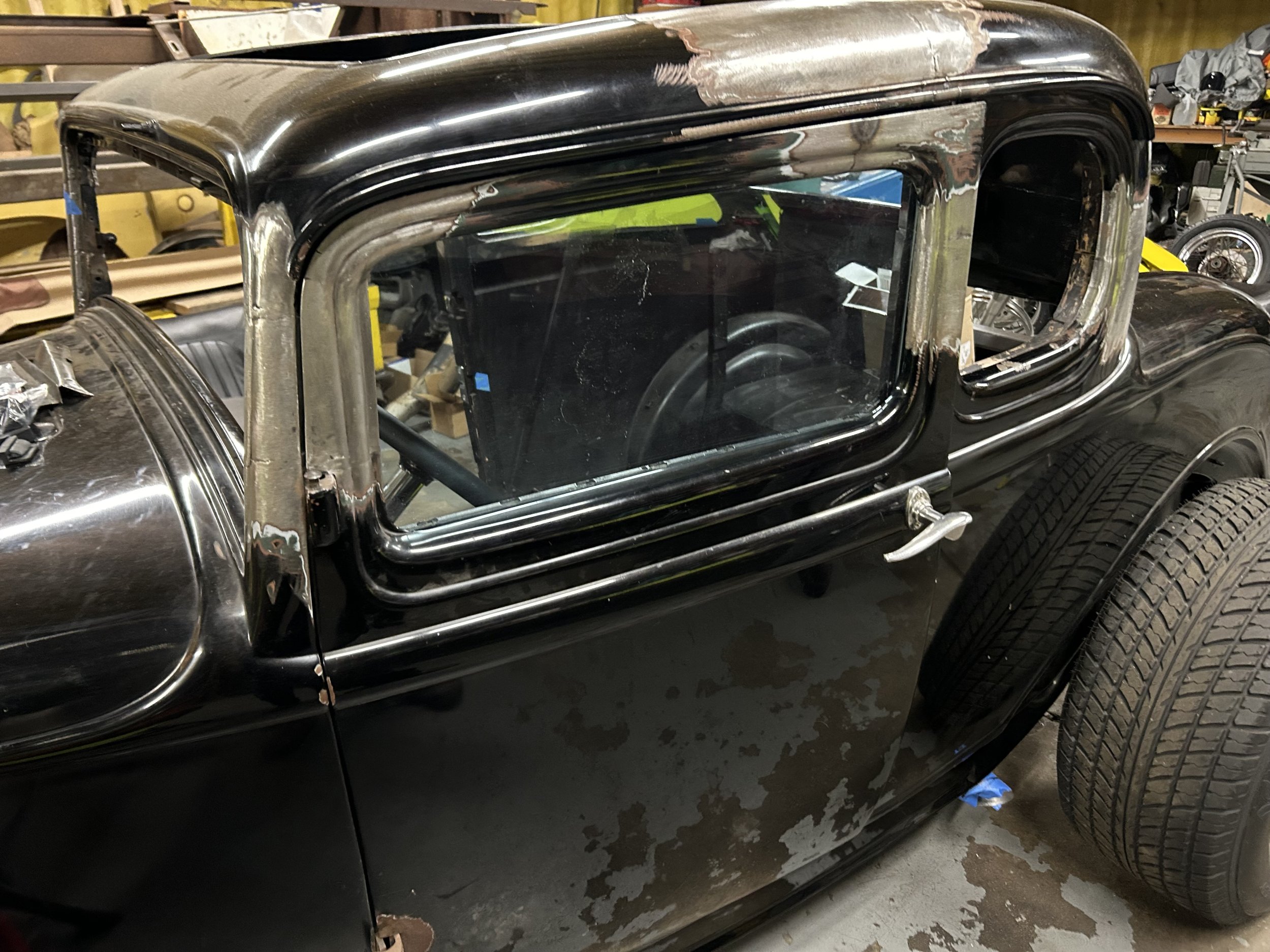

    I'm confused looking at the scars on the body. Does not appear to be chopped. Has it been raised back to original?
  2. It has been chopped 2 5/8 inches. I need to finish the welds and get some paint on the roof.

    clarifies that. thank you

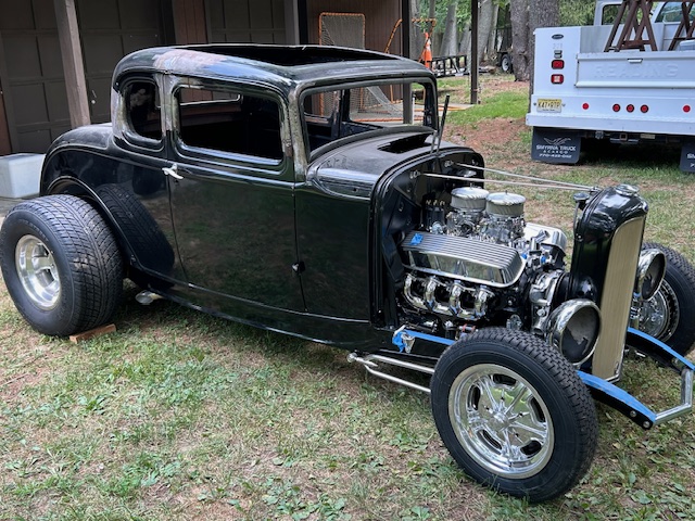

  9. Here are some updated pics. I finally got the body back on the frame. Now I can finish up some of the welding on the chop, wire and try to get it running. It has taken me longer than I planned but it will be worth it when it's dome. frame outside.jpg bodyandframe1.jpg bodyandframe1.jpg bodyandframe2.jpg bodyandframe3.jpg bodyandframe4.jpg
    Budget36, leadfoot1000, rod1 and 8 others like this.
  10. Here are a few more pics of the car with the hood on 32together2.jpg 32together4.jpg

    My vote is for no hood, let that big block shine !
  13. Thank you. I do have the complete set of fenders, running boards and brackets just incase I decide to put them back on one day.
  14. I do like the look of the motor open but I have always been a fan of a 32 high boy with a full hood. Something about the lines of the car with the hood on is really what I like. I will be starting a 32 coupe for my son and he has already said that we won't run a hood on his car.

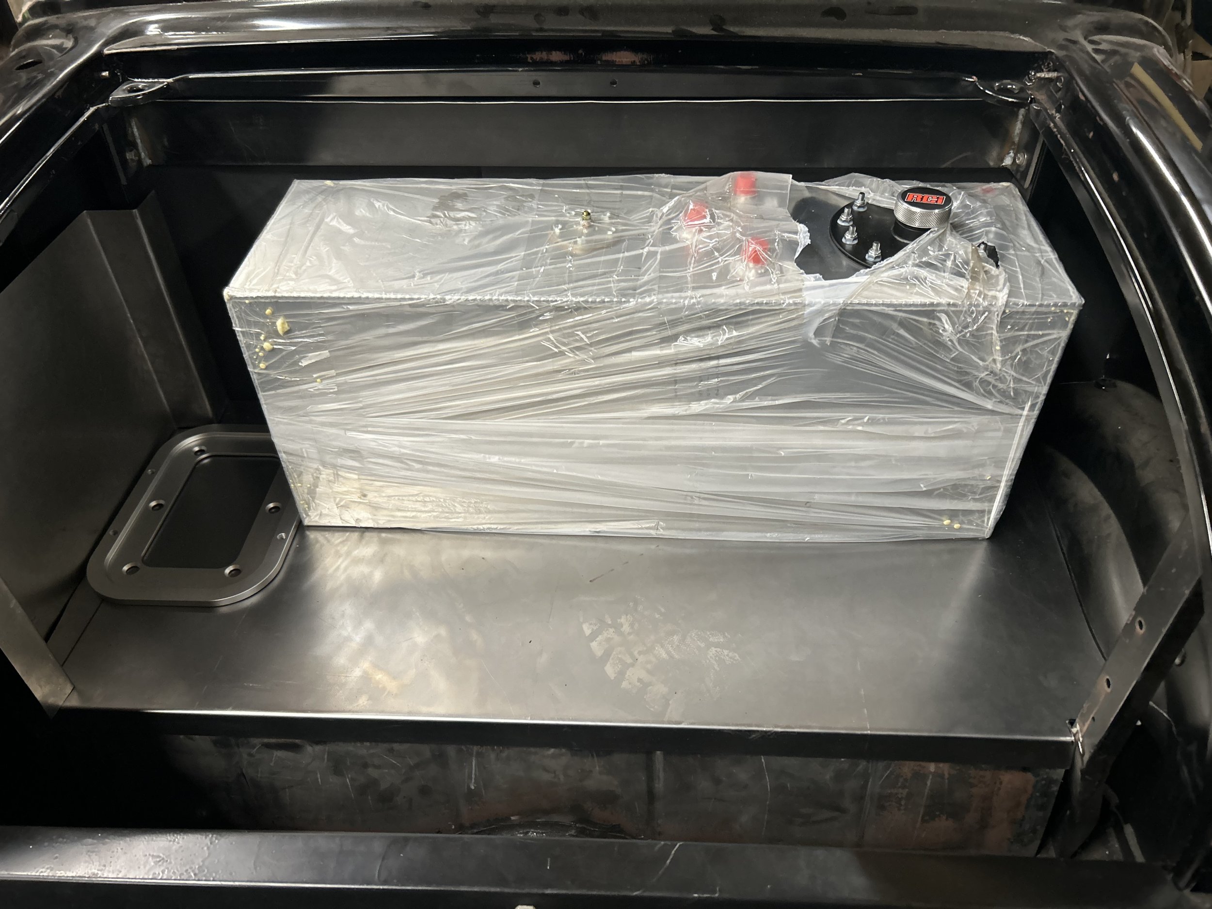

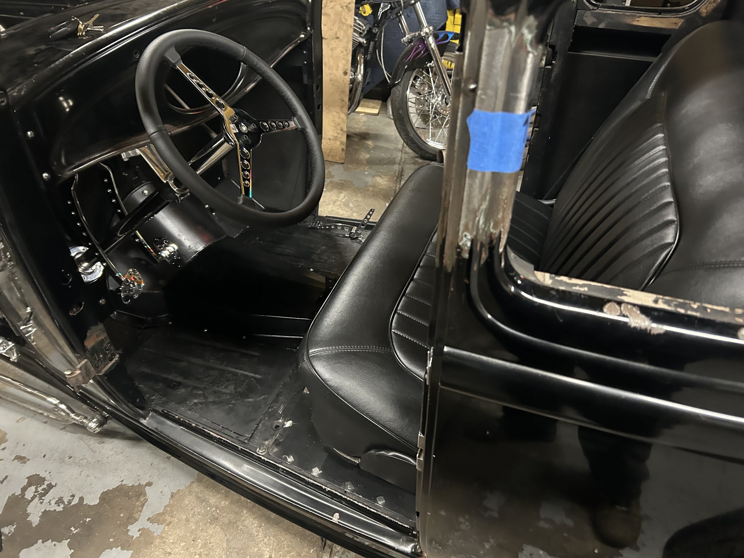

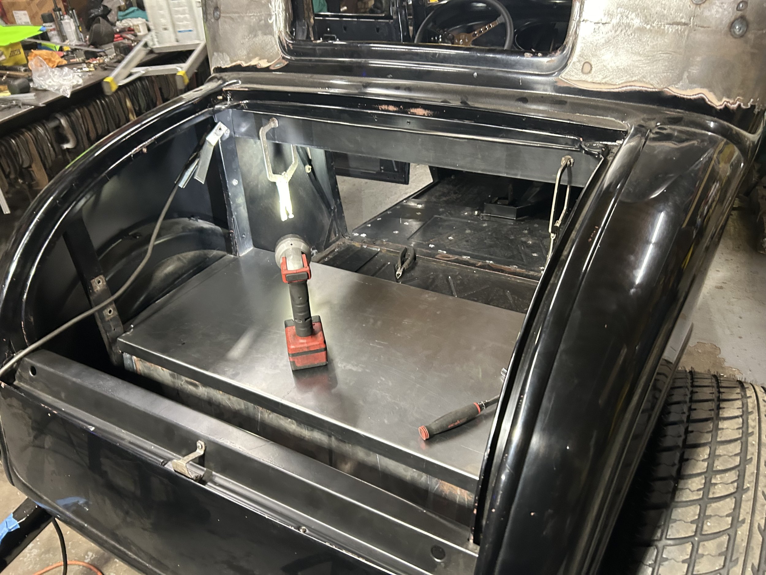

  15. Here are a few updated pictures of my project. Finally got the floors, transmission tunnel and trunk area sorted out. I decided to have a roll bar bent and that process took way longer than it should have. The plan is to fit the roll bar then send it out for chrome. This one small detail has slowed my progress but I think the aesthetics of a chrome roll bar and safety factor is worth it. IMG_6824.jpeg IMG_6826.jpeg AD76B55F-3A6E-4589-8DEA-8A3F45430B86.jpeg IMG_6848.jpeg IMG_6849.jpeg IMG_6850.jpeg IMG_6824.jpeg IMG_6824.jpeg IMG_6826.jpeg IMG_6824.jpeg IMG_6849.jpeg

    With the fuel tank in the trunk are you going to shorten the rear frame horns? I see an original style tank came with the car.
  17. I’m also getting ready to have the gl*** cut for the car. I installed one of the door gl*** that was in the car back in the 80’s. It has a nice blue tint to the laminate. I think I’m going to try to do either a light blue or light green tinted gl***. IMG_6959.jpeg
    No, I like the look of a 32 with the stock fuel tank. We has to notch the stock tank a bunch to clear the rear bit I still want it there for the look.

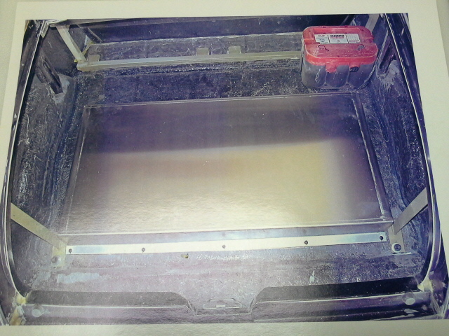

  20. DDDenny
    Posts: 22,611
    I did a double take when seeing the aluminum cover for your trunk riser as I did something similar for my roadster.
    project starter likes this.
  21. Looks very similar. Nice work.

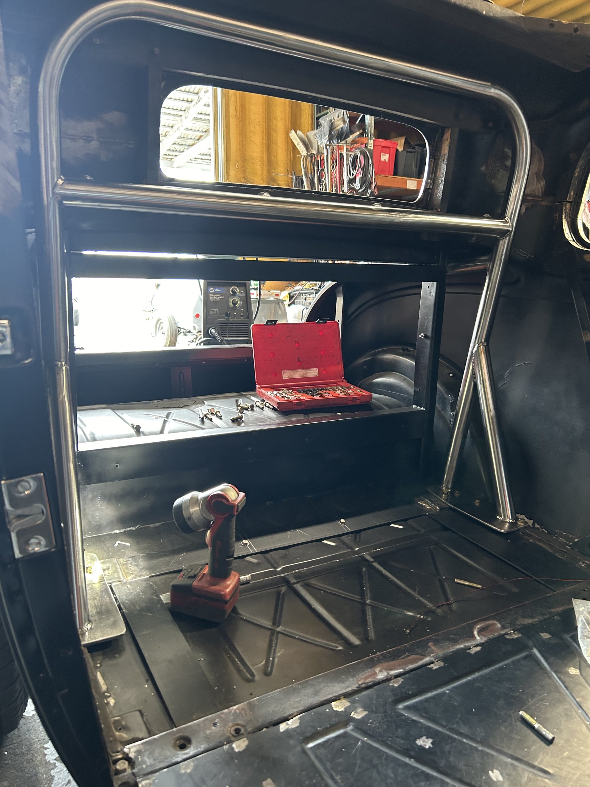

  22. This is the next piece of the puzzle for my 32. I really wanted a roll bar for a little added safety and to complete the look I was going for. One we are finished fitting and welding it will go out to be chromed. Space is very limited when you put a big block in one of these cars so we had to get creative with the placement of the roll bar and to be sure we secured it to the frame mounts. There will be two bars that go to the rear of the car as well. The rear bars will be made detachable so I can get it out of the car to chrome it. Everything was put together with steel slugs that we turned down on a lathe and plug welded. The floor mounting plates have the slugs welded to them and then the roll bar is welded to the plates. Probably overkill but if you are going to build lt. build it strong. I will run harness type seatbelts that mount on the crossbar. We made the original design out of pvc pipe. It was much easier to get it in and make sure everything would fit. IMG_6988.jpeg IMG_6989.jpeg IMG_6987.jpeg IMG_6991.jpeg IMG_6992.jpeg

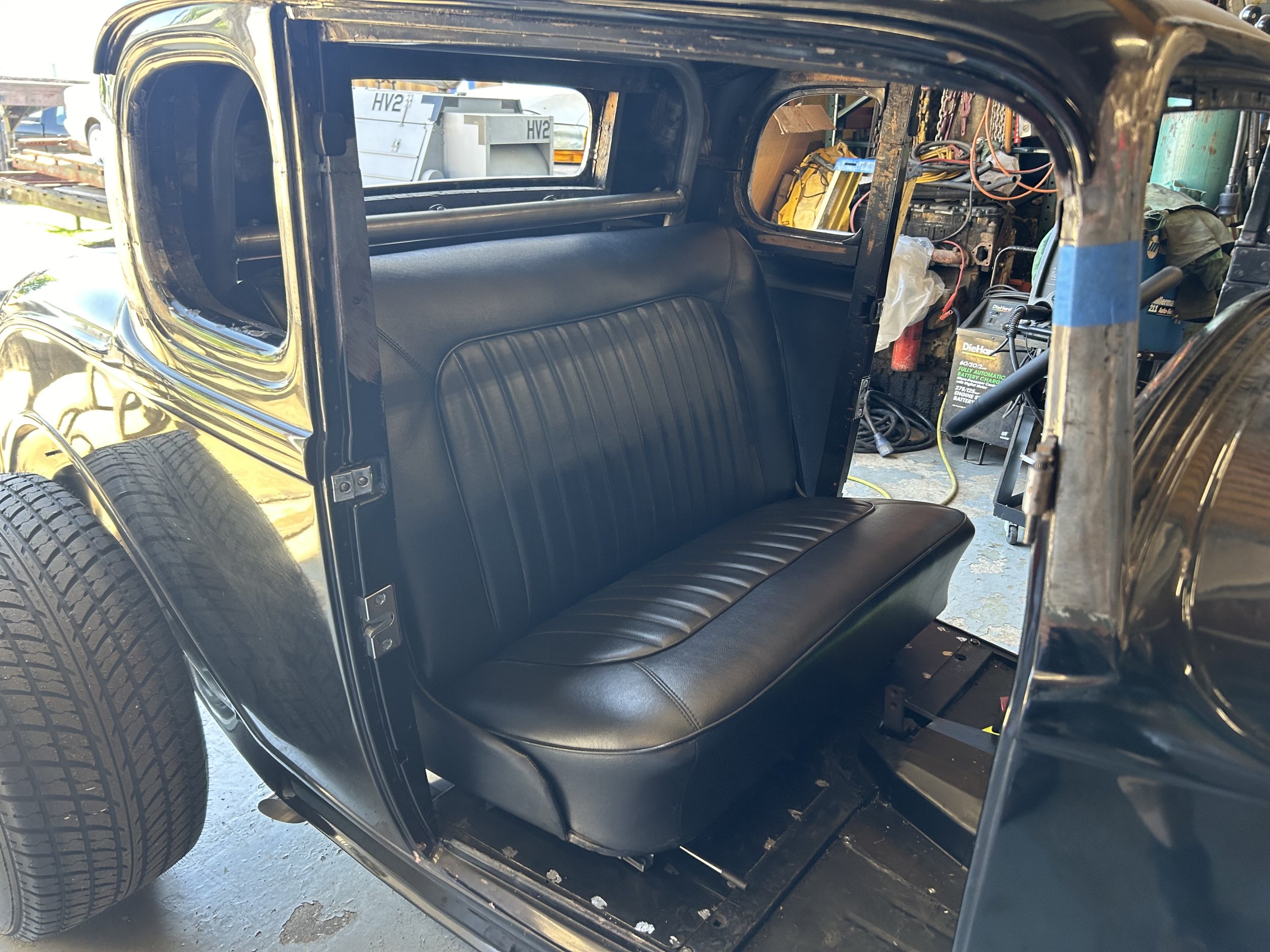

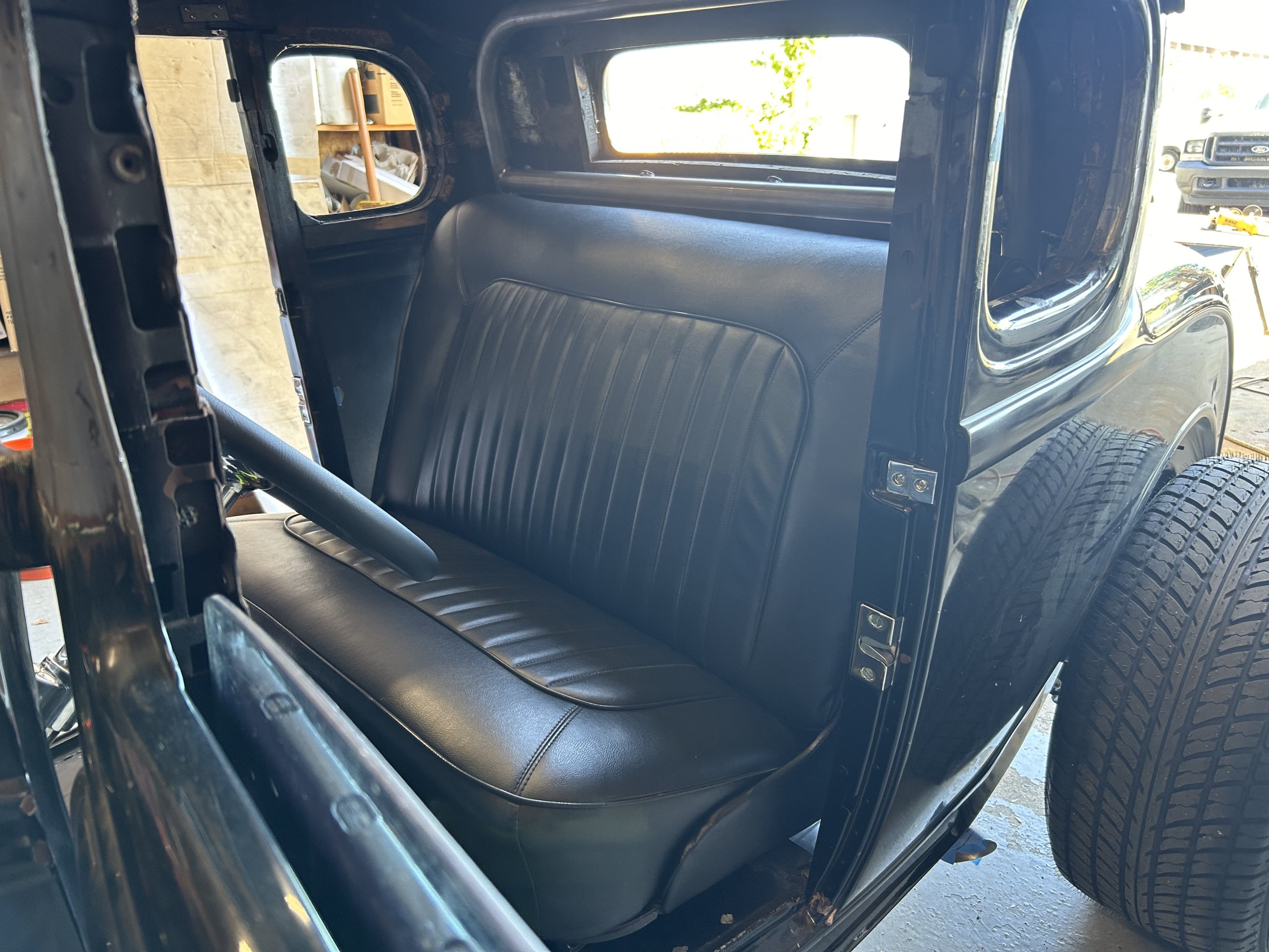

  25. Here is a picture of the seat in the car with the roll bar. I really wanted to expose as much of the roll bar as I could but there isn’t much room in a coupe. The rear bars are detachable so we can get it in and out. The rear bars have a 4 inch sold steel slugs that join the rear legs to the main hoop. The rear bars will be painted black because they will be hidden behind interior panels in the trunk area. IMG_7050.jpeg IMG_7050.jpeg IMG_7047.jpeg IMG_7052.jpeg IMG_7053.jpeg
  26. akoutlaw
    Joined: May 13, 2010
    Posts: 1,574
    akoutlaw
    Thanks for the extra pics. I wonder if you will have to worry about banging your head on the roll bar. Not much room in there.
  27. The bar is back far enough that your head is clear of it. We bounced up and down on the seat to test that theory.

  28. Here is the finished roll bar. We bolted it back in for one final test fit. The welds have been polished and the bar was cleaned up with scotchbrite. It’s off to the chrome shop today. We are cutting a piece of stainless for the divider wall behind the seat. IMG_7075.jpeg

    Lookn good! What size DOM tubing did you use?
  30. 1.75
