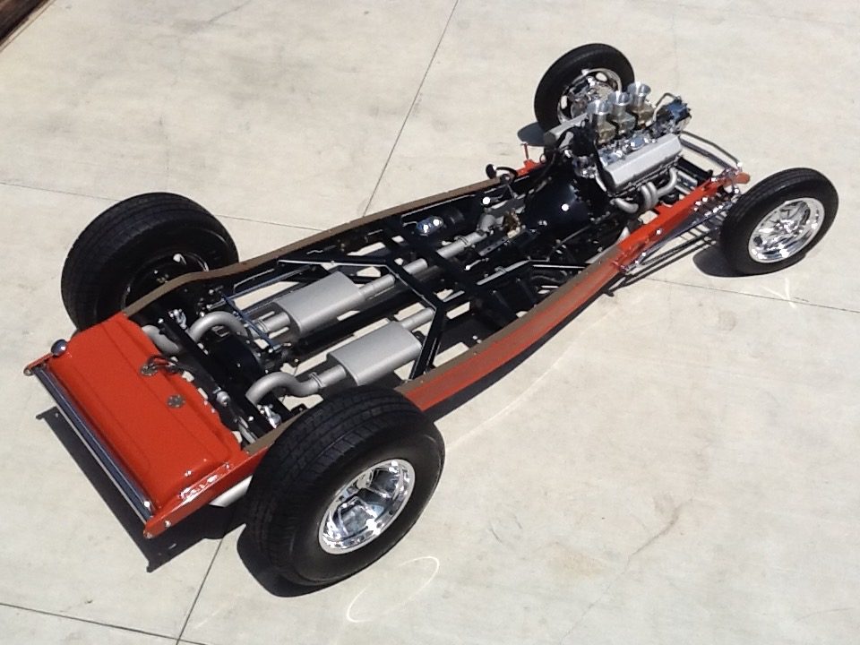

    Here are some examples that might give you some ideas...........
    Personally I'm planning to build similar to the TCI ch***is with the box tubing x member as I feel it should be very strong and gives room for routing exhausts. Some guys like the more complicated look shown in some other examples.
