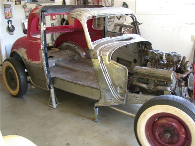

    It is too bad that they cut up so many 32-34 Ford coupes back in the day to make race cars. Glad to see you bringing this 32 coupe back to the street where it belongs. It is something I like doing as well, and there are two old race car coupes in my garage now. The red one is a 33 and is now the black one - and the white coupe is a 34 I recently picked up, waiting its turn. Takes a lot of time and effort, but you will get it done!

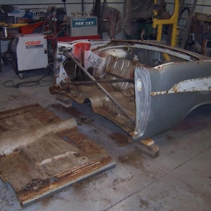

    Here's one cut in half the other way! :)

    alchemy
    I think you found half a fordor RC.

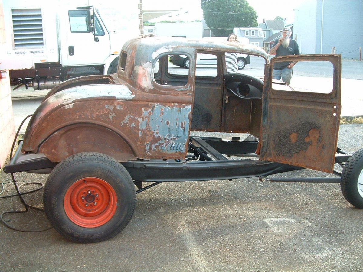

    Glad to be putting that winter behind us. My dad sold his 28 Chevy and now the deuce is tucked safely in the garage. We continued work as much as possible over the winter. The frame continues to be our focus. The more we worked on the frame, the more problems we uncovered. Cracks, bends, twists, dimples and bondo. yeah bondo. But we have set our course and we will set this thing right. We completed our jig and finished removing the crappy boxing plates that ran the length of both frame rails. We purchased a nice set of original '32 frame blueprints and we are going inch by inch checking everything. Thankfully many of the original mounting holes for the cross members and sub floor mounts revealed them selves as we continued work. So once we have rails tacked to the jig we be able to use these landmarks to help sort out all the issues. Its a labor of love for sure. Time well spent with dad.

    The work on these frame rails was so horrible... they had these super shady looking rear frame extensions welded on to them. We had the rails sitting on cinder blocks at one point and I was removing part of an old bracket with a hammer and chisel when suddenly the welds on the rear extension literally sheared off. Whoever did the 'fabricating' on this thing should forever be banned from holding a tool again. What a mess!

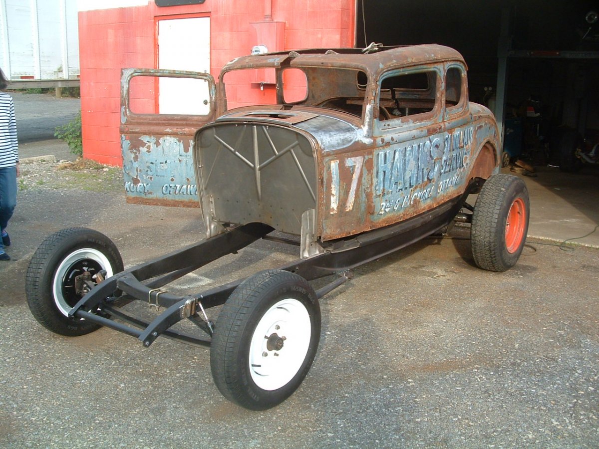

    ok... its been way too long since I updated this. Life has thrown us a bunch of curveballs but we are continuing to make progress. We handed the frame over to a local hot rod shop to have to some final straightening done on it before we start welding on suspension brackets. I think our hard work was worth it. The owner of the shop said it's one of the nicest deuce frames he's seen. Oh and we also finally got around to cutting the body in half so we can restore it to it's proper width. We will have several more pics soon.

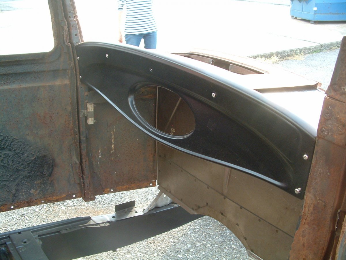

    okayyyy... progress. The frame is finally back together and squared up. The body is finally sitting at its proper height and width. Now... on to the patching. And there is a lot of it haha
