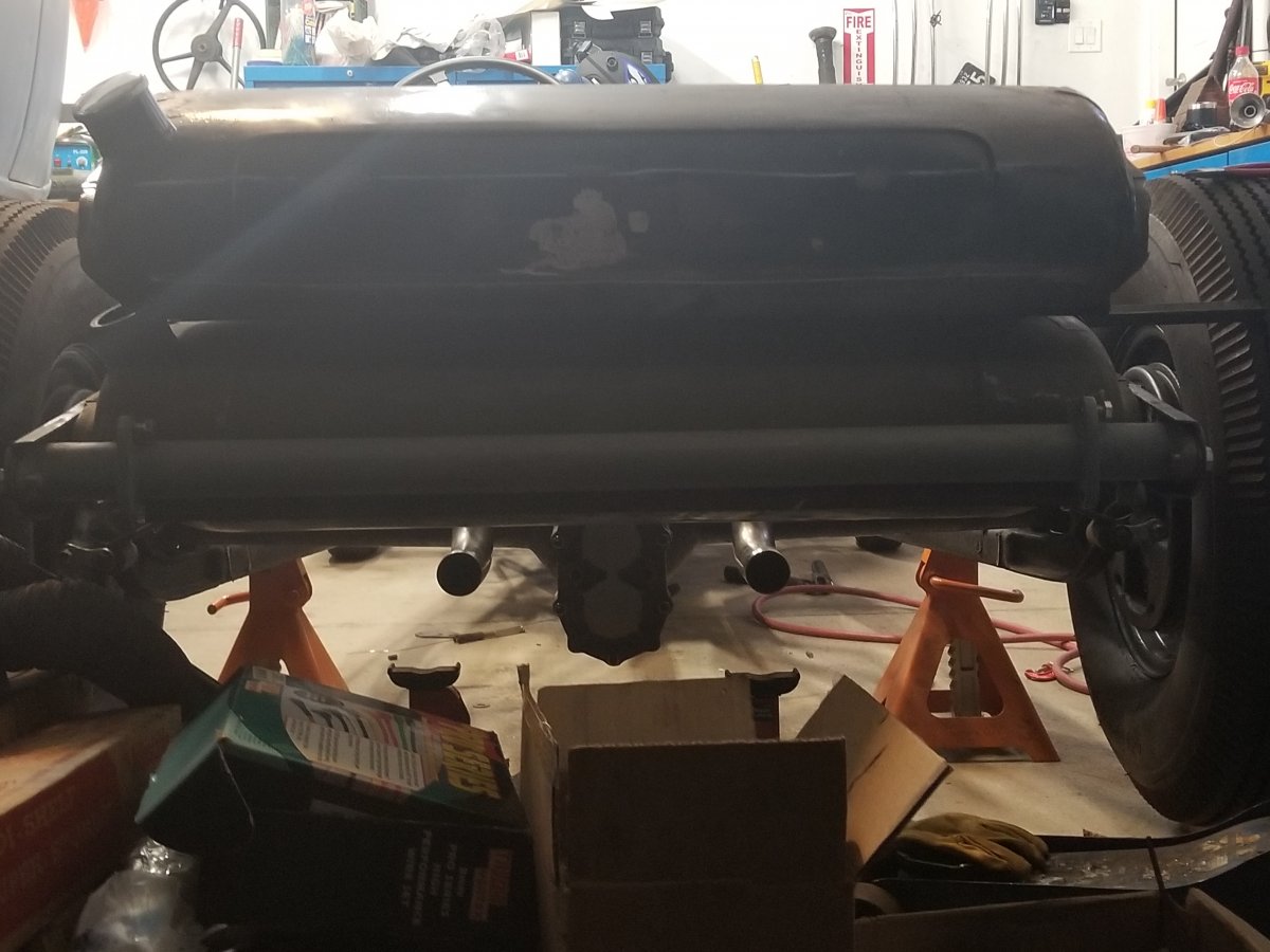

    This week I worked in the exhaust quite a bit. Man do I hate welding stainless tube. I finally bought a Y valve so I could run a purge line inside the tube and it was like night and day easier to weld and with better quality. Once complete I'll be able to out the body back on for final mockup. I'm going to run chambered tube mufflers like on my sedan and 2" stainless, but for mockup I have just a set if straight pipes in there.

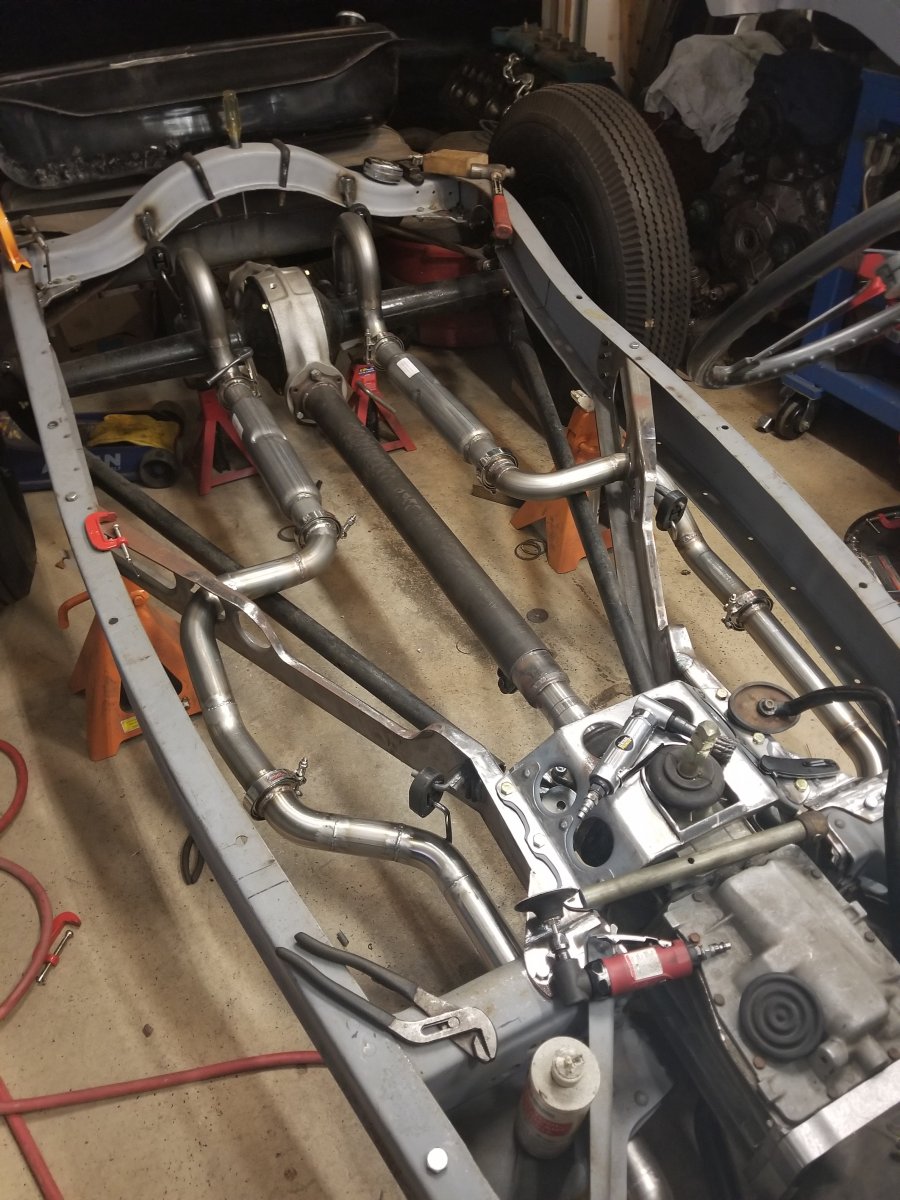

    Worked on the driver side exhaust this weekend. Learned something else new- I had tacked several sections in place and them removed them to fully weld. Stainless moves around enough with the heat that i had to cut back apart a few welds and realign . From now on I will fully weld one section at a time.

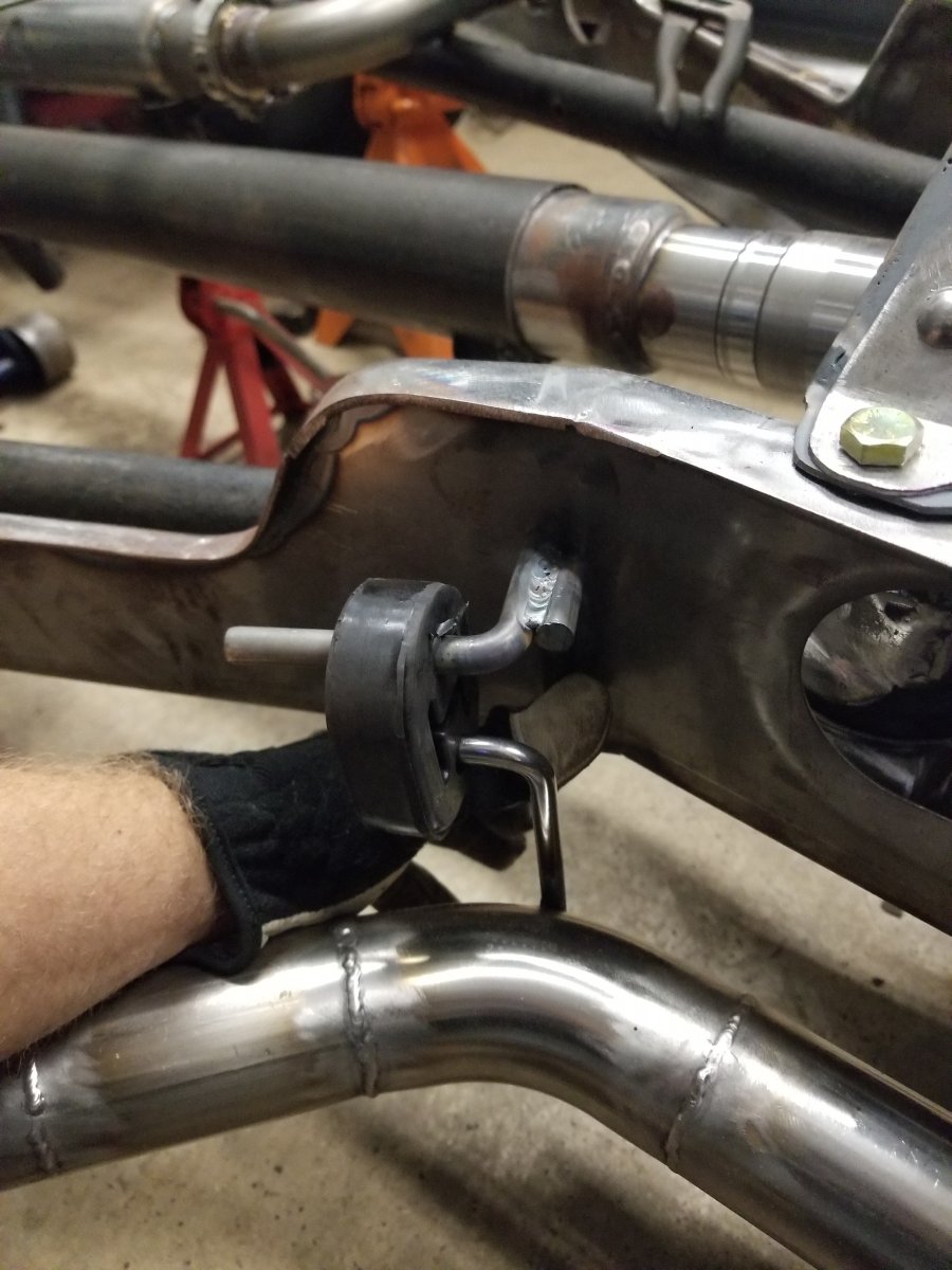

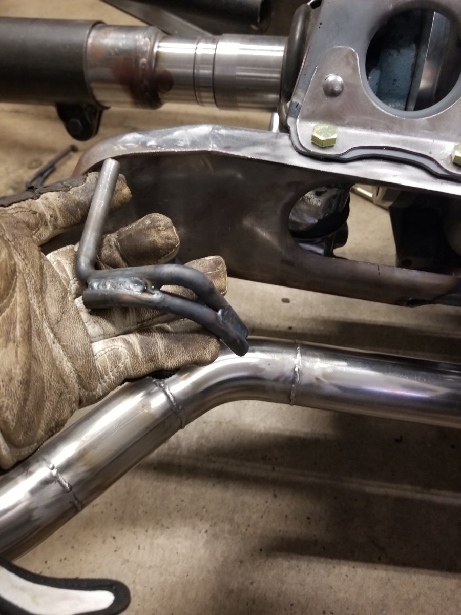

    Hey guys- well, this exhaust has taken me 4 times longer than anticipated but I was able to wrap it up today. I hung it with 4 rubber hangers but I may add one more per side to make it bulletproof. Now that this is done, I can cut the hole in the floor for the model A crossmember and set the body back on.
    For the mufflers, I used the identicaluffler that I used on the sedan from Classic Chbered exhaust: http://classicchambered.com
    He is local and does a nice job.
    For the hangers, I used stainless on the pipe side and steel on the frame side. On the frame side I doubled the bars for stiffness like we would on a typical OEM application.
    Tomorrow I am going to a friends house to have him help me cut down the torque tube. Stay tuned...
