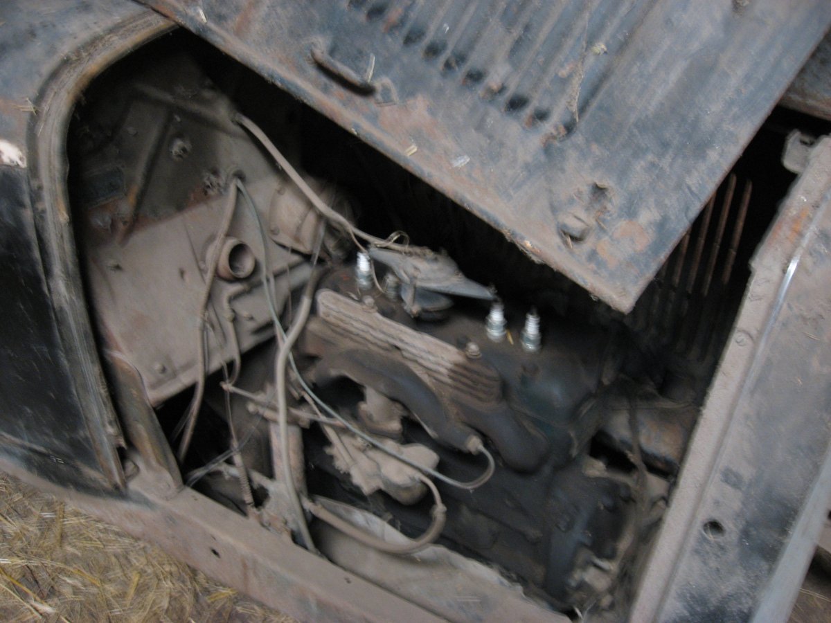

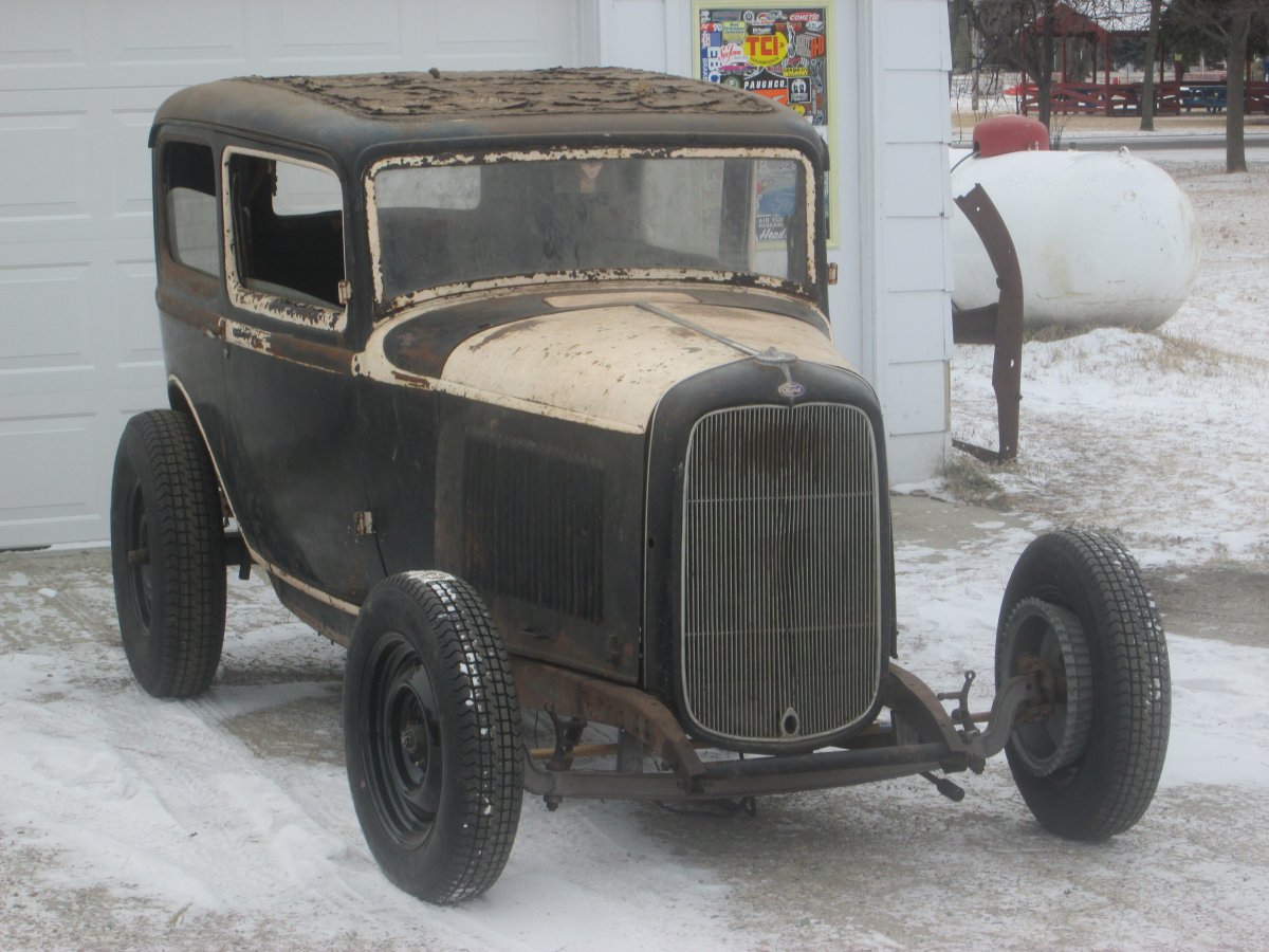

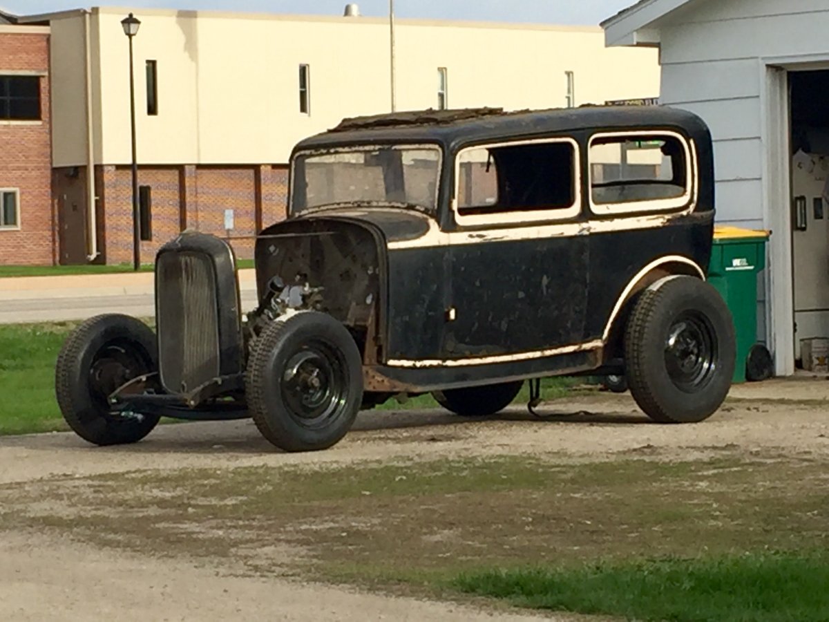

    The sedan came from my neighbor's farm a half mile from where I grew up. I remember riding the bus and seeing the grill of the car sitting in the machine shed.
    I have history on the car from mid-1950s. The sedan was, at some point, purchased by a farmer in western ND and driven back to eastern ND. Eventually, the farmer decided that it was no longer needed as a car. So the decision was made to turn the car into a spray coupe. His intentions were to cut the back of the body off and mount a sprayer. After inspecting the frame he decided it wasn't heavy enough for this and the car was parked in the barn.
    Dennis bought the sedan from the farmer around 1957. He graduated from Nome ND in 1959, I think. He's the one that added the pink (now faded white) paint on the outside of the car. He also added the pink interior. He told me that the girls really liked it! There is a large picture of the car with a few girls standing on the running boards pulling away from the school in the 1959 year book. He also told me he sent a picture to the Ford Times magazine. He said it was published in the back of the magazine in the late 50s. (I have never tried to find this pic) Dennis kept the car until I bought it in 2001. He wanted to fix the car up but never got very far with it.

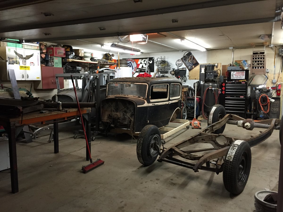

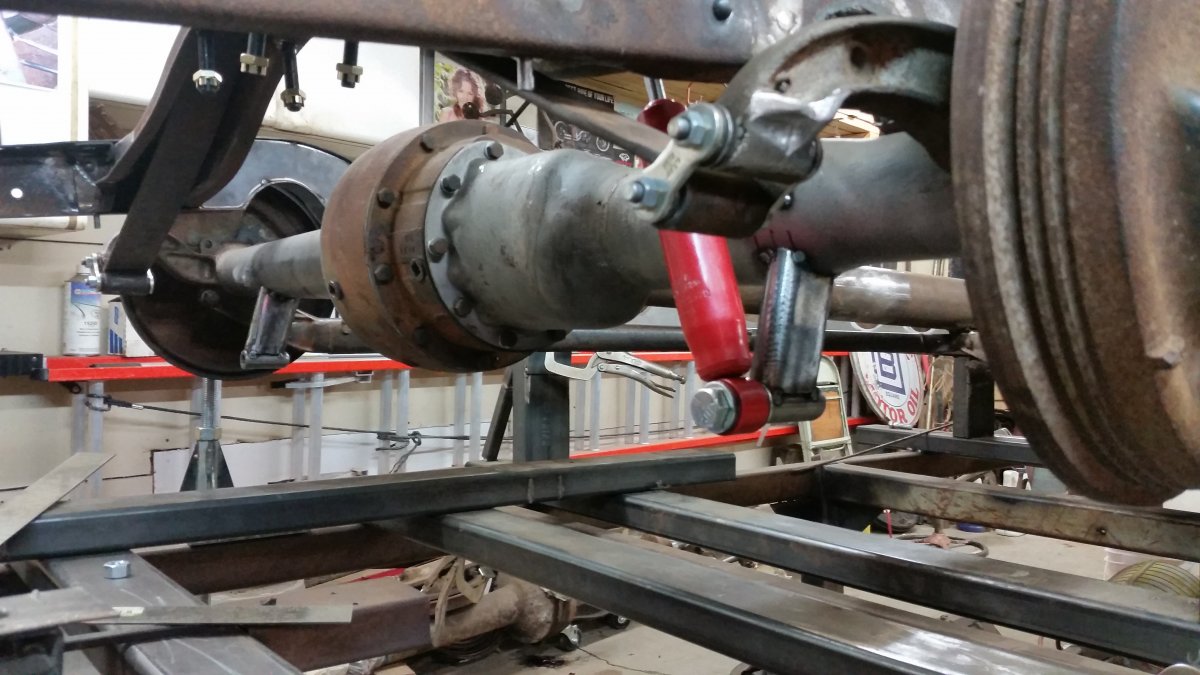

    Greg Haynes of Anson dropped axles, dropped the original heavy axle to the car. downsized_1229041534.jpg

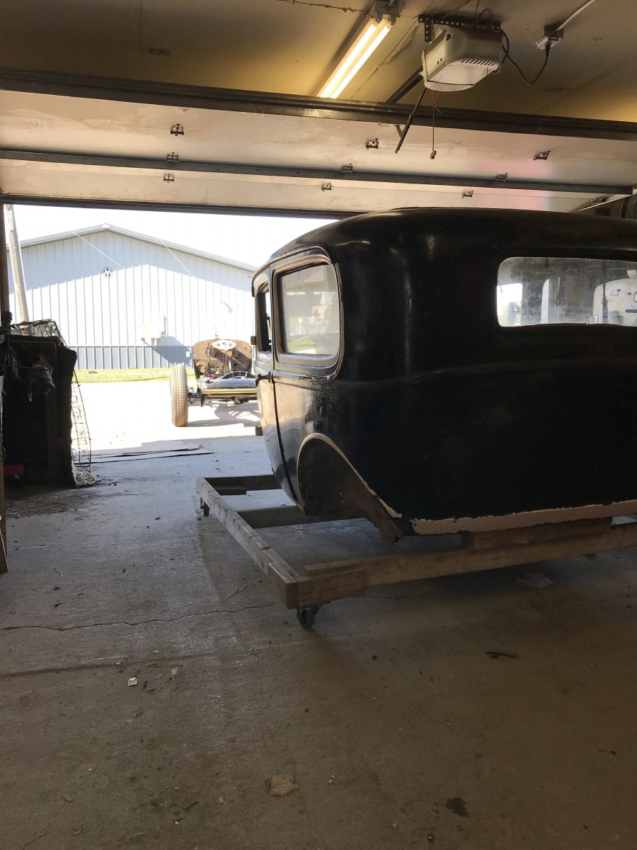

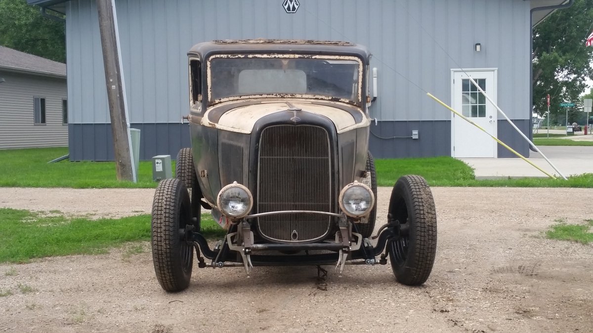

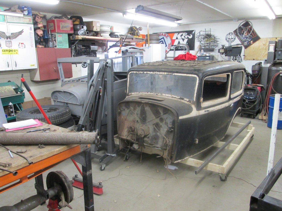

    First time the body was taken off the ch***is.

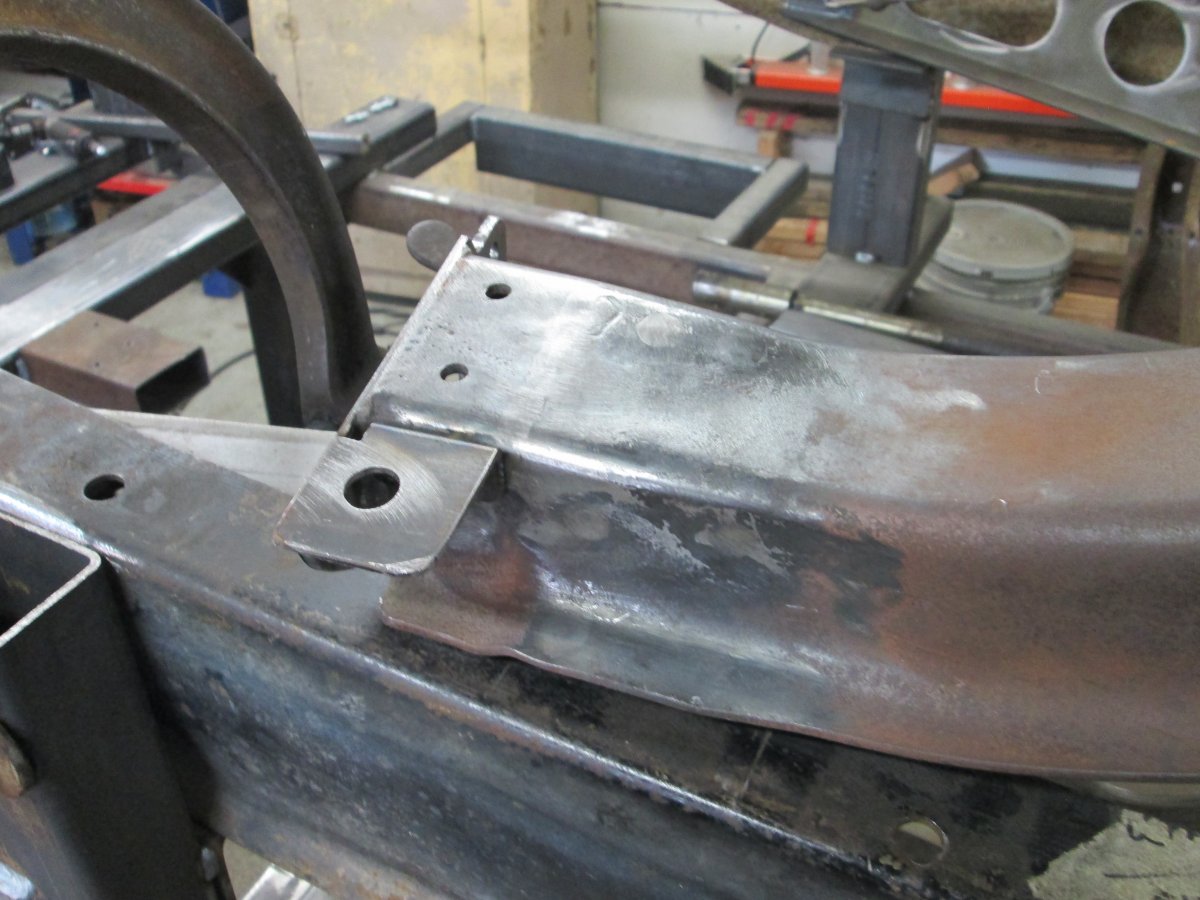

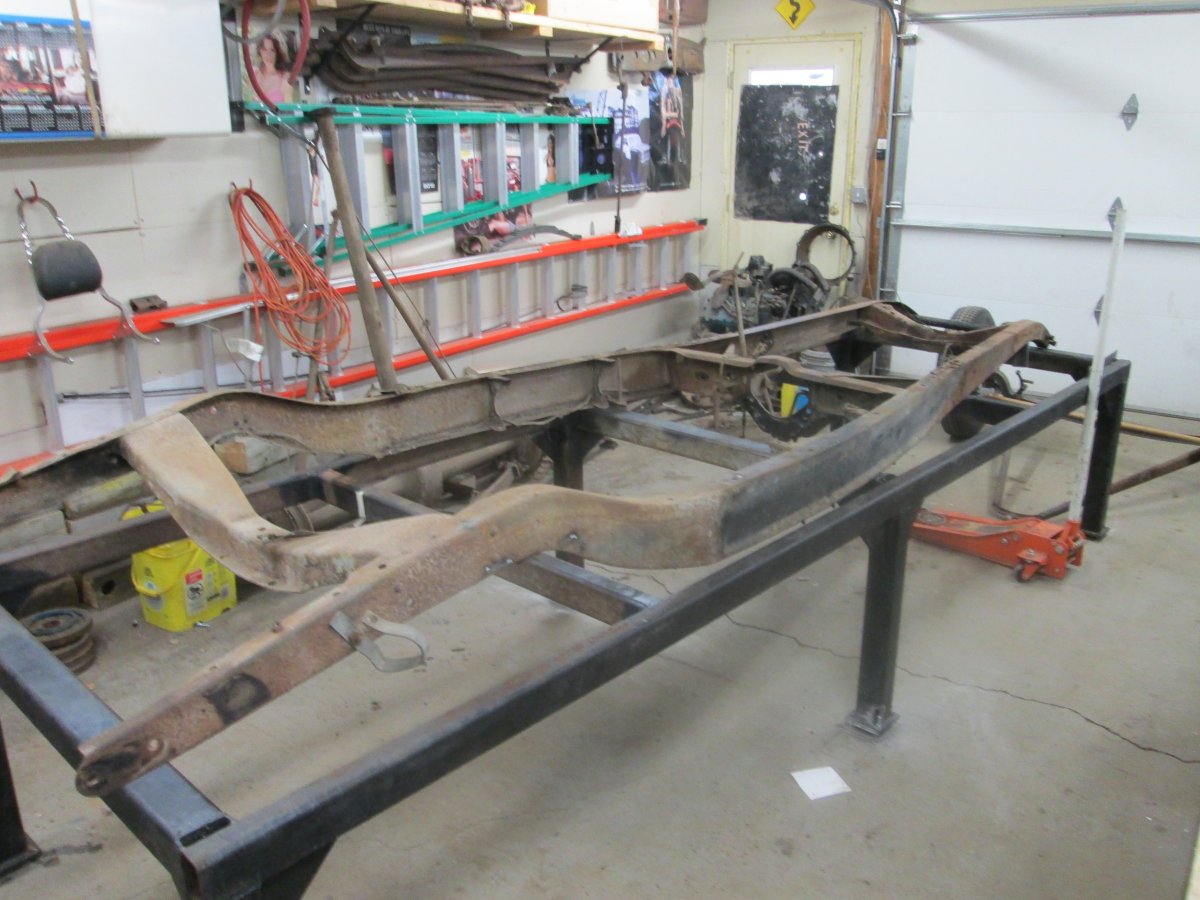

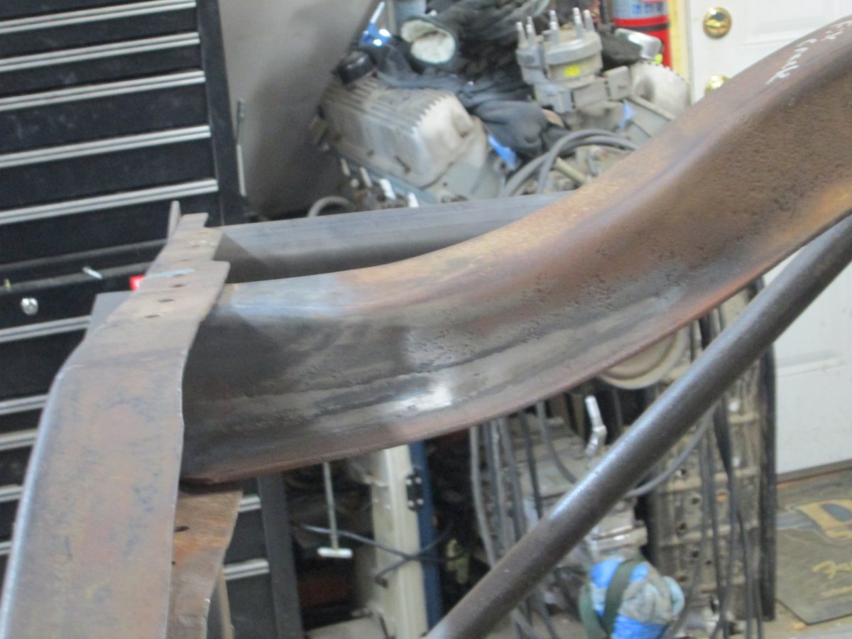

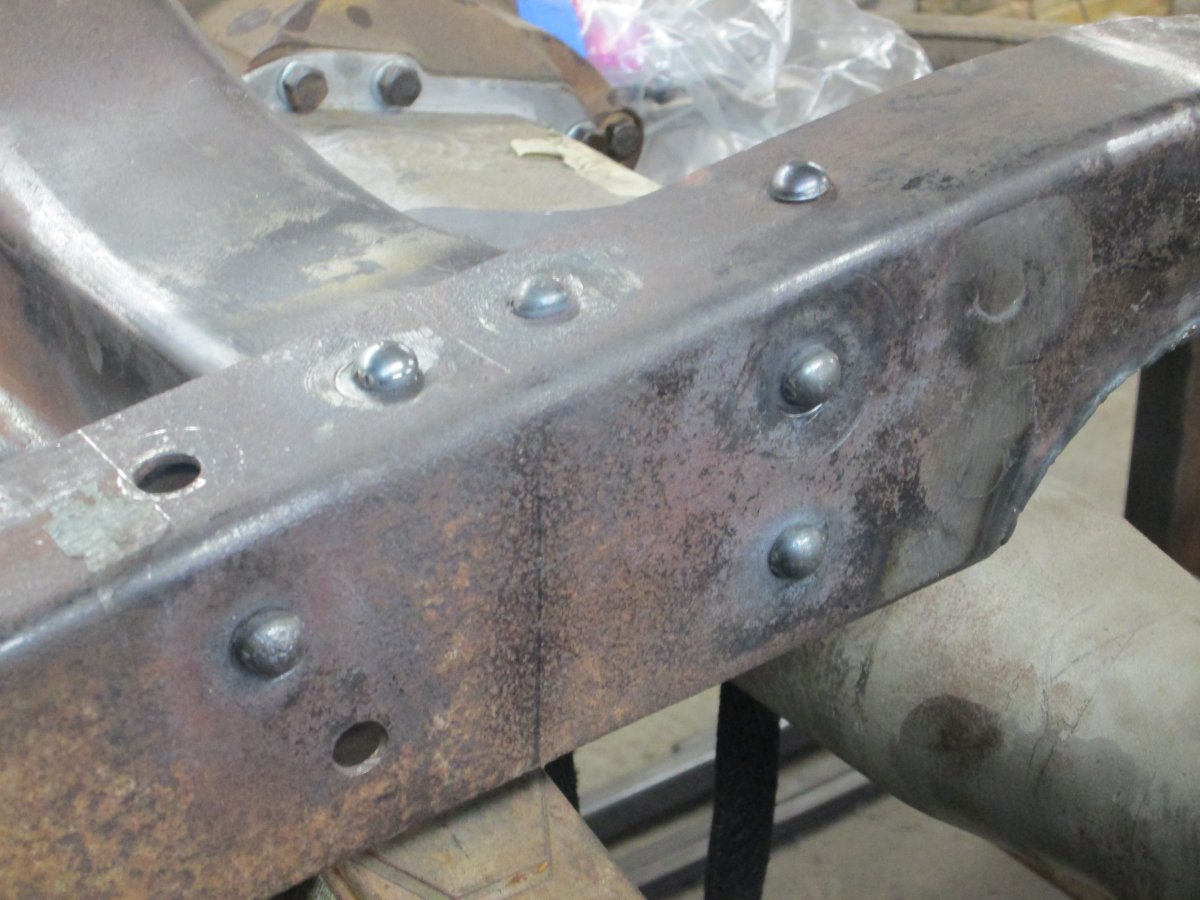

    The front crossmember was badly broken. I built a jig from good 32 crossmember to rebuild my original. I added a model A center while I was at it. I also changed the rear crossmember to a Model A. If I ever want to run a quick change in the future. The rear crossmember was also widened to the frame rail width and riveted. The rear kick up was boxed and C-notched. I also made a removable plates that tie into the boxing plates and the K-member legs.
    IMG_0567.JPG IMG_0621.JPG IMG_0624.JPG Img_5087b.jpg Img_5117b.jpg IMG_1025.JPG IMG_1026.JPG IMG_1035.JPG IMG_1036.JPG IMG_1037.JPG IMG_1038.JPG IMG_1040.JPG IMG_1043.JPG IMG_1044.JPG

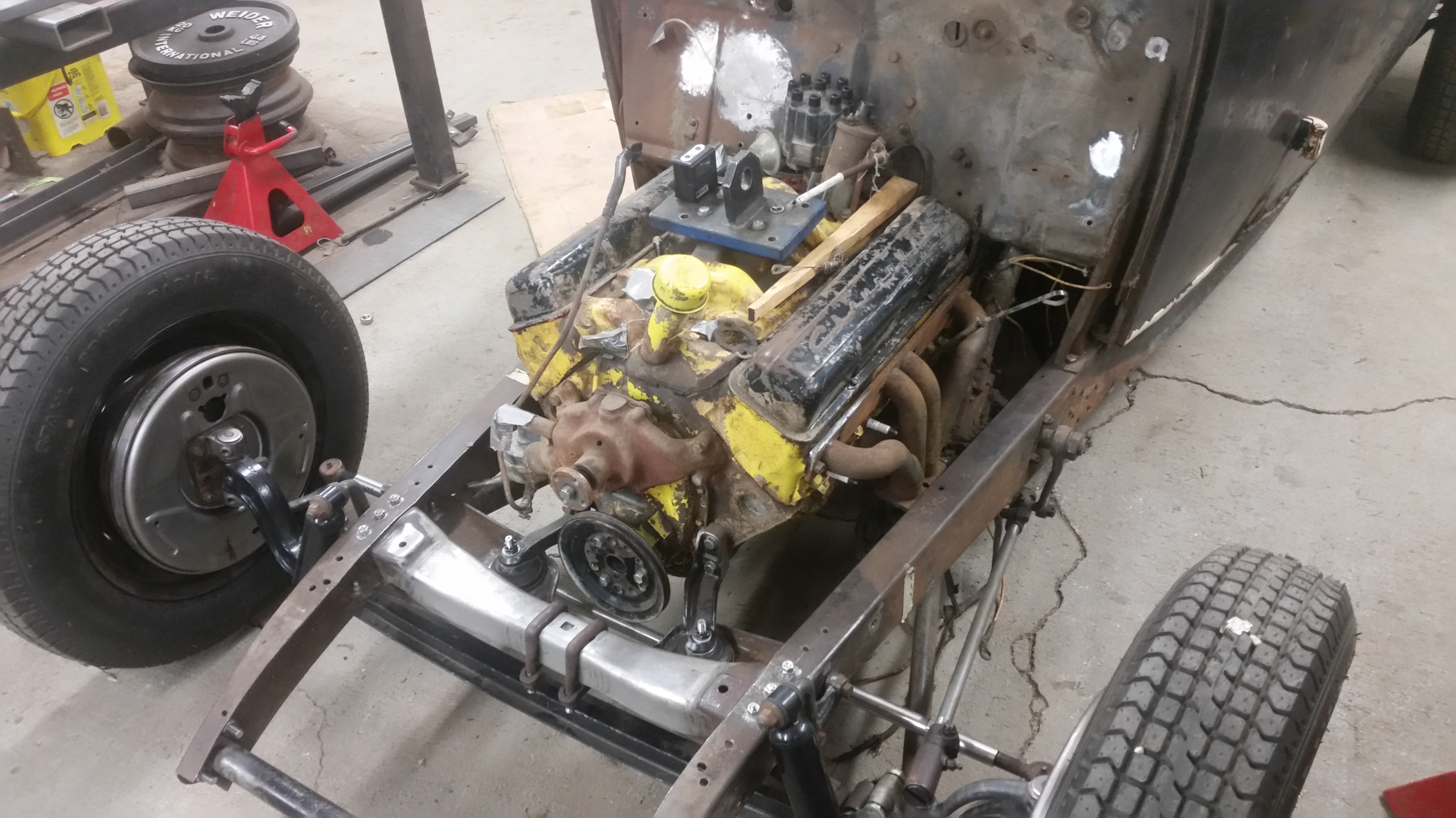

    The original plan for the car was to be flathead powered. Unfortunately with the flathead I didn't have enough clearance from the oil pan to the ground. So I will be running a 1958 283 with 10.5 pistons, ported X heads, 300hp 327 cam, tri power and early Hedman Hedders. I know I'll never be able to use all of it with the 39 trans and the Columbia but it should still be fun. IMG_7603.JPG IMG_E7608.JPG IMG_7612.JPG

    32 Ford V8 motor mounts modified to work on an SBC. Rear shock mounts made from some left over wishbone. Steering arms dropped and a 1937 Hudson steering box that was rebuilt by NealinCa.

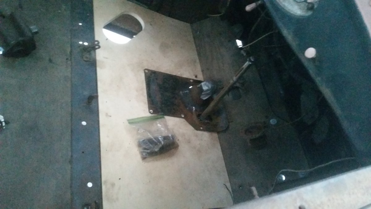

    Modified headlight bar and F1 shock mounts. I had to cut up the floor in back for clearance. So this is what I came with. I tried to keep as much of the original floor as I could. I also modified the original trans cover to work with the 39 trans. RZVH1009.JPG BXSS2732.JPG QBJZ8930.JPG IMG_9127.JPG IMG_9129.JPG IMG_9130.JPG IMG_9156.JPG RTKK3448.JPG PLOW5827.JPG

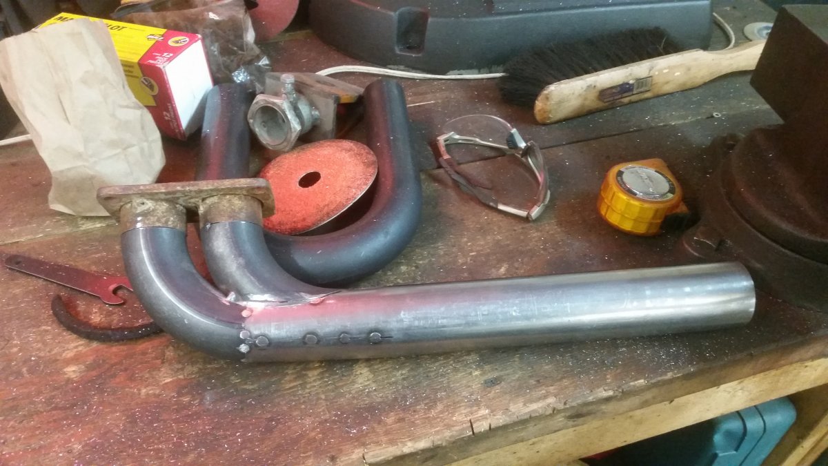

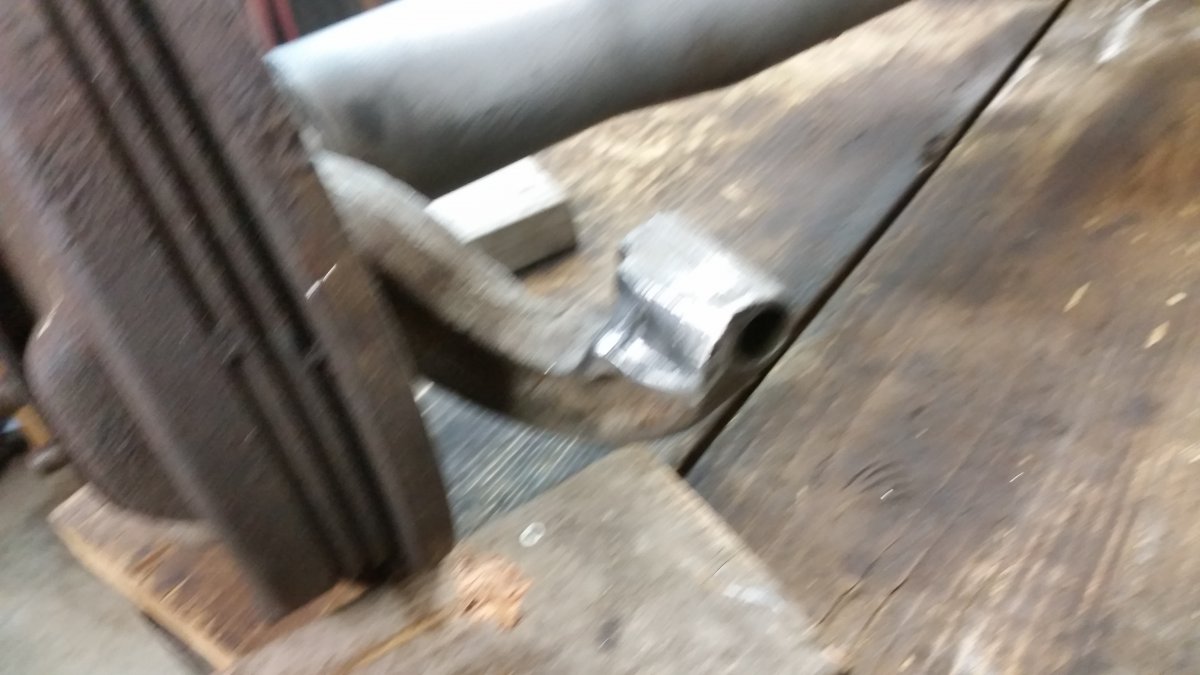

    I've never done any kind of exhaust work before making the collector for the Hedman Headders was challenging. I also started making the exhaust system at the same time.
    MMZJ7177.JPG KZLS3671.JPG GFDO6005.JPG WHFN8819.JPG LSTI3200.JPG LLOU0066.JPG

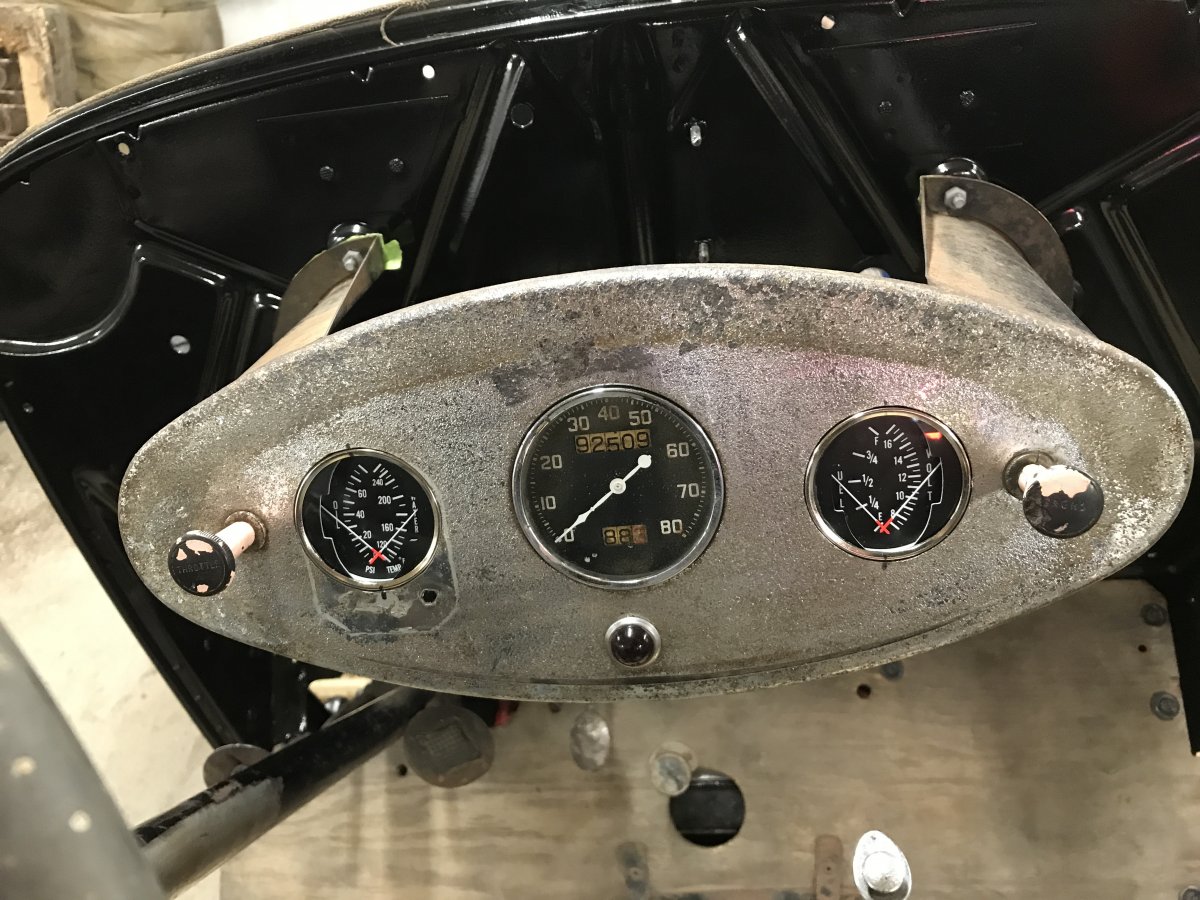

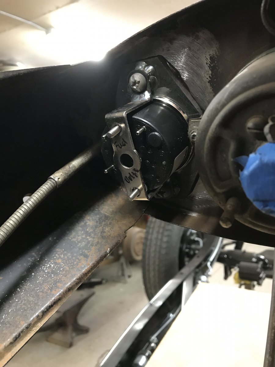

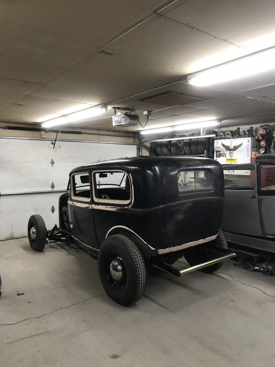

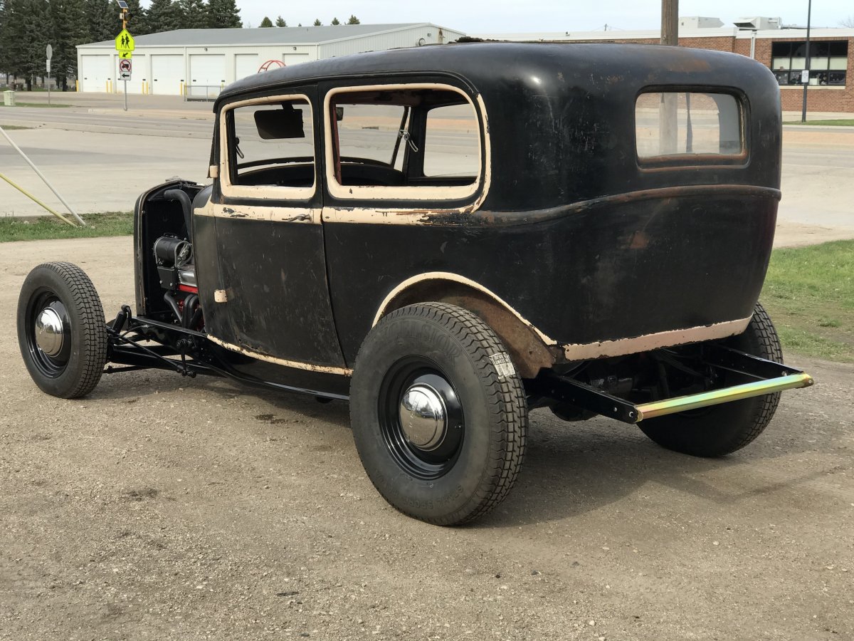

    I’ve been working on the car everyday for the last four weeks rebuilding carbs, bleeding brakes and doing all of the little stuff. We put the body on for the last time on Tuesday. That’s where I’m at currently.
