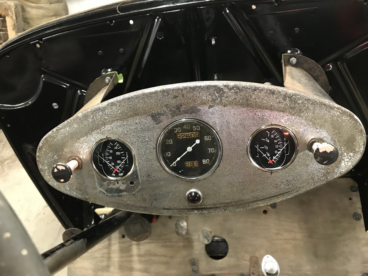

    If you don't mind me asking, where'd you get those new dual function gauges?

    ROBRAM the dual function gauges are from Westach. https://www.westach.com

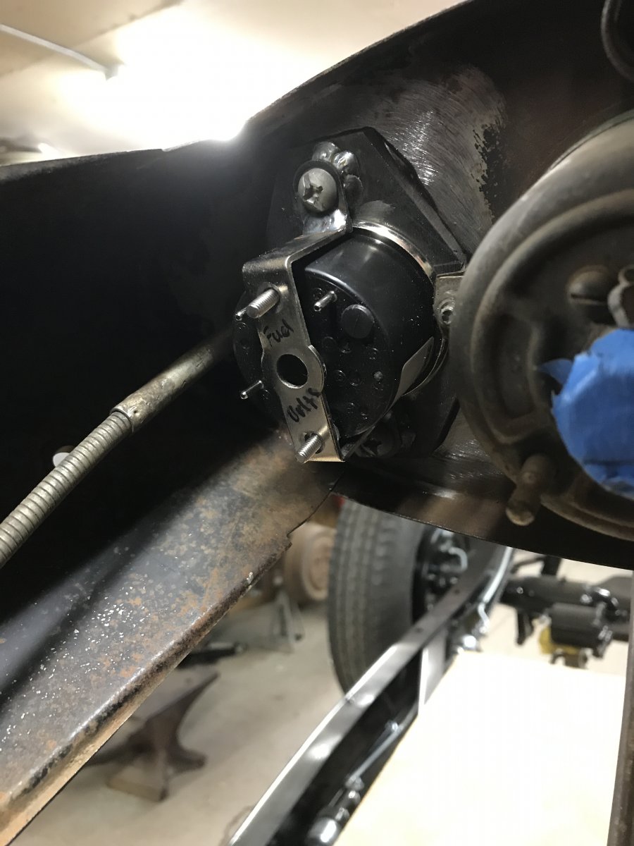

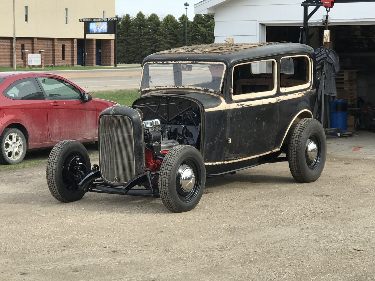

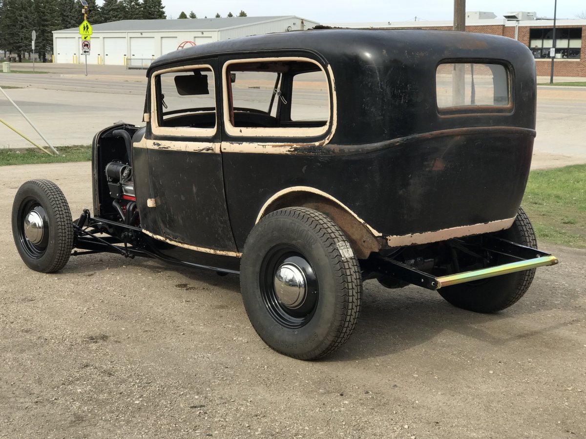

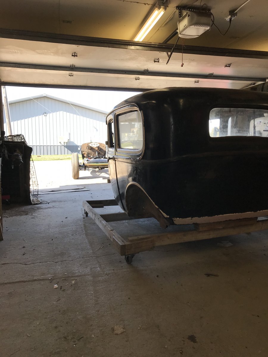

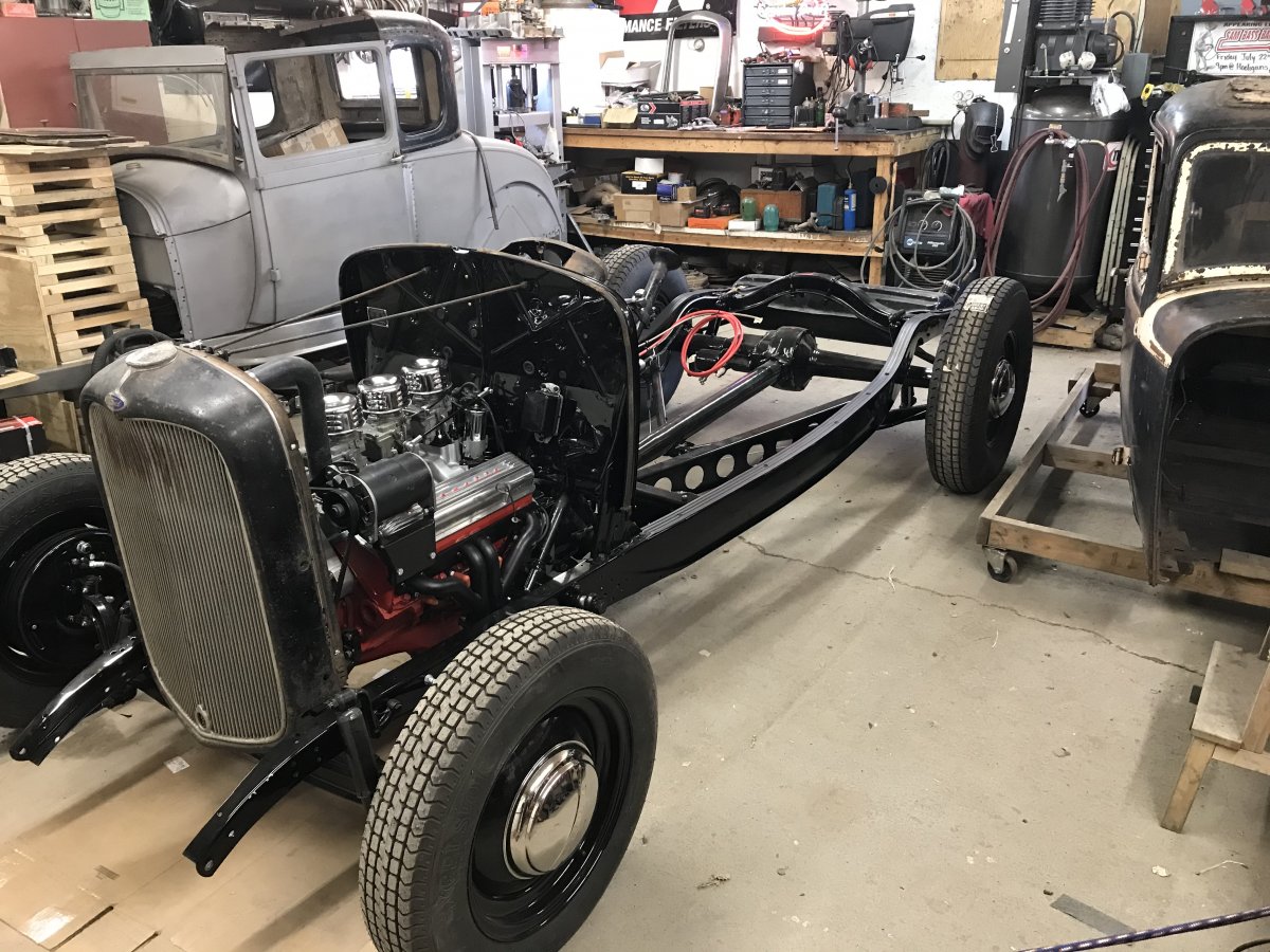

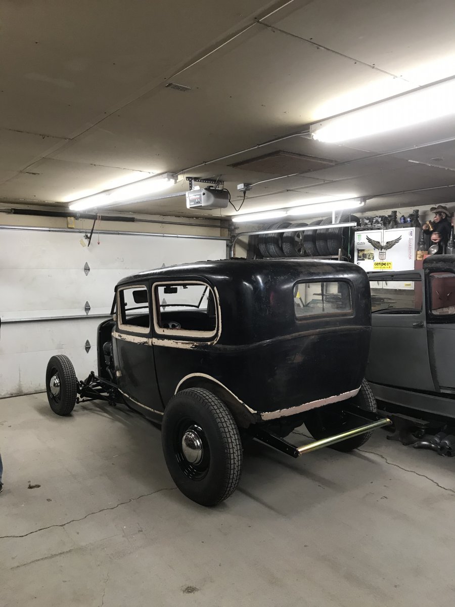

    I still working on this thing. It’s just about ready to fire. 7B5A422D-4686-4506-B50E-9977EA151CBD.jpeg 918C9673-D759-4537-817F-A14F496CED40.jpeg D79E112F-000A-4F56-A158-022F793858BE.jpeg 692A85F8-C4AF-478D-A102-479C71BB4833.jpeg F30D6333-1837-4E28-9E91-F5B4EF41C40E.jpeg CD385175-B716-41F6-8F16-F2953C1DDDE6.jpeg

    I enjoyed your build. Very nice workmanship. One thing comes to mind and that is your front motor mounts. I had issues years ago when i changed an engine for a guy that had the old Hurst mount that had the center removed because he put a larger balancer on. With that modification the engine movement loosened up the bolts and ate out the bolt holes We changed out the engine and added a piece back to tie the 2 outers together again. Solved the problem. Your mounts are beautiful and well made, but i would safety wire the bolts so they can not back out or tie them together to prevent the same thing happening. I am in no way knocking any of your workmanship, just saying what i saw on the engine swap i did on a 40 coupe. Nice work, will continue to follow

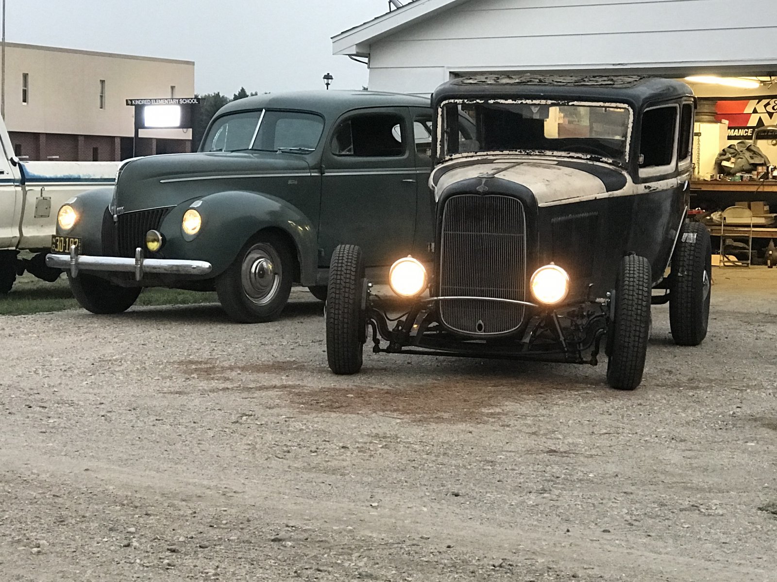

    from NoDak
    We got her fired up for the first time over the weekend.

    Thanks, everything on this car has been drilled and cotter pinned. Just like When it left the factory.

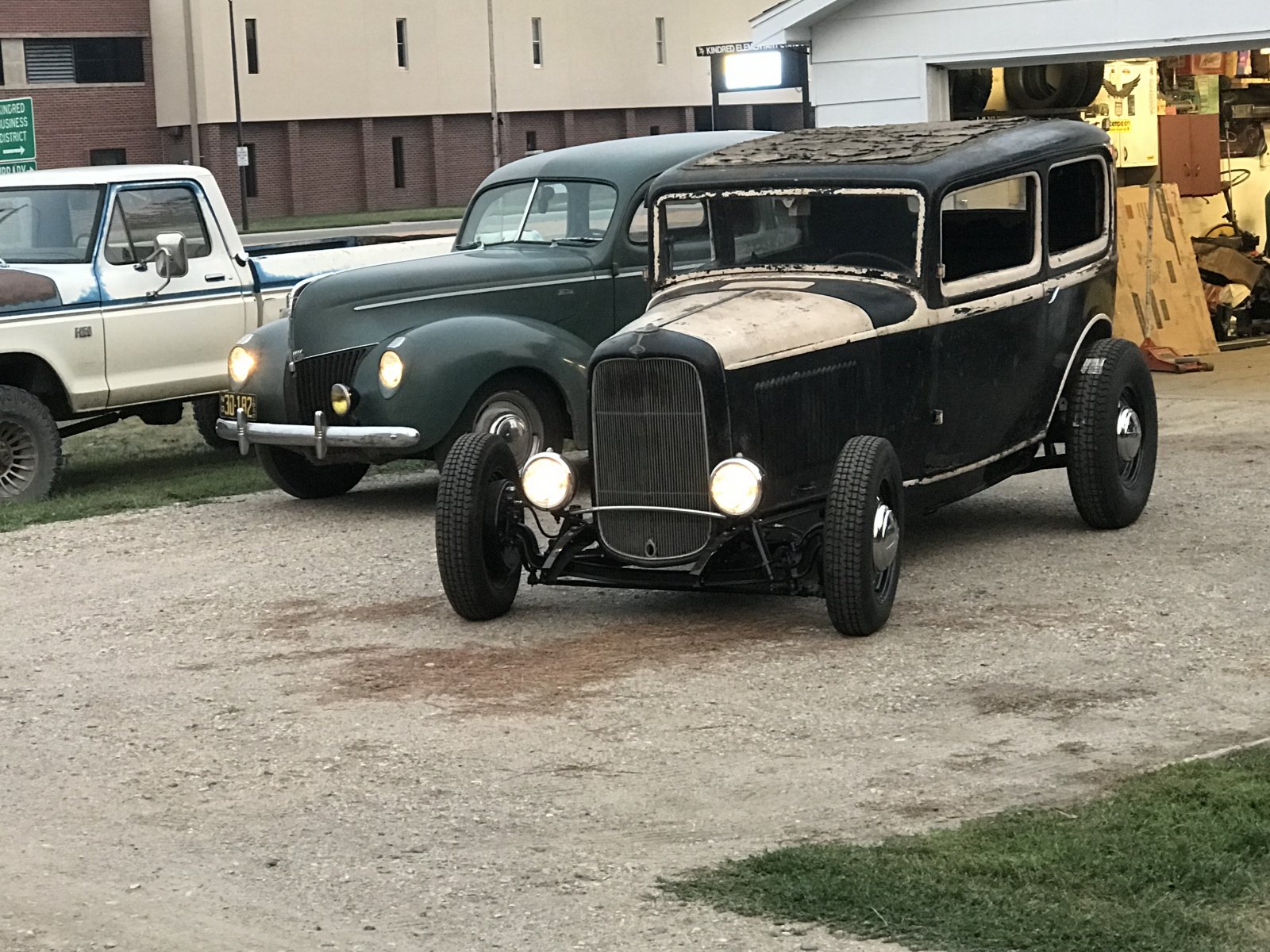

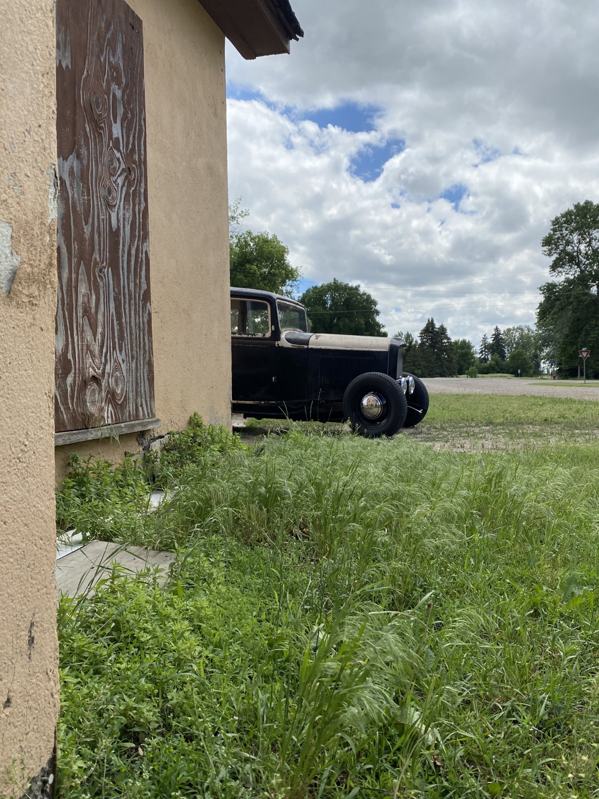

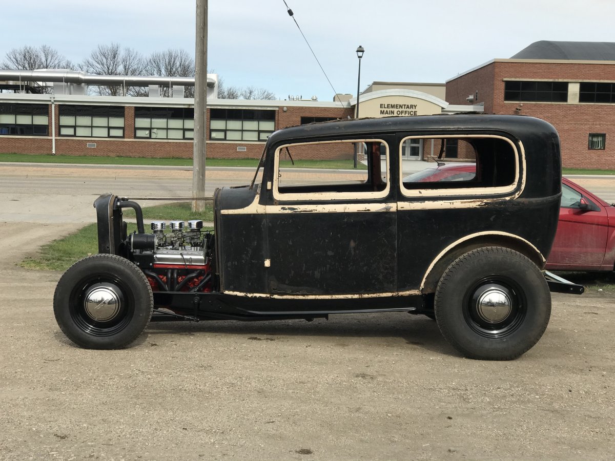

    Thanks everyone. She made the trip to Watertown, Sd a few weeks ago for the Vintiques car show. No major issues other then some exhaust rub. I did have to oil the leather seals in the Columbia canister when we got to Watertown. 91267F33-2926-4785-B530-8B229A9CF867.jpeg 8CBD2BE3-F227-4415-955C-65F72F9CC0D6.jpeg

    Just came across the build thread. Darn nice work Luke. One of these days I’ll have to see it … and the ‘40. Love them both.

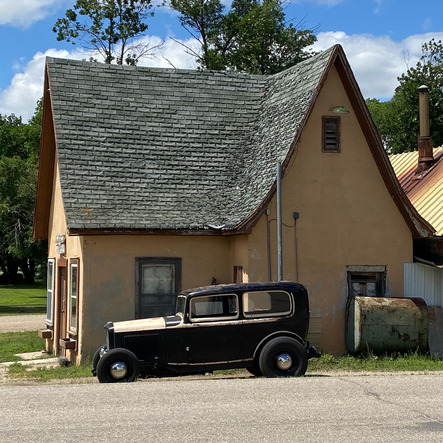

    02D2F357-3AA3-4F20-8FCA-F4F8B2230BF8.jpeg 57F7EFFF-26C7-4B95-B180-EEE4FBF66B8C.jpeg 0D5D6A27-FB4E-498D-9BC6-563EFE80ACDF.jpeg 334C17D4-09F3-4239-827A-D509C684EAD4.jpeg 02D2F357-3AA3-4F20-8FCA-F4F8B2230BF8.jpeg 57F7EFFF-26C7-4B95-B180-EEE4FBF66B8C.jpeg 0D5D6A27-FB4E-498D-9BC6-563EFE80ACDF.jpeg 334C17D4-09F3-4239-827A-D509C684EAD4.jpeg D659C533-08FF-4EE2-A2A4-C88DC6D3285D.jpeg Starting to get some miles on it now.
