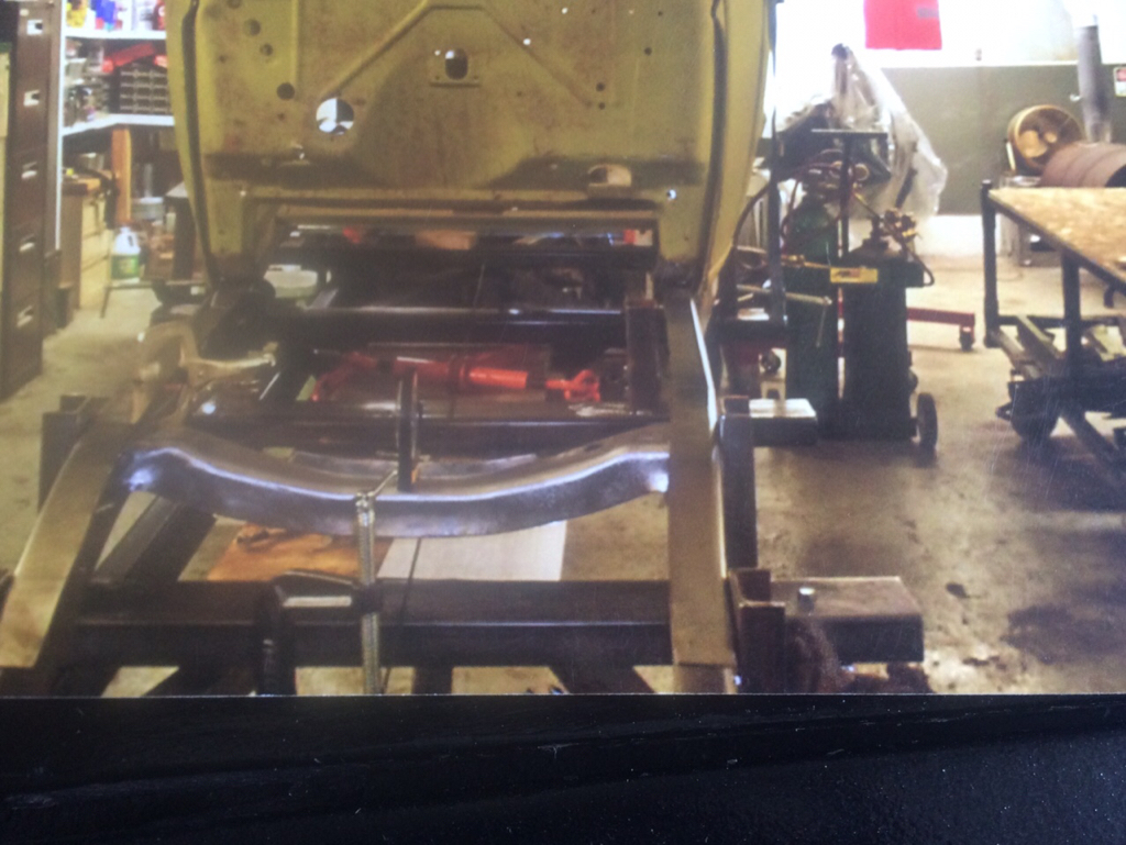

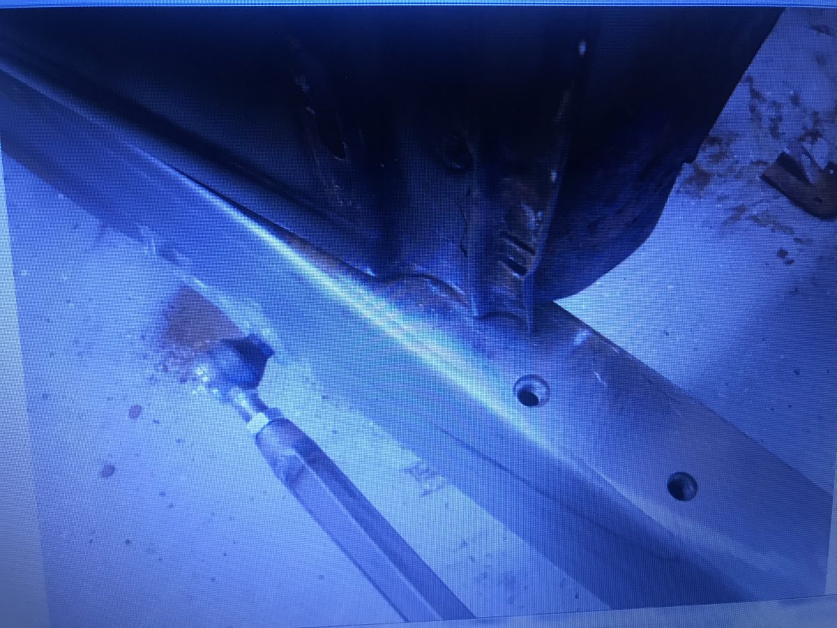

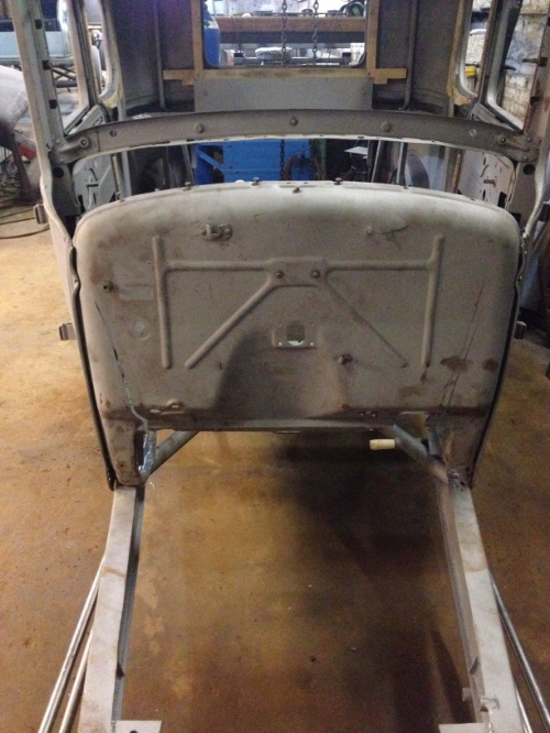

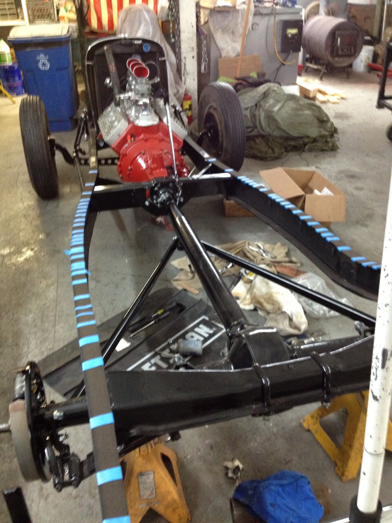

    I pinched my 32 frame to fit a 31 coupe body. Used chain tensioner, welded on a tab inside the frame and yes had to use heat. All this was done on a frame table. [​IMG]
    Pinch at the cowl was about inch and a quarter I think, then I pinched at the rear about 5/8” before the rear crossmember. The K member had to be narrowed but the rear crossmember did not.[​IMG]
    Second photo shows the chain tensioner set up, I only did one side at a time.
    At the cowl, because the pinch was coming in, it only required a slice top and bottom, which had to be filled after the pinch. Same with the rear.
    Right before the front crossmember
    I had to put V notches to allow the frame to move together.
    deluxester and Hyoctane95 like this.

    Thanks Ralph... I did the same thing with welding in a tab and pulling the frame in, but I made the mistake of not cutting relief cuts in the frame like you did. I also failed to pull in each side one at a time like you mentioned. I heated the frame up but it was so hot that I stretched the boxing plates on the inside. Just trying to get some opinions on how folks are doing these pinches. I think the frame I have now is trashed and won’t to do it right the next go around.
    Did you leave the rear crossmember in place while pulling in the rails on the back?
    When you pulled in one side at a time, did you have an anchor point of some sort welded to the table to pull against? Thank you sir! Adam.

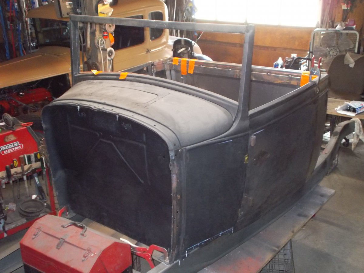

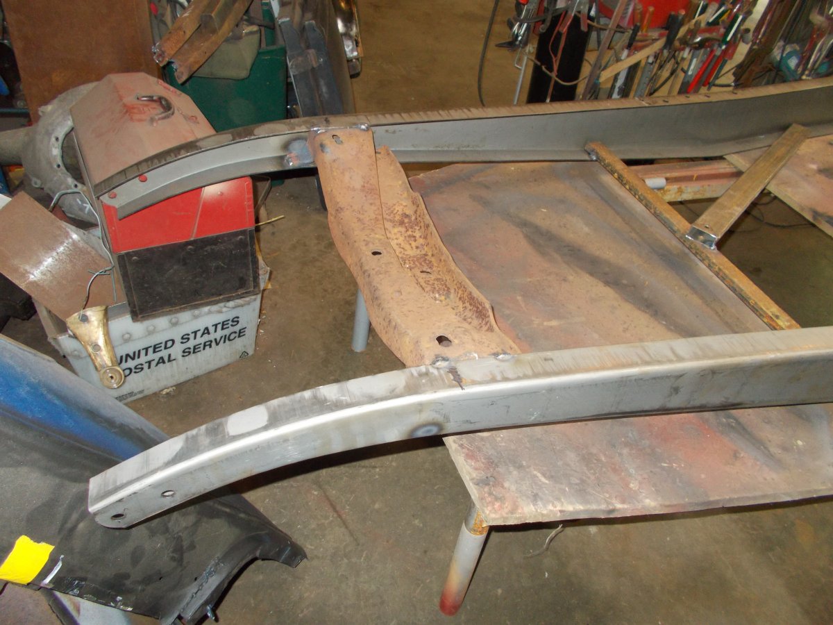

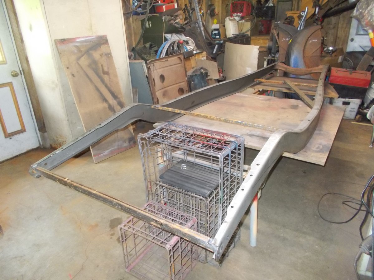

    Ran a '28 truck front crossmember [thicker], then pulled the rear in about 1/2"... this brought the 2 cowl body bolts on top of the '32 rails.. the offsets for the hood are on top of the rails, but the skins are outside, I will run a stock hood...
    I also installed the front crossmember back 1.25" [half the difference in wheelbases]..
    this and the reversed firewall lets me run the stock hood...
    just something to think about...

    Yes definitely anchored to the frame table and only pull one side at a time. Take lots of measurements before and after. No I did not have to do anything to the rear crossmember.
    Let me also state that I originally was going to build a fibergl*** 32, so the frame was completely set up for a 32 body. Then I found a good 31 steel body and that’s why I changed everything.

    hey h95,
    I never had one... using rectangular tubing to connect my coilovers and panhard…
    the '32 rails were 42.125" at the bolt hole before the kick up... after i tacked the rails into a perimeter frame...with what I did I had to trim 3/8" from each upper rail to bolt the TANKS '32 tank between the '32 rails... because I am running a stock '31 hood I needed to run the A's 103" wheelbase... so I split the 2.5" difference and moved the front crossmember rearward 1.25" and the rearend will move 1.25" forward....
    perimeter frame.

    Did not cut the rails... set them up so they work with my '30 cowl,
    this is where they ended up...
    outside to outside of the rails ;
    42.125" at the cab back...
    39.250" at the apex...
    39. 5" at the tail...HIH.
