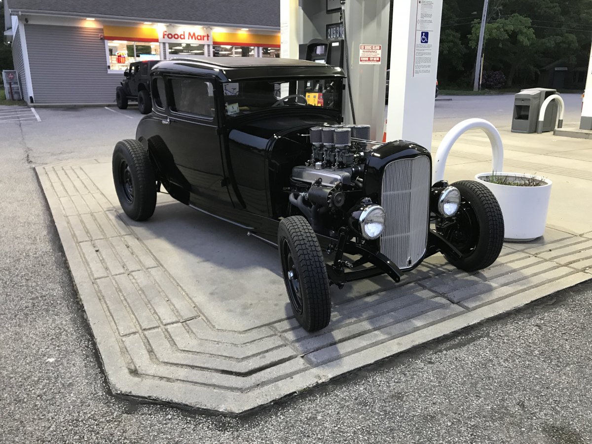

    This picture shows it pretty well, there is no pinching or bending these are stock contour rails. I narrowed the rear enough that when the back of the frame kicks up it was inside the wheel well. Front was narrowed as well till I thought it looked good. 5A7E06F3-83FC-42BF-B431-5954E070CDD9.jpeg

    @51box could you share a pic of the wheel well area please

    Damn 51box, that car looks awesome! Holy ****. So all you did was narrow the front and rear crossmembers and doing that tucked in the frame rail where it kicks up in the back and where it sticks out at the cowl. I wish I knew that a few years ago. Did you mini channel the body to tuck the frame up in the subrail? I’ve alredy done that so I’m curious if that changes anything. I need to go in about 1” total on the rear to **** the frame up in the body...that sound about right? Same for the front. I’m going to go the cardboard template route with the body to check the contour of the frame.

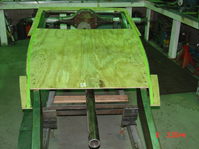

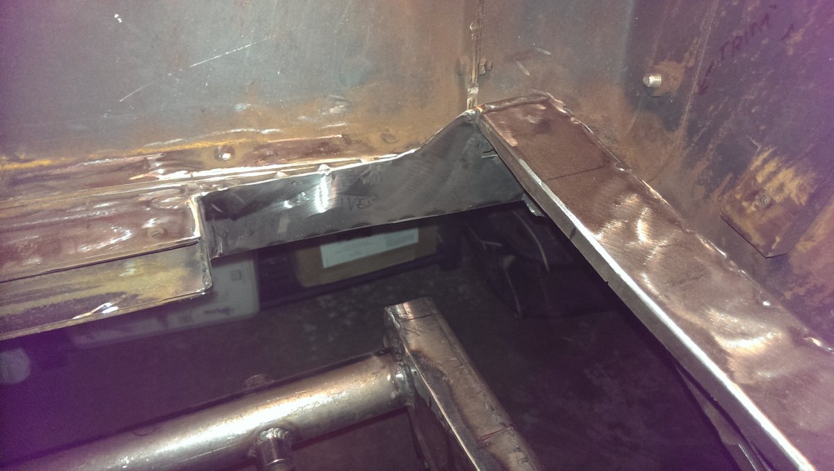

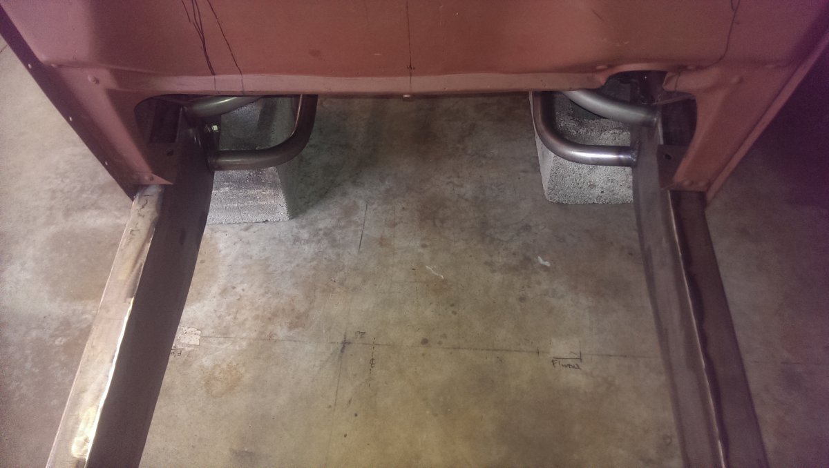

    On my '28 Tudor/'32 frame marathon project:
    1) I made a plywood template of the body's lower edge; @oj welded the rails & x-members to match its contours perfectly.
    2) At the firewall, the body's stock wood blocks are removed & lower feet cut off, so the body rests on the top feet.
    3) In back, I cut off the rear frame horns just aft of the rear x-member, then fabbed up new 16 ga. subrails that follow the frame contours.
    Hope this helps.:)
