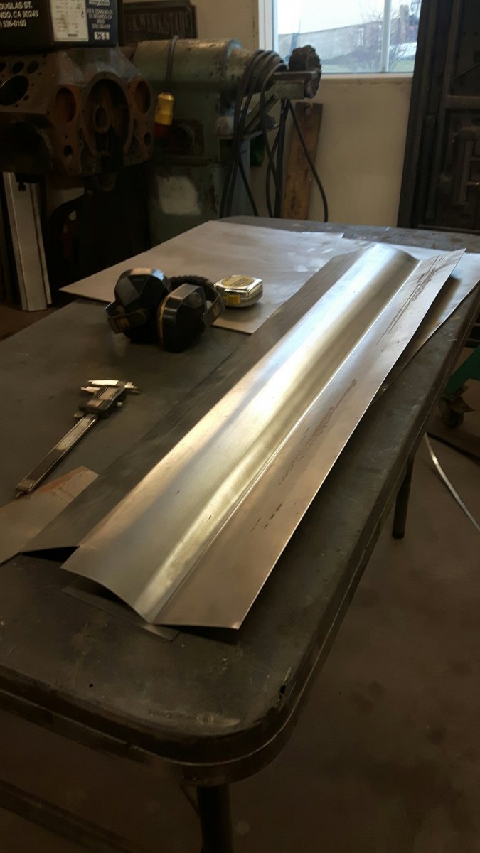

    Monday boxing plates made and welded .
    Pullmax 5 with shrink dies is good machine.
    Aulis

    Tuesday englishwheel and beadroller jobs.
    Aulis

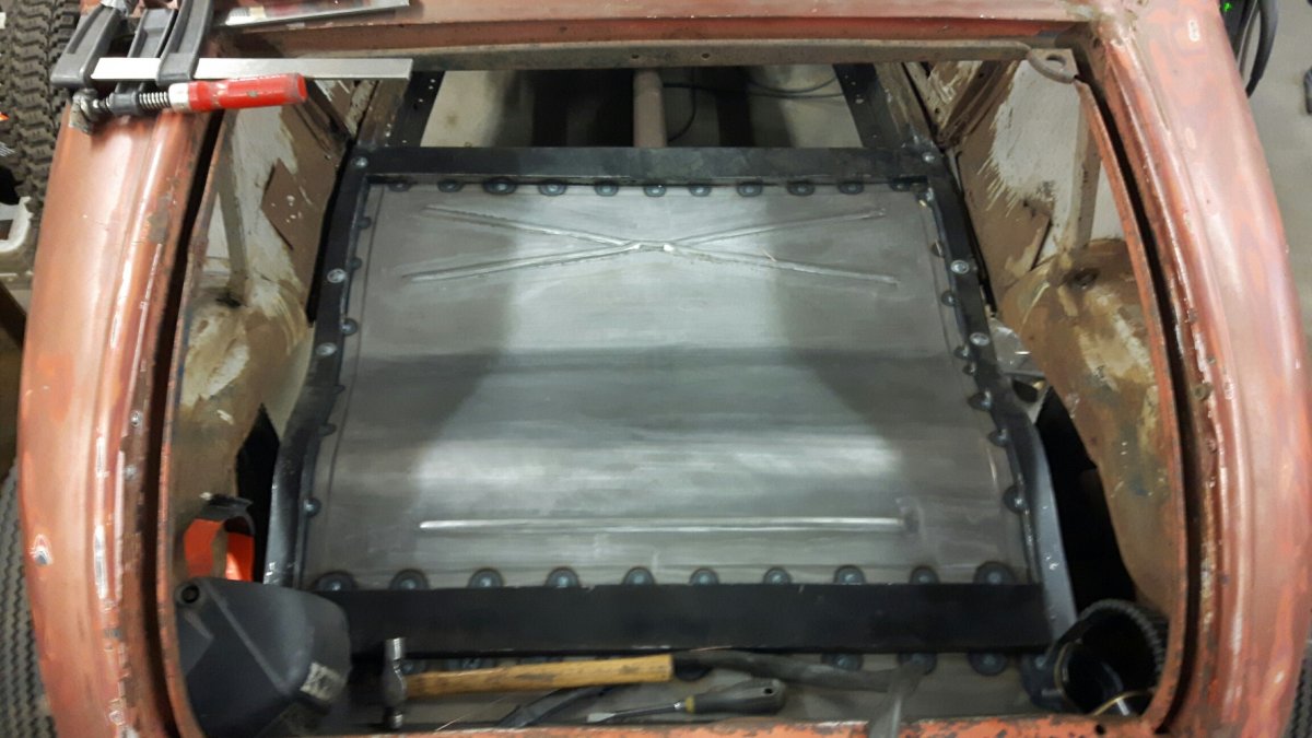

    What gauge sheet metal are you using for the floor?
    Stogy likes this.
  10. AULIZ
    Joined: Oct 28, 2005
    Posts: 1,665
    AULIZ
    Regular 1mm finnish made steel. Lowprice and good quality.
    1.25mm would be maybe better, but its so heavy. stuff... and I have tune my pullmax shrink dies for this 1mm sheet metal.

    Those floors look so much nicer than the store bought ones with all the XXX over them. Brilliant work . Though i probably would have chosen 1.2mm to even 1.6mm for the floor. 1.6 may be overkill and harder to work . The floor is structural .
  19. AULIZ
    Posts: 1,665
    AULIZ
    Hello
    You´re right. Floor material thickness can be more. I left front side of floor (X) up. I mean I didn´t stretch those bendings , bending bottoms so much as need, if You want that floo is straight. Now it´s little more up side, but I wan walk there and its not flexible at all.
