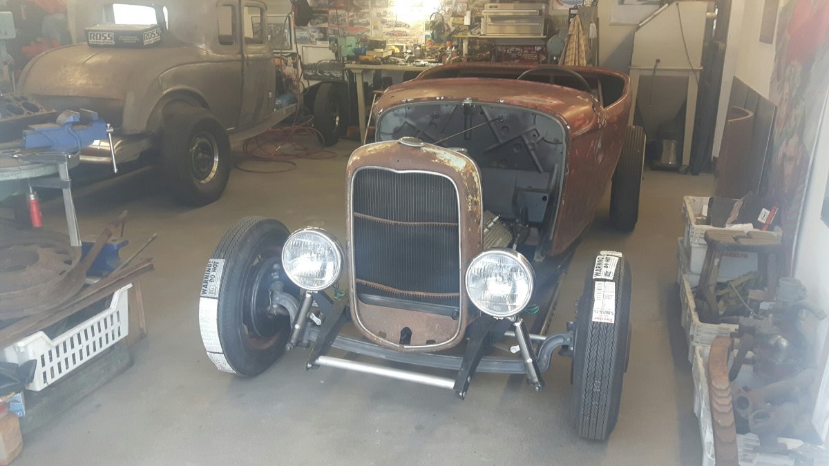

    jukka-230.jpg Column ready. Not too "new outlook" ?

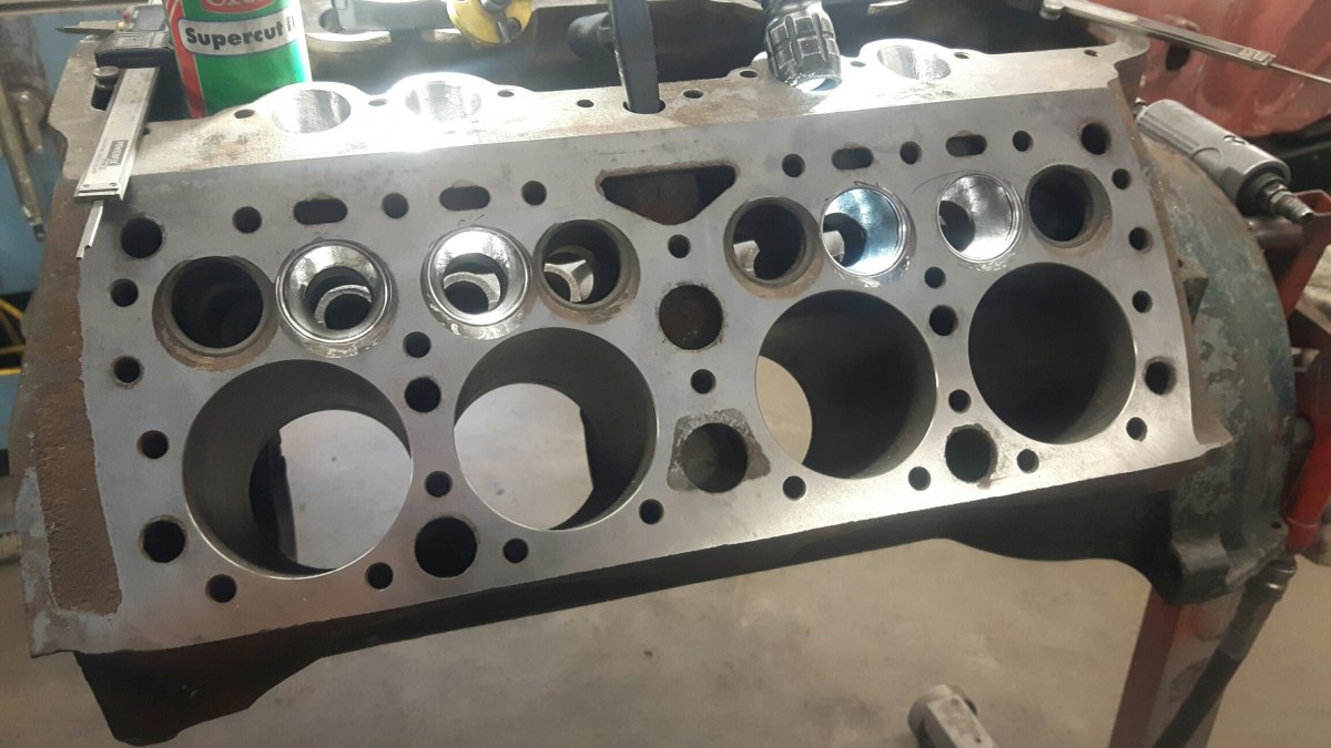

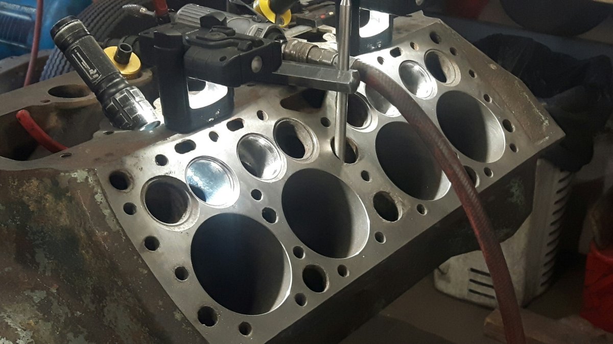

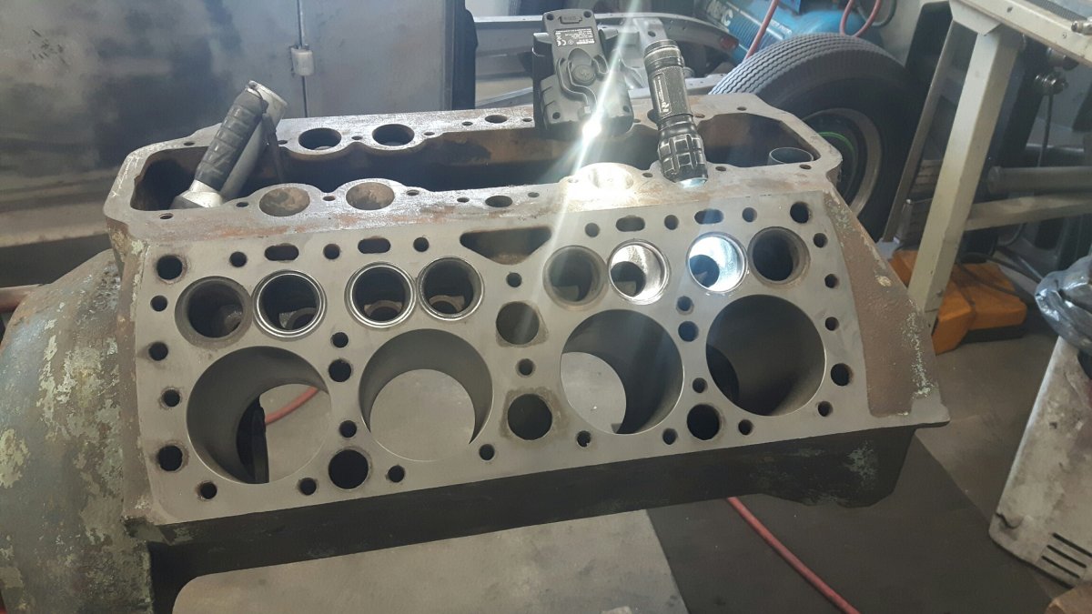

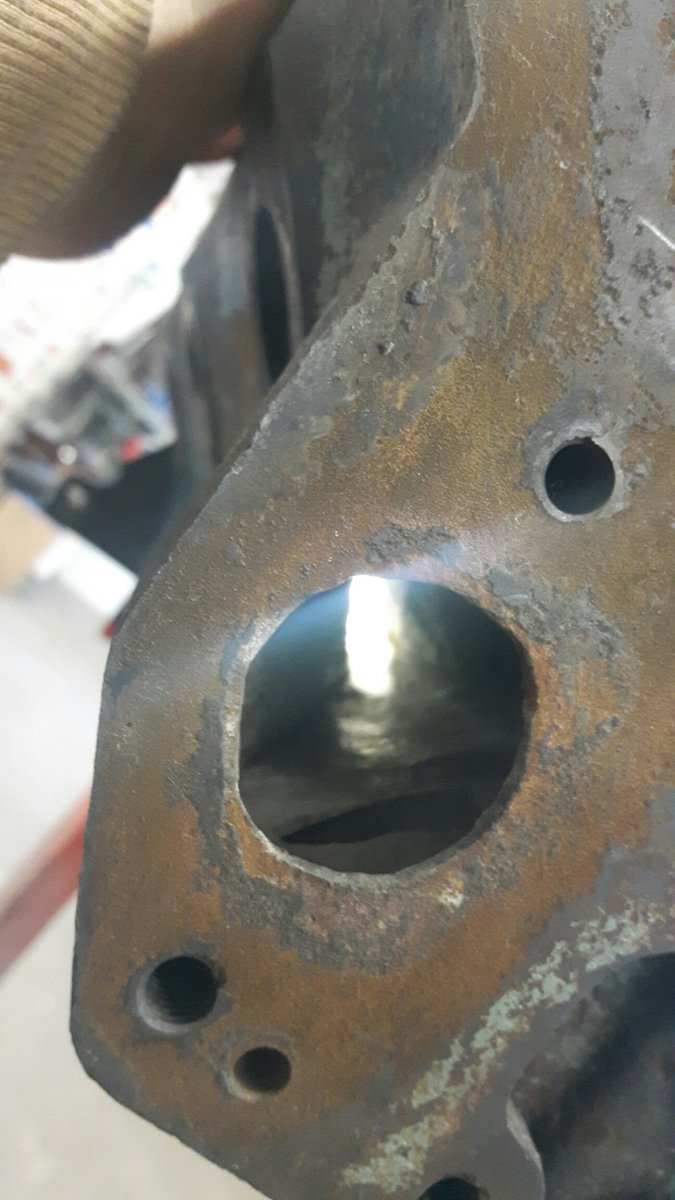

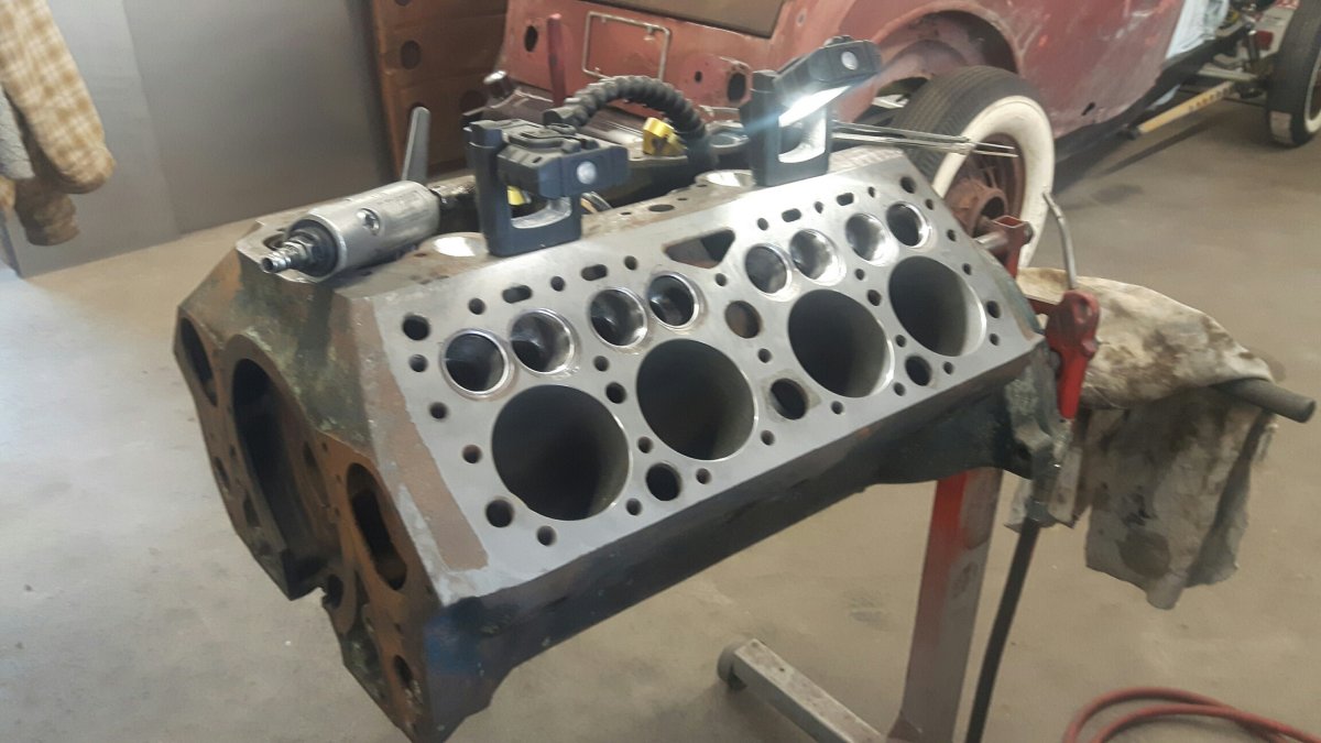

    Now I leave this hot rod project two weeks. While I built flathead engine ready. Many weeks ago I bore&hone cylinderblock. This week need to port intake runners (4mm) also need to open ex runners. Valves will be manley pro flo 1.60" in and 1.50" ex. jukka-232.jpg jukka-233.jpg jukka-234.jpg

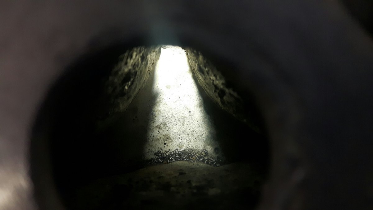

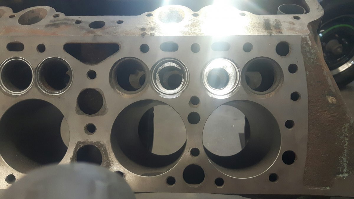

    3hours per In runner.

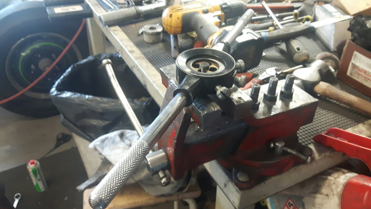

    Old and new valveseat tools. Old US set (small), old UK set (big) and new valve seat cutting tools , neway. 70dec. 60dec. 46dec and 30dec.
    Aulis

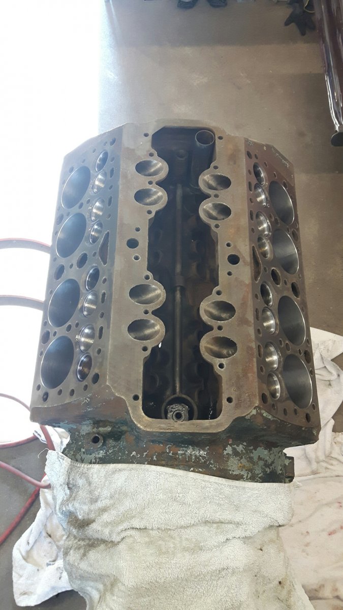

    30-40hours porting + valveseat jobs. Now block is washed and oiled.

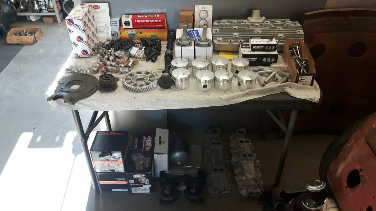

    Next week I need to put it together with new parts. (Navarro intake, Navarro heads, SU1 cam, stroke kit with ross pistons and H-beam rods, auliz -oilpan, pro flo valves (1.65/1.50), 2 x97, stromberg distributor....
    1-2kg iron on floor before I cleaned it.

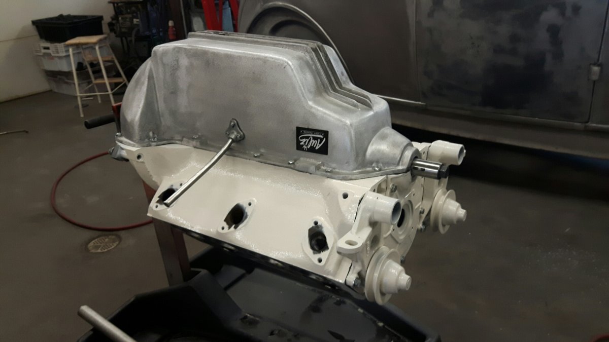

    Oilpan ready.
    Tomorrow 12.3.2020 Radiator hoses are here. Those are delay 4weeks. Maybe 15 shipment send tomorrow all over The Ball. If You need Upper or lower hoses, send email: auliz@kotinet.com

    Cool Auliz oilpan. Did you cast it yourself?

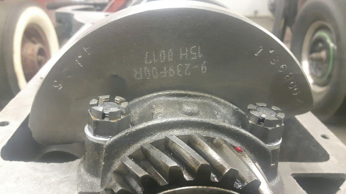

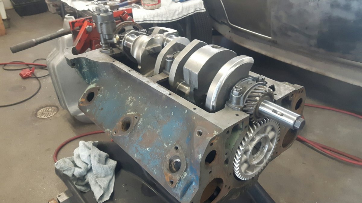

    Yes, I have made few (8-10pc) flathead oilpan. 2pc I have polished. Those are my own engines (21bolt twin spark plug engine and 284cid Italmeccanica engine). One was bolted on McCulloch roadster. I sold that car to Sweden on December.

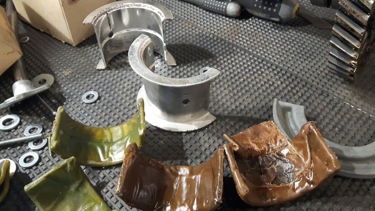

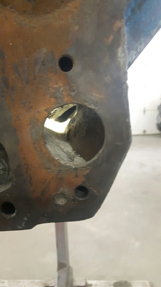

    Today installed cambearings, cam and crank. Now a days those cam bearings are mostly shit. Everytime one or two of those cam bearings are not right dimension. 1st bearing was too tight after installation and cam stuck. I need to use reamer. Now works good.

    Curious about the use of studs securing the outer main bearing caps and bolts being used for the inner bearing cap. I've only rebuilt the lower end of a few engines, so I'm asking as a newbie and willing to listen and learn.
  15. AULIZ
    Joined: Oct 28, 2005
    Posts: 1,718
    AULIZ
    hmmm.... "my only trick is no any tricks". When I piece this "59" engine, bolts were like they are now. I do not have any extra stud bolts, but I think its OK to use ARP grease (threads) and use those normal mainbolts with center cup. 80lbs ends, 90lbs center. I don´t know is it good idea to use little higher torque if You have UNC thread like normal mainbolts have...
    I have done like that, but there is as many ways to do things as we have engine rebuilders...
    My Alum. oilpan (2kg heavier than original steel) is very strong casting, so I do not use any oilpan gaskets. I hope oilpan is also make engine stronger.... never know.

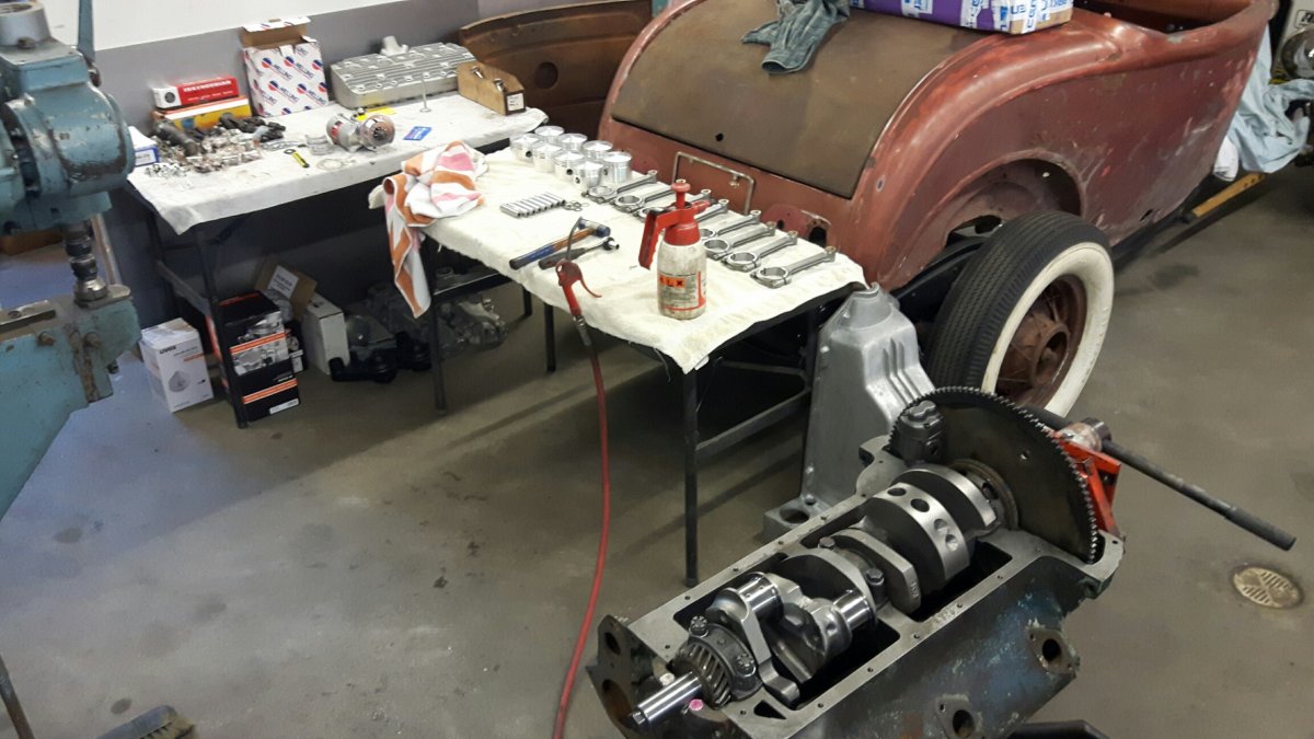

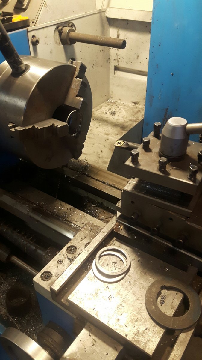

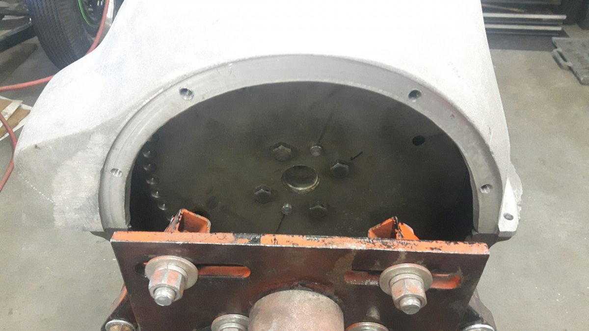

    Slowly (too slowly) engine project is foward. I have worked all Saturday with this project, not so much ready... I made new flexplate/flywheel quides, shorted flywheel bolts, because now I use those with flexplate. Tranny will be C4, ford. Also bored one extra hole to oilpan side. Now can install torque converter afterward.
    Tomorrow must get shortblock ready. Valves need to cut (-0.1") before installation....
    Aulis

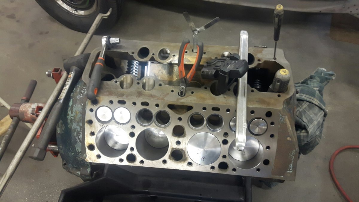

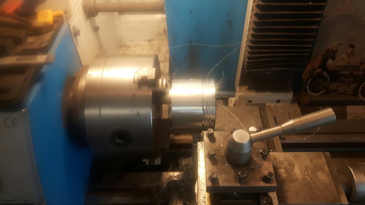

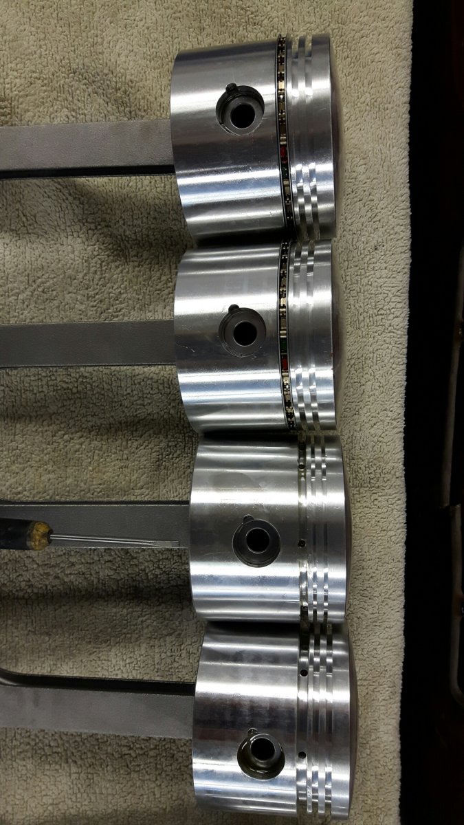

    Pistons,Rods & Rings installed. Ross pistons were packed wrong. One piston has different number and...... I worked today 3-4hours with that piston. Now ring grooves are same than other piston.
    I do not know who is pay my salary, but sure I send email to H&H Flatheads and Ross pistons. Hard and long Sunday.....
    5cylinder valves are installed. I have shorted all Pro Flo Manley valves (- 2,5mm / 0.10"). Not want to adjust lifter screws too deep. Those do not feel so thight if screw has turned lower.... (You understand what I mean).

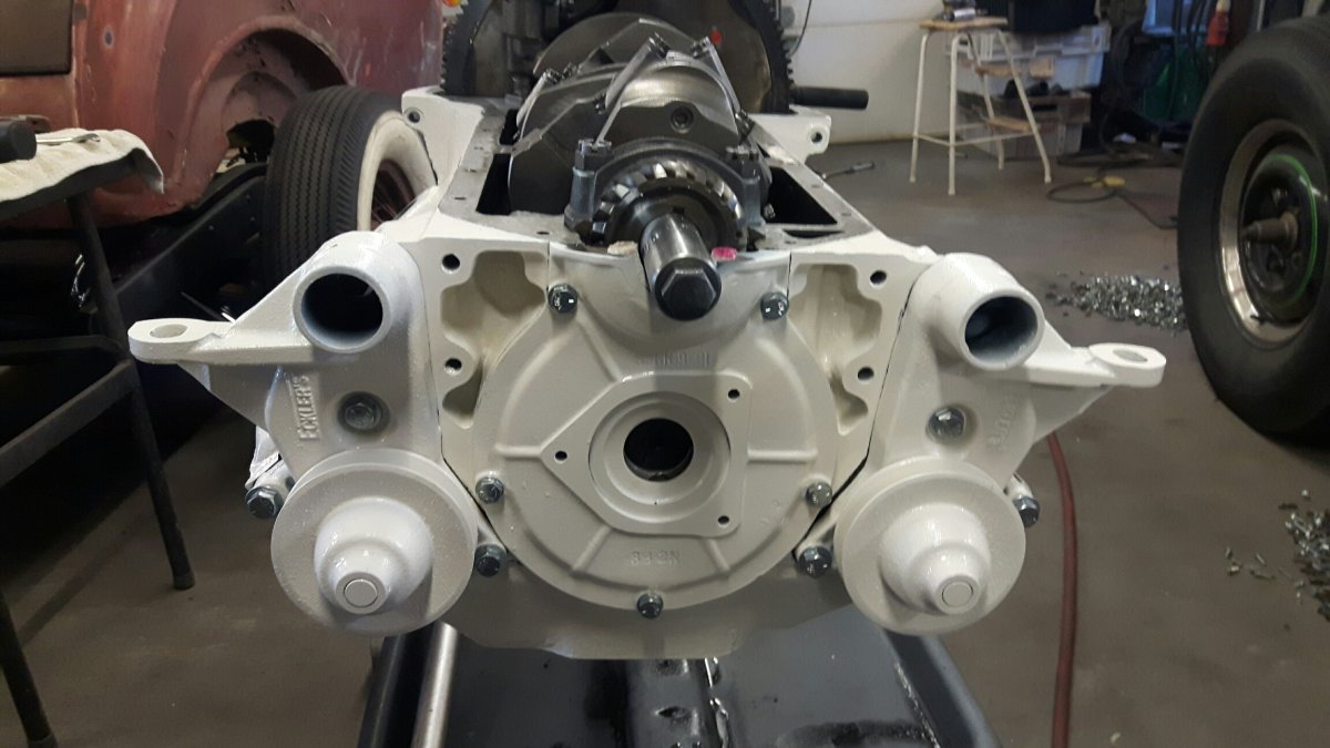

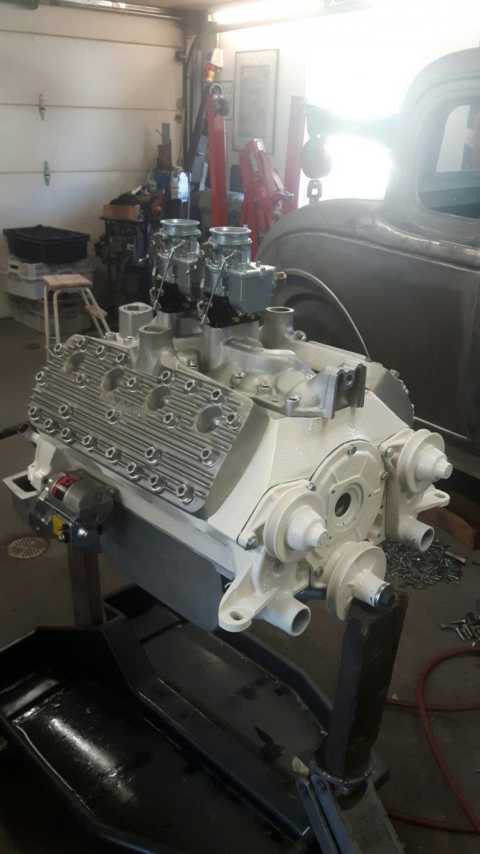

    Painted. Oilpump pick up welded.
    Waterpumps + timing cover bolted on.

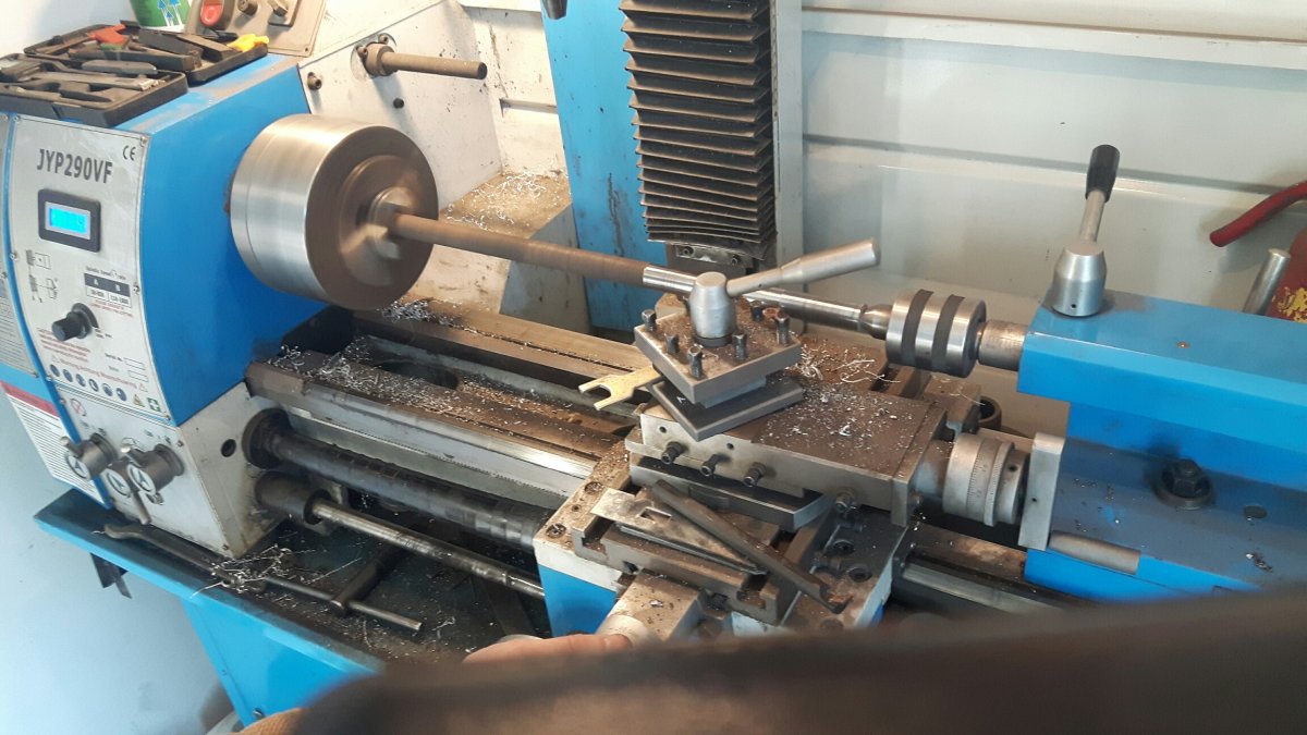

    Today I lathe crank v-belt pulley and also painted it.
    Tomorrow need to mark timing marks (TDC, 20dec, 25dec advance) after installed pulley.
    After that I can continue in "upstairs" (heads, intake, carbs, fuel lines....)

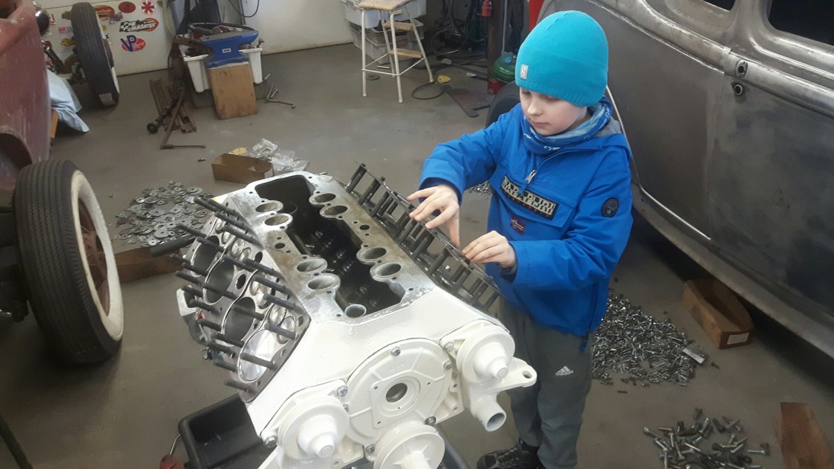

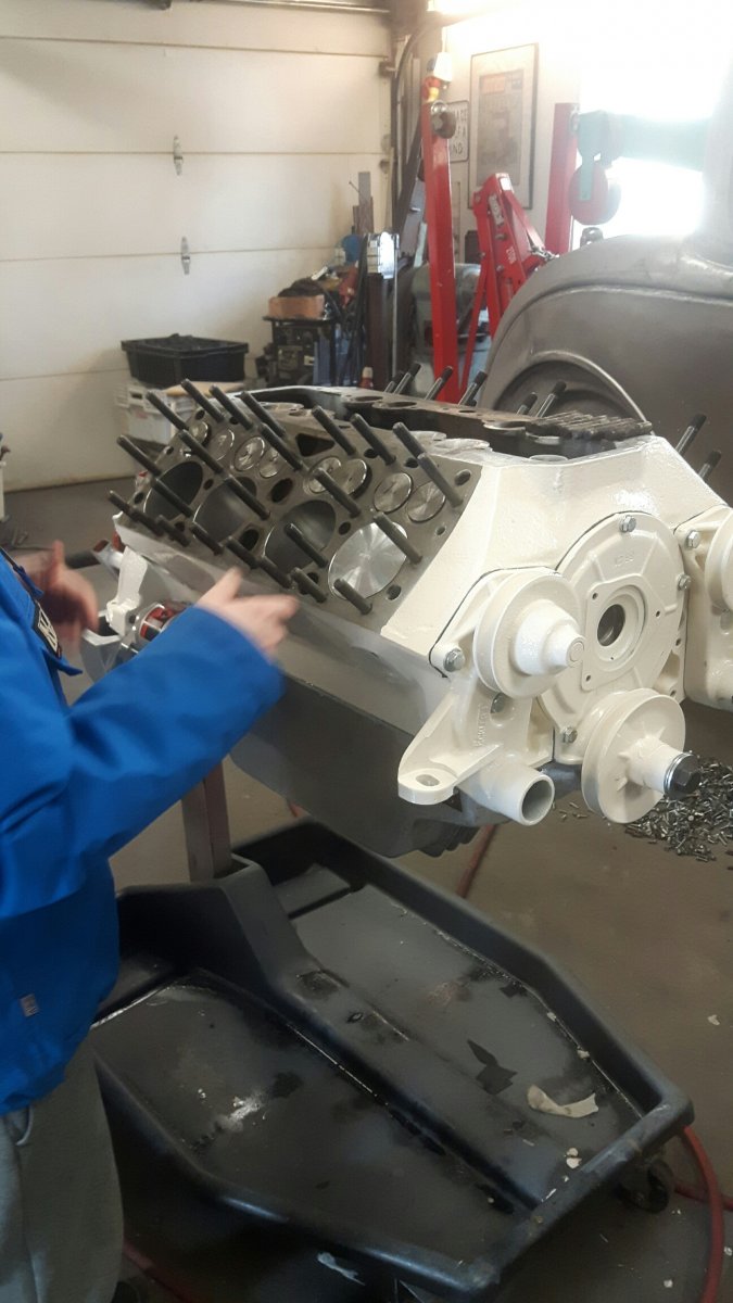

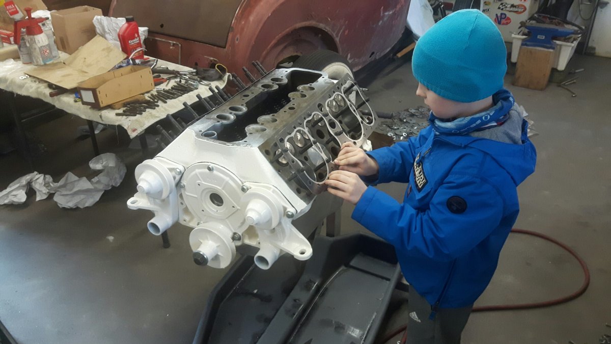

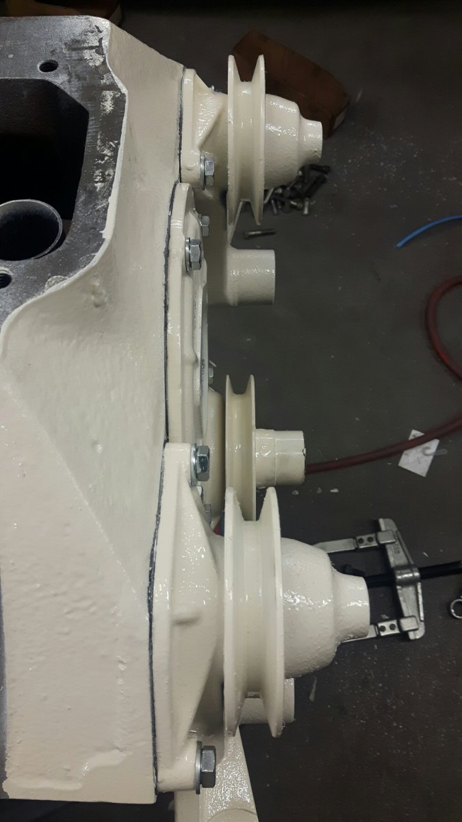

    Oskar son is now studying home (COV-19). While he is play football outside and while help dad with headstuds and big bore gaskets.
    First thing in the morning I made few washer. Crank pulley need to shim same line with waterpump pulleys.
    aulis
    flathead-64.jpg flathead-65.jpg flathead-66.jpg flathead-67.jpg flathead-68.jpg flathead-69.jpg flathead-70.jpg
