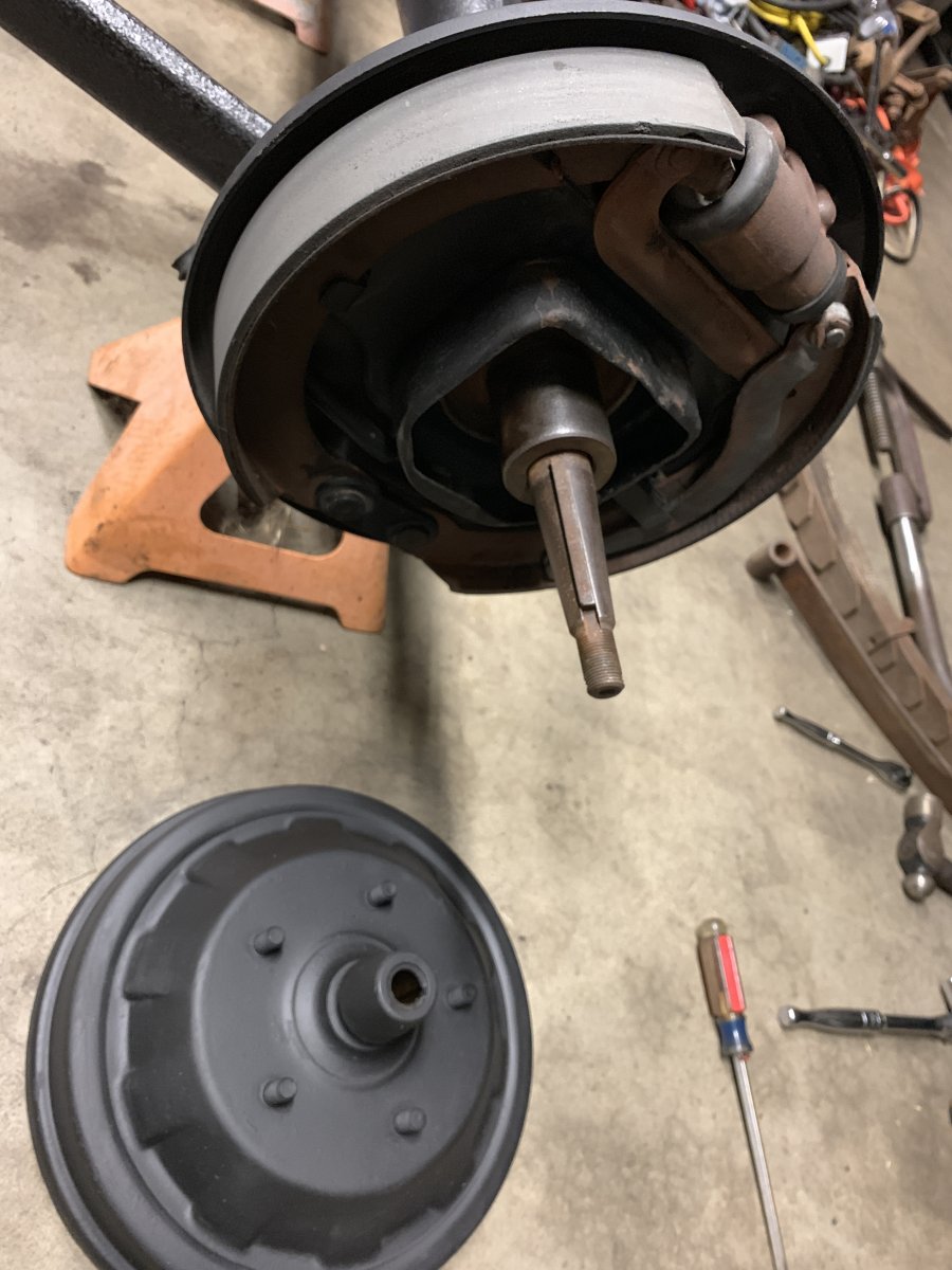

    ***embled new brake hardware on the rear axle. Used ‘40 type backing plates and drums for the conversion to hydraulic. Getting late so this is where I stop tonight.. I’ll start again on it this weekend.

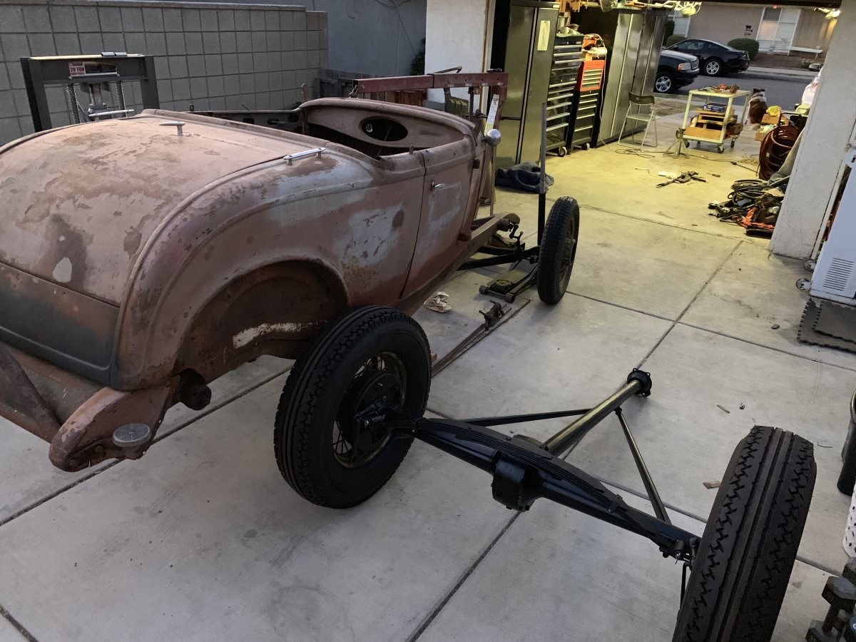

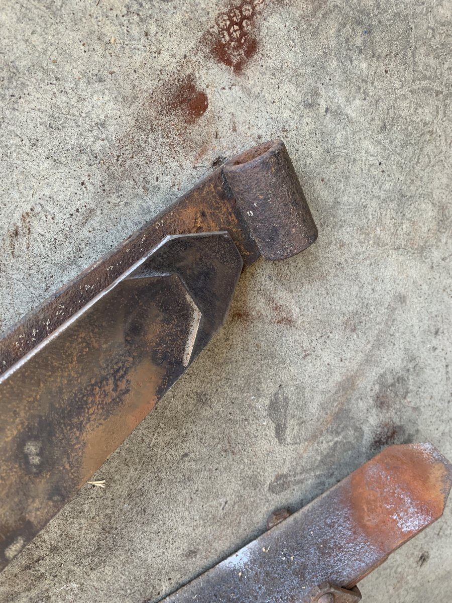

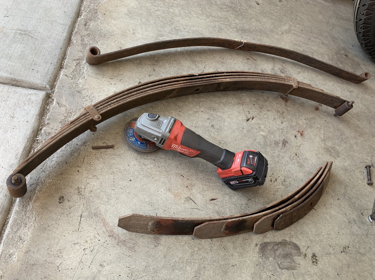

  5. deluxester
    Joined: Mar 14, 2004
    Posts: 478
    deluxester
    5791A356-D708-4123-BD5A-8E5E260F0576.jpeg 92168F64-302A-46E0-B6D6-5B9551BFB9EE.jpeg 7B7AF966-5848-4FA0-BC7B-B7263AB4953F.jpeg
    I dis***embled the rear leaf spring pack to clean, paint and install the reversed eye main. Leaf no.2 was shortened to fit within the reversed eyelets.

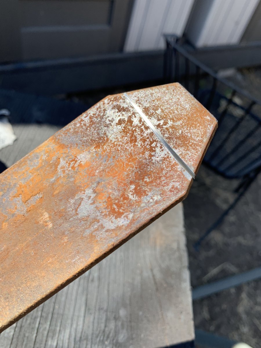

  7. deluxester
    Posts: 478
    deluxester
    F44FFDAA-2D7C-4DE0-B9AA-1A1D3DEE7EBD.jpeg 43DDFAF8-8C97-4653-8144-8B528D606101.jpeg 0F1BAAA0-4954-4366-B035-5062B9CAE70D.jpeg
    I installed new bushings in the reversed main leaf. Also painted, greased and ***embled the leaf stack today. I had to shorten the two clamps as I removed leaf number four from the bottom. Curious to see how the changes will impact the lowered stance.

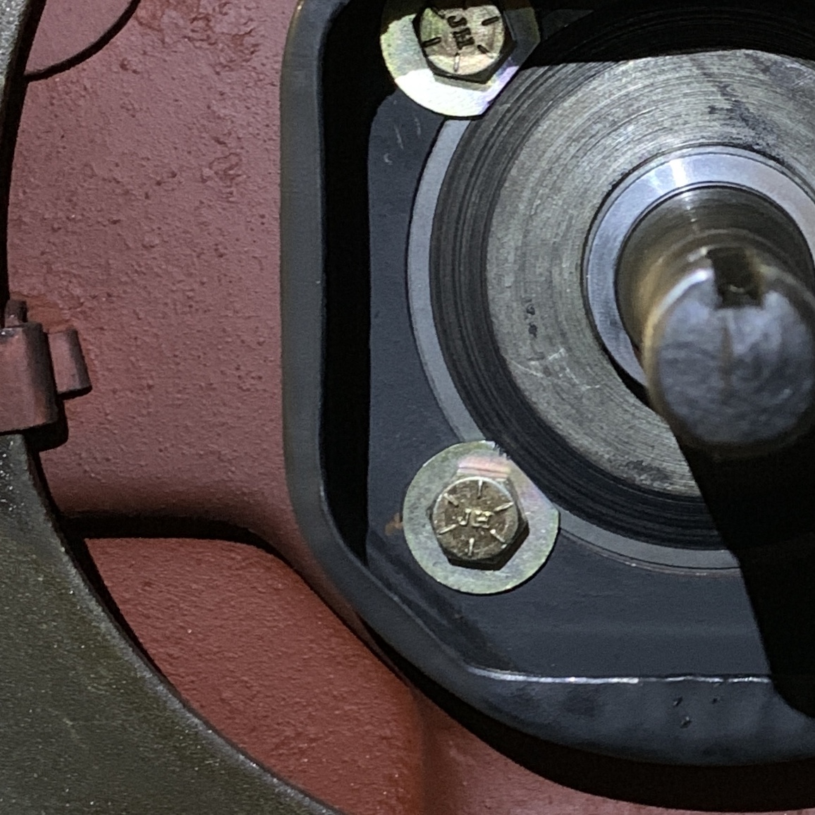

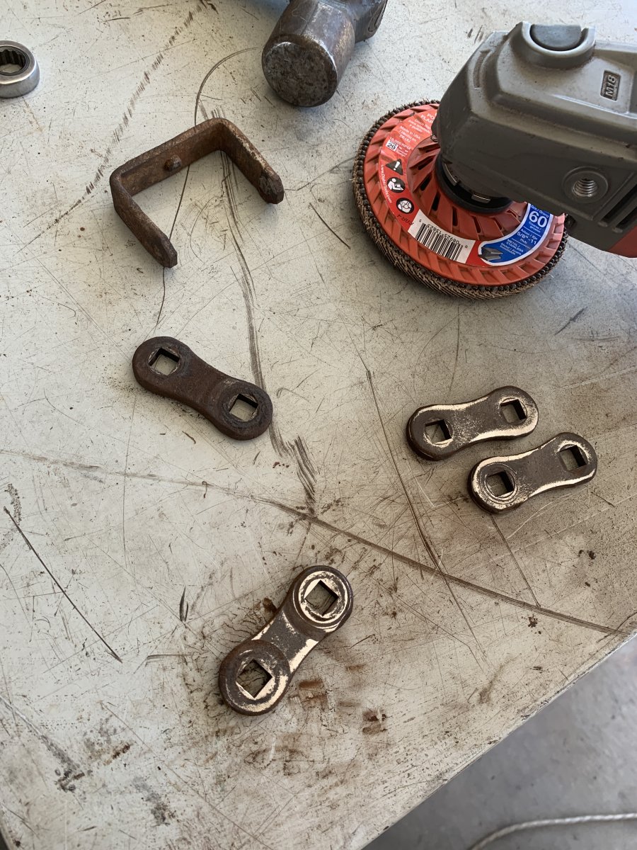

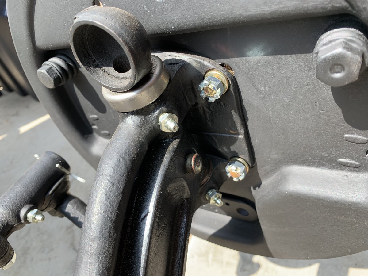

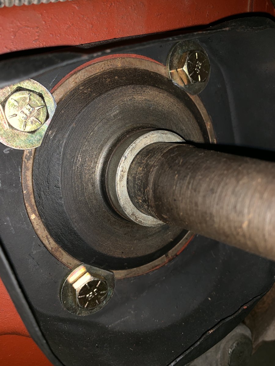

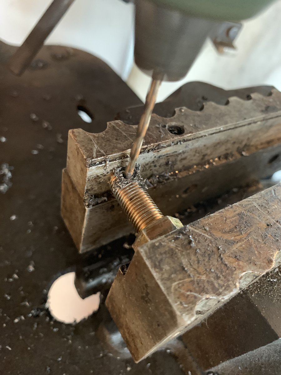

    4D88A434-D06E-4423-AAB7-EAF512FCC06D.jpeg B9351308-BC6A-4102-AE54-8A4C0CF95FAC.jpeg FA69AFD1-FEDF-4DF9-B9AF-A928DAB82765.jpeg I learned that 1932 spindles will not bolt directly to a 1940 backing plate. I purchased adapter rings and also notched the backing plates to accommodate the smaller bolt pattern on the spindles.
  17. deluxester
    Posts: 478
    deluxester
    Loosely bolted together here, but I’m not sure I like the look of the notches sticking out from behind the spindle flange.
  18. deluxester
    Posts: 478
    deluxester

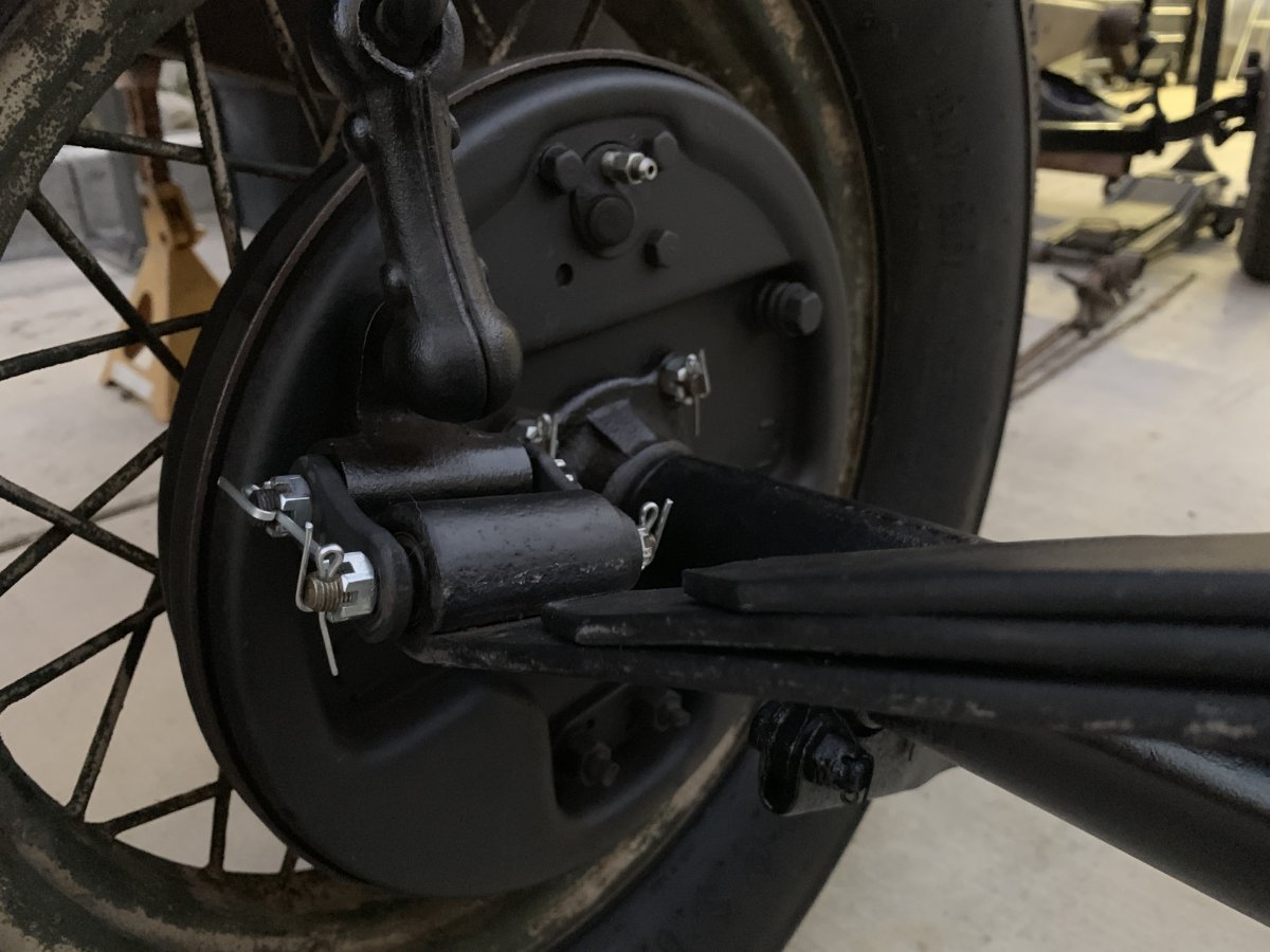

    I drilled the backing plate bolts for cotters, cut some washers to fit around the spindle center, and ***embled the front brakes finally.

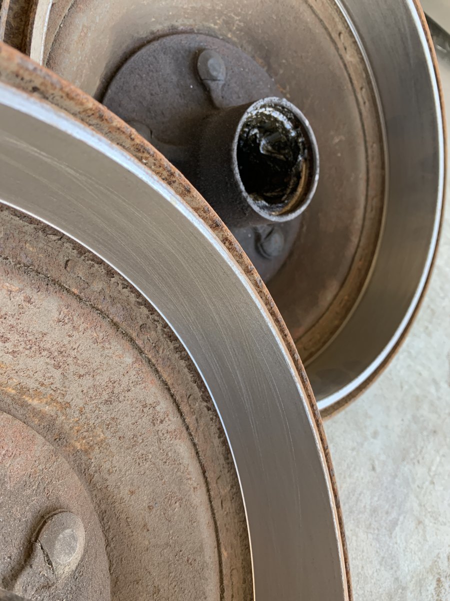

    @HellsHotRods turned the front drums down for me. Its hard to find a modern brake shop capable of mounting early Ford drums on their equipment. Thanks Dave!

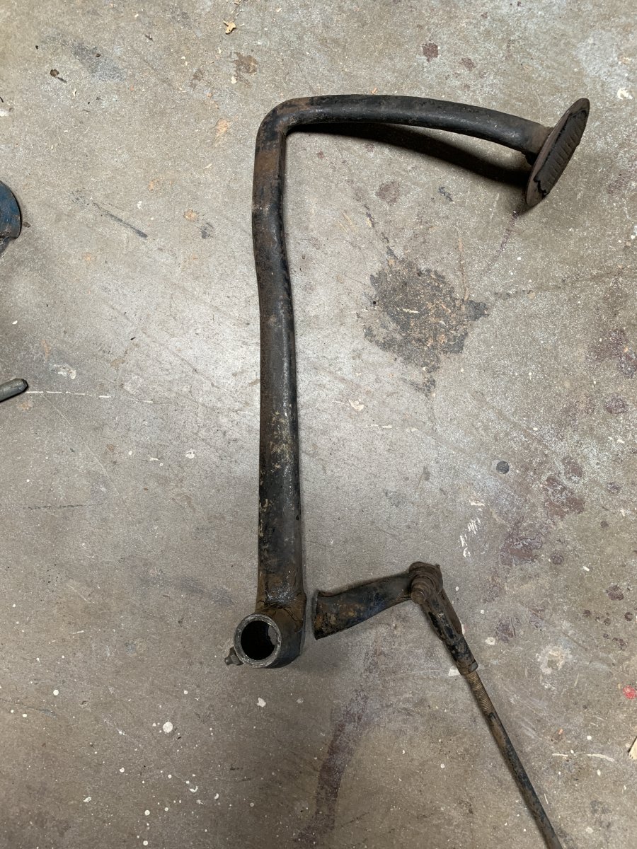

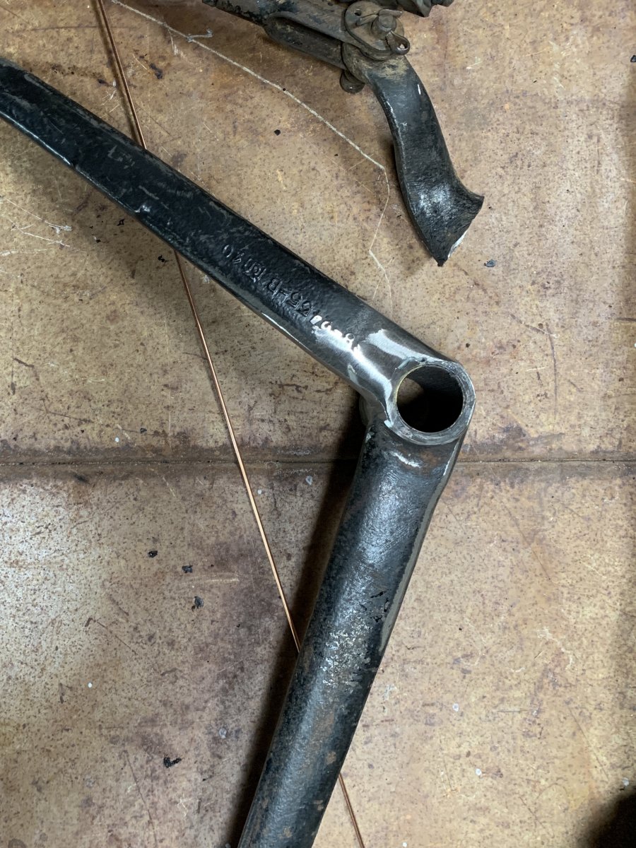

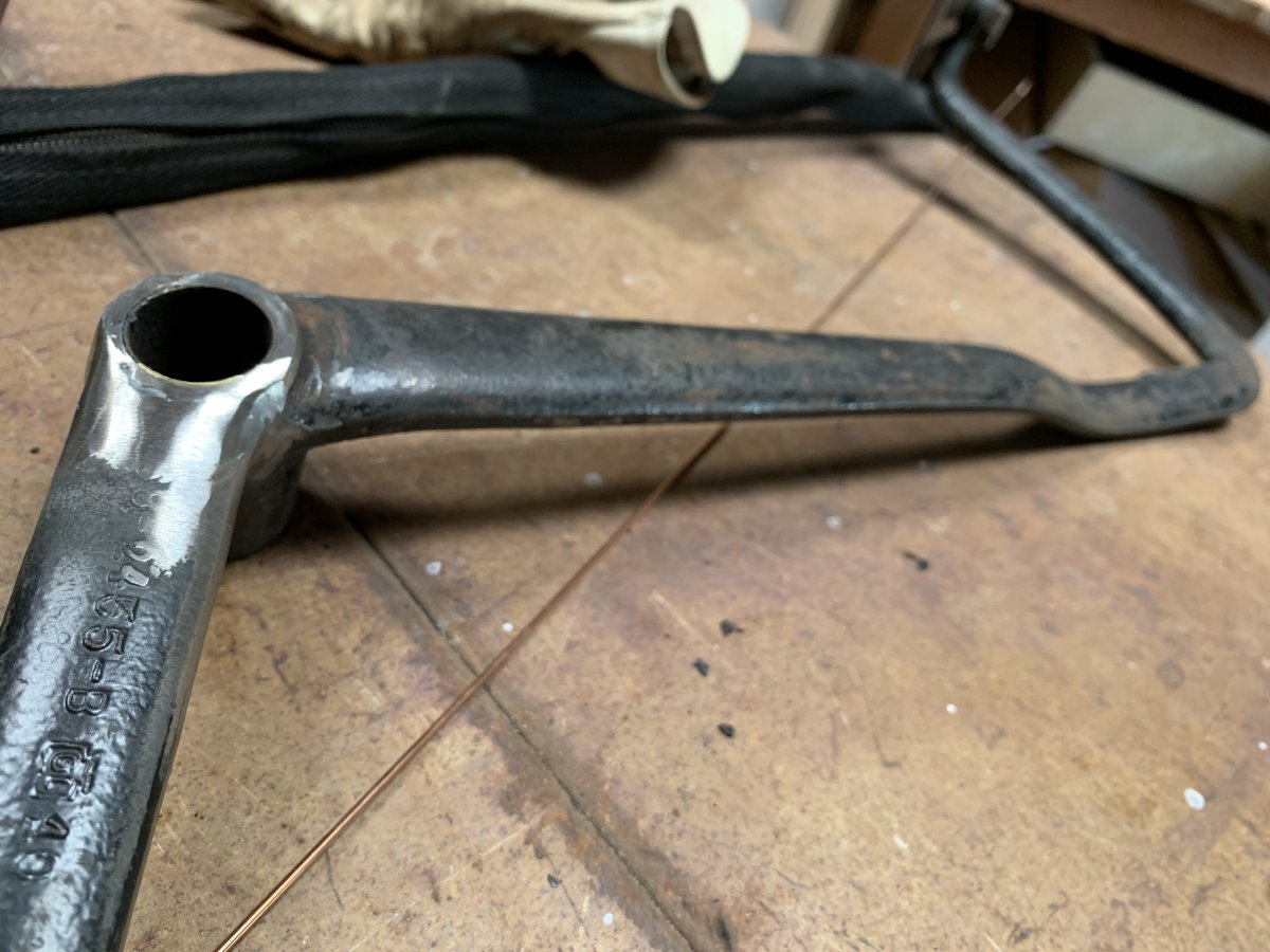

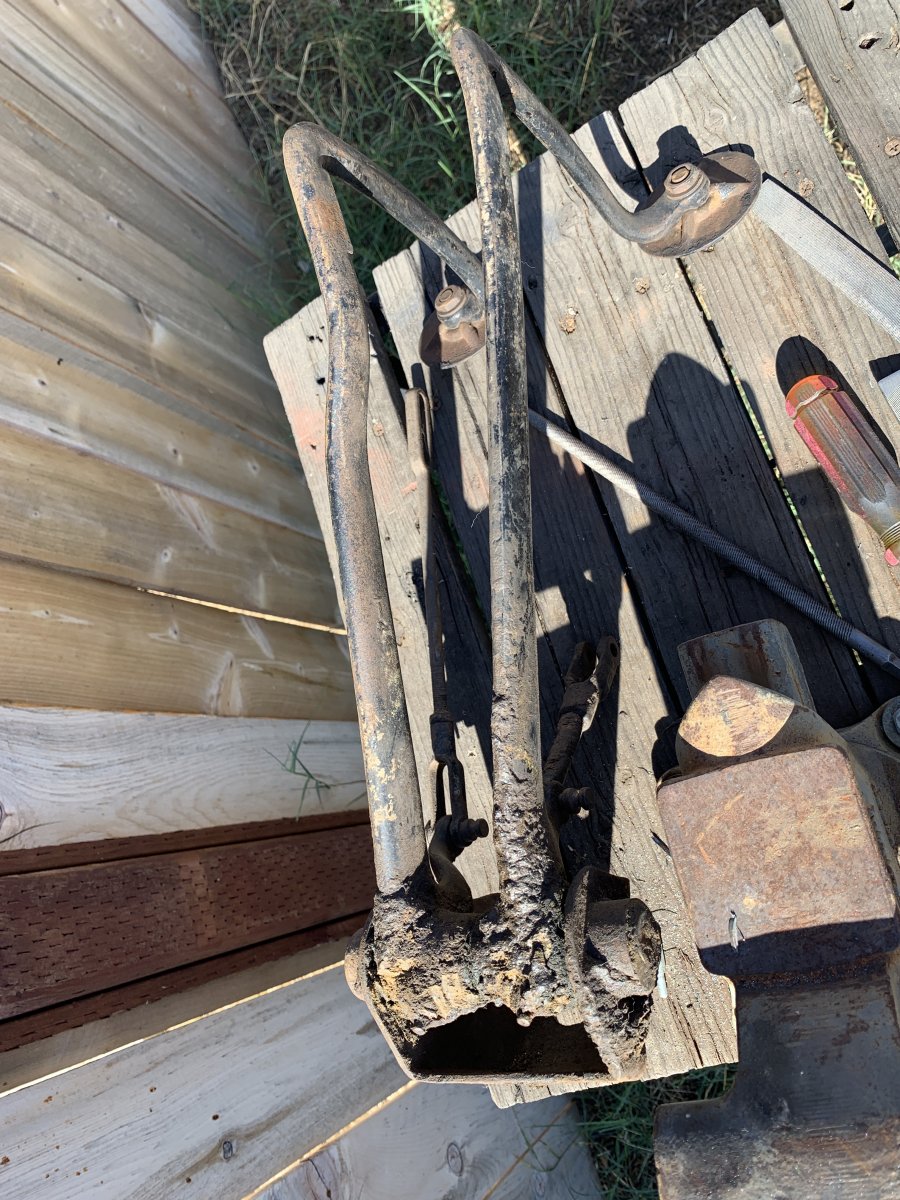

    cleaned and dis***embled the stock pedal ***embly. A78738CB-43C1-4FCD-B2D1-9A82EC5864ED.jpeg
    ..Then chopped off the original actuating arm for the mechanical brakes.

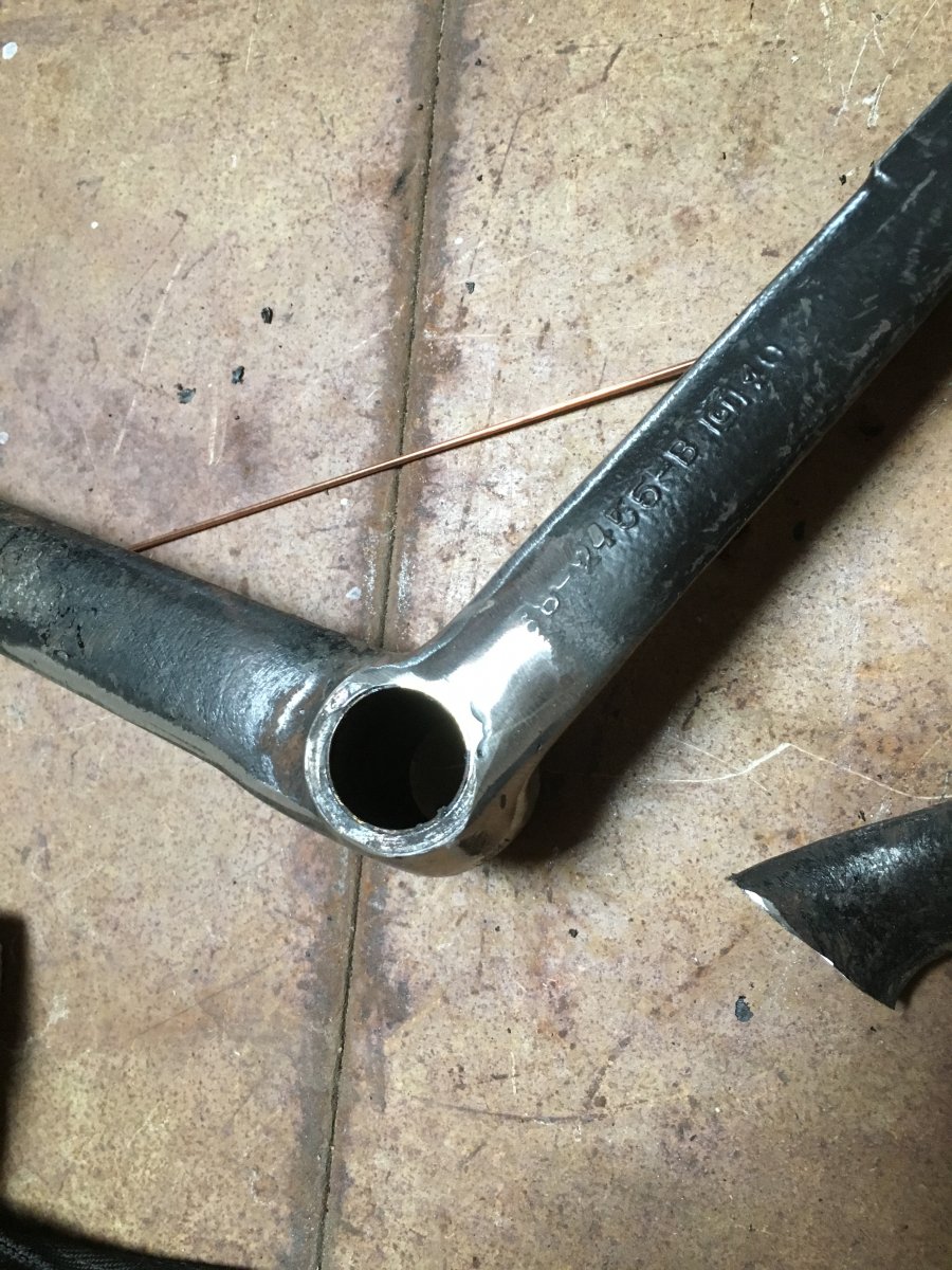

    I took advantage of @HellsHotRods shop space and helped myself to his Tig welding equipment while visiting earlier today.
    I welded the beginnings of an actuating lever on the opposite end of the stock pedal arm, so that the pedal will now have a pushing effect for the master cylinder plunger.

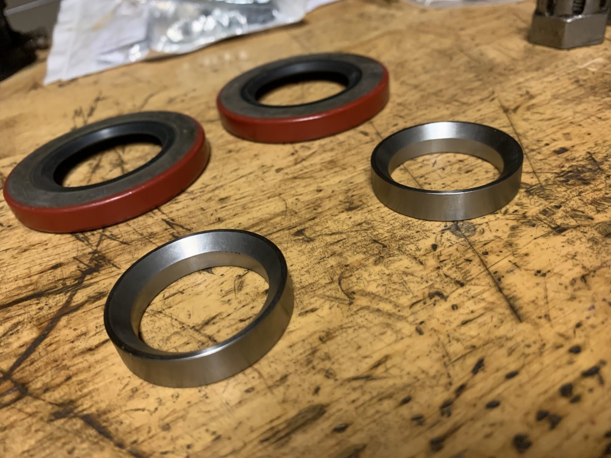

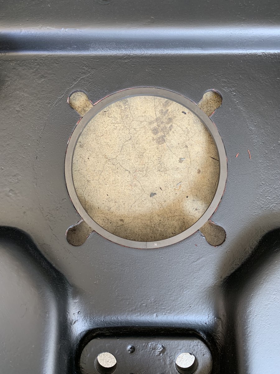

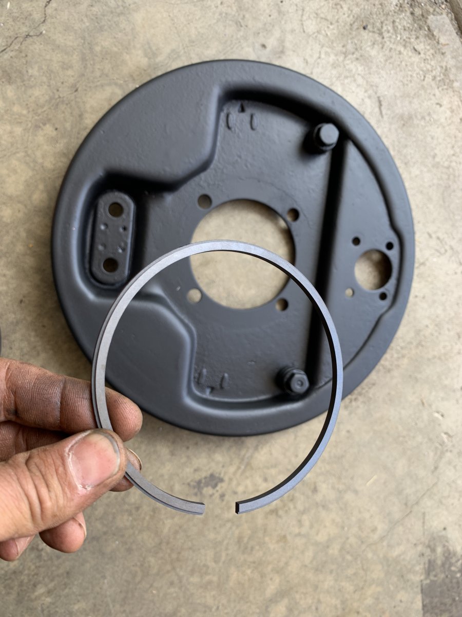

    I forgot to mention that these machined spacers were necessary to form a mating surface for a grease seal at each front drum when mounting ‘40 style brakes on ‘32 spindles. They have a slight press fit at the base of the spindle axle.

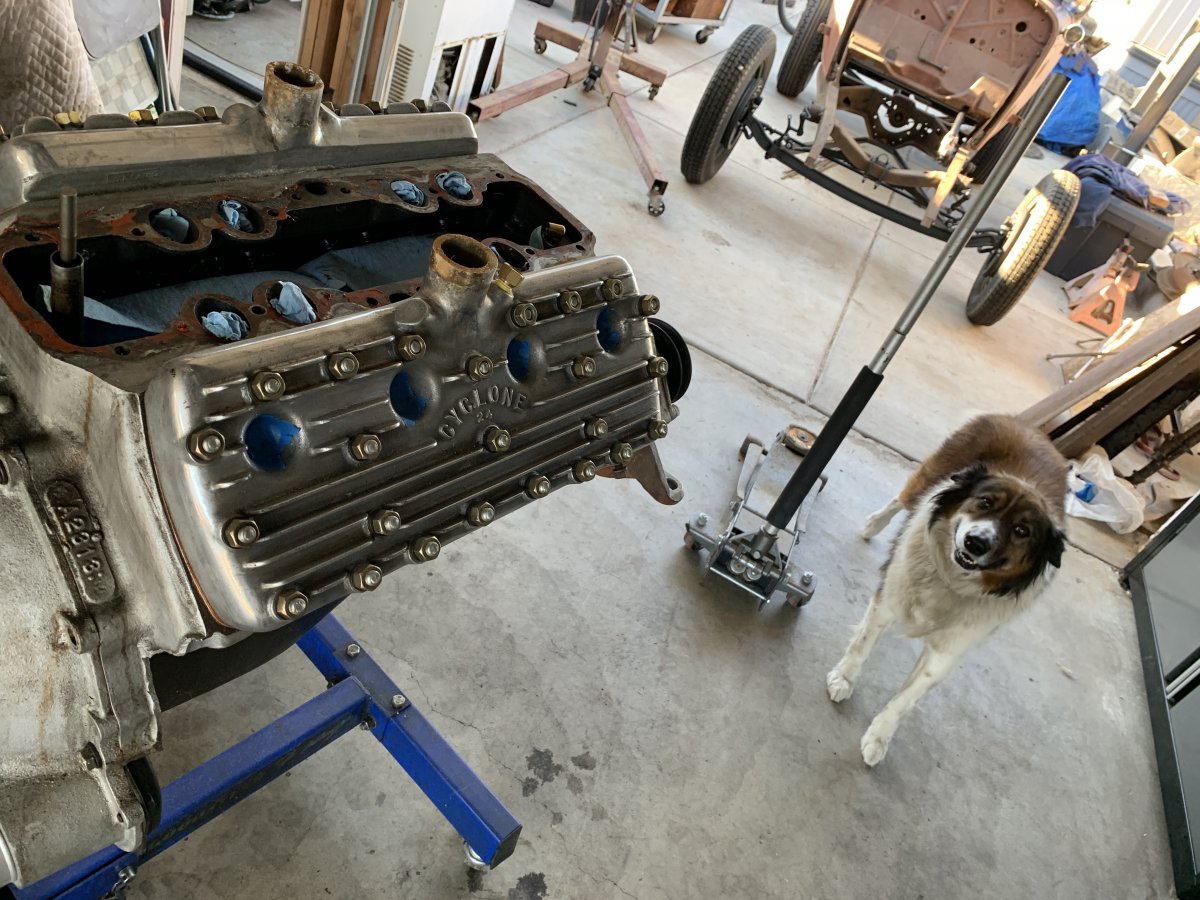

    4E502B3D-7EB2-4E99-AA30-CBE23ECAFA0B.jpeg Prepping an 8ba motor this morning that I built last year. Snyder cam, converted to early distributor and heads, zephyr valve springs, high volume oil pump and truck pan.

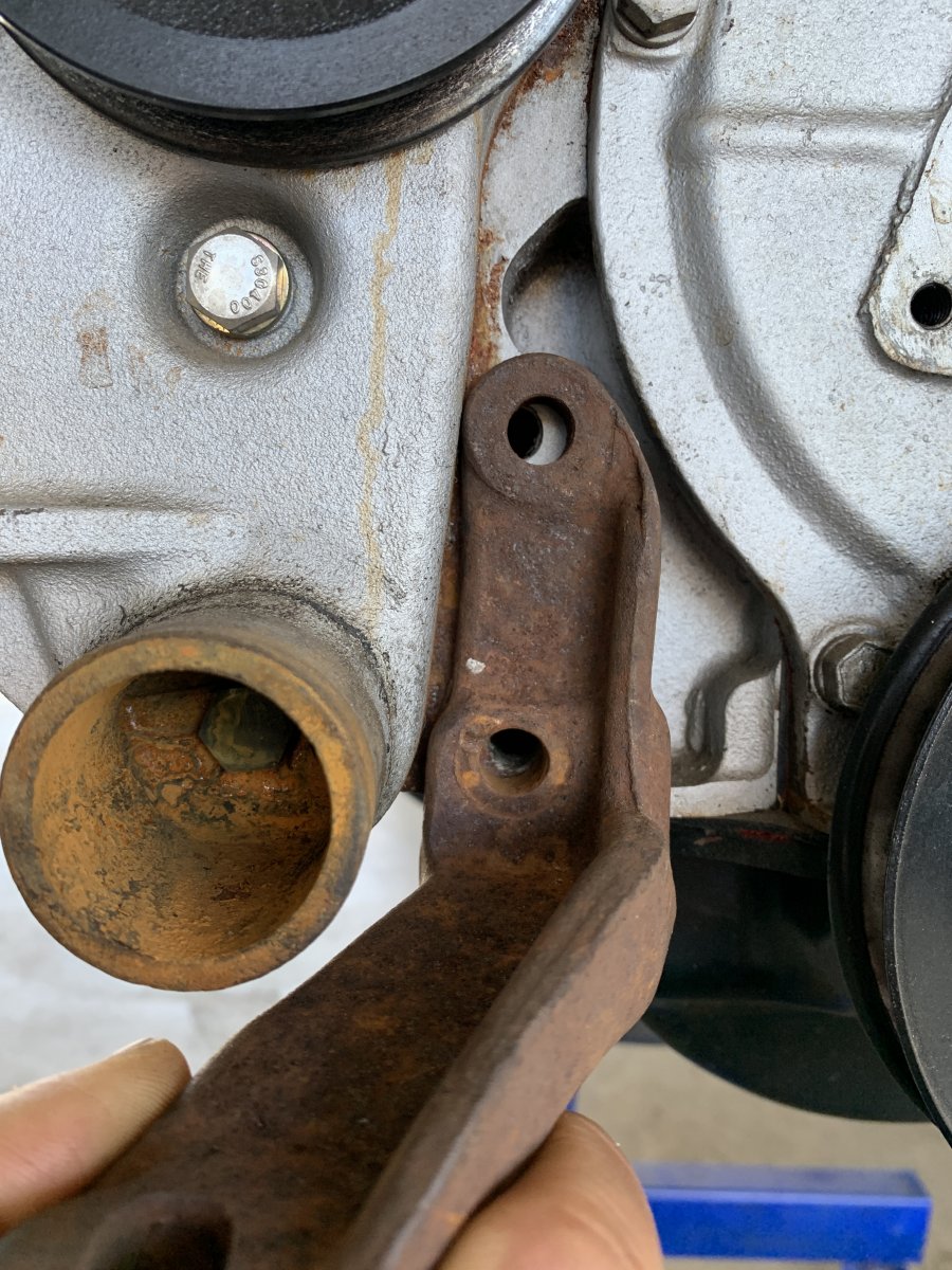

    EDD6D1D5-D623-4210-AA77-28E08079D188.jpeg Some grinding to the mounts required along the water pumps to get these 32 motor mounts to bolt up to the 8ba.

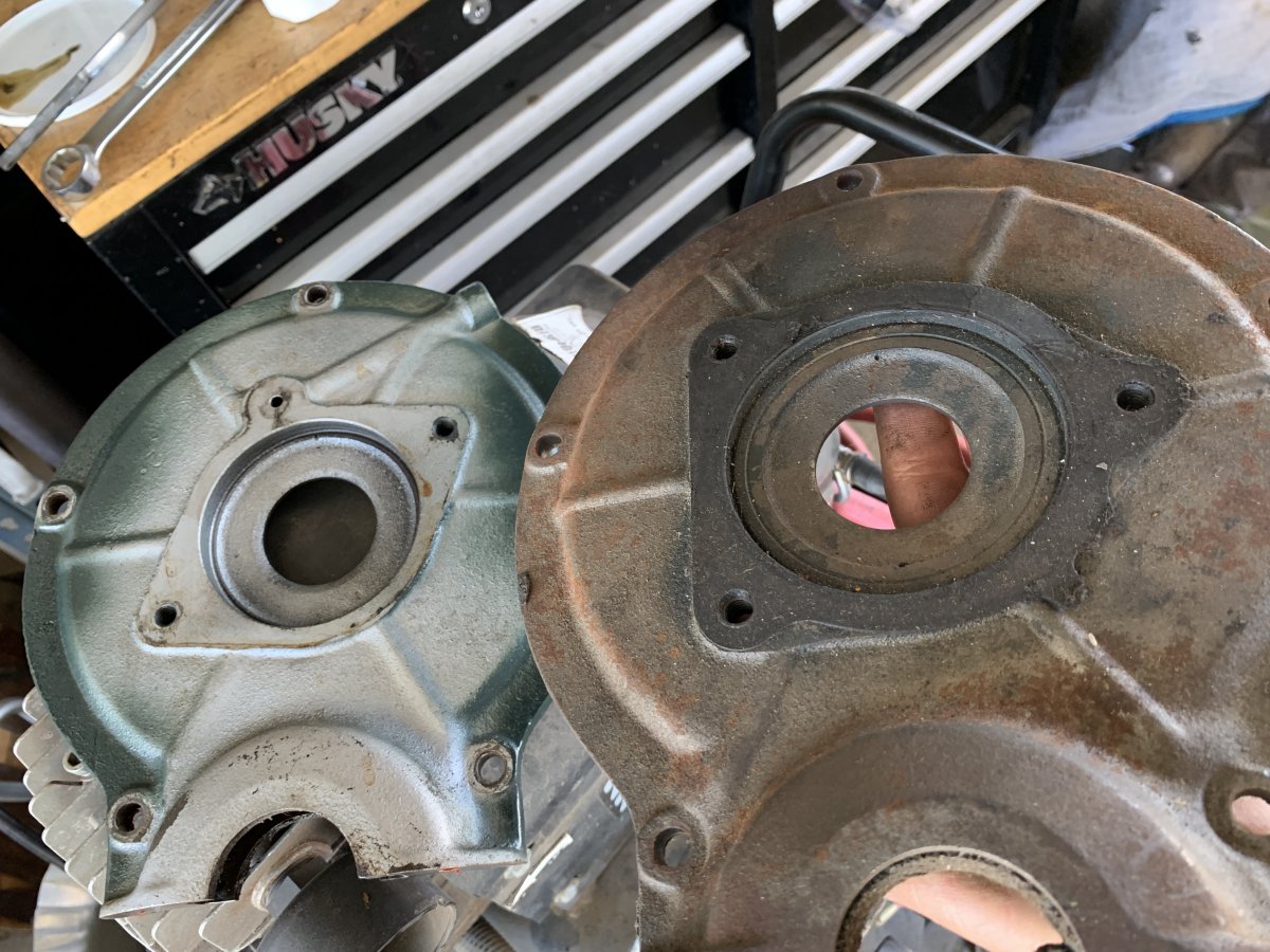

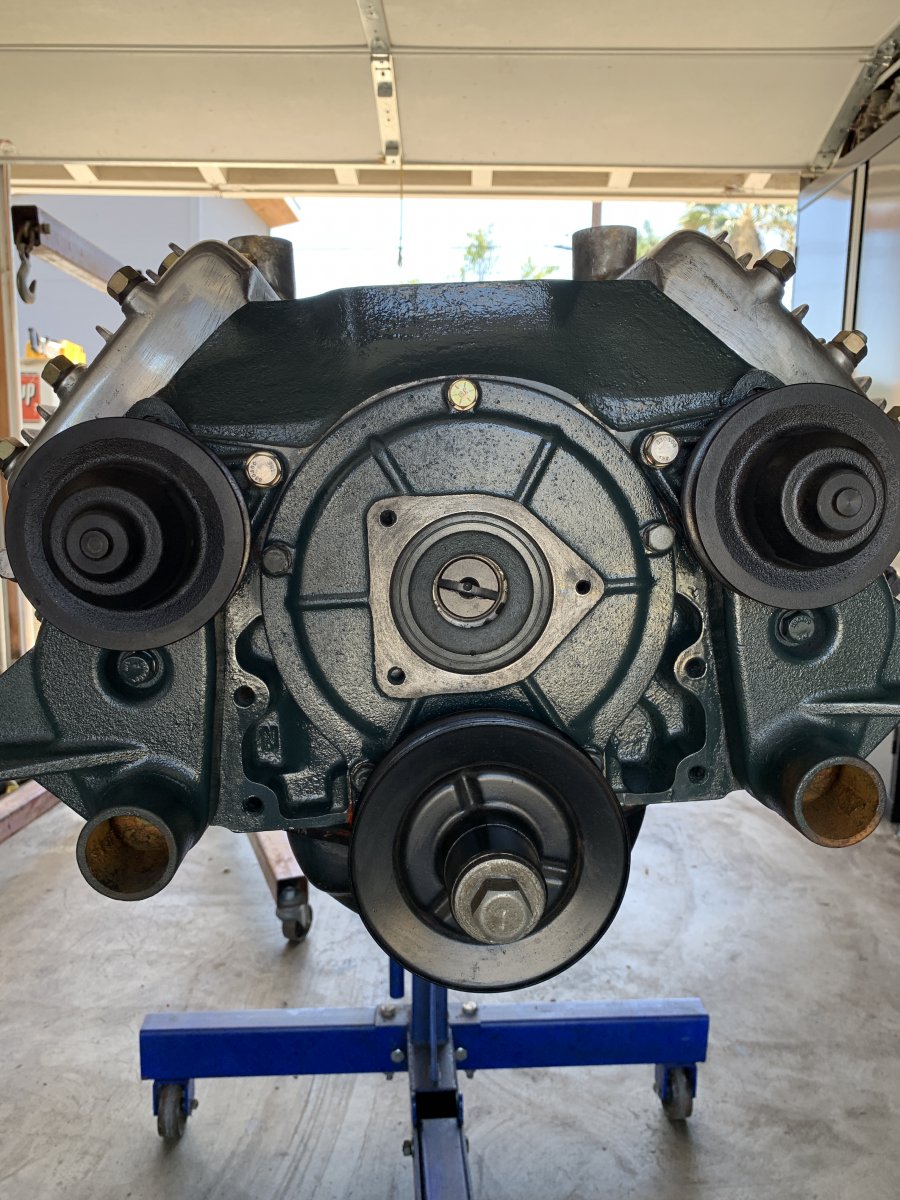

    I needed to swap the timing gear cover with a 3-bolt type in order to accommodate a Lincoln V-12 distributor. I also cleaned and painted the block M200 Antique Ford Green.

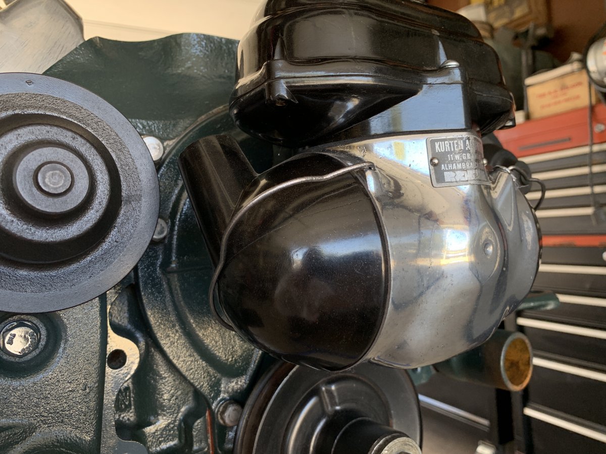

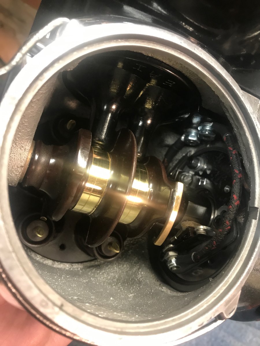

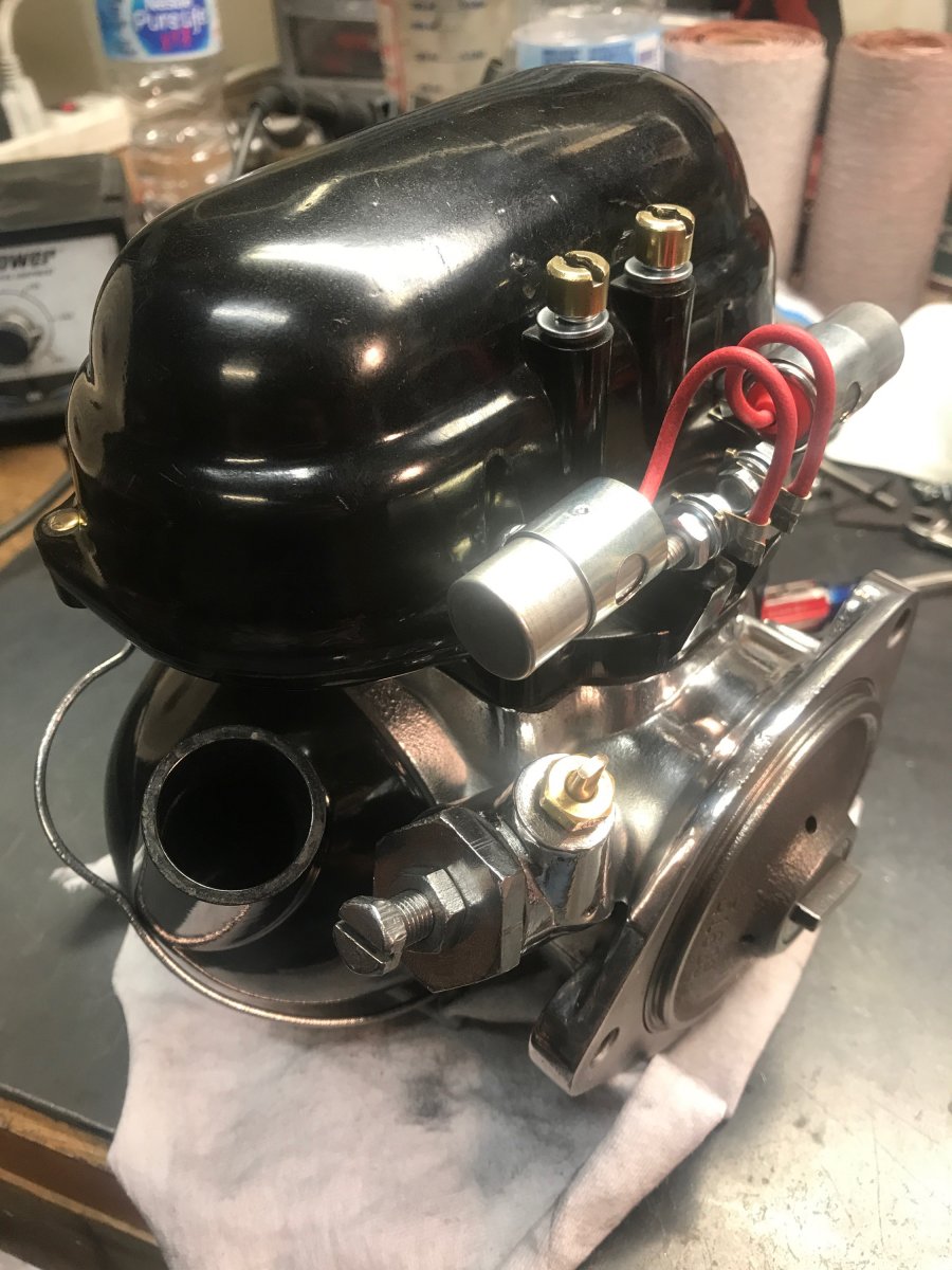

  29. deluxester
    Posts: 478
    deluxester

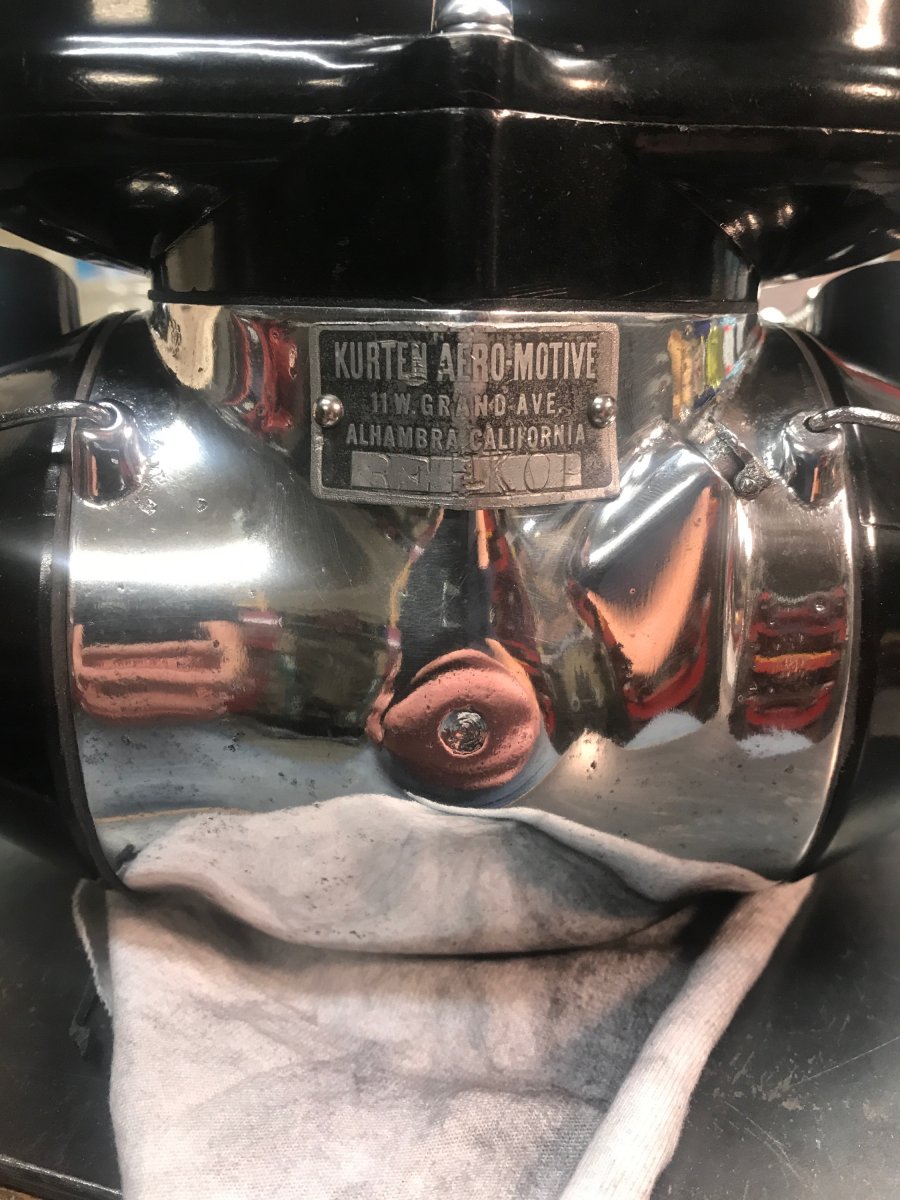

    I managed to find an original Kurten converted Lincoln distributor, and had Tyrell Pennington restore the unit to perfection! He does beautiful work and I’ve been anxious to mount it to the motor. The coil has been converter to 12v.
    Having grown up in Southern California, I enjoy finding and learning about local speed equipment manufacturers. Kurten Aero-motive operated out of Alhambra during the 1940’s. Owner Jim Kurten produced about 50-60 of these to my knowledge and proceeded to share his knowledge with the Spaulding brothers of Monrovia, CA.
