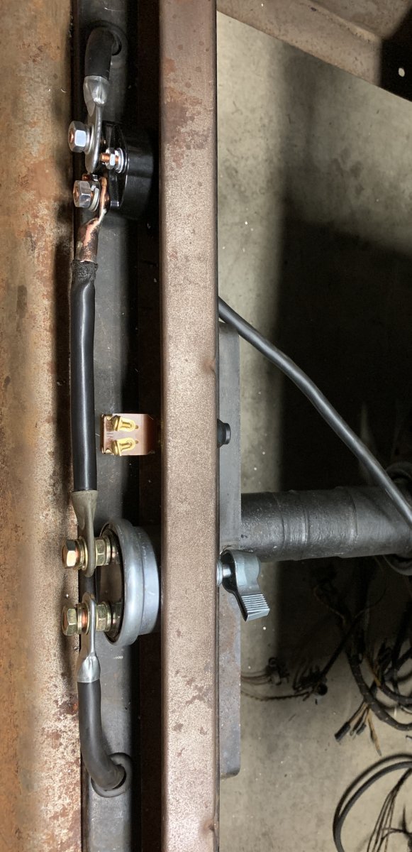

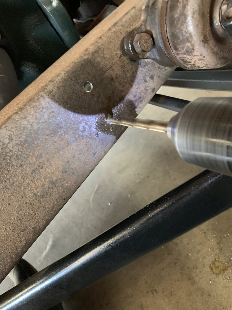

    Battery shut-off/starter relay/starter switch installed under seat.

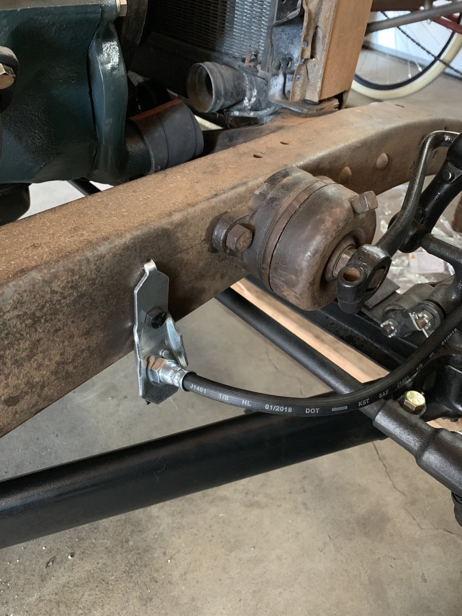

    Added some brake line hangers.
    5B4AA49E-E6D1-4BF6-8DD5-5C2B1BED5246.jpeg 72A74178-C9B1-4D4C-A93C-81C537B1312A.jpeg

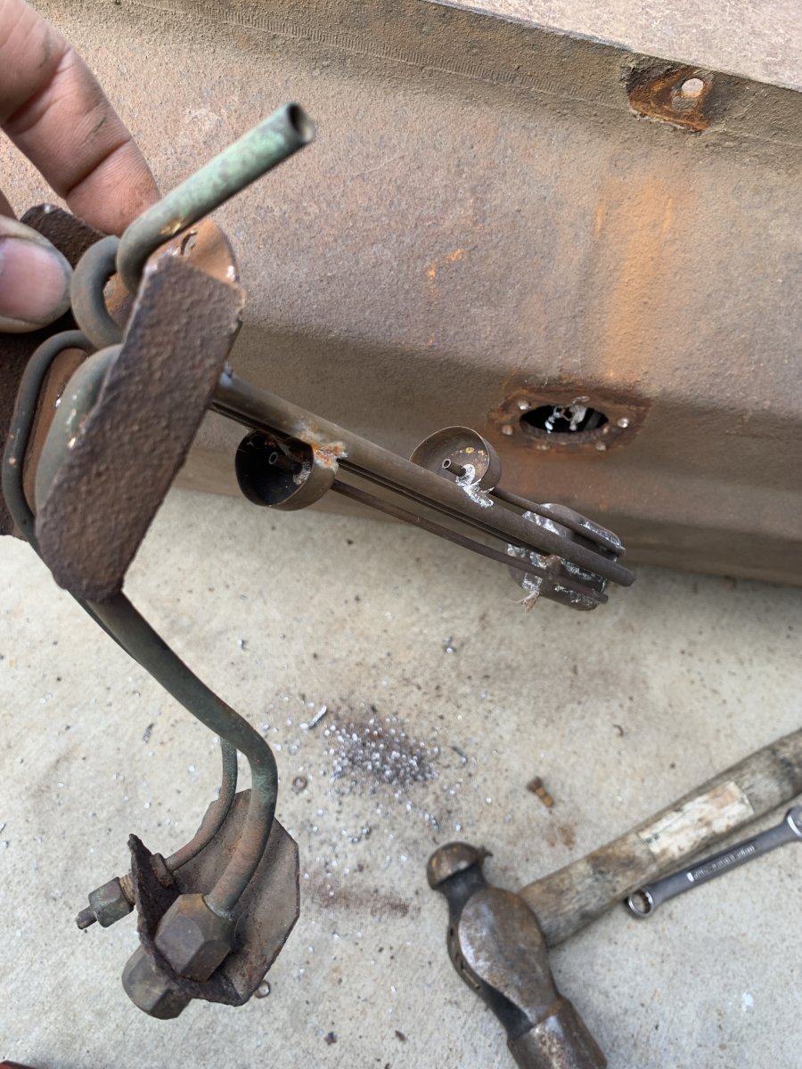

    And started on the fuel line.

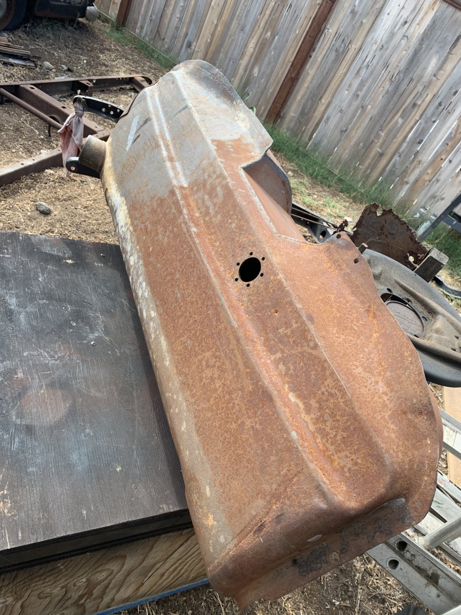

    I removed the sending unit from the badly rusted original tank and cleaned it up for use on another tank that I picked up from a friend. The replacement tank had been modified for quick-change clearance, and there were some pin holes to patch, but overall much better than the old tank.
    5690CAFD-43B0-4789-8A32-4831DD408A53.jpeg 4328C405-74F7-4648-85E3-D4D1E998E96A.jpeg

    Thats what my friend said yesterday! I’ll be switching to the stock 32 type clamp and relocate the line to the dimple in the firewall.
  24. HellsHotRods
    Joined: Jul 24, 2009
    Posts: 1,429
    HellsHotRods
    Move the FUEL line to stock firewall location (I have the clamp you need). The brake line brackets are '39-'48 FORD and are dead on period correct for a post war hot rod as this build is. @jimmysweden Do your research, nobody was welding on tabs or running street rod brake lines back on the dry lakes after the war.

    I don't mind the 1940 Ford brake hose bracket one bit. Just what they would have used in 1940 to hot rod that little roadster.
