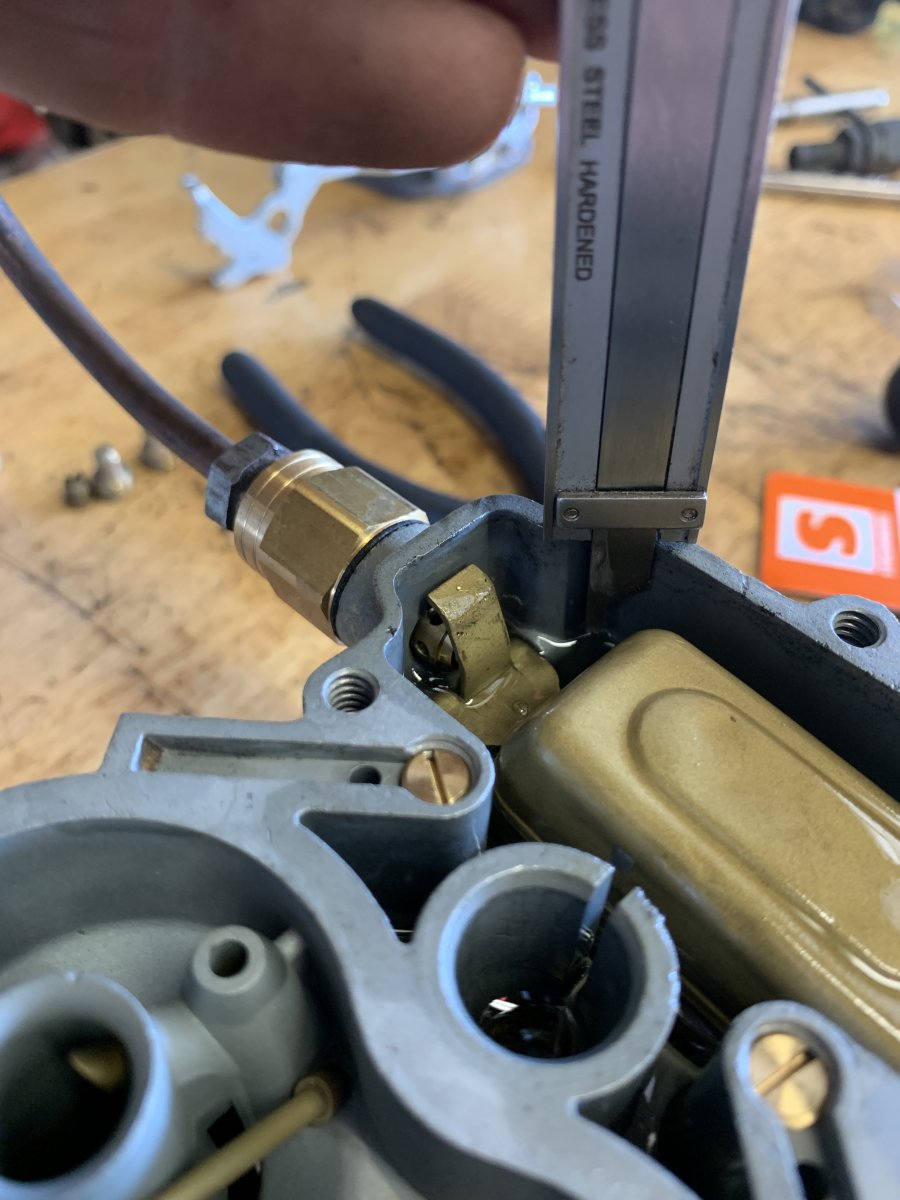

    I’ve been having trouble with these two stromberg 81 carburetors ever since their rebuild. I elected to install the check ball style valve to replace the stock float needles, as well as new matching set of 71 byp*** jets and idle jets.
    The float adjustment is something that I always eye-balled and estimated somewhere below spec to avoid flooding.
    I finally decided to dive in and set the level precisely by observing actual fluid level. I’ve read that ideally there should be 1/2” - 5/16” margin between fuid level and top machined edge of the carb bowl while the motor was running. I invented this method of pressurizing fuel into the bowl while on my bench. Seems to have worked well, but please let me know if there is something wrong with doing it this way.

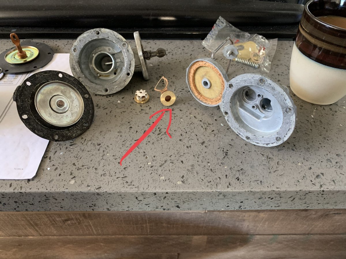

    Tried to fire up the car with no luck this morning. Had I made a mistake? Impossible.
    No fuel to the carbs; bad nos fuel pump? Maybe. I dis***embled to find one bad valve I think. Rebuilding now with a kit from the Early Ford Store.

    Yes, the kit came with new levers. But the pump was a very old nos unit still in box. I only replaced the large diaphragm, and both valves...
    it works!! Fired right up.

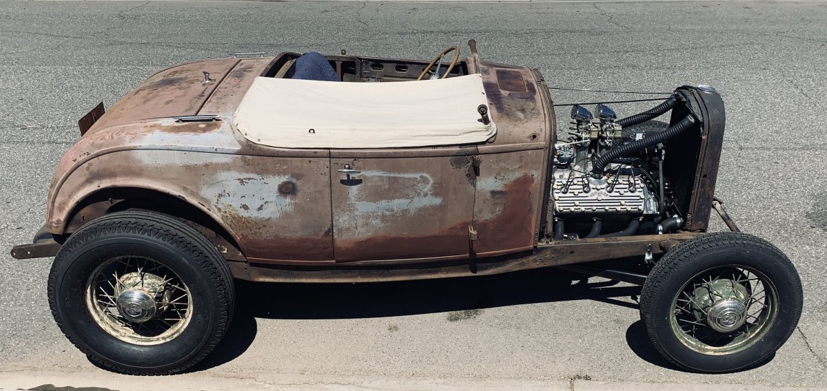

    I drove it 60’ feet to the front of my house. (Still needs brake lines)

  10. Congrats, looks great

    What's the plan for the body? Neglect or a nice quick shot of primer or something?

    There are traces of the previous maroon color under the primer. And beneath that, I am certain is the original ford black. I’ll experiment later with peeling off the layers, and will likely patch into the original black paint.

    Nice. It would be interesting to see if you can get the gunk paint off and maintain the black underneath

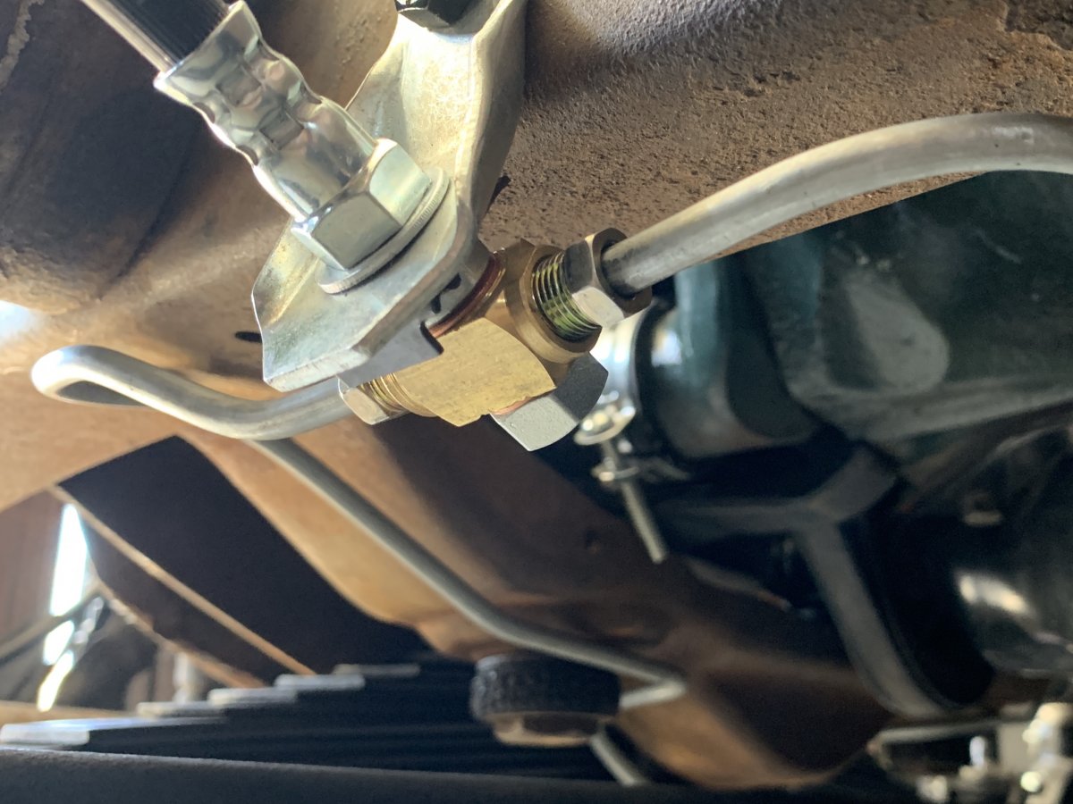

    Finally started on brake lines today. I’ll be adding clamps once everything is connected. 358DCD61-AA2C-49BD-BAC7-2C51E0EC68D9.jpeg D7CF8743-D26C-4384-B901-081F880BF05D.jpeg

    Brake lines: done (still need clamps)

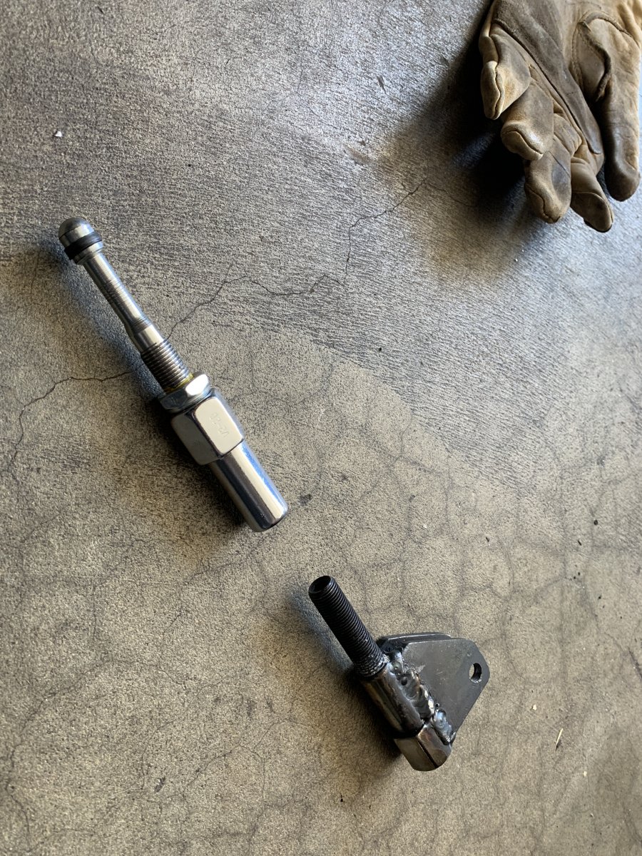

    I fashioned some lugnuts together with a threaded rod and some tabs that I made. 818484A5-65E8-4C58-96A2-753C3151E9E7.jpeg

    Adjustable pedal rod to master Cylinder with high offset pivot: DONE
    Not too pretty but should do the trick safely.

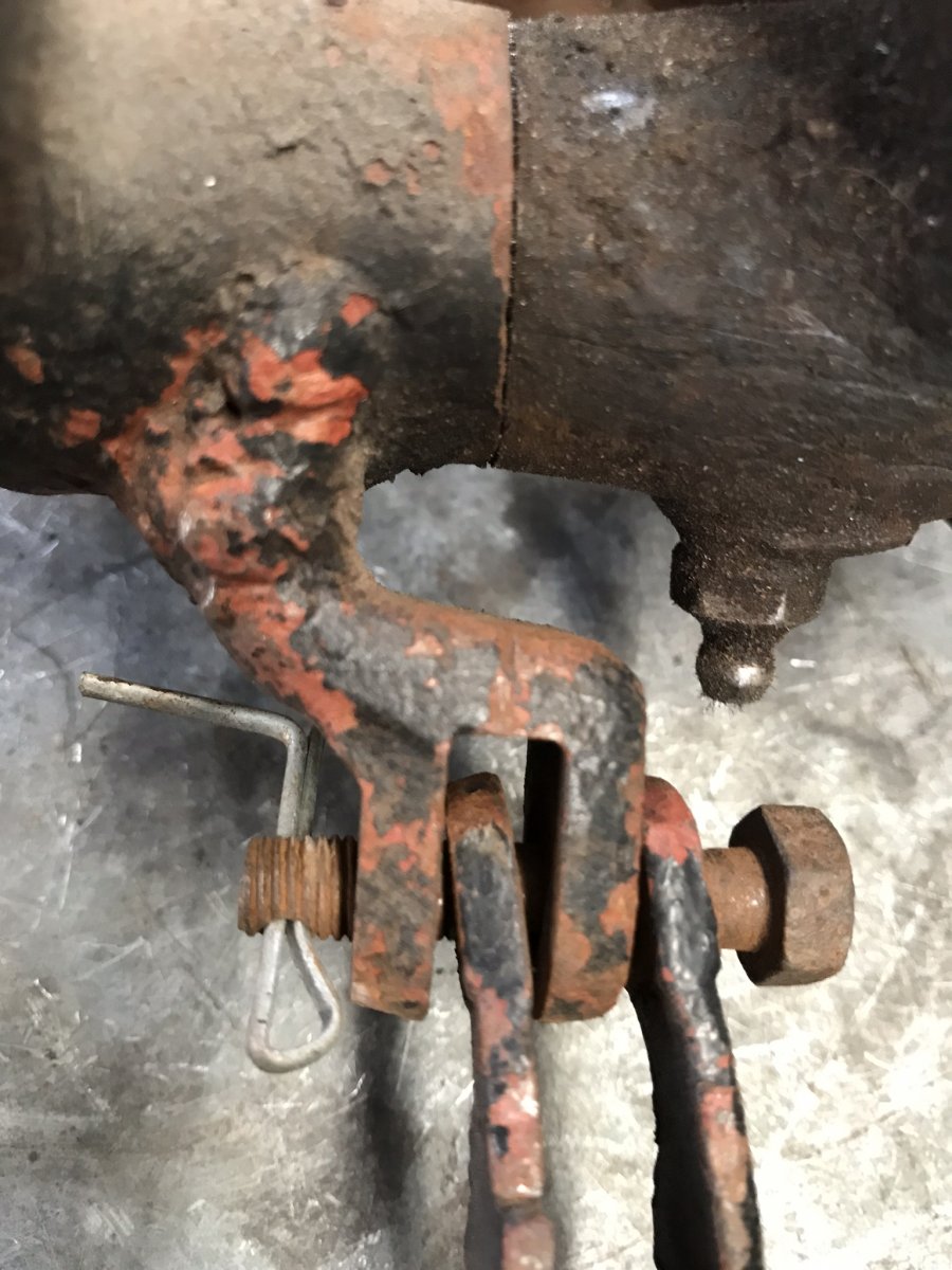

    Torched the brake arm to the left to clear the motor. Torched the clutch arm to the left for a little more toe-room along the steering column.

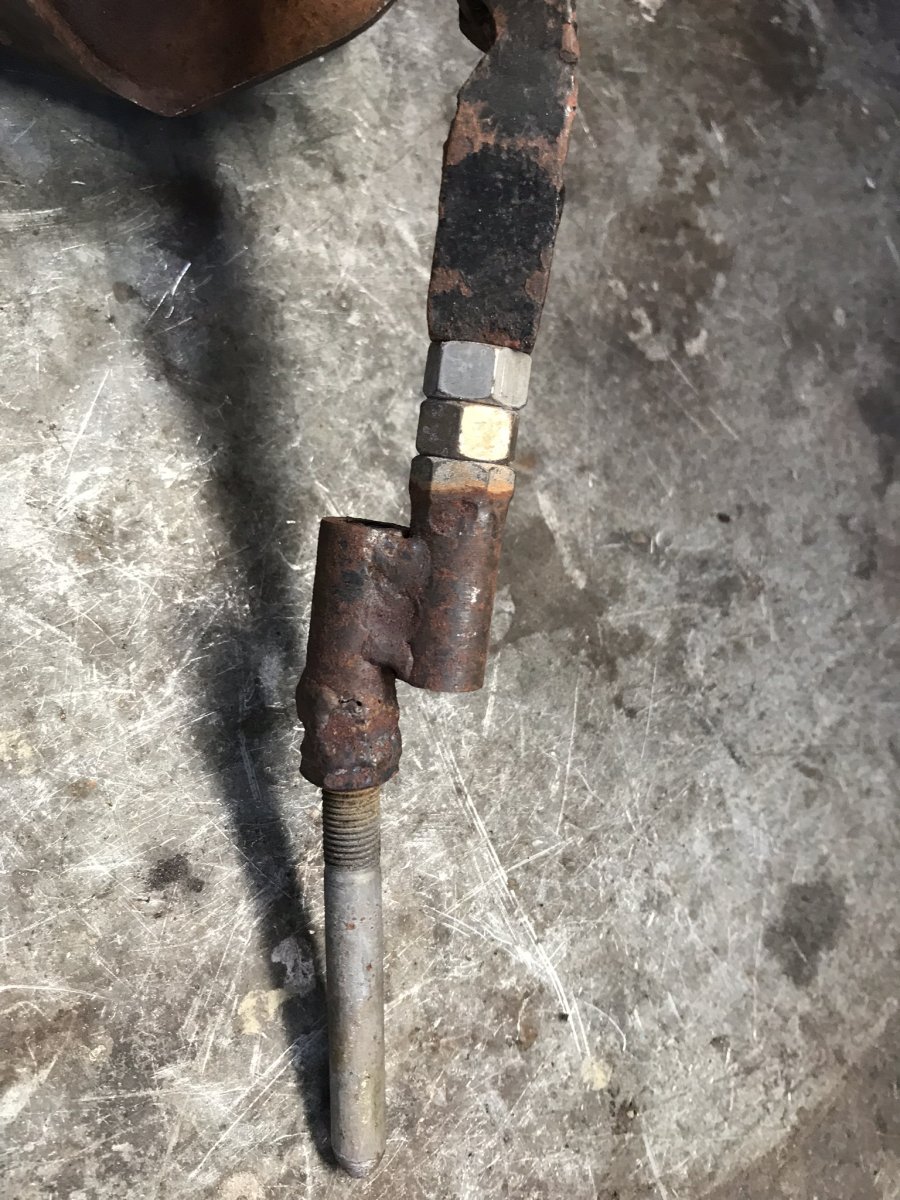

    69EA76E0-7966-460C-9A97-3F8FA86E525C.jpeg F80EDC52-D538-4EA6-97F6-3D8FAF2B6481.jpeg Nice job on the push rod and ***embly , way nicer than the cobbled rebar and blind monkey welds done but a long forgotten owner on our 32. With the angle way wrong.
    Down under we can’t weld brake or steering components like you did on the brake pedal actuating arm. I found a new 32 pedal at the Roundup that was cast/forged with the arm already made for hydraulics,dont know who made it , but it was nice.

    Looks like something I would have done if I were broken down in a parking lot.

    You need a jamb nut on both sides of your middle female connector, and if the forward fully-threaded rod doesn't bottom into the connector link with the pin, it should have a jamb nut too.
    Might be better to make a simple one-piece rod that is round on one end and threaded on the other. Then you only need one jamb nut. The undercut near the rounded end should be easy to do on a lathe if you have access to one (or a buddy with one).

    I have one jam nut on the rear lug. I’ll put another set on the inside stud - that is a good idea. No lathe, but that is exactly what I wanted initially. Just hand tools, a drill press and a welder machine here at home and that entire amalgamation was a work around to not having a lathe. I’ll have to make a cleaner unit with some help once I’ve confirmed that the system works well.
