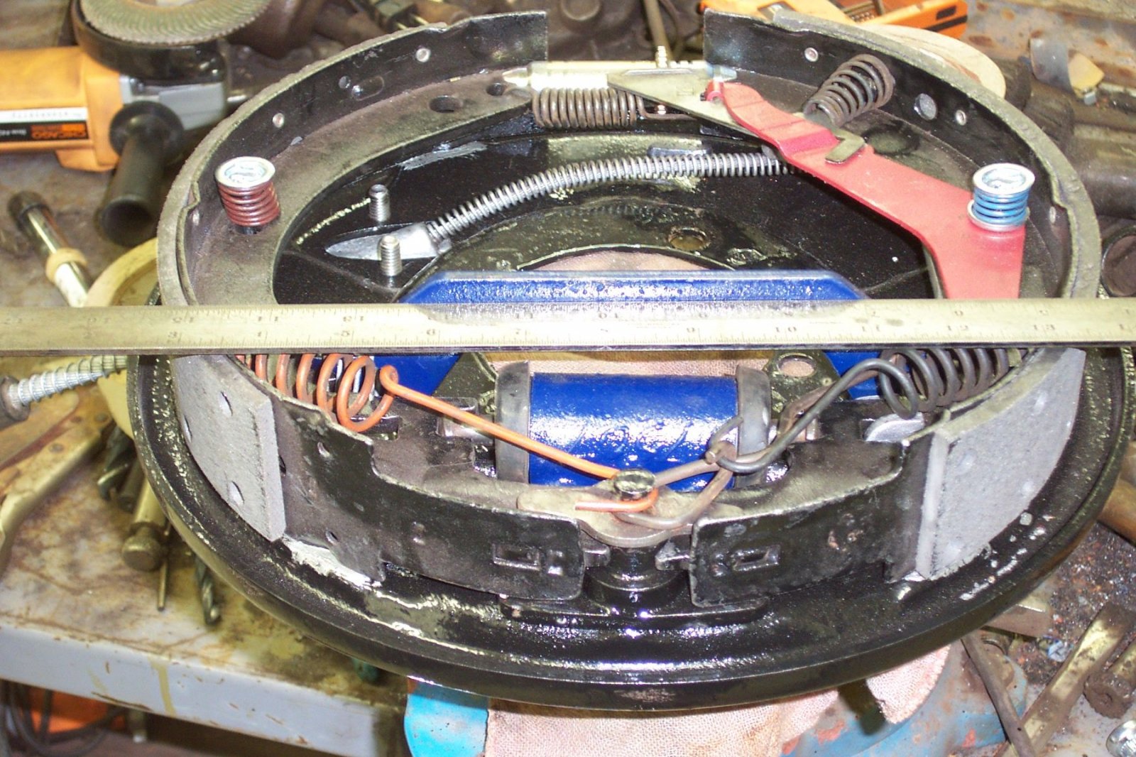

    lincadjust.jpg I apologize to those who pm'ed about the self adjusters. Heres the picture. I used the self adjuster parts from the BIG (only) 71-76 Chevy Station wagons. I got smallparts kits from the auto parts store except for the long arm shown on this picture. I used the arms off of a mid 70s El Camino. They are too short, so I cut them and welded in pieces to get the right length. Out of focus pic. Sorry

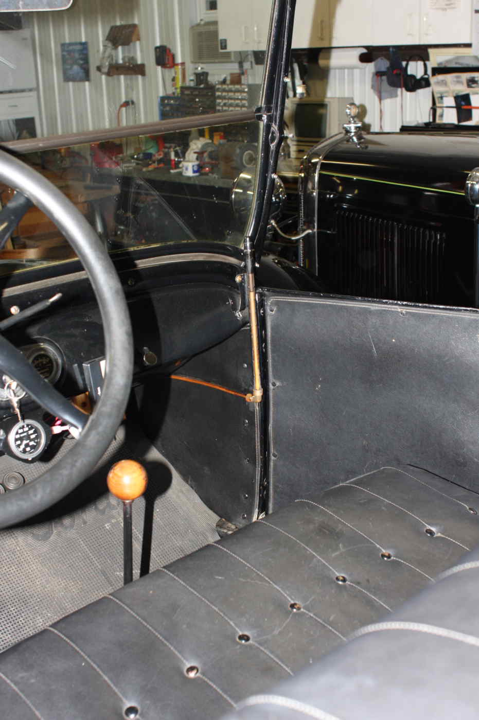

    UPDATE
    Last Friday I finished up the installation of the gauge panel, gauges and dashboard but the Boss had the camera so I couldn't take pictures until today.
    The original gauges were replaced with a new set of Stewart Warner. I opened up the holes in my original painted commercial gauge panel for them to fit. The dash light switch was moved to the upper right hole. The lower middle hole under the speedometer is going to be filled with a vintage looking red jewel light which will function as a "low oil pressure" warning light. I have a sender on the way, too. I decided on the warning light because I didn't want any additional gauges or other things hanging from the bottom of the dashboard. Not a big fan of that.
    I'm very happy with how the new dash treatment looks.
