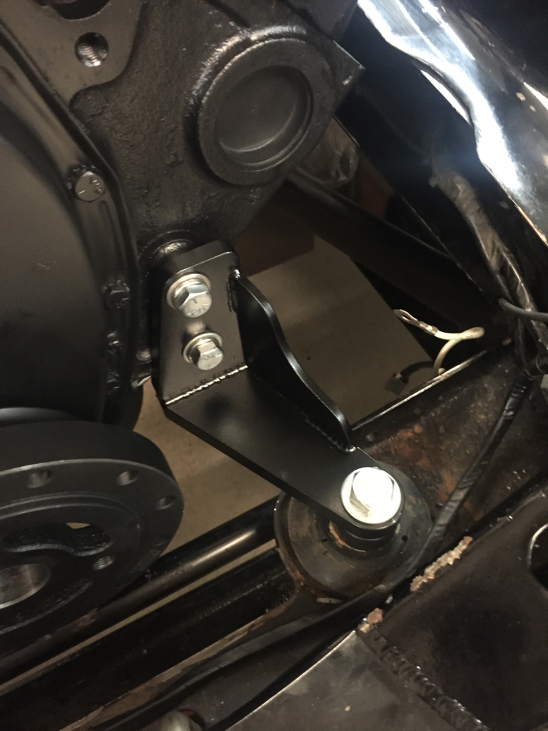

    Dennis. Just put spacers under the motor mount. I put a 7/8" spacer under my dads 32 5 window. ImageUploadedByH.A.M.B.1443357254.697737.jpg

    Really like the wheels and tires. Danny, won't the spacers under the front motor mounts effect the alignment where the trans bolts into the rubber mount in the K member? Never ran a torque tube/original trans setup so have no knowledge how critical this is.

    There's nothing more I can do to lower the front besides modifying or replacing the front cross member and that's not going to happen. I wouldn't want the front any lower than it already is. The rear is going to come down noticeably. Right now it has a stock spring with 5 leaves removed. It will be replaced with a reversed eye spring that has also been de-arched 2 inches.
    The oil pan has nothing to do with the tie rod clearance problem, the pan is a mile away. It's the harmonic damper/crank pulley that are too close. Either the engine needs to move up or the tie rod needs to go down.

    No problem. It just puts a little strain on the rubber mount, but it's very minute.

    I have done three cars like this and I've just cut the top off the adapter.

    It's about 6.5". I looked around for a smaller and reasonably priced damper but 6" is about the smallest I could find which would only net 1/4" savings in clearance. That still doesn't fix it because the crank pulley is 6.75" and at full steer the tie rod is directly under the pulley.
    I considered doing exactly this. Before I make any changes I will try out some spacers on the motor mounts. I sure would like to leave it sitting like it is in front. I'll just have to cut more off of the clutch housing.

    On my flathead powered '32 project I cheated the front of the engine upwards 3/4 inch or so as well. It didn't seem to hurt the rear trans mount any. But if you had only 3/4 inch clearance between the damper and tie rod, it's not enough.
