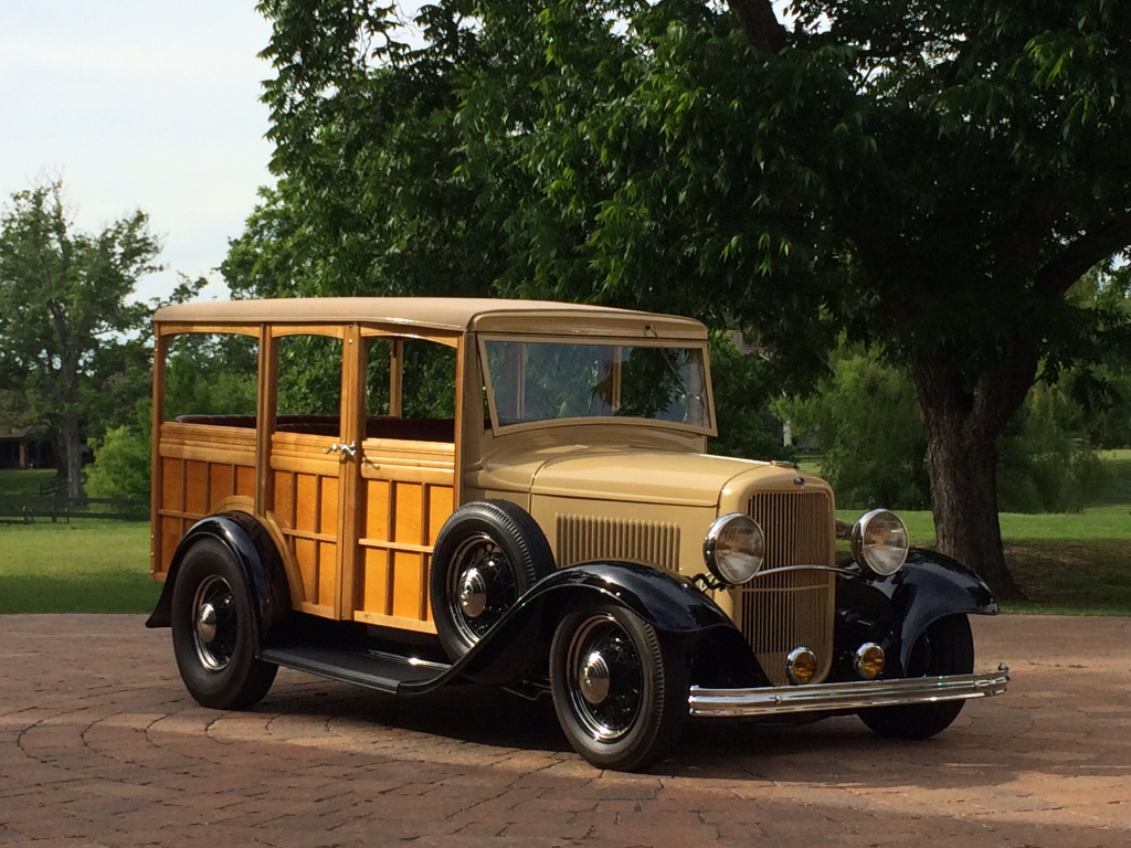

    Here's a woodie I built for a customer. ImageUploadedByH.A.M.B.1443568041.558715.jpg

    The 18" front tires we are running are close to the same height as 5.50-16, so it is possible to run fenders with 18's

    Damn Danny that is niiiccce! I guess I have alternatives with fenders. But for now it's gonna be fenderless.

    That Woody is damn cool, Danny. Dennis, what's the word of the day? Any lunch hour breakthroughs? :D
