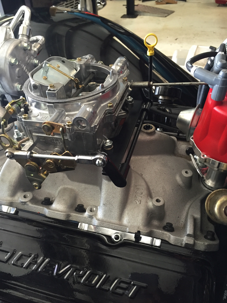

    Dennis. You may try something like this on your carb. I made this one for dad's car. ImageUploadedByH.A.M.B.1444485417.163027.jpg
    CTaulbert likes this.
  24. Dennis Lacy
    Joined: Apr 27, 2008
    Posts: 1,461
    Dennis Lacy
    Danny - That is a fantastic idea! It needs to get filed in the "why didn't I think of that" drawer. I would totally do that if I had a V8 throttle ***embly to use and will absolutely do it for the '57 283 Power Pack that we're putting in my Dad's '33 Panel. I've actually already modified the "B" ***embly by making a new shaft that still has a short hook on the right side for the spring and pokes out the side of the retainer cap on the left with a lever attached. I keep forgetting to take pictures of it. Thanks for the killer idea!
