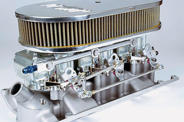

    Late last week I received a big box from Speedway. Some of what it contained was the Zip water pump riser kit and the new 235 Chevy water pump to go with it. I went ahead and got the engine mounted up on a stand, pulled the long water pump and pulleys off, mocked up the Zip riser and pump on put on some mock up pulleys that a friend gave me. (I bought new single groove crank and water pump pulleys from Speedway but didn't want to scratch them so I'll use these double groove pulleys for mock up.) The Zip rise seems nicely made and I really like that it handles mounting the alternator, too. I also mocked up the original '32 V8 front mounts.
    [​IMG]Hosted on Fotki
    At this point I am strongly considering keeping the triple Rochester setup because it's *****in'. If I do this one issue I will have to overcome is that the typical 45 degree water outlet interferes with the pump riser. Zip recommends using a vertical outlet but that won't work because of the front carburetor. It looks like I will need to fabricate my own outlet if I'm going to keep this setup.
    Here's a close up of the '32 V8 engine mount on the Chevy block. The upper threaded boss in the block is just below the original upper hole in the mount. A little re-working and I'll be in business.

    Hey Dennis. That pic above with the '32 motor mounts on the sbc is mine. I have those mounts out in the shop. They have really simple adaptor plates that fit behind the '32 mounts and bolt on to the sbc with countersunk bolts and position the '32 mounts exactly where they need to be without altering the original mounts. Jason Smith at Hot Rod Garage made them for his roadster. As soon as my camera batteries recharge, I'll go out and take some pics for ya.
    kidcampbell71 and volvobrynk like this.
  29. DDDenny
    Posts: 22,306
    Dennis--
    You might consider the thermostat housing used on the Barry Grant six shooter setup along with a short riser/spacer like on my roadster. Not sure if they used the standard bolt spacing though. I like this housing because it doesn't have that "billet" look.
    It appears their carb. float housings are larger so this may (look) like it would not work, you may have to get one to verify clearance on your setup.
    The last photo is an adapter I made to orient the thermostat housing on my Carryall engine. Two 3/8" alum. plates, shaped and welded on inside.
    My apologies regarding the modern looking stuff in these photos, just some suggestions to help, may save you from making a housing from scratch.
    I like the traditional direction of your build, but I gotta say; I just can't warm up to that big late model GM alternator up there.

    Try these two FOUR SEASONS numbers.
