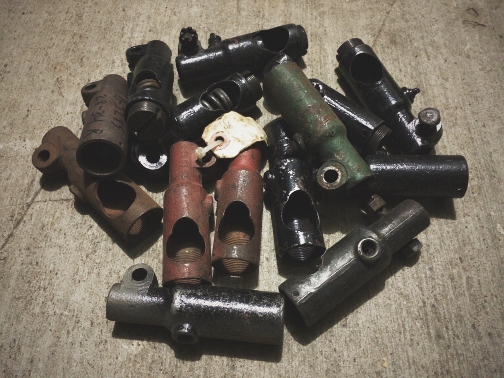

  13. TexasSpeed
    Joined: Nov 2, 2009
    Posts: 4,632
    TexasSpeed
    from Texas
    I'm loving this stuff. You just made me even more glad that I buy up all the '28-'34 tie rod ends I find at all the swap meets that I can find. Of course, I buy up whatever else early Ford stuff I come across too.. Love original Henry stuff.
  14. Dennis Lacy
    Joined: Apr 27, 2008
    Posts: 1,461
    Dennis Lacy
    So, that's where all the tie rod housing are hiding. We're actually running low on good originals so in most cases I use reproductions and save the gennie parts for the customers who demand them. Now, maybe if I actually hit a swap meet once in a while I could have a stock pile of tierod parts too!
    volvobrynk and TexasSpeed like this.
