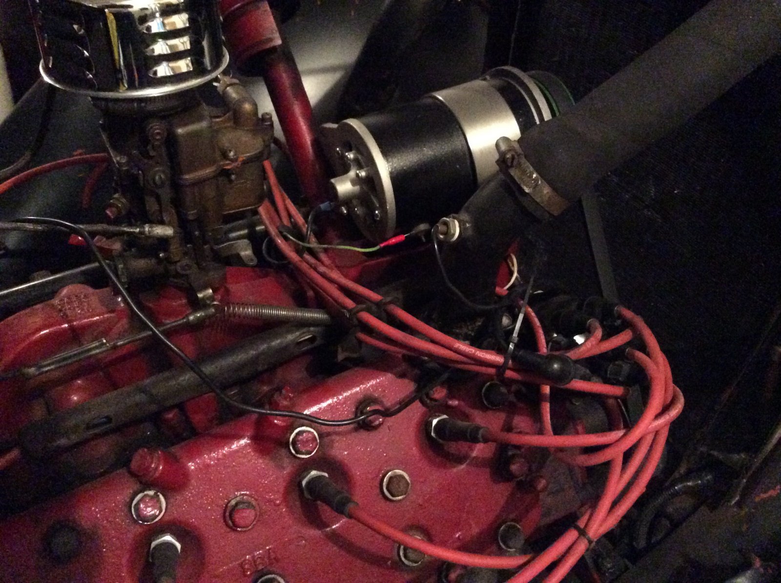

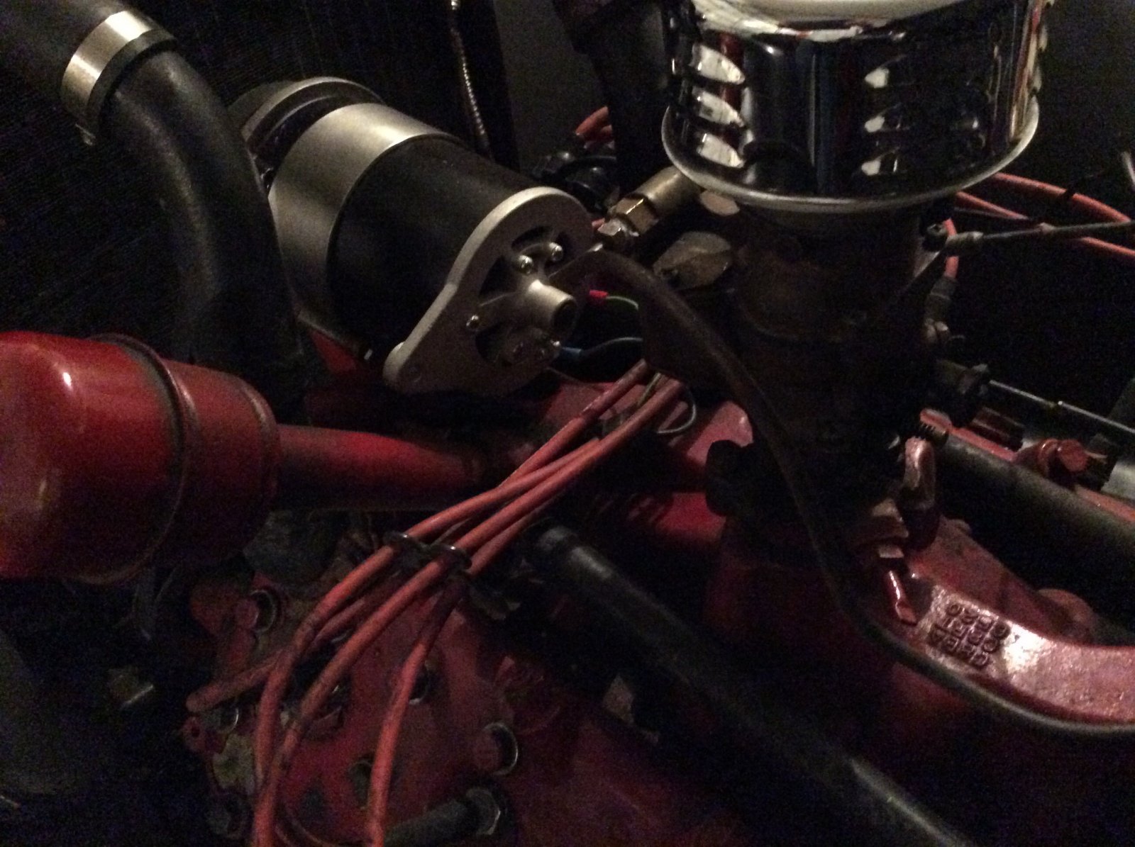

    image.jpg image.jpg After trying to find a generator,
    I used the same type alternator, called a dynamator and adapted it to my flathead, even though they said it couldn't be done. Haven't sorted out a fan yet, but has been great for last 6 months. Have still to trim original brackets.
