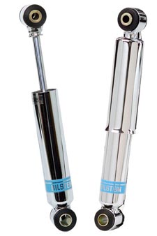

  14. 31pickemup
    Joined: Apr 9, 2006
    Posts: 1,303
    31pickemup
    Dennis I love this thread. But I have one recommendation for you. I would ditch the SoCal shocks, I bought Bilstein shocks from Posies and it was the best decision I ever made. They're a little bit more money but they changed how my truck rode completely. It was a totally different truck after I put them on.

  16. Dennis Lacy
    Joined: Apr 27, 2008
    Posts: 1,461
    Dennis Lacy
    I'll have a look at the Bilstein shocks in the event these covered SoCal versions can't fit. From what I remember they are fairly modern/street rod looking?
    Thanks for the input. I used a pretty tall castle nut on the lower shock mounts so I could definitely free up some clearance by running a shorty nut and a spacer between the shock and shock mount. I bet I can shift the shocks close to a 1/4" forward and that would most likely do it. I could also make a sleeve to slip over the inner most threaded part so that the entire lower shock bushing is still supported.
    I'm anxious to get this ***embly back under the frame next week for multiple reasons, one being so that I can start playing around with the upper mounts. There's usually always a way to make something work. :cool:

  19. 31pickemup
    Joined: Apr 9, 2006
    Posts: 1,303
    31pickemup
    They look like SoCals to me. You can get them in black or chrome. They blow SoCal's away.

  21. Dennis Lacy
    Posts: 1,461
    Dennis Lacy
    Those do look essentially the same. I must have been picturing something else. When you replaced the SoCal units were they new or relatively new?

  24. 31pickemup
    Joined: Apr 9, 2006
    Posts: 1,303
    31pickemup
    Dennis the SoCal shocks were new.
  25. CTaulbert
    Joined: Apr 8, 2007
    Posts: 1,337
    CTaulbert
    from Detroit
    Unless RCD changed, they stopped making the Bilsteins with the flared covers like the So-Cal shocks. It ****s, because that small detail is a breaker for me. I'm running So-Cals on my stuff right now only due to the cover. The last time I talked to RCD, they said quality issues with the covers prevented them from selling the covered versions anymore.
    By the way Dennis - this thread has been great to watch the progression, and the detail is invaluable as well.
