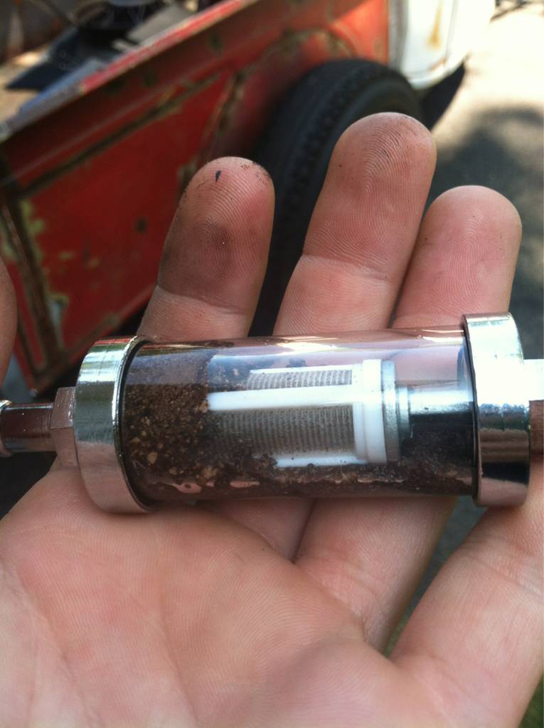

    Well! Got about 500miles since its been back and running! (2 weeks! Wooo!) and ran into my first running issue. Drove to the hardware store today and when I was under heavy load or quick acceleration the truck was missing. Got home and did the basic checks. First thing. FUEL. Gl*** filter is 95% clogged with rust from the fuel tank. Thought I got it all out but I guess not! Cleaned out the filter and back up and running!!!!

    Don't know what kind of gas you have there but the ethanol out here is REAL good about cleaning **** out of your tank. LOL

    oh it's cleaning it alright!

    Dont fart around changing the filter. With dirt like that you need to remove the tank and have it cleaned. Lines blow out too.

    The lines are all new and the one to the filter is only about a foot and a half long.... Just gotta burn through this tank and see what I can do cleaning it out! I thought it was cleaned already but I guess not haha :D

    Pull the tank and take it to a radiator shop and let them hot vat it,with all that **** in the tank this is not going to stop anytime soon. HRP

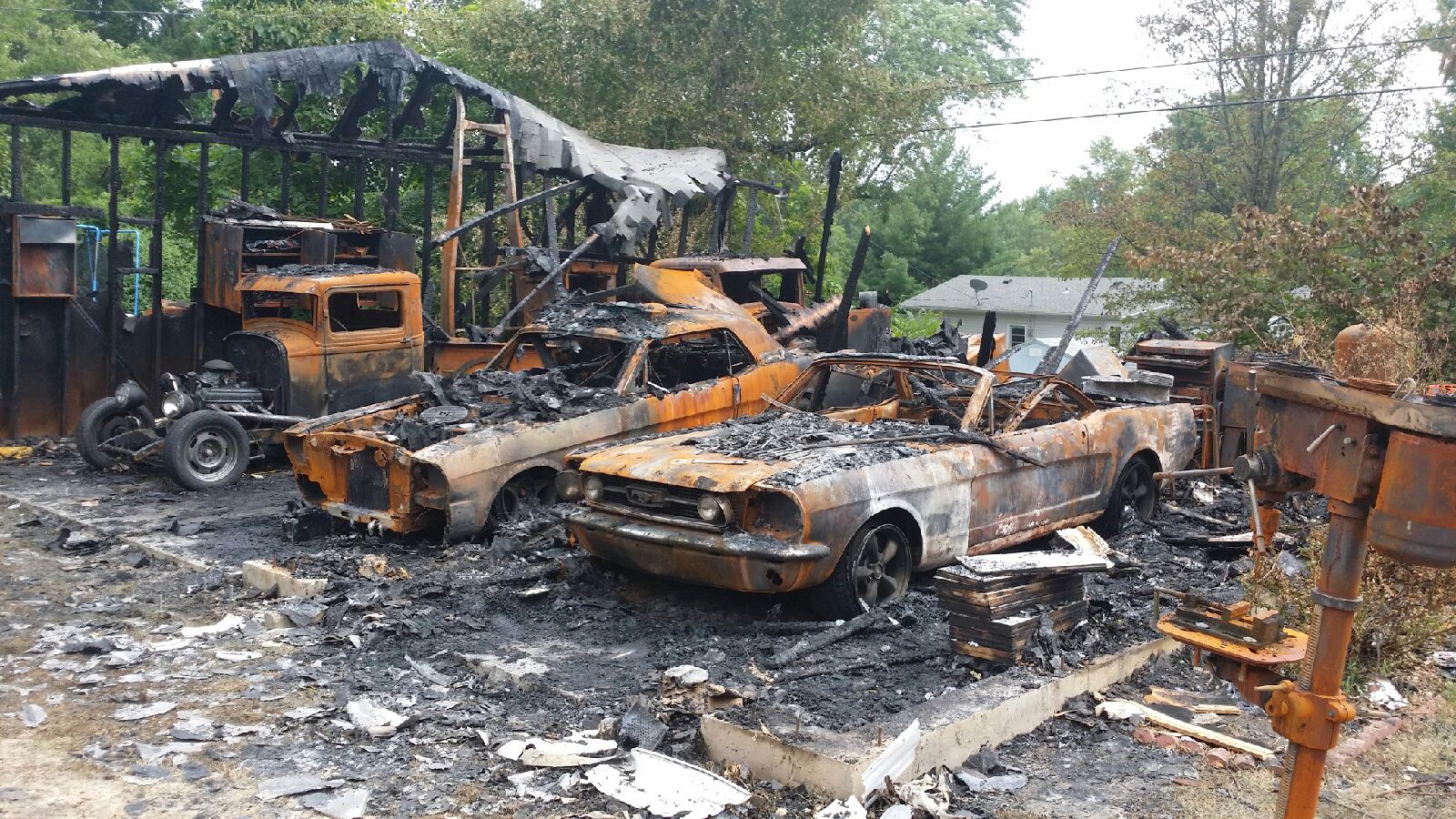

    Glad to see your making great progress. ... here's one that's not the best looking 32 right now.... but it will rise up from the ashes. A buddy of mine ... here on the board is 12BAGT had a fire burn his garage last Thursday night. Lost alot of stuff burnt we are planning on rebuilding the pickup. Gotta get the garage rebuilt first.

    Started cleaning up Saturday. Of the 3 the truck is the only one we can salvage.. we got a lot of work to do this winter.

    Holy ****... What sad looking pictures. A shame to see the other 3 totaled. Good luck! And hope, he and everyone else were alright.
