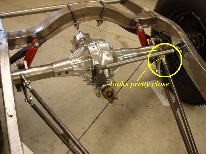

    Was wondering if you think you have enough clearance between your new panhard bar and that ladder bar. Do you plan on limiting suspension with rubber snubbers over the axle?

    flthd31 - I think that photo just has a bad perspective of the clearance between the panhard bar and ladder bar. There's actually a lot of clearance there.
    Well tonight, I notched the gas tank so I could bolt it to the frame. After that, I took some measurements of the gap to the body, and cut the rear frame horns off. I split them in two on the bandsaw, and opened them up in a wedge shape about 1/2". I filled that with a filler piece, and welded them back on the frame. The end product was raising the gas tank up about 1/2" to tighten up the gap to the body. The kick-up on the top of the rail is hidden by the body, so it's a bit subtle. The body isn't bolted down in the photo below, but the gap tightens up to about 1/4-3/8" now.
