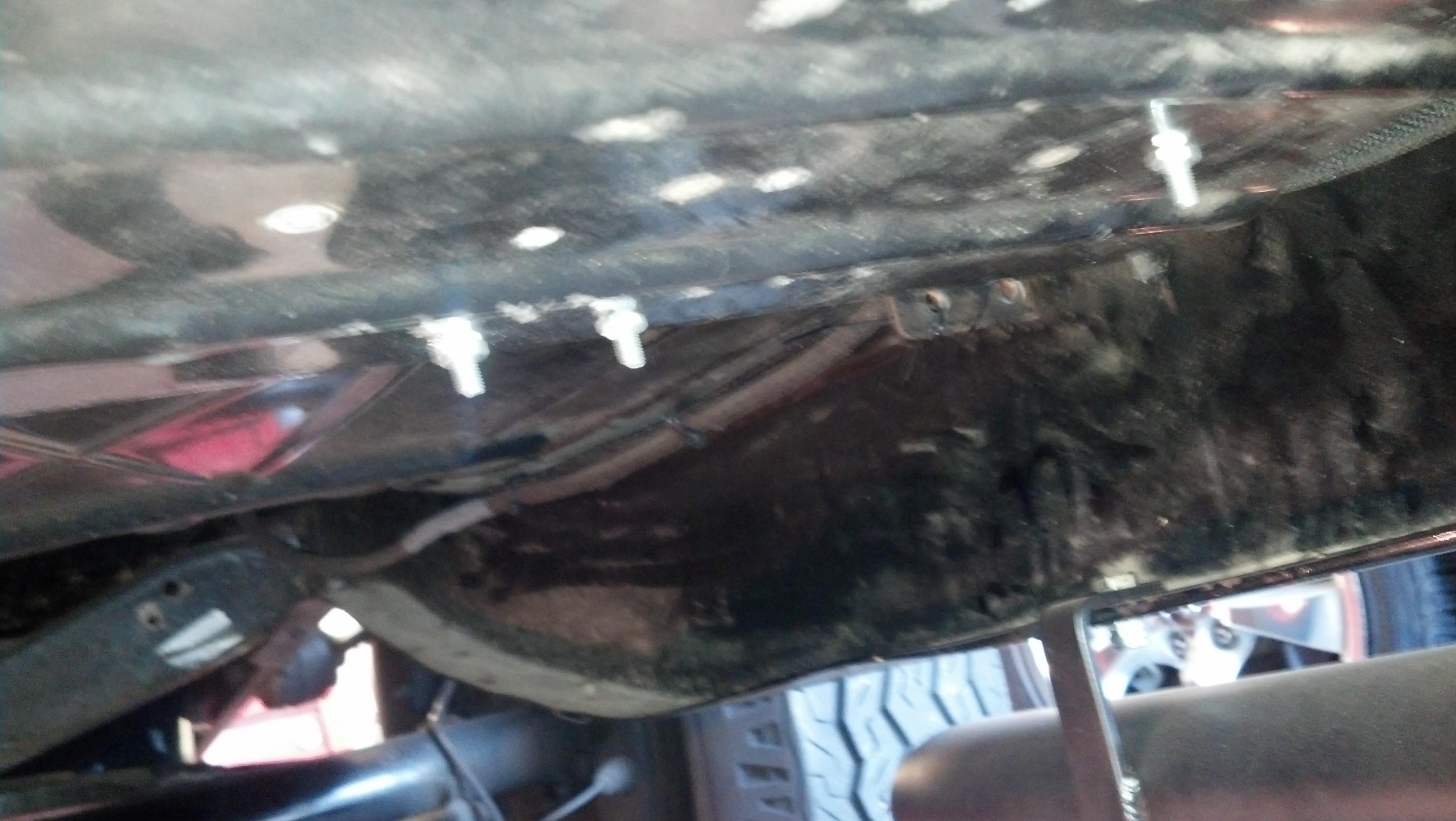

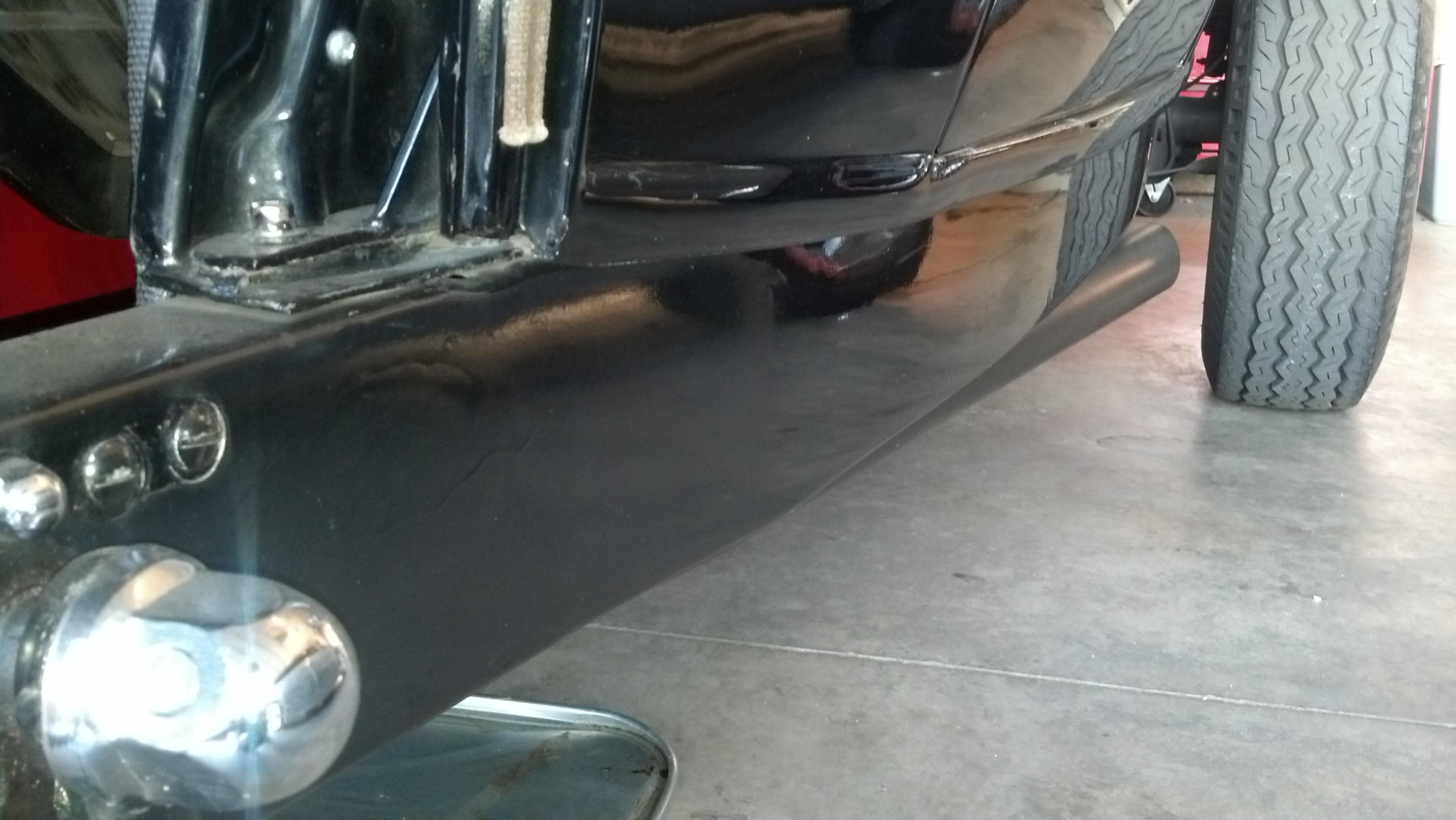

    It obvious that this is a modified frame with a bunch of holes being filled ,like the fender holes ,steering on the p***enger side ? How does that look from inside the rail? Is the body real?
  30. Lucky Mike
    Joined: Dec 30, 2012
    Posts: 94
    Lucky Mike
    Modified might be a streach. Yes, there are several of the holes filled. The orignal builder told me this. Here are some pictures of the rails. No, the body is not original. This frame was originally a truck, just like the one pictured below.
