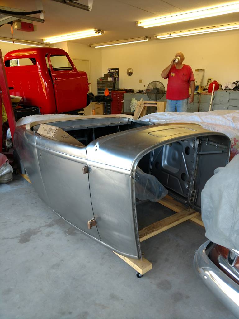

    Today I got body ready. Next need to weld rear fenders studs and nuts. I like that original style , even never gonna bolt on any fenders....
    Gauge panel is fitted and holes made.
    Today I ordered 8meters 1" OD tube for seat frame material.

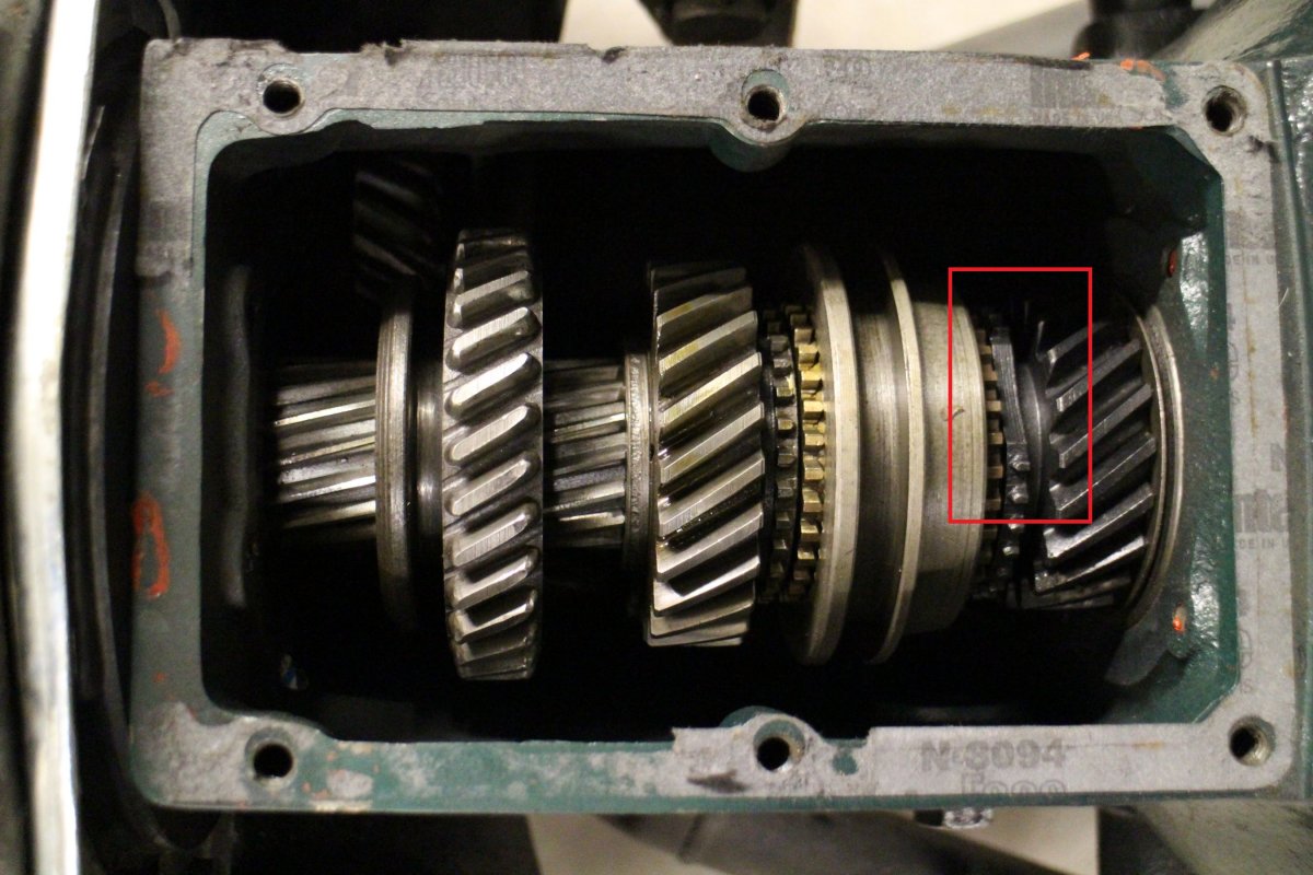

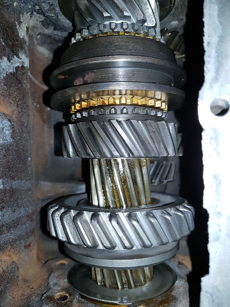

  5. Photo of inside of trans with regular Ford gears...not sure why there is the area on yours without the teeth that engage the synchro rings? I'm wondering if it could be to aid quicker

    You´re right, syncroring modifications are give quicker shifts... I have had many times in my Muncie 21 and 22 ******s modified syncro rings.
    I need to calculate all gear teeth. I have one 1939 Double detend ****** rebuilt, so I can open both and compare.

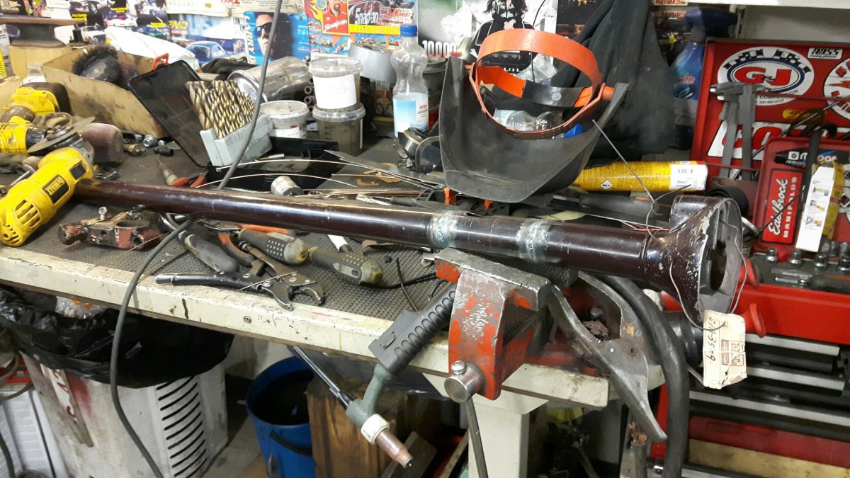

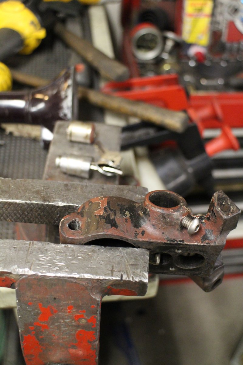

    Opened steering box and shimmed it. Im not using that BB ford "long column" steering box. Column tube will be original 1940 ford NOS stuff.
    Column drop opened and bored lock out. I do not know if somebody is selling reasonable price 1932 column lock, so I used 1936 Ford steering lock. Easy to change original 1932 lock, if buy one new.
    Woods also bored and installed on the body. I picked up today 12meter 25mm x 2mm tube. Need to make frames for seats. also bought 4 sqm 1,5mm aluminum (interior panels).
    Tomorrow I get steering ready.
    aulis

    Column ready. Original 1940 NOS column is now "destroyed".
    Aulis

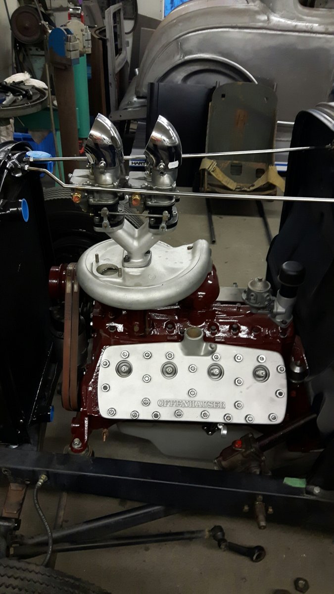

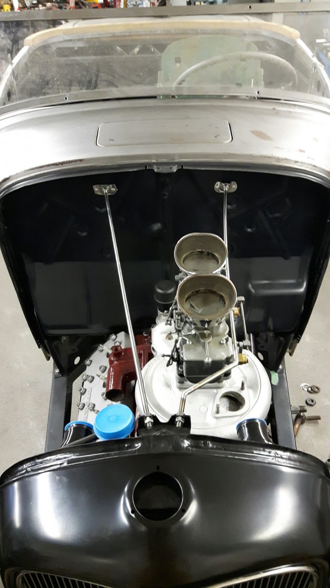

    Nice build! Just curios why you didn't want to move the supports rather than bend it to get around the carbs.

    Hmmmm.. Support rods; I do not want to change mountins. New expensive, good quality Walker radiator,.....Not want to change it..

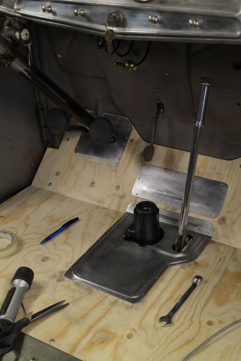

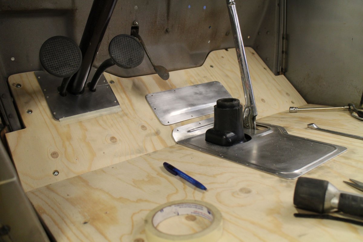

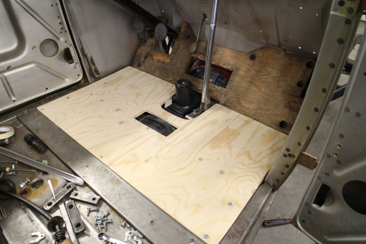

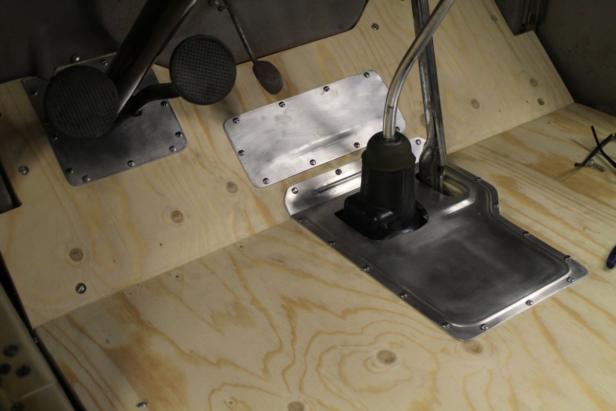

    Yesterday I changed firewall. I like more original firewalls than those new production ones.
    Original has all threads, holes,..... Bolted on original gaspedal etc.

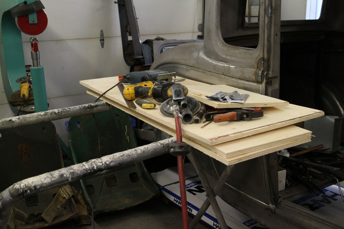

    I took my cabriolet original floor plywoods. I copy those and started to cut new ones.
    Steel ****** cover need to copy too, but make also some changes. Original 1932 ****** has "angled" shifter tower and I use this car 1939 DD ******, so shifter hole need to move. Some other dimension differences, but that is normal...
    Aulis

  17. This area makes it possible to have the cluster gear fully installed (with the shaft in) - and still be able to install the front main drive gear. That little cut-away (if rotated correctly) allows the synchro teeth to go past the cluster.

    Floorpanels ready and bolted on their places.
    First alum. cover plate is nearly ready. I copy original 1932 ford plate with some changes.

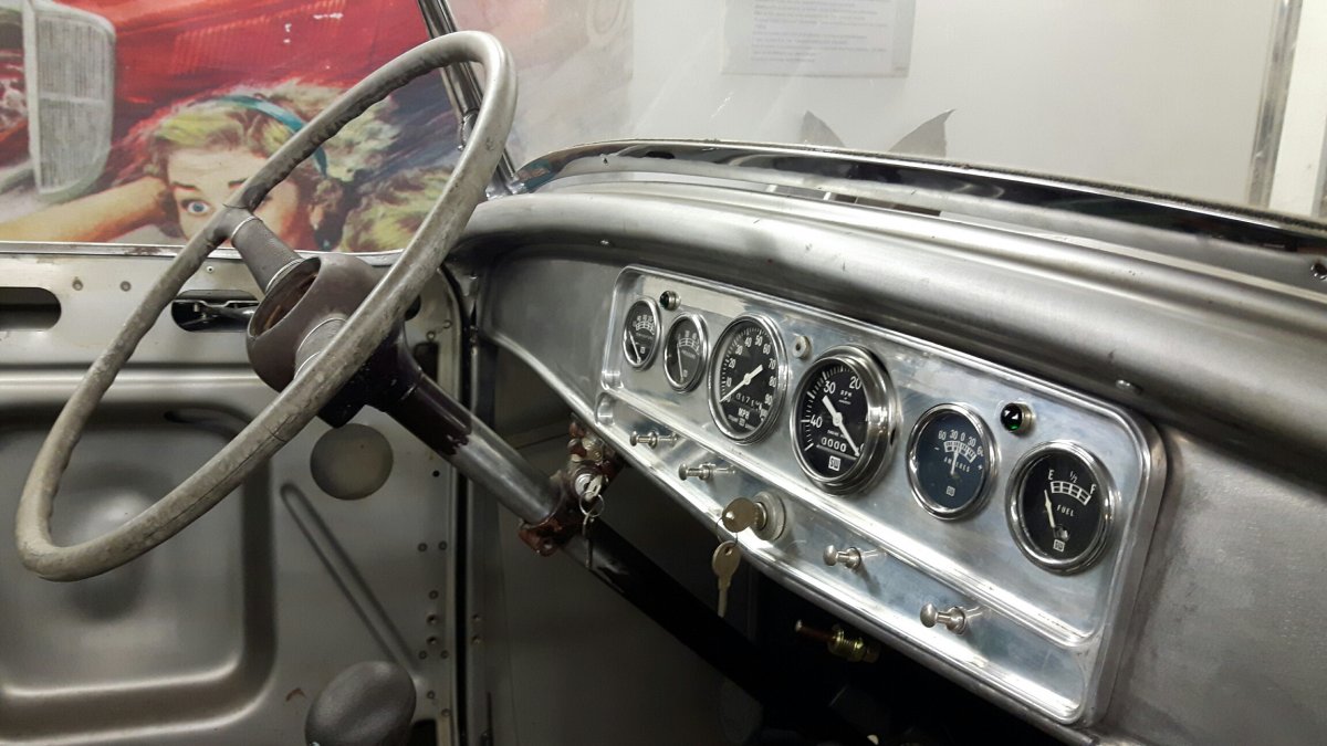

    What is dash insert from? Looking for one for 32 roadster as well. Like how that one has holes for speedo and tach same size. Let me know if you can thanks! Great project!! Great work

    I do not know who has manufacture that dash insert. Looks like aftermarket product.
    I bought that insert with gauges from here HamB. Seller has often interesting stuff here for sale (N***aublue65).

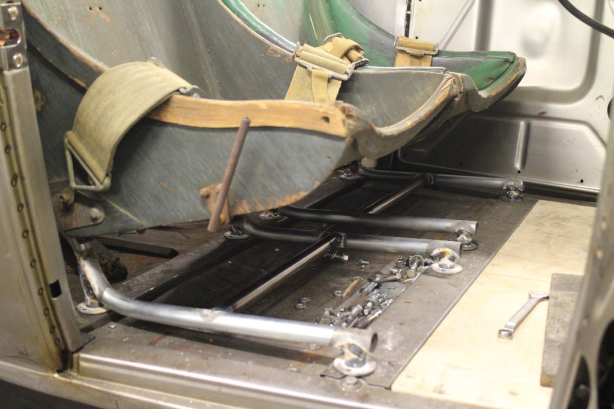

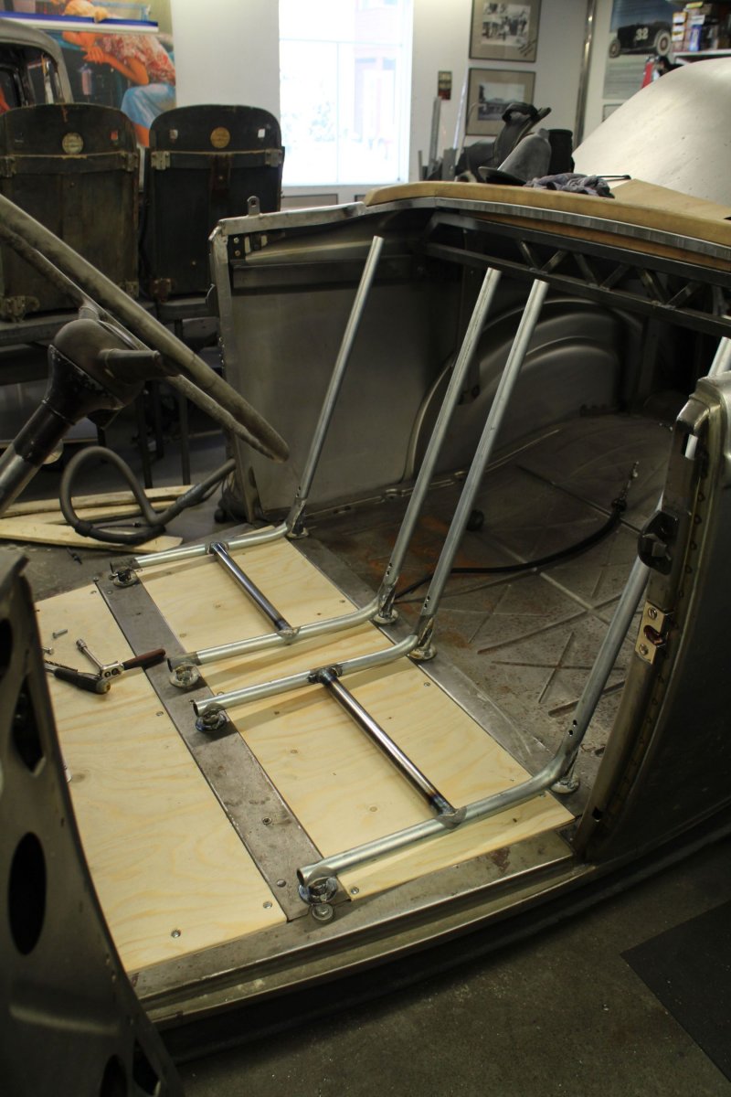

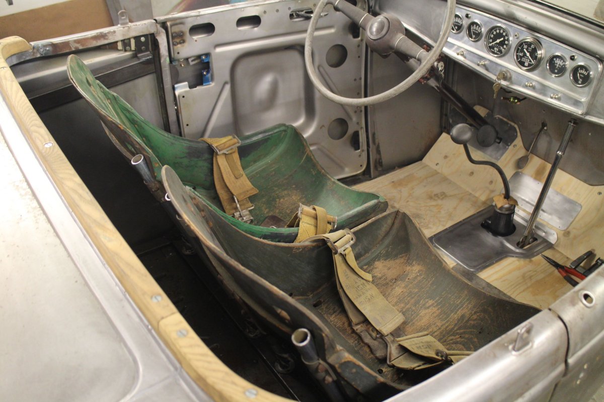

    Yesterday I bought 1" OD (0.01" material thickness) tube. I cut it 4pieces and bend to the right shape
    Today worked 8hours and seat frames are ready. I have never had so good seat in my hot rods like those old Friz Ziebard wooden seats. Feels good under my ****.
    Tomorrow I can continue with "racing" interior" (patch panels, door panels,..)
    AULIS
    IMG_4824b.jpg IMG_4823b.jpg IMG_4822b.jpg IMG_4821b.jpg IMG_4819b.jpg IMG_4816b.jpg IMG_4815b.jpg

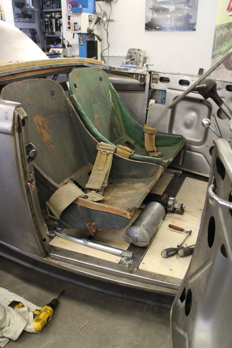

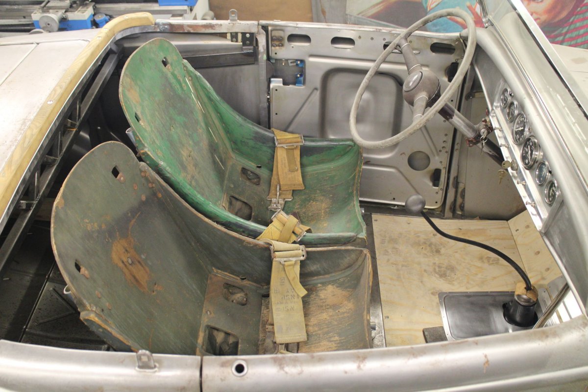

    One more floorpanel is now made wood (Under seats). Steel panel is for sale (see ad in -parts for sale).
    Also drilled holes to the body and bolted on seat frames on their places.
    Alum. plates bolted on using flat slotted wood screws.
    30´s Standard Oil companys First help -set (round alum. tube) bolted on.
    Old Fire Extinguisher bolted on between seats.
    I drilled 3 set holes to the seat frame tubes. easy to lift or set down seat, just turn handle and adjust.
    AULIS

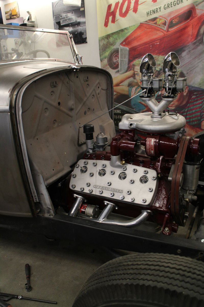

    Are those Smith heads you have on that motor? I love the heads that have the water logs.
