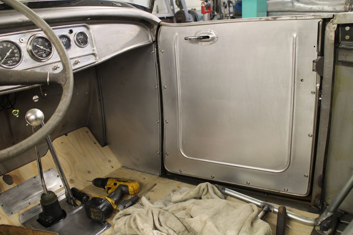

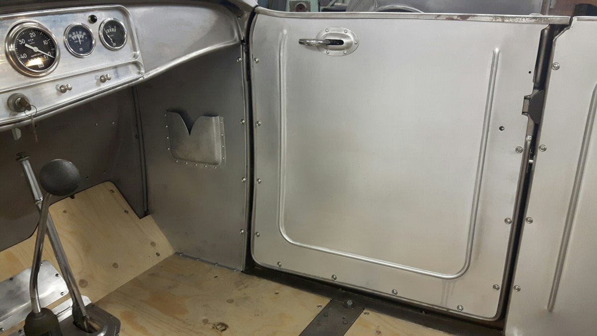

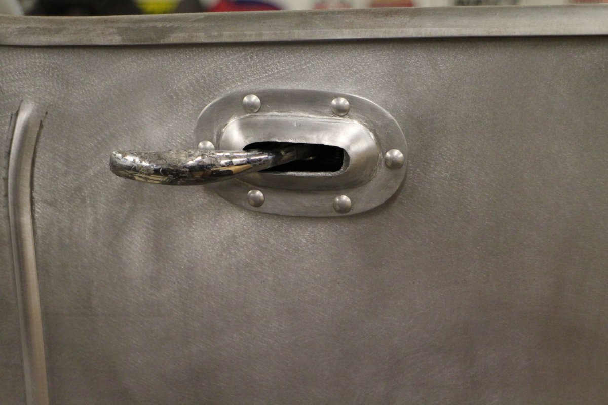

    Here new pics. 1st doorpanel is "semi ready".
    First escutcheon looks not so good, but second one is better.
    I want to keep interior simple. Race.
    Aulis

    Today I made driverside doorpanel. I made new escutcheons, those are better outlook than 1st prototype. Tomorrow I made cowl panels, that is easier job.

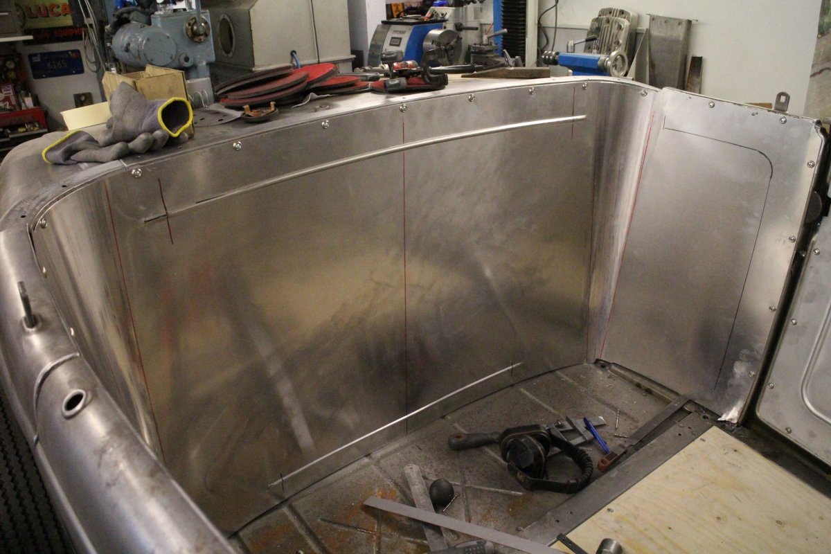

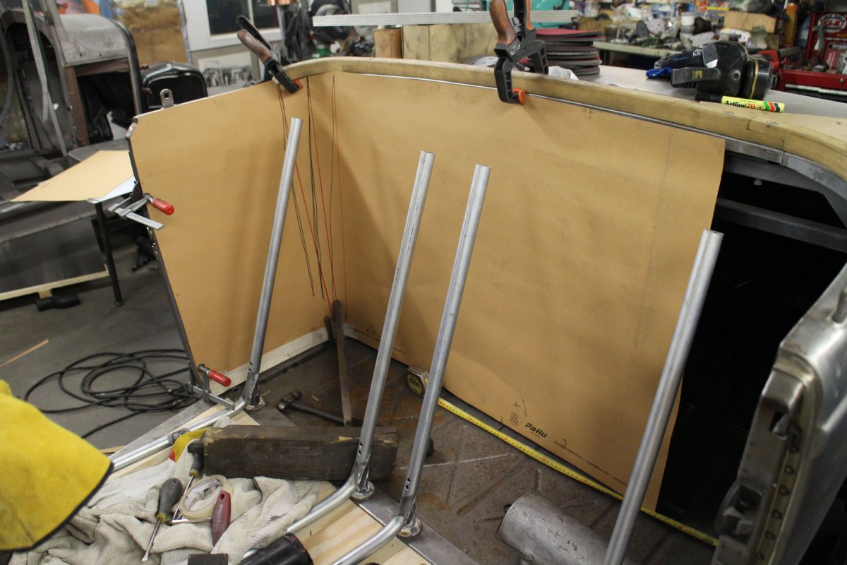

    Last and biggest job is to make one piece panel behind seats. Need to measure and make plan how to do it.
    Sides + two corner + rear. Im not sure how it goes,.... If not try, never know.
    Aulis

    Today get ready cowl side panels. Looks maybe too simple, but I do want to make any extra bead.
    Also started to make one piece rear panel sketch. IMG_4873b.jpg IMG_4871b.jpg IMG_4868b.jpg IMG_4865b.jpg

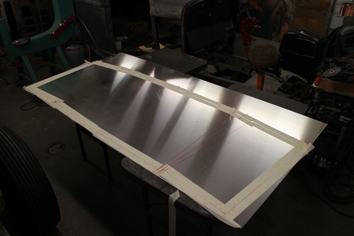

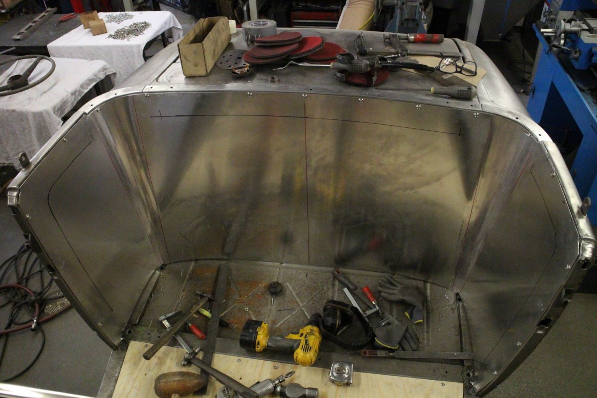

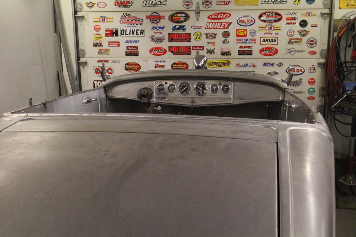

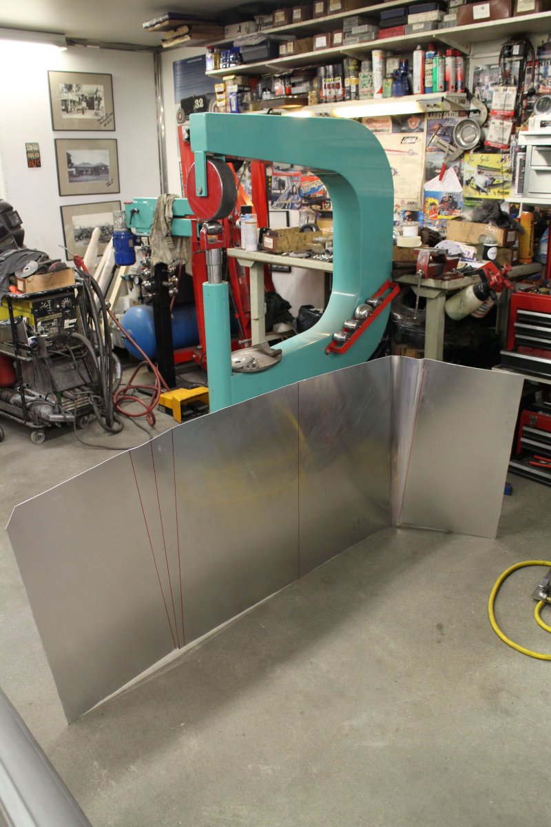

    Hard day. Today, Saturday, I started 6.00 Morning to cut rear piece (2meters long , nearly 7feet). After nine hours panel is ready. Still need to work with it, but 90% ready.
    Hands are now like "paste". It´s rather heavy job to work with english wheel alone, when have big panel.
    Side beads need to make outside. My garage is too low.....
    Aulis

    That looks great! I thought you were going to make it out of multiple pieces of sheet... now I understand why you were having space issues with your garage!

    Thanks. I decided to piece my bead roller machine tomorrow morning. If I take foot off, then I can put machine lower and I can make those last beads. If get machine 2feet lower, then I have enough free space to work.
    Sometimes low and small garage is not so good, but..... I like that small garage feeling....

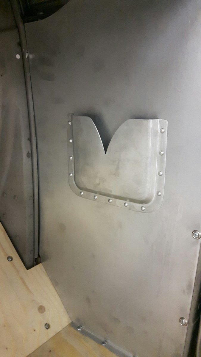

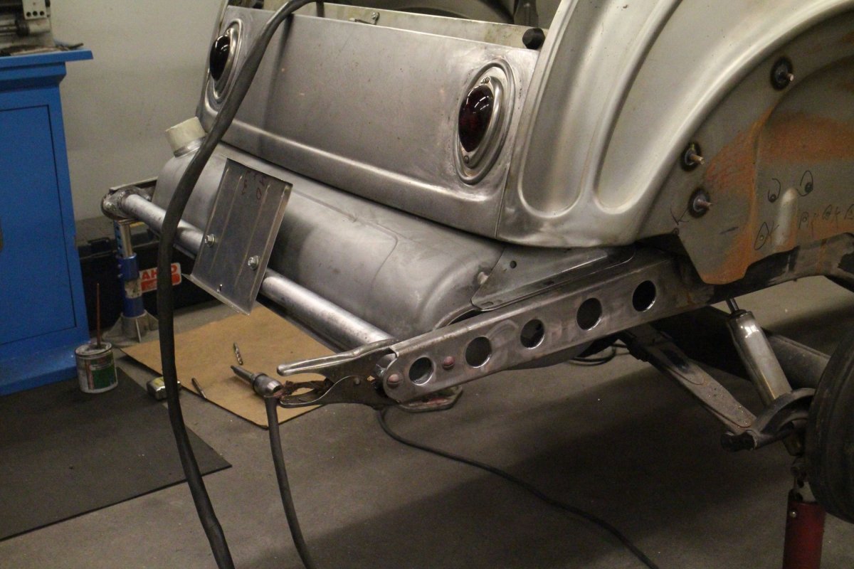

    Today (Monday) Morning I made this "phone and paper" -pocket and installed it.
    Still need to make rear frame support tube. Flanges are laser cut and ready waiting for.
    Im not interested in to use those SS tubes. Front I have original tube with lic.plate holder.
    Aulis

    Here rear tube. I used old tube and flathead headers flanges....

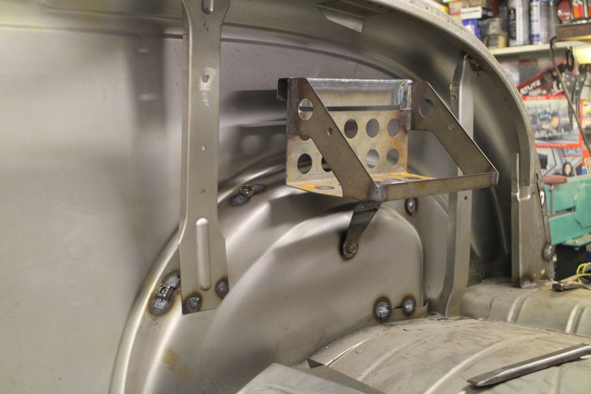

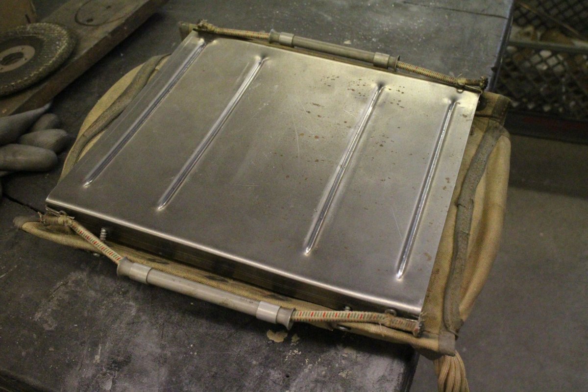

    Today need to continue making battery box in to the trunk. Normally I like those original style battery boxes/locations (under floor) but this frame they have added 1934 style long frame support from K-member to rear and that´s why there is no enough free space behind K-member.
    Mufflers arrived yesterday. I use new very short (10", 250mm), free flow mufflers. Big Flathead sound is so nice, why to hide it....

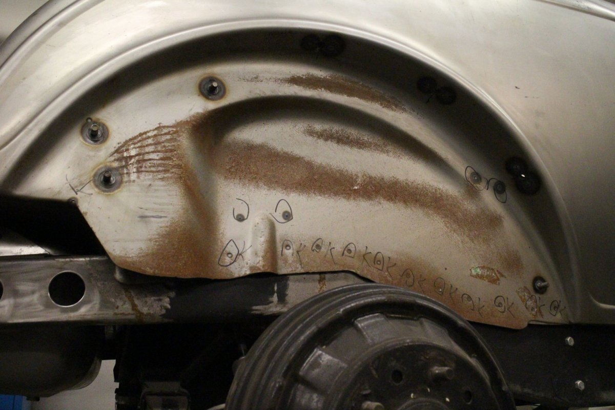

    I tig welded rear fender studs and squared nut to the rear quarters.
    I like those orig.style mountings. Now orig.fenders fit good.
    Yesterday I started to bolt off doors, floors, interior.... Saturday when when we come home, I call two friend to lift body off. Need to make outside of my garage own "painting room". Racing Pit tent (6m x 3m) with walls and liquid gas warmer. There I paint all "acid" paint etc etc (I do not know right words for those paints). Only final colour in real painting room.

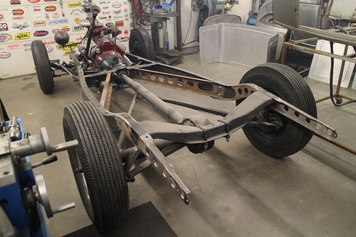

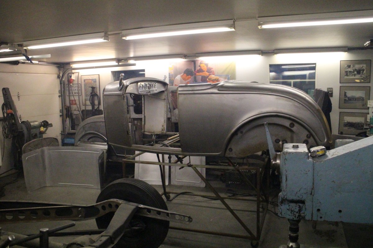

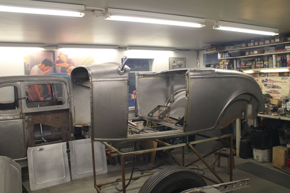

    Body lifted up. Also welded togetger batterybox and same time take round over body and rewelded some factory weldings.

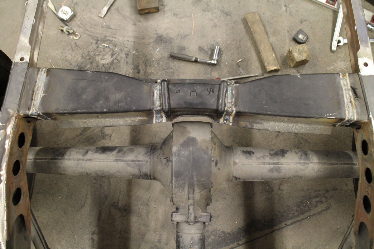

    Tomorrow can start working with frame, brake master cylinder, rear axle, rear crossmember need to "drop".....

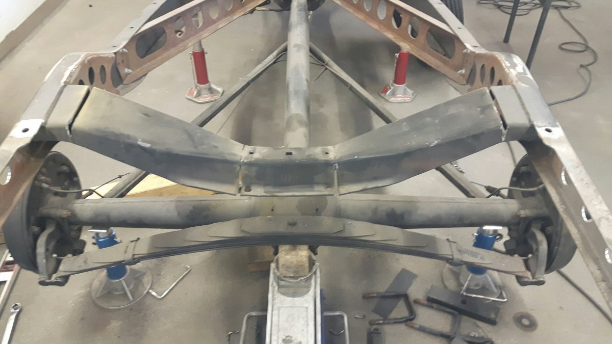

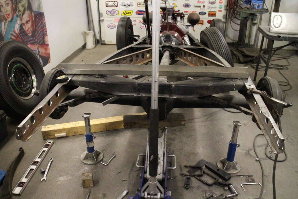

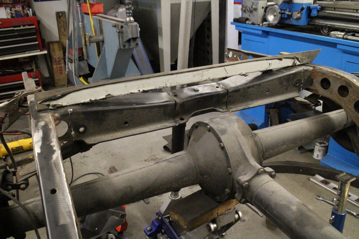

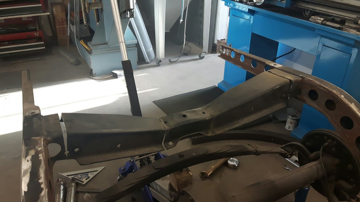

    Here today afternoon result. I was ordered from USA new 1940 "dropped" rear crossmember.
    First I think to change crossmember, but today I decided to cut and drop original member.
    Now frame is 3" lower than earlier.
    I know that now rear tires are fill all rear inner fender area. Front end is too high, but
    I don´t want to use drop axle....... I like those 1932 Heavy axles. 50" Wide, heavy, and outlook is perfect.
    New tires are coming from USA. Rear tires are higher than old ones (old 7.00-16 and new 7.50-16) and new front tires are lower than old ones.
