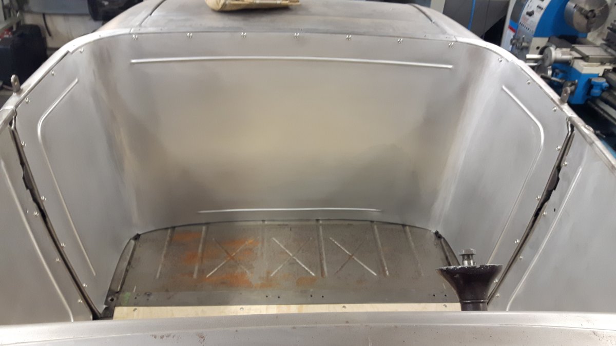

    Brakepedal mechanism looks strong and tig welded good. Exhaust tubes, and brake lines are missing. After that Im ready to stard grind and fix frame for painting. Yesterday Morning I was fix body all around and cut off cowl top.
    They had welded it together with cowl sides (brookville). I want that cowl top is original style bolted on.

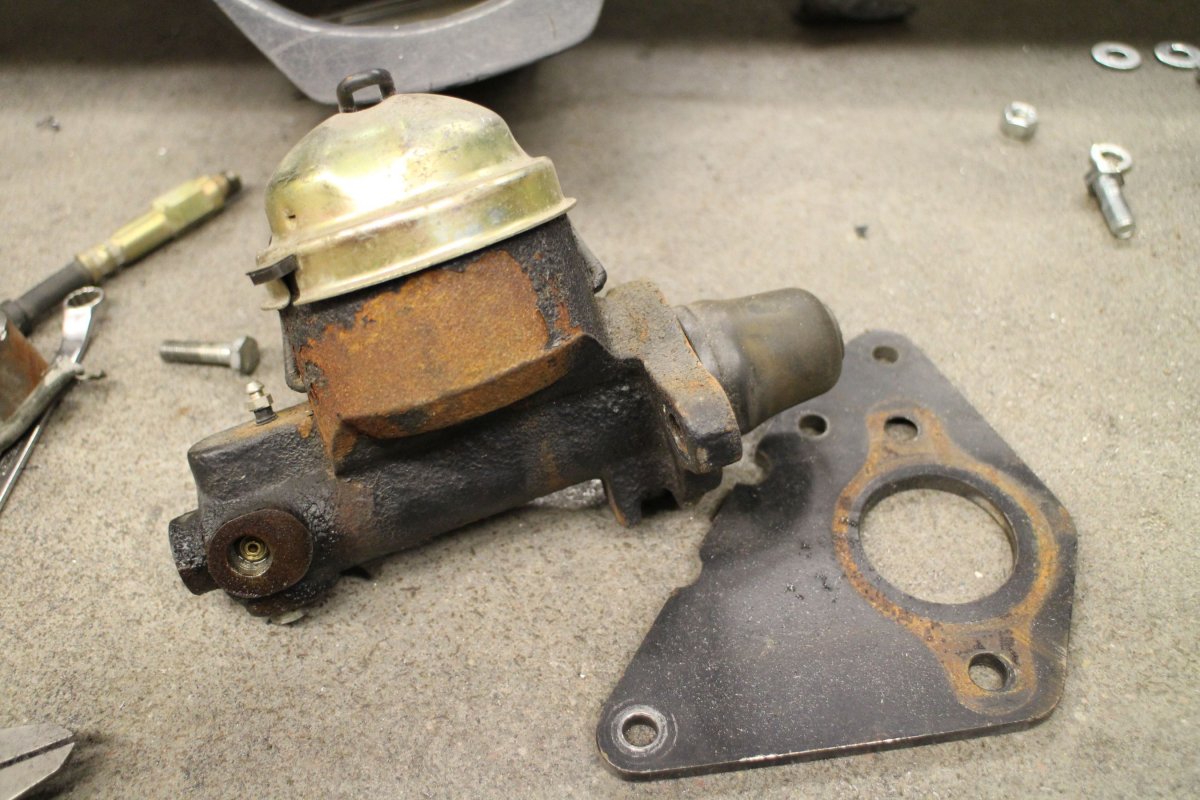

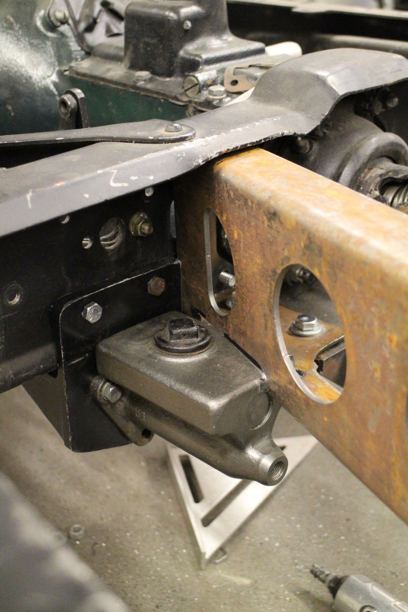

    Today I removed 2bolt mounted main cylinder + bracket and installed 1939-> ford cylinder + hot rod bracket.
    few hours cuttin, welding, lathejob and all sit there.
    What is that 2 bolt mounting brake cylinder?

    No idea on the master cylinder.
    Do you have any idea who or what or where the adapter kit is that you modified?

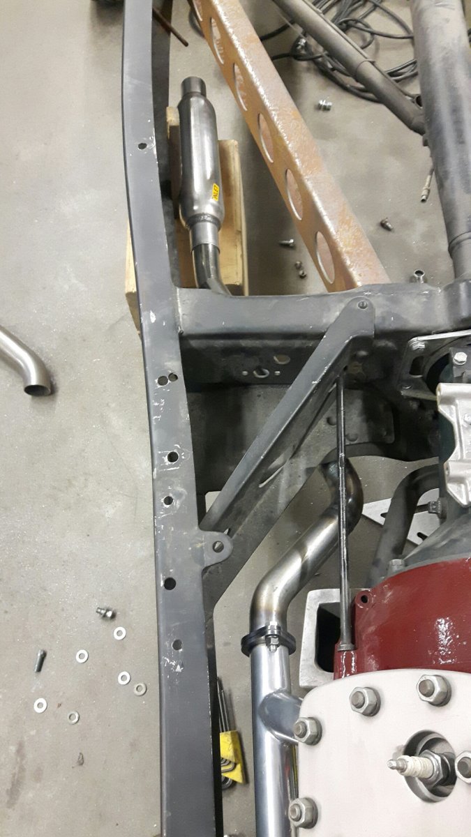

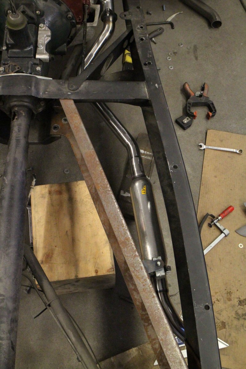

    Started to make exhaust. Last week got those 10" long mufflers.
    Tomorrow more pics when both sides are ready.

    My apologies if I'm misunderstanding the role of that part that you machined on the lathe.
    If that small turned diameter (and radius) is any part of your braking system, I'd consider redesigning it, does not look adequate, only thinking of your safety.
    Even for a clutch pivot it seems a little "iiffy".

    Yes, part is to brakes. Do not worry, finnish steel is good quality.

    P*** side exhaust ready for painting. IMG_4938b.jpg IMG_4935b.jpg IMG_4934b.jpg IMG_4933b.jpg

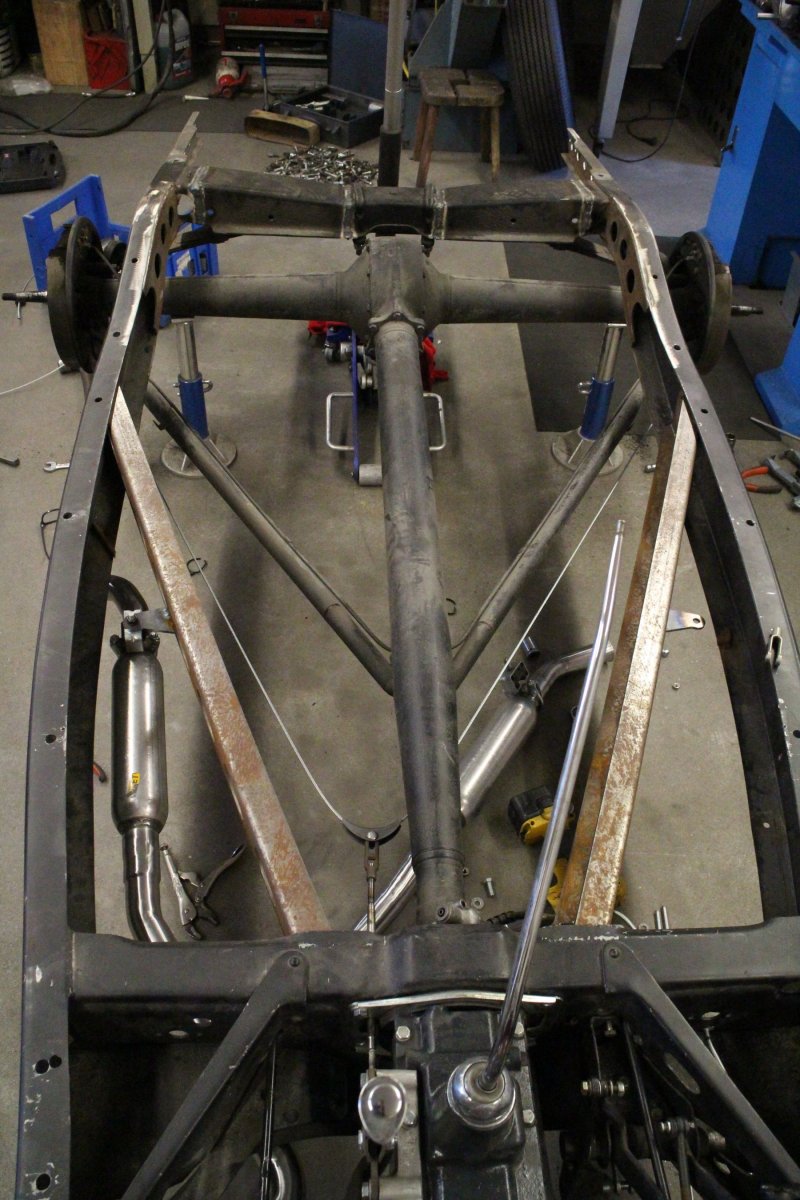

    Today need to make Driver side exhaust tube and during weekend Brake lines Front and something else small things.
    We have here not normal weather.... This time year normally nights can be around -10dec celcius and days are near zero, but now nights are -20dec celcius and days -10.....
    So, snow is still staying and springtime is not coming so early like few years earlier.
    Next week they have cold in Middle-Europe too. Siperia cold weather (I have been working 25y ago in Siperia max -40dec celcius when I was there) is "push" in to the Germany and there..... Their houses, heating systems are not so good like we have here.... We have here very good insulated walls, top, 3-4times cl***es.....
    Like Will wrote me, he has done that 1940 rear axle job to my 1932 frame. I like that job quality. All fit 100% and all looks like original 1932 style. When built hot rod, all not need to be original, but need to respect original deuce style with own rebuildings, part changes, hi-perf parts.....
    Hope that end of next week I can lift up my 3meters x 6meters racing pit area tent.
    That will be my "painting room".
    I have used Ford flathead header flanges in exhaust connecting flanges. Also same flanges in rear frame support. Its good that now a days many companies have laser cutting machines. Very low price and good quality stuff easy to get.

    The master cylinder mounting plate that you removed and pedal lever that you modified are made by my Dad and I at our shop, Early V8 Garage, in Southern California, USA. They are designed to install using existing holes and no modification to pedals. We have been selling the kit for over 20 years now and have 100's out there all over the world. Unfortunately, the kit does not work with the add-on rear legs as you found out. The reason the master cylinder mounts so far to the center of the ch***is is to line up with the add-on lever AND to allow the battery to stay in its original location.
    The 2-bolt master cylinder supplied with the kit is a 1950's GM piece with built-in residual valves but I forget the original application. It is a 7/8" bore while the '39 Ford master cylinder you installed is considerably larger at 1-1/16". The lever had to be long enough for the push rod to p*** under the K-Member and because of the lever ratio we had to use the smaller bore master cylinder. Because you did not change the effective length of the lever you are going to have a very hard pedal with the '39 master cylinder. (We have tried it.) We have several customers who insist on the '39 master cylinder for early looks and have had them sleeved down to 7/8" bore for correct pedal effort.
