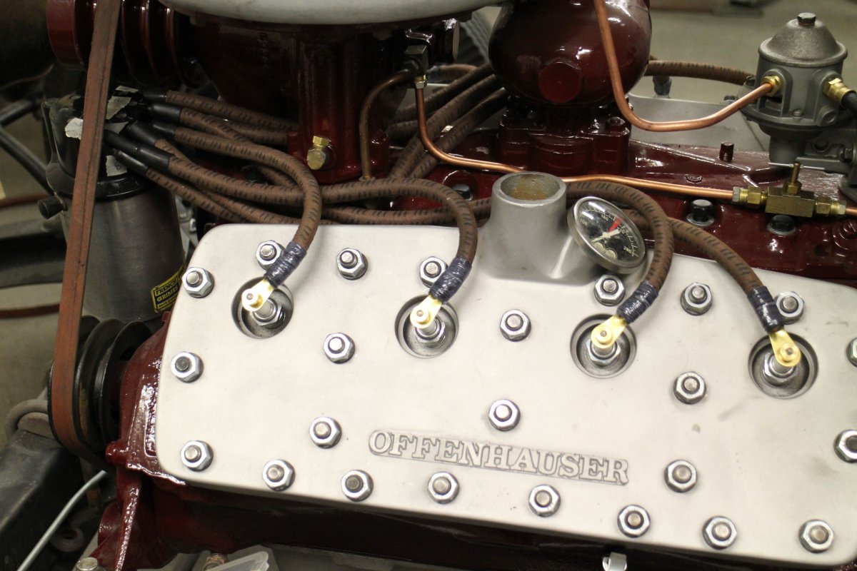

    Spark plug wiring ready. 1/2" OD brown vintage wire.

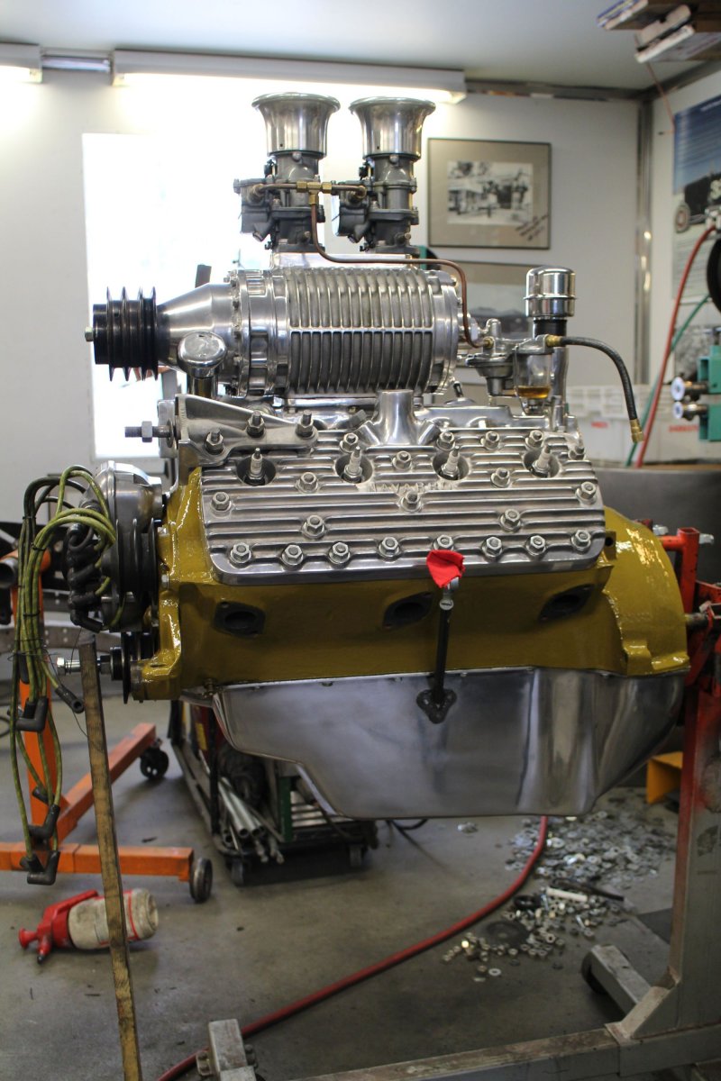

    Italmeccanica engine is rebuilt and this week I can continue working with roadster Project.
    Powerful engine, but I had problems with head studs. Never blow out head gaskets, but too many "soft" studs.
    I piece engine after used it all last summer. Now I have plugged total 30 thread/hole and made new holes middle of plugs + 7/16" threads. After that I plane decs straight and test moment all up to 90lbs.

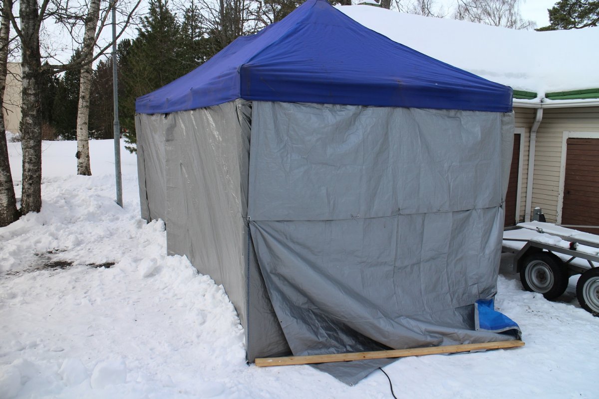

    "professional" (poor!) painting room is slowly grow up to my property. I still have one old 3meter x 6meter pit tent left. Not so good condition, but ok for me. Tarpaulin walls and it´s ready. I paint all primer, epoxy and filler in tent and only final 2K paint in my friends paintshop.
    Save time and money,....this is hot rodding.

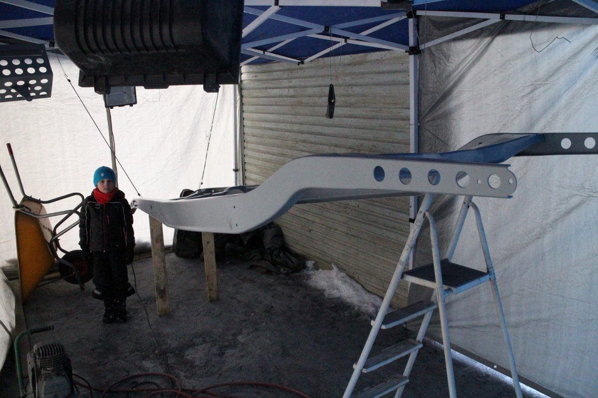

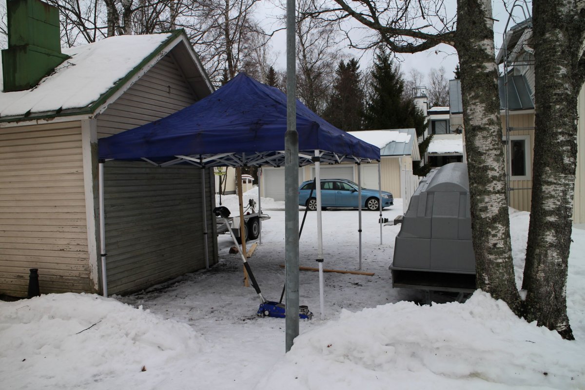

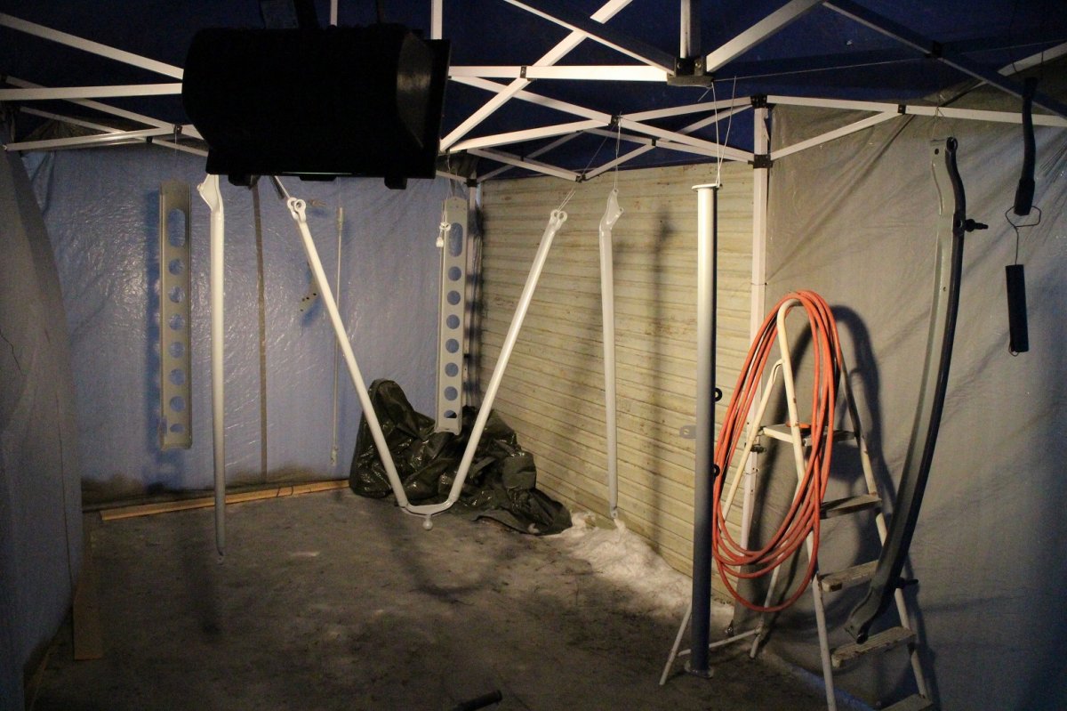

    1243b.jpg Thank You. Last days I have been lazy. Poorman´s paintingroom is ready another side of my yard.
    Cant begin to paint because nights and days are too cold. Normally this time year "thermic spring" is normal, but now we have extra much snow and cold...... Tent is warm very easily if outside is around zero decrees celcius, but if its minus 6dec like today (sunny but cold), there is not enough warm inside tent.

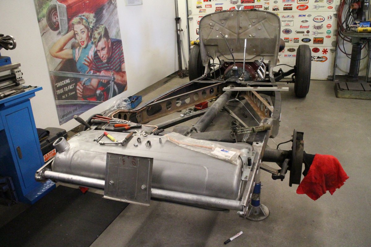

    Today empty frame and lifted up engine/****** to wait final installation.
    Tomorrow need to weld frame, make some holes and after that I all are ready for painting.
    Frame and body same colour, old style Basic acryl.
    Aulis

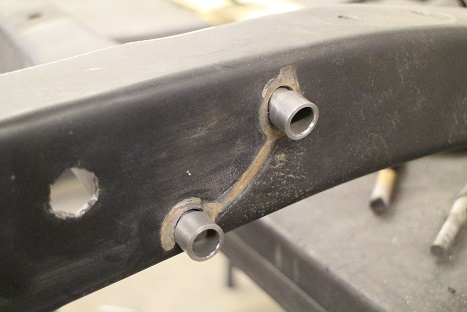

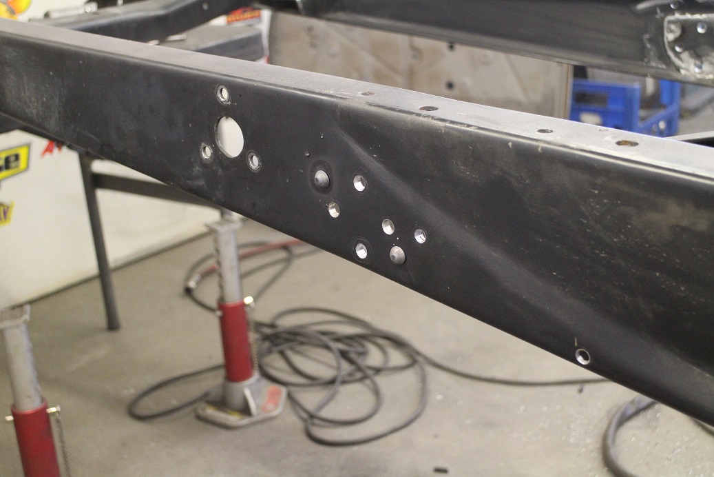

    frame welding, new rivets,.... Front shock mounting sleeves are not welded in picture. Later welded those from inside.
    Aulis

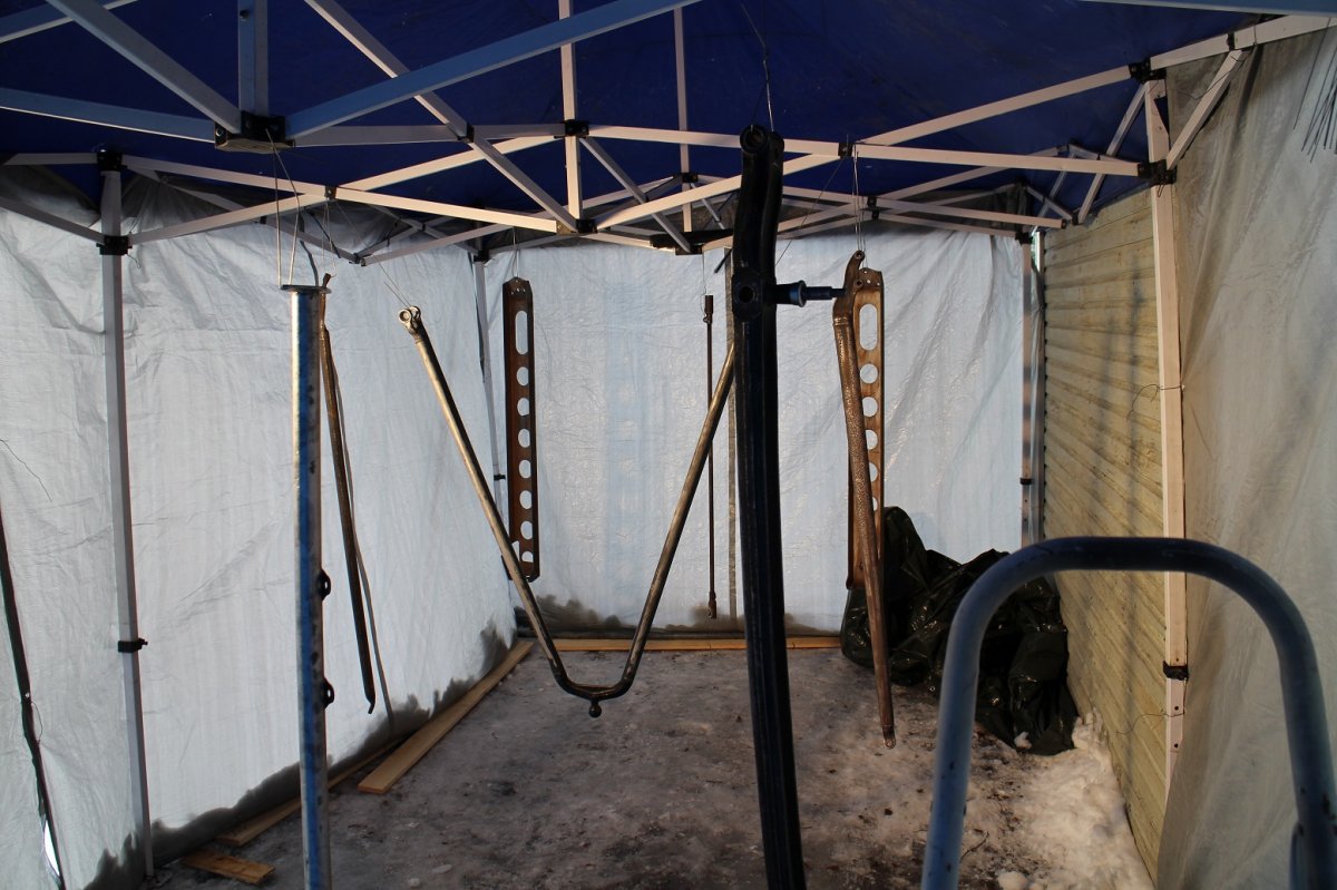

    Today I painted industrial epoxy primer some frame parts.
    Tomorrow frame, fuel tank, maybe some body parts or brakes parts.
    Looks cold outside...hahaa!
    Aulis
    nb. Now days are going longer and longer. Every week daily bright time is continue 60minutes.....

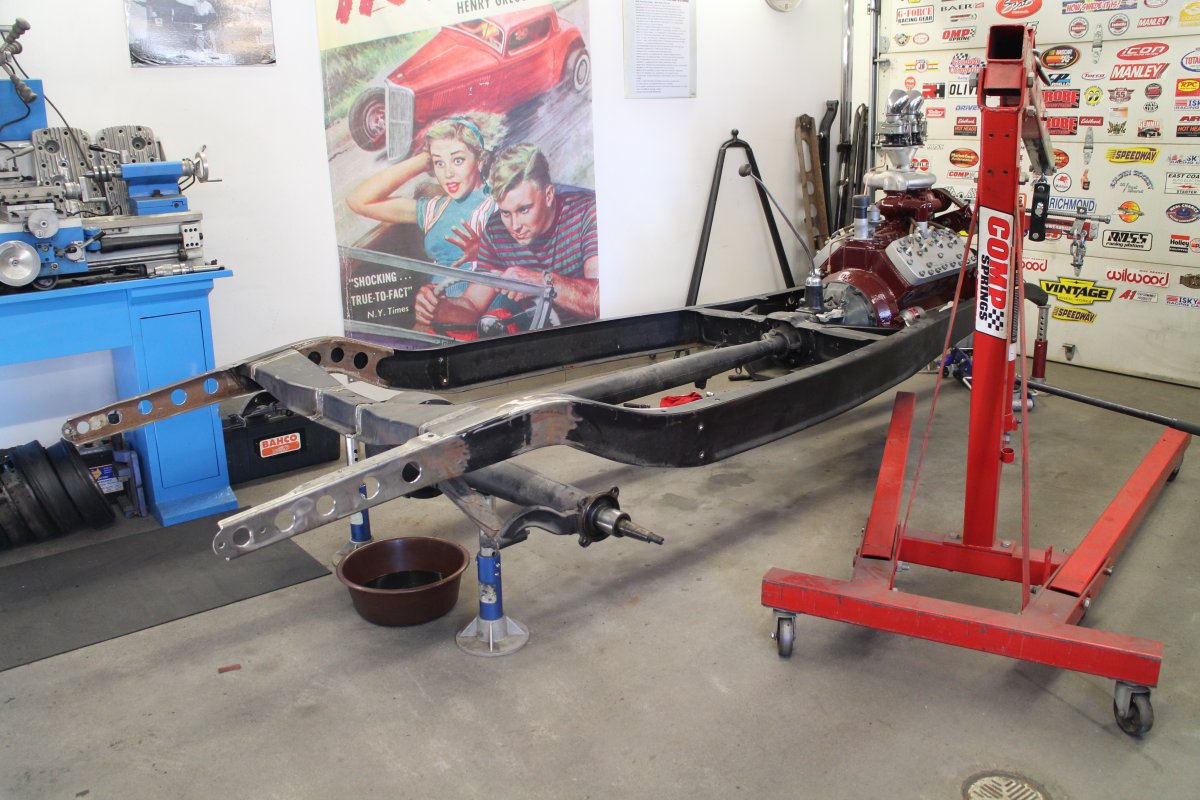

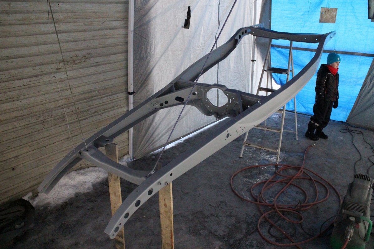

    Frame and inspector.
    Today I bought 3litre paint (body and frame) and 1litre (axles, springs, pedals, wishbones..). Glasurit 2K acryl.

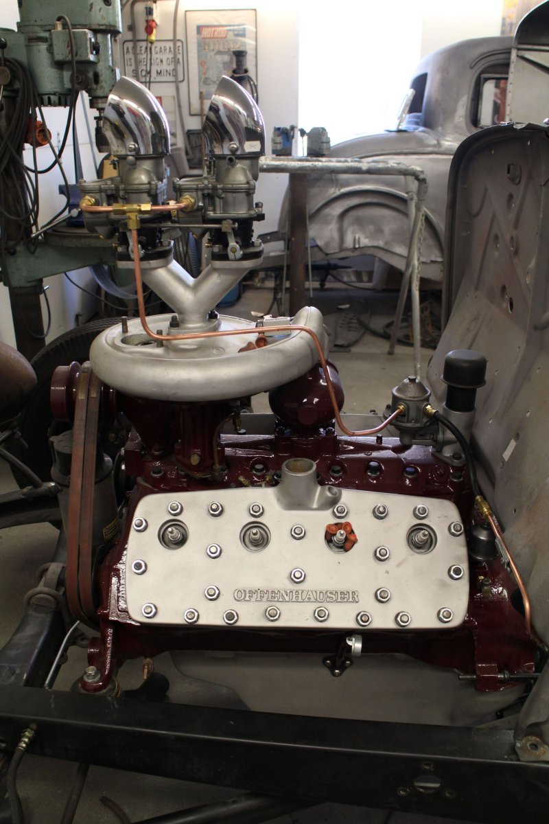

    I bought from here HamB some velocity stacks (seller has ad. in "parts for sale").
    Good aluminum and low price. I fixed 1hour those and now looks good when sit on carbs.
    Aulis IMG_5010b.jpg IMG_5011.JPG IMG_5012b.jpg View attachment 3844675 IMG_5019h.jpg IMG_5021b.jpg IMG_5022b.jpg

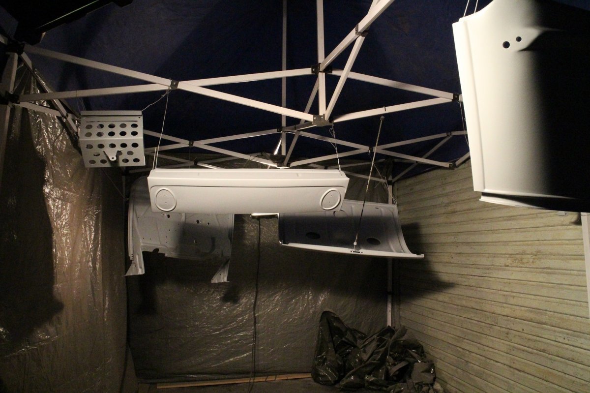

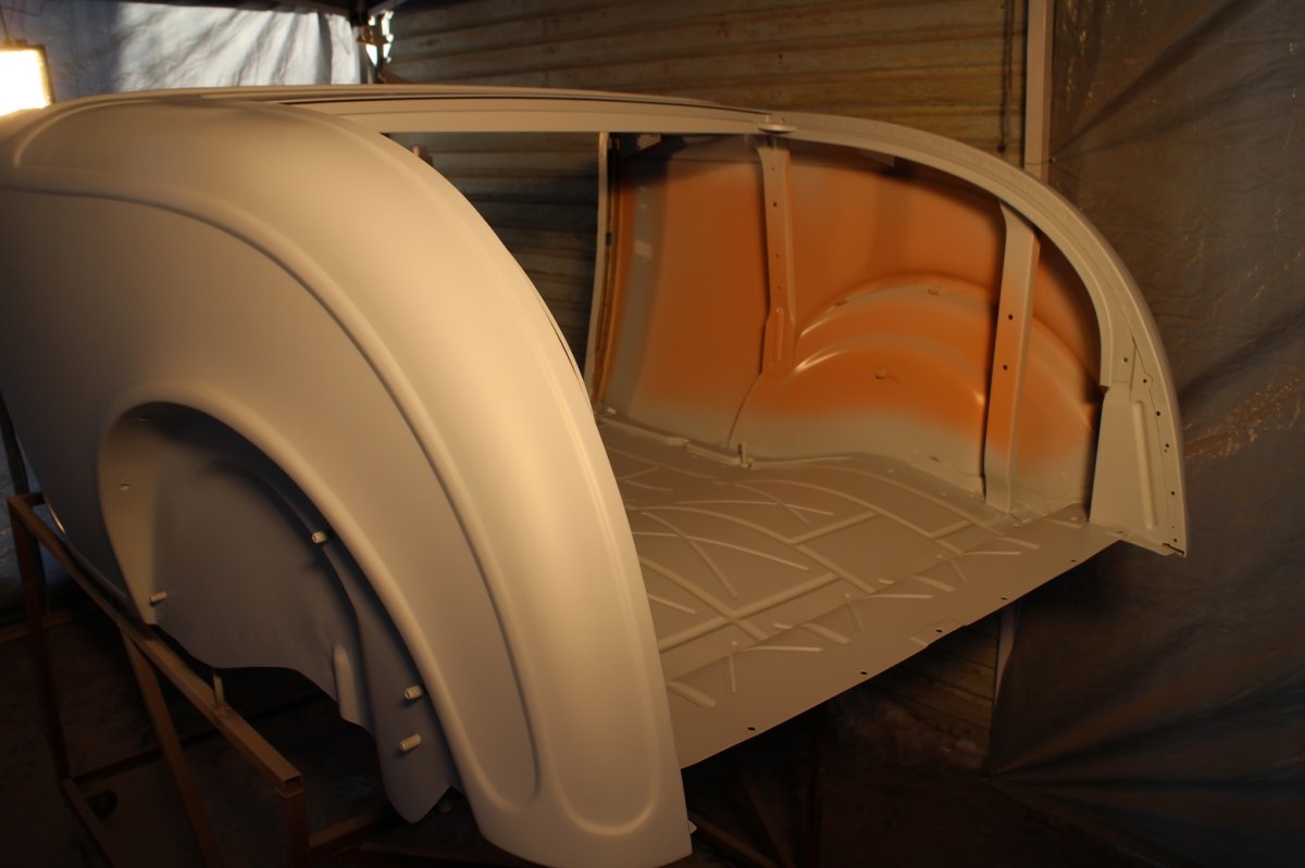

    Doors, tank and body painted.
    2kg epoxy primer
    2kg filler
    Still need to paint rearaxle and driveshaft + brakes....
    Need to change ring and pinion before painting.
    Aulis
