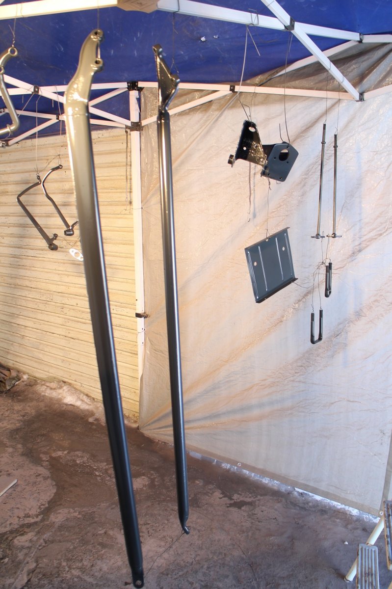

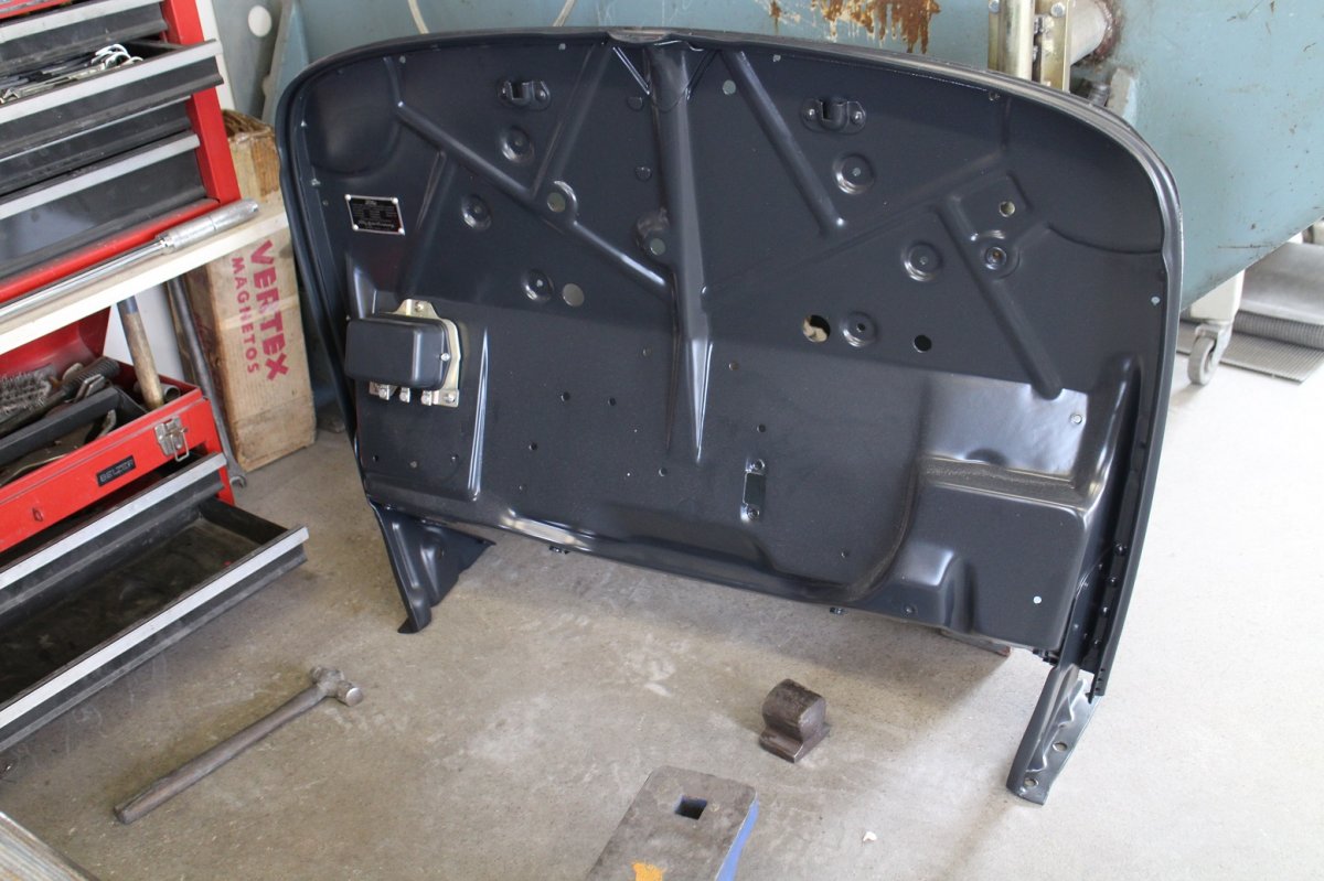

    Small parts painted.
    2K acryl. Colour is "cast iron" + 40% matting base.
    Aulis

    More painting,....
    Today I paint frame and maybe gas tank.

    How in the world does that paint work when it's freezing outside?

    I have never paint when its under +5dec celsius, are You?
    When painted , for example rear axle, we lifted axle inside garage.
    In tent I keep 8-12hours after paintjob +5dec celsius or more.
    After that can be as cold as in Alaska or Siperia. Now a days 2K paints has only 10-20% thinner.
    If You have very warm You use slow hardener, if You have weather like now here, You need to use faster hardener.
    Everybody knows that those water Basic colors must have very good painting room, all water must fade away before clear coat. I do not use those "water" paints. Hot rods not have clear coat.

    Fantastic job you’re doing. Regarding painting I have always been told not to paint below 65* farhenheit. You’re doing it above 5* Celsius/42* farhenheit? I’m going to have to look into that as it would sure speed things up around here!

    Epoxy primer can be paint very low temperature, even lower than +5dec Celcius.
    I use only Industrial Epoxy primers. Those are "hard stuff", smells like hell, and very good "contraction" (I do not know right english word , what I mean).
    When paint 2K , need to be more like 10dec Celcius. Before painting temperature was higher, but now a days those new paints (like new Glasurit, what I use) are spray lower temperature. New "line" Glasurit is made 3:1:0.5 ...
    Today tent was nearly too hot and I opened front of tent. Every time I use before painting liquid gas heater + 2 x 1500W light + Sun. Rear Axle I painted just outside of my garage. Very warm Place (sun) but maybe not enough warm.... but when using 40% matting base in 2K painting, does not matter. Anyway paint is not "shine".
    Aulis

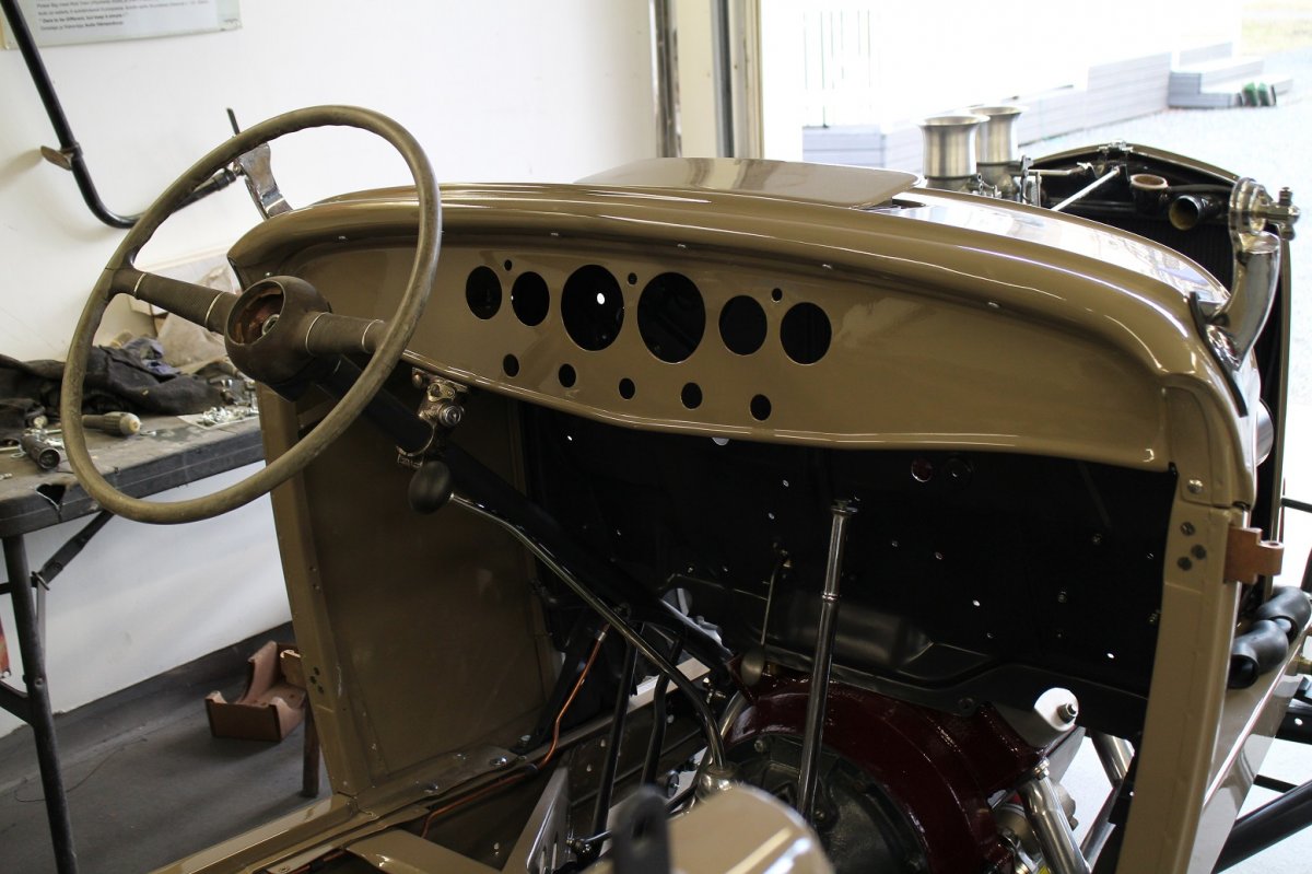

    Color is: RAL 7006 Beige-Gray
    Real hot rod colour......
    All of my hot rods are paint using RAL colorchart. Simple like builder himself.
