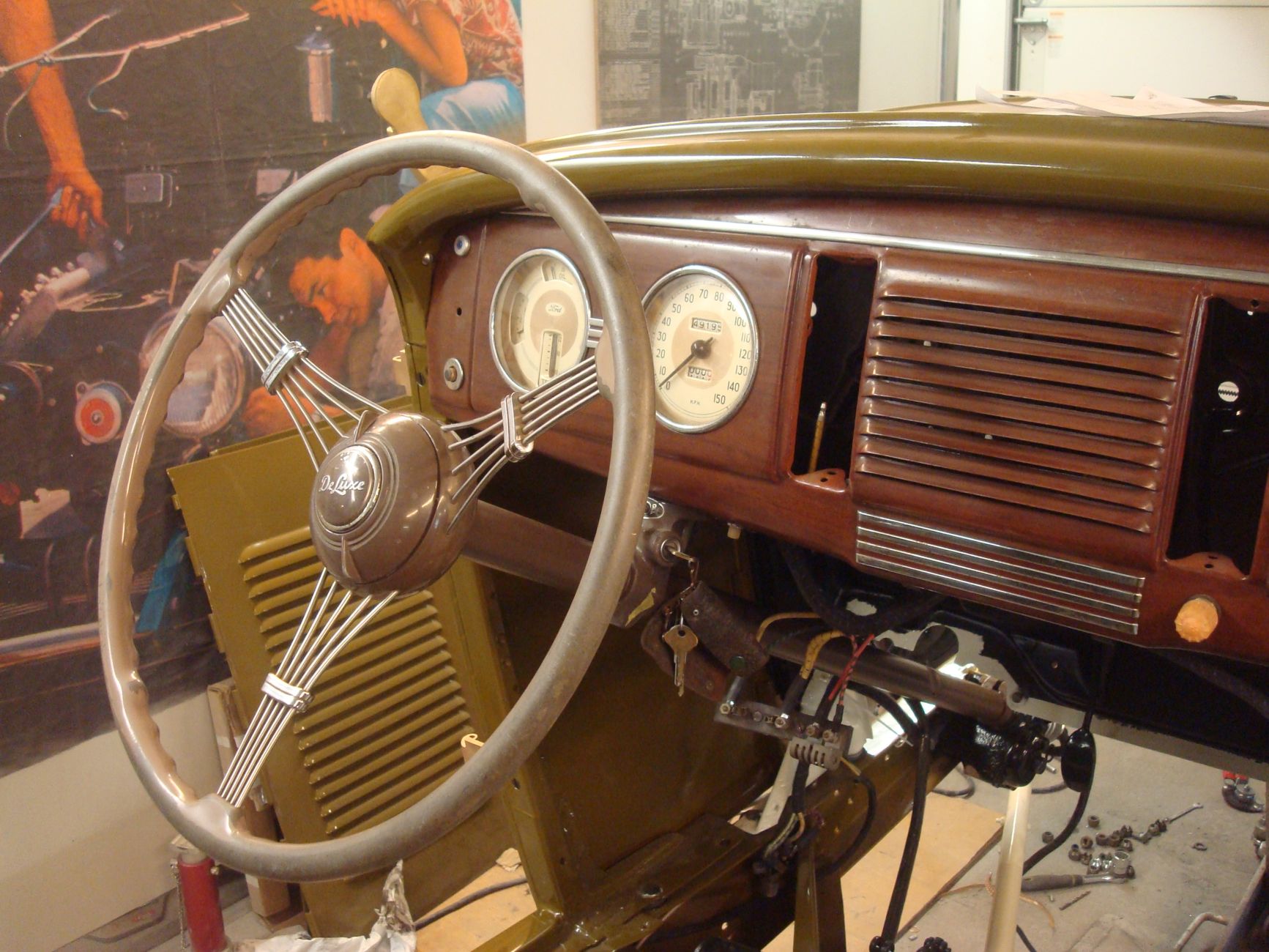

    OK. there is some differences between my projects ´39 deluxe dash.

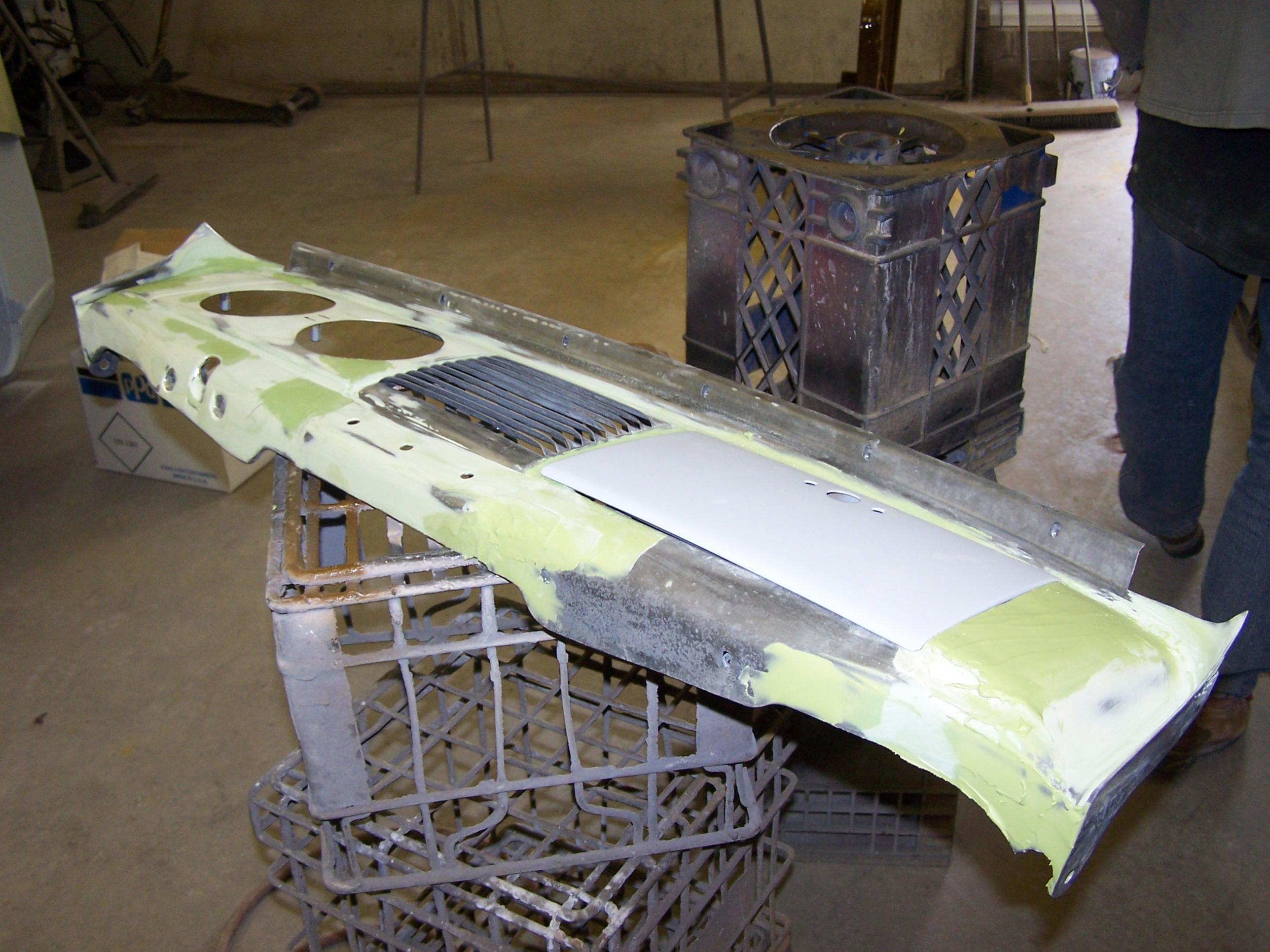

    Your's looks to have been shortened on the ends while LowA100's has had it's ash trays removed.

    You´r right. Also very good outlook and practical to use 40´s column/shifter.

    That is correct JH
    I sectioned 4 inches out of the width by taking the ashtrays out. This was done to put the steering column on centerline with the gauges.

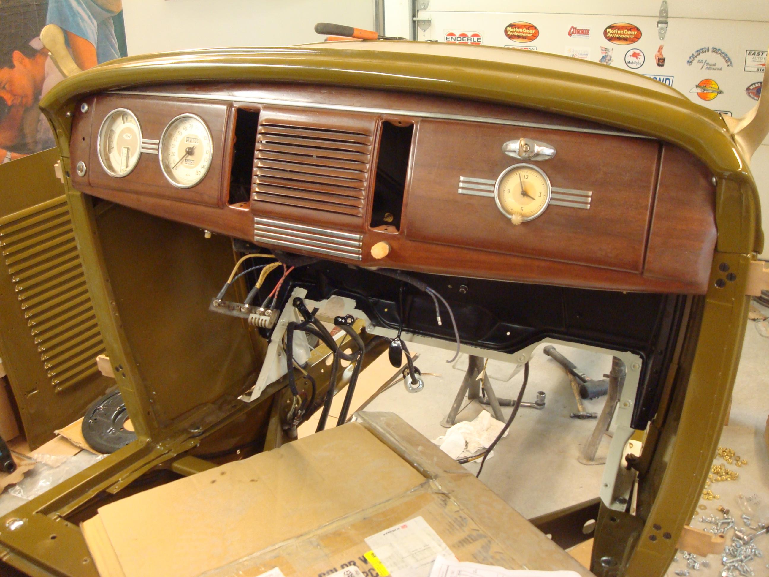

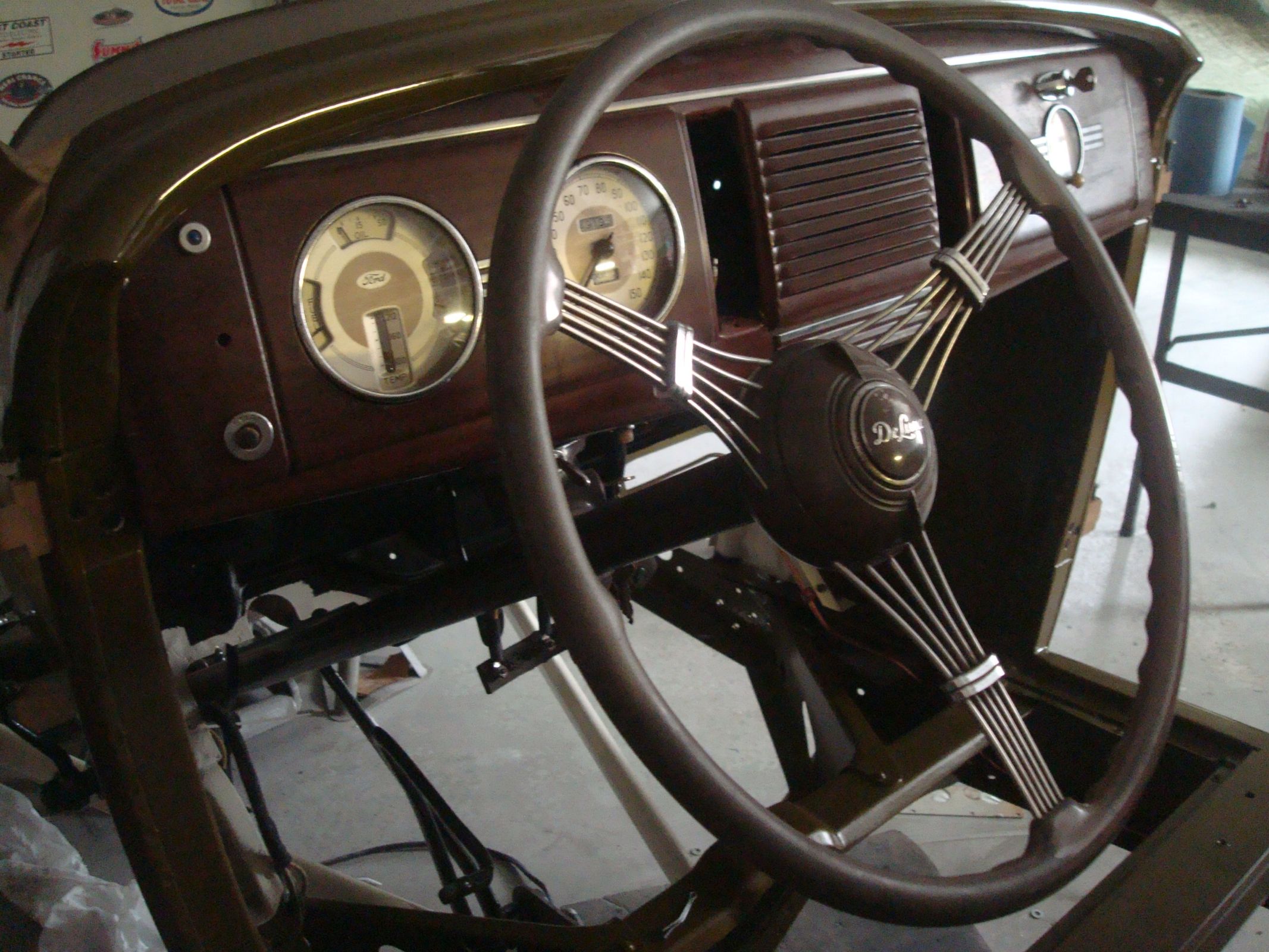

    More dash pics - 39 std w/no clock in glove box

    First I love this car and the color is great! What is that round thing below the dash, speakers? What are they ? I would love that in my truck.

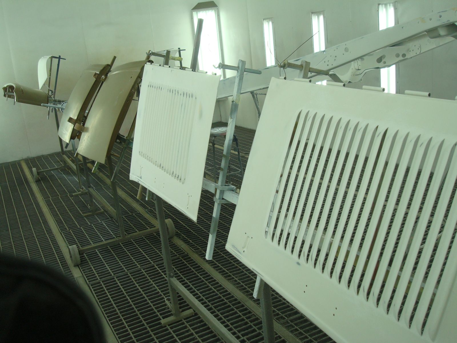

    I have had little problem with paint. have to pait all parts twice because this DuPont color is not cover basics. If I know that first, I would paint there all over nearly same color other brands paint (glasurit), but we note too late this problem and now I have to sand all parts another time and repaint so we get more thickness and so on,...
    Good thing is that i do it myself (no costs) but takes time and we have used 9litre (2gal) Olive green color and not ready yet.
    This car will be for driving and I do not fix all problems,... but all must look OK before I carry parts own garage. I called to DuPont and they said, this old color is include very much adhesive and a small amount of pigment (H-D color), that´s why it not give good result.

    Salf100 - Thanks for the words. The underdash thing is a 1942 aftermarket Tropic-Aire heater. I found it NOS on EBAY and put a 12 volt motor in it and it works great!!

    Now all parts paitend twice, doors three times, cowl top 4time,....
    We have same problems with "LowA100" if we are talking about paintjob.
    I have now used 9litre (over 2 gal) Olive green and cost over 1000euro (+1300usd) + epoxy etc etc. Good thing is that my friend owns carpaint company and he was nearly sponsor all what I did there.

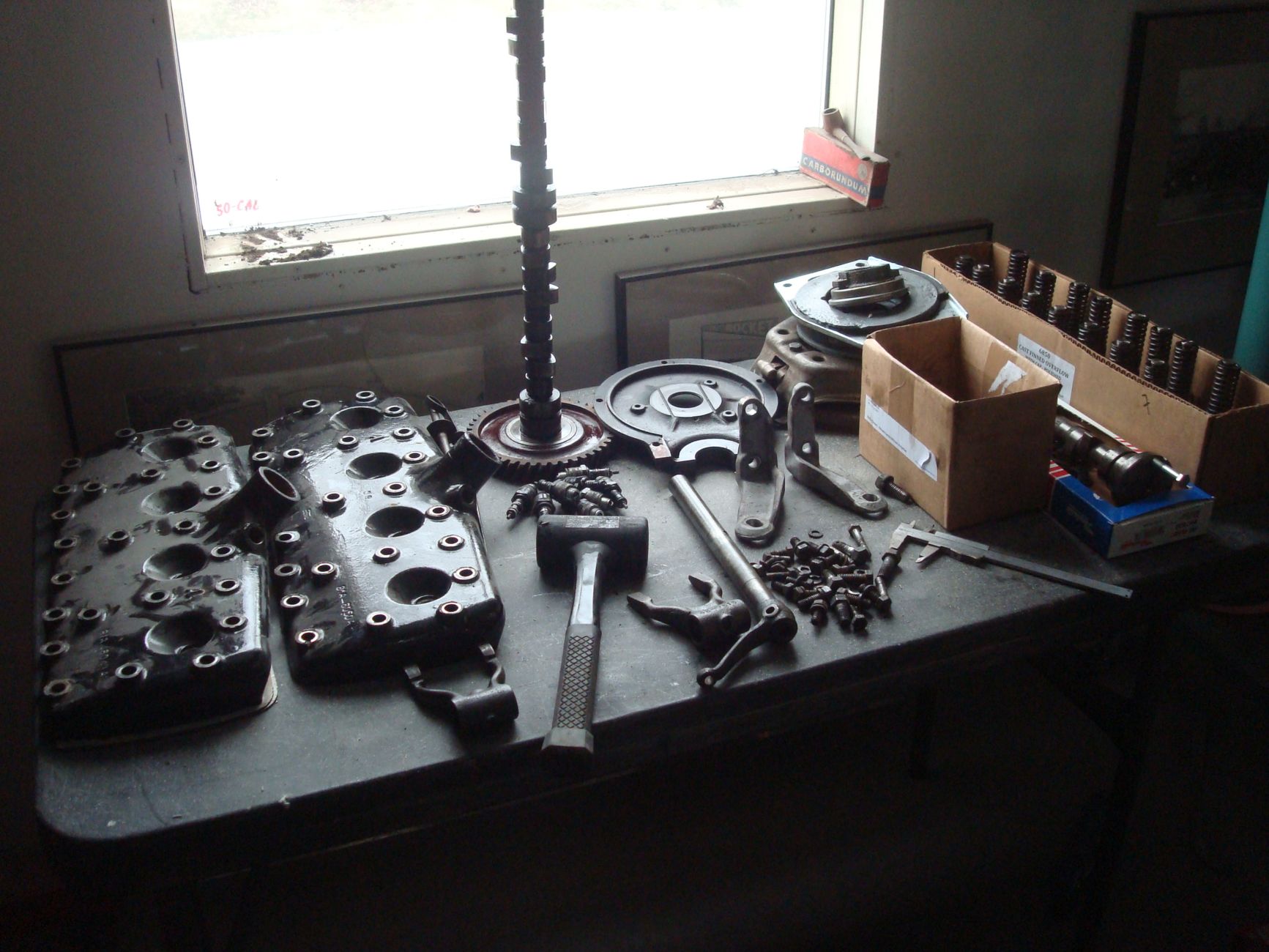

    Harman & Collins camshaft has been measured and also get some info from
    Grand Old Camshaft manufacturer in CA. 260/262 , 0.365"/0.365" , 110lobe. Sounds good, hope that also engine sounds good too. Cam was unused!.

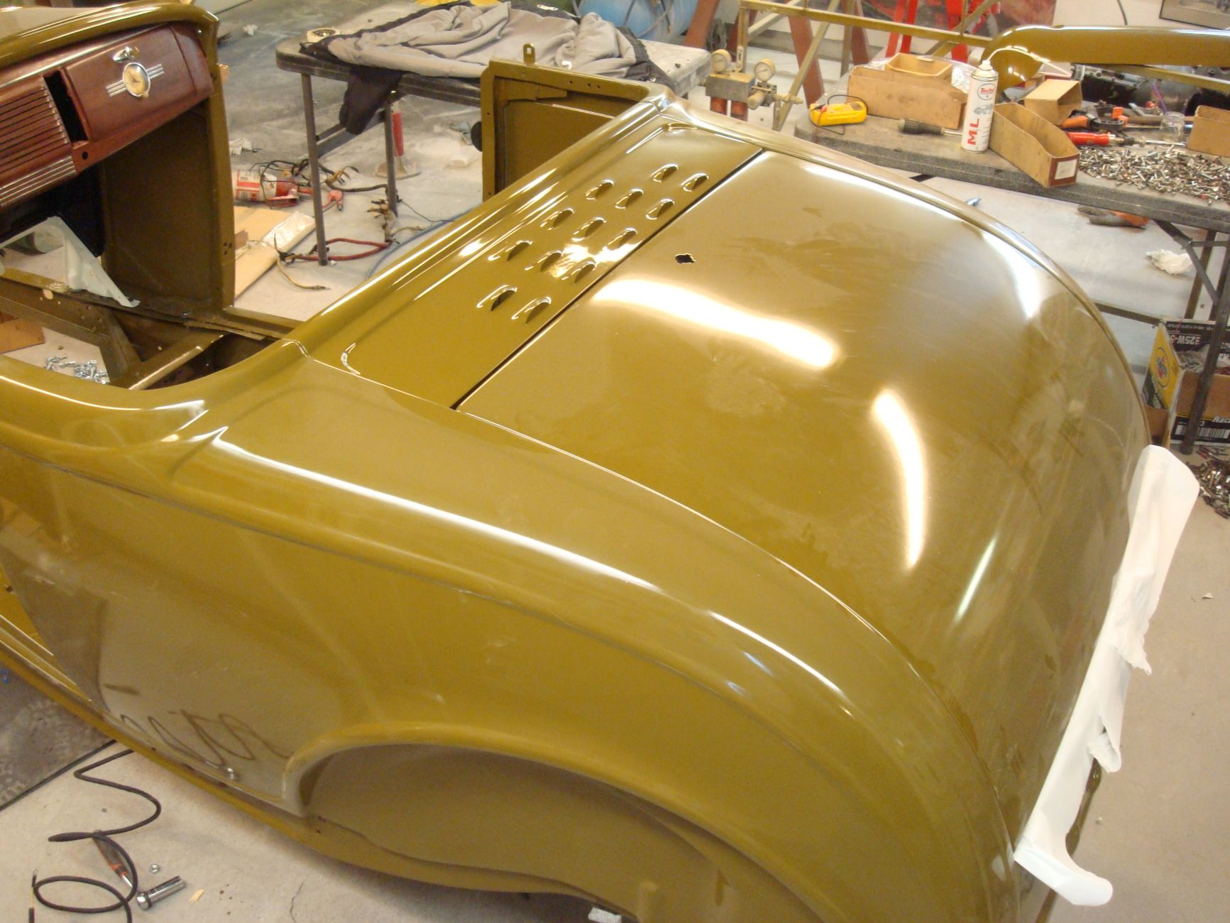

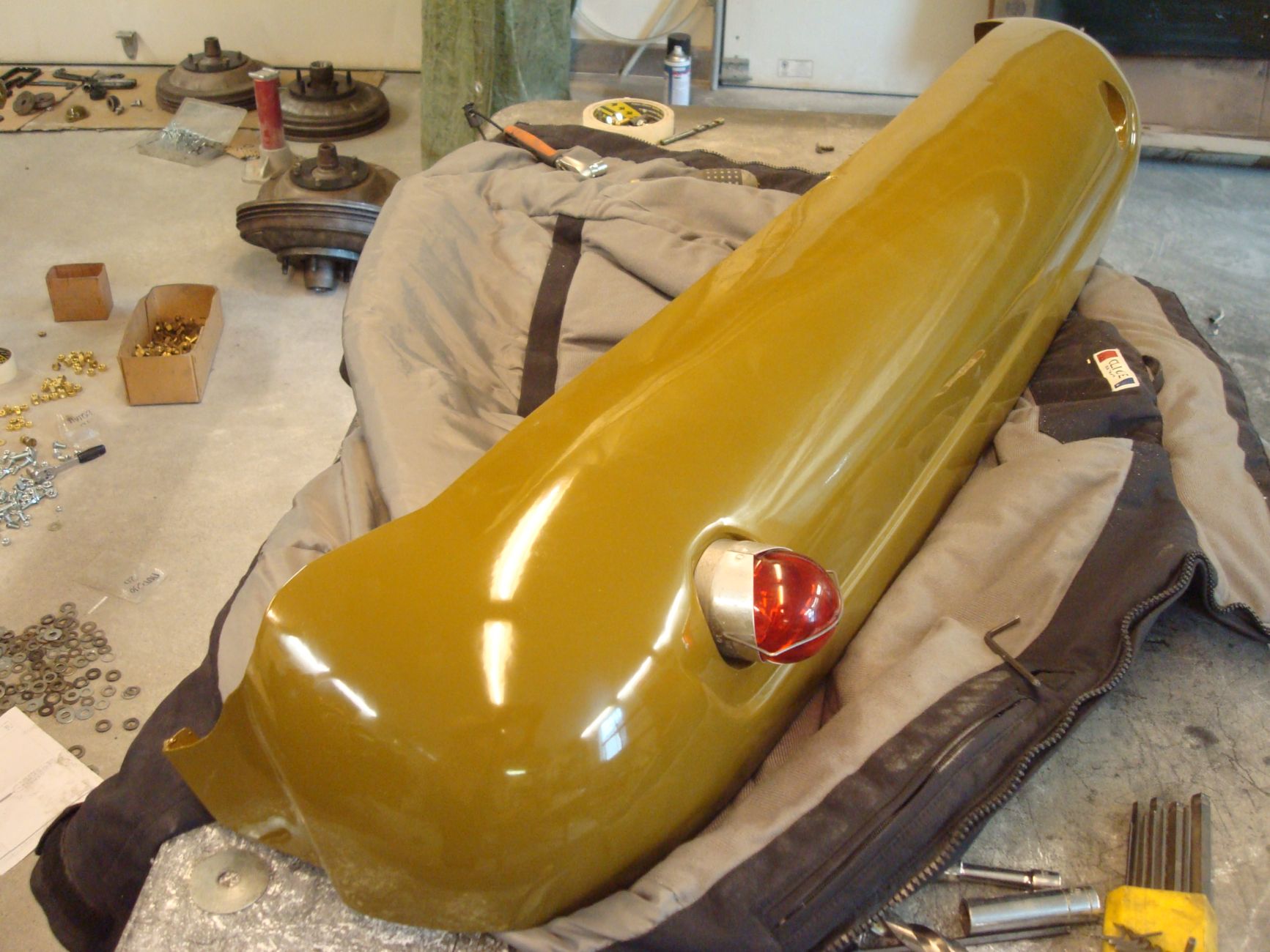

    Still problems with color,.... now need to paint doors 4th time rollpan 3r time and hood tops 3rd time. Unbelievable paint, cover nothing.
    Aulis

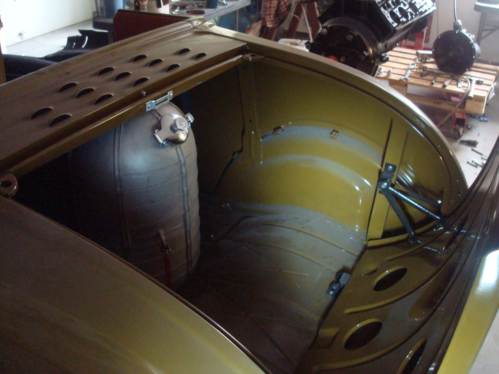

    Love the old air tank as the gas tank!

    Here some pictures. Engine was "SEMI" rebuilt in Norway, that´s OK.
    Now need to buy new adjust lifters, valves etc because old Harman&Collins, Im gonna use, has samaller basic round. Engine was better than I was think. sometimes positive supprise.
    Aulis
