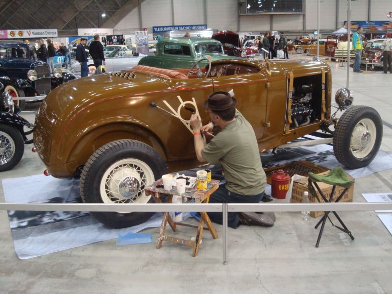

    No throphy from Tampere. There was so much hi-quality hot rods and my "middle-cl***" job was not enought,... Maybe I must go to "hot rod school" to get some more tips and tricks for building,... anyway,
    Here 4 pics more. Young rodder who finally owns all junk in my yard.

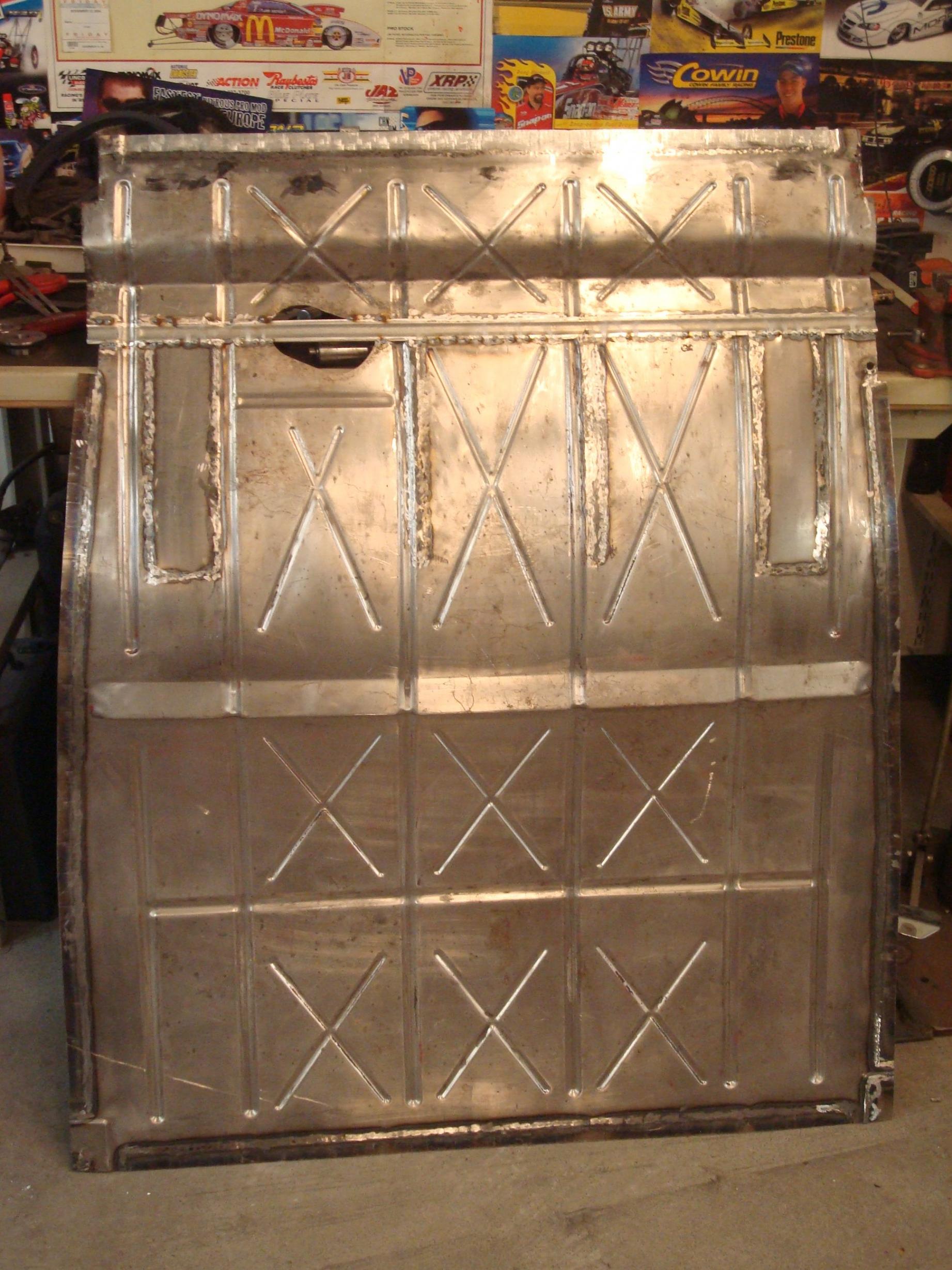

  8. AULIZ
    Joined: Oct 28, 2005
    Posts: 1,783
    AULIZ

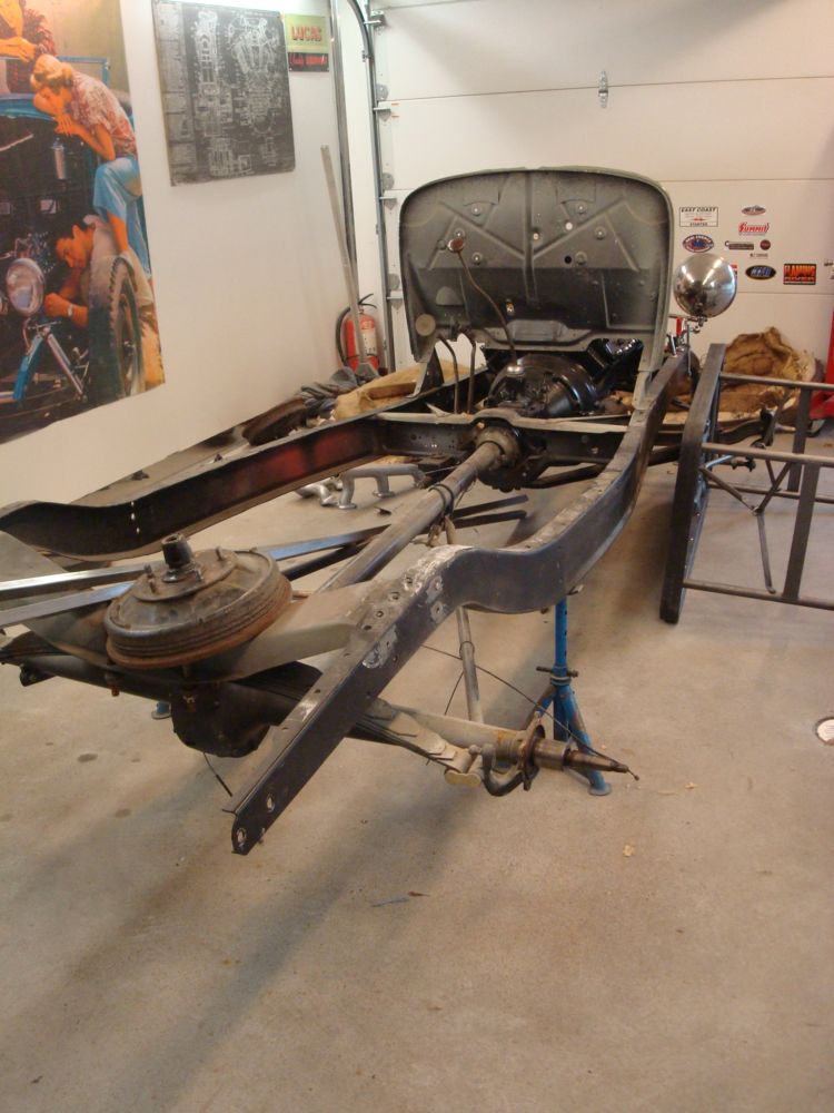

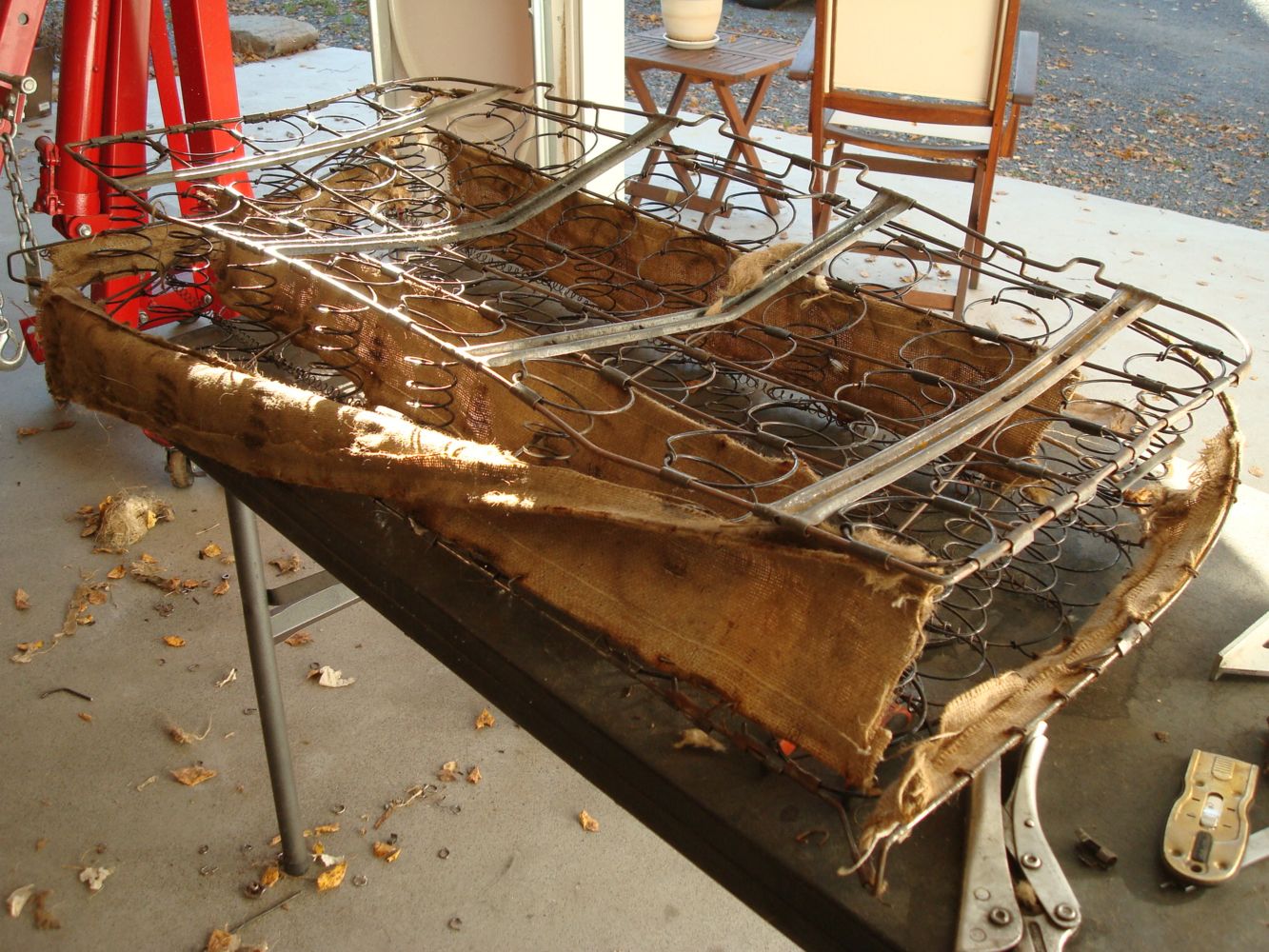

    More "before" photos.
    Aulis
  9. AULIZ
    Posts: 1,783
    AULIZ

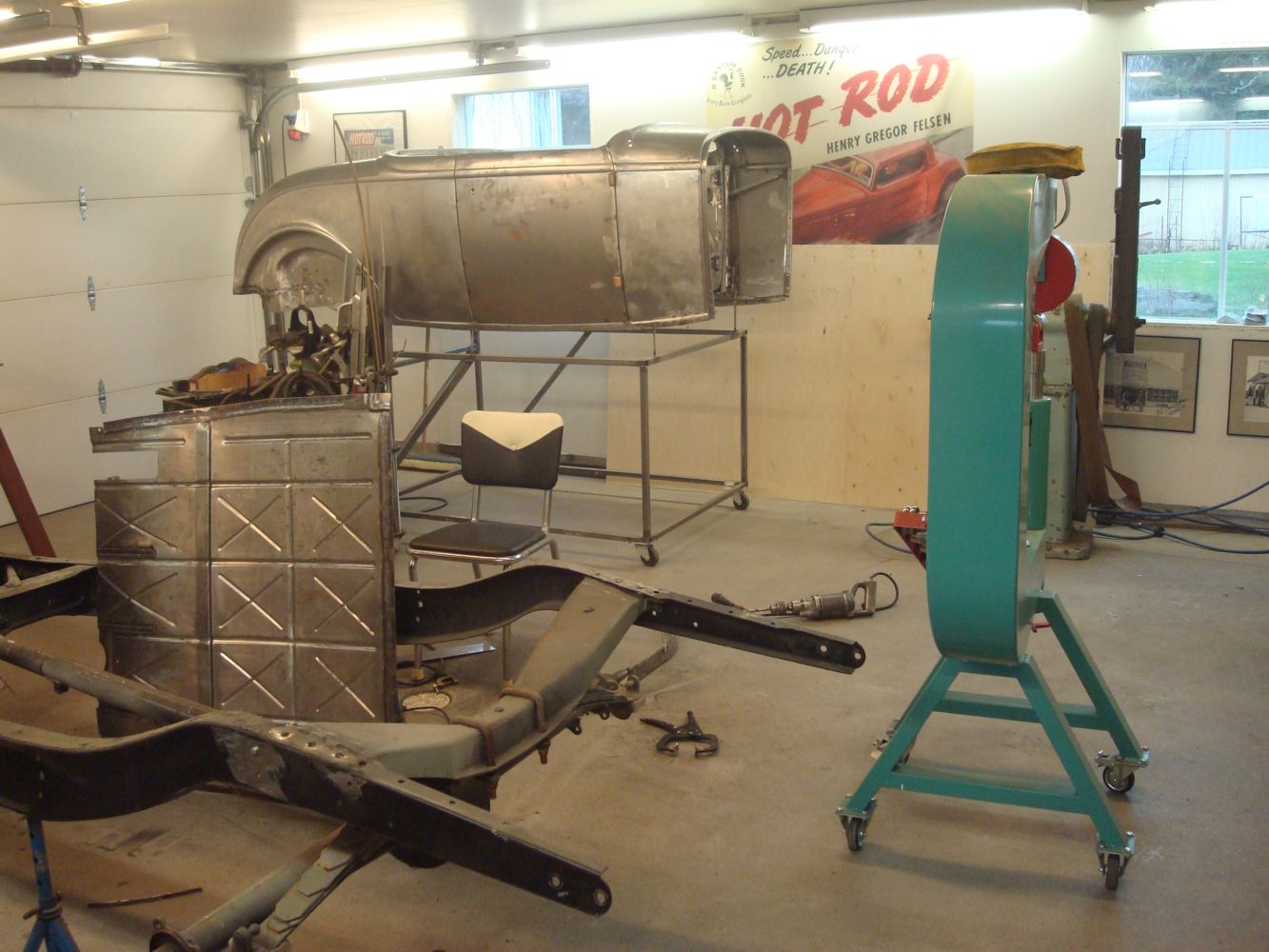

    III "before" photos.
    All these and earlier "before" photos are September-October 2011.
    Everybody knows that it takes time to make all jobs. 8months and +1300hours is possible
    if goes to garage every morning 5.30 and have dayjob home so can use longer mornings, afternoons/evenings with project. It takes more time if You have CommunalGarage (jointgarage). I had +20years ago jointgarage with Mika Valle and Juha Mehtala and after that I have try to keep own garage. No missing tools, can invest expensive tools and machines and not need to show with finger if something is missing, broken,.....
    Rgds,
    AULIS

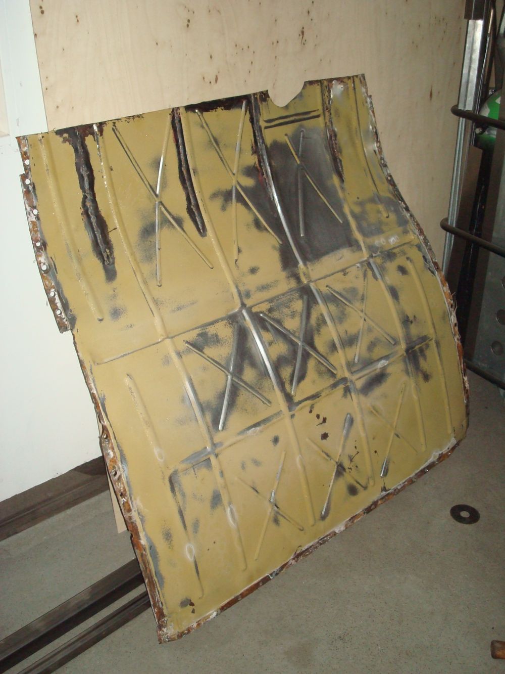

  10. AULIZ
    Posts: 1,783
    AULIZ

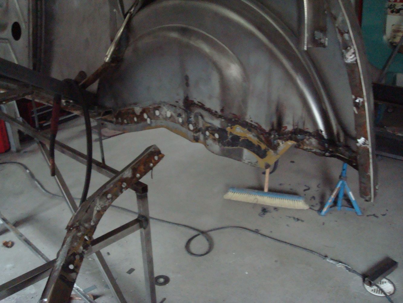

    "before III" photos.
    November 2011.
    Aulis

  12. AULIZ
    Posts: 1,783
    AULIZ
    These are two last "before mail".
    Begining of December 2011.
    Rgds,Aulis

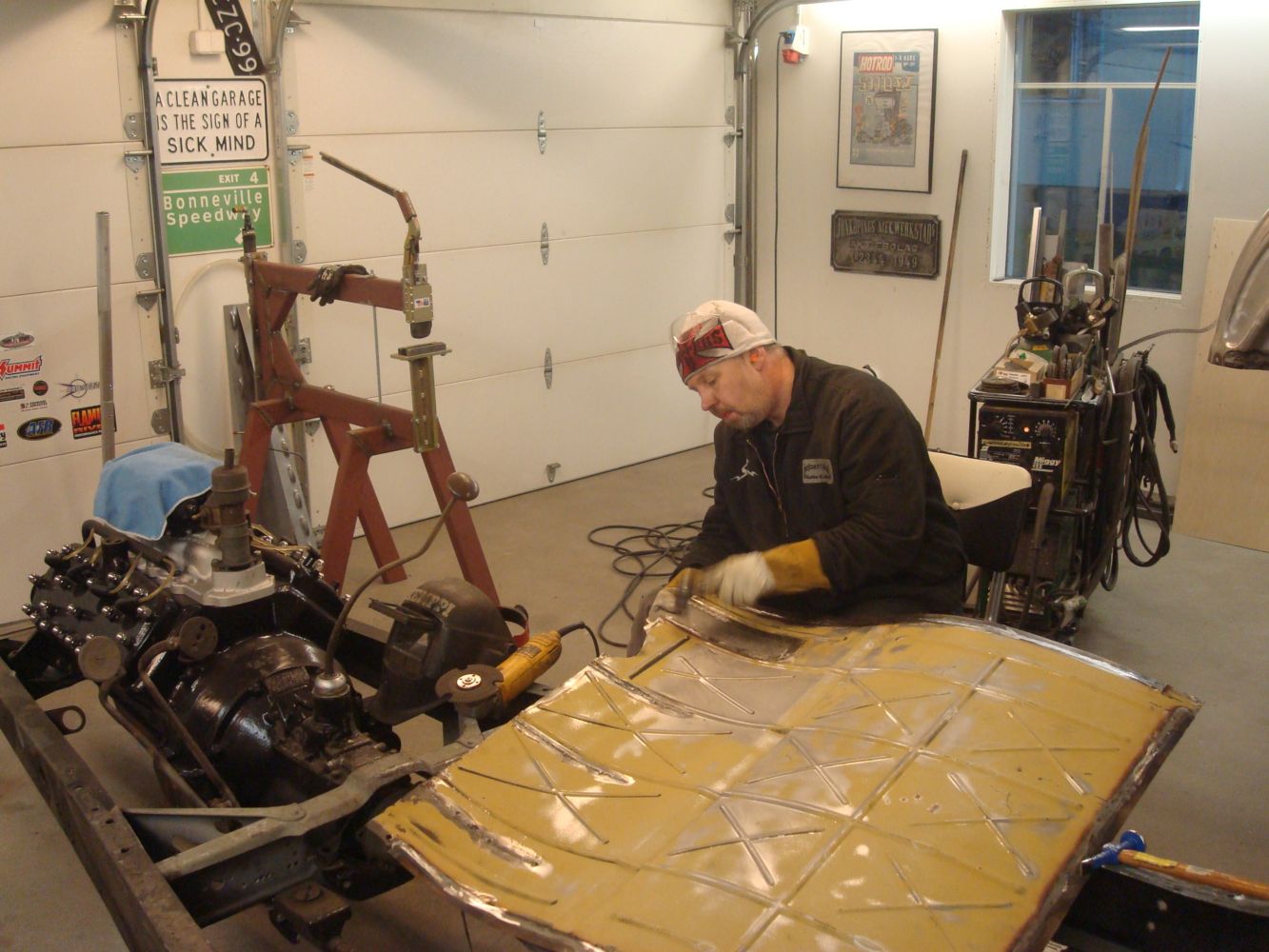

    End of December 2011. "before" new Year.
    Aulis

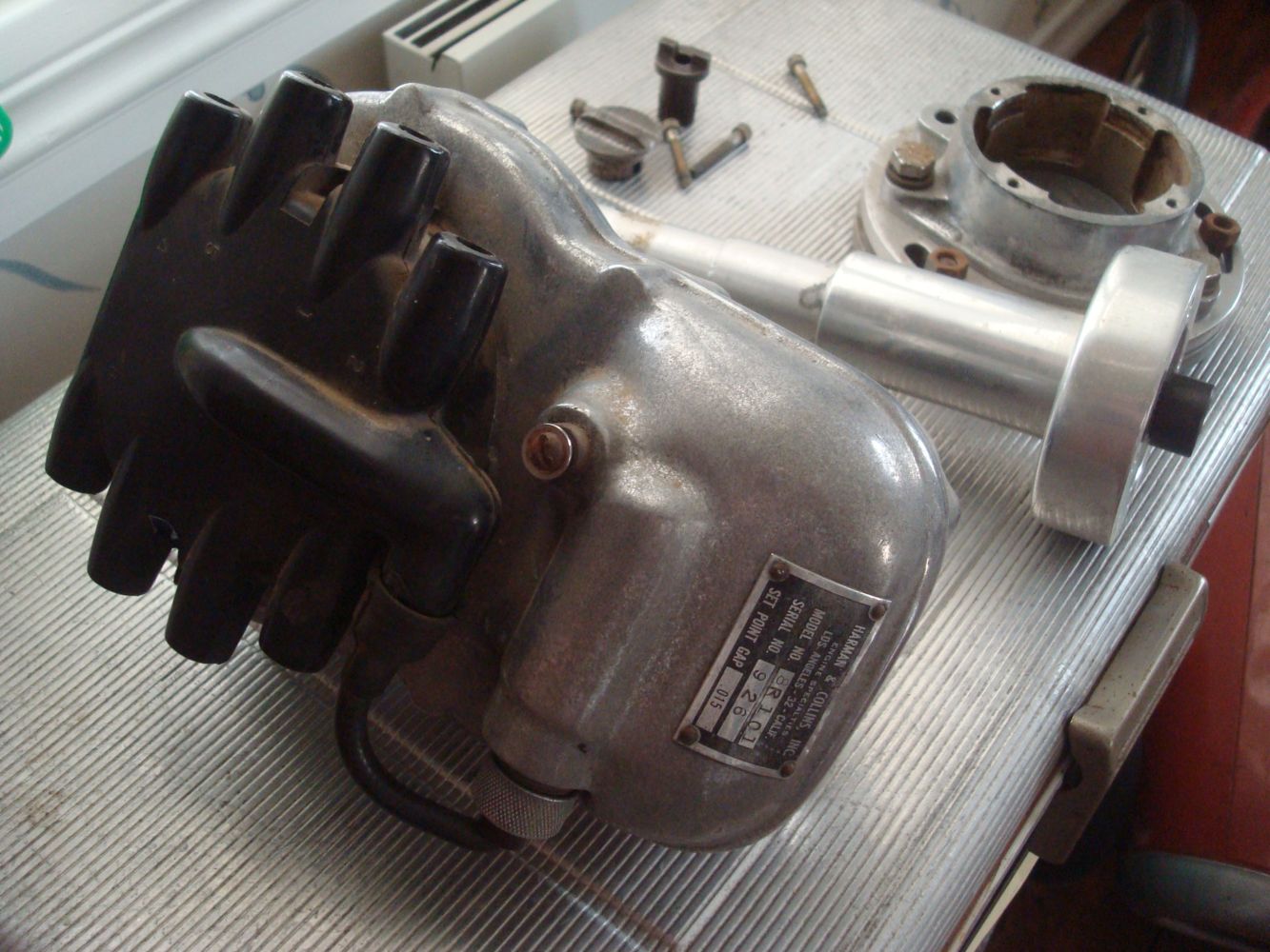

  15. AULIZ
    Posts: 1,783
    AULIZ
    Hello,
    Thanks N847 and Peter. I have enjoyed this winter very much.
    I have good situation that I work home (dayjob and own hot rod shop), so my days are flexible.

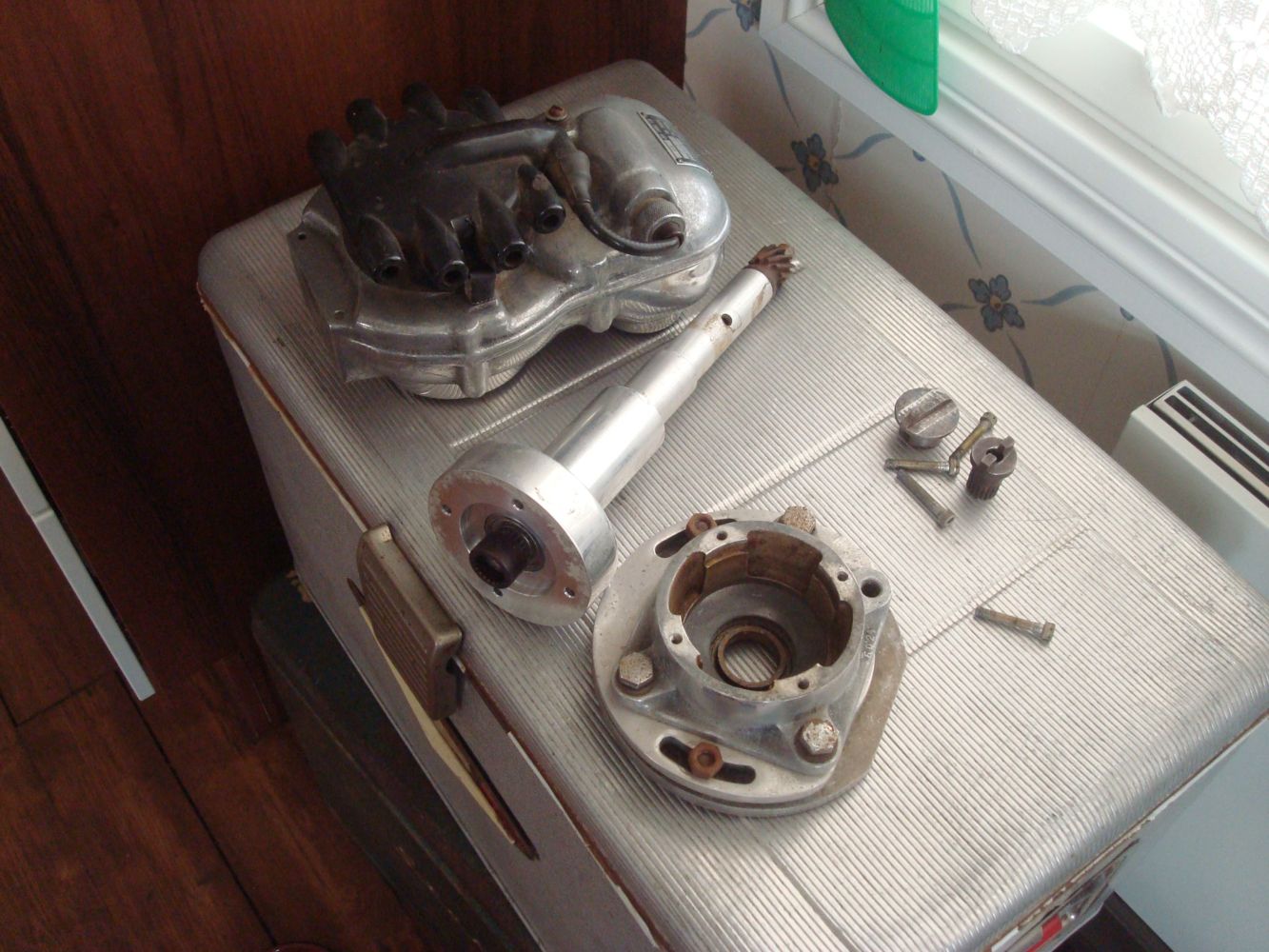

    Feels every week that its "christmas time",... and today I got 7kg shipment from Norway (Thanks Pål !!), Harman & Collins magneto. Fits earlier 59A,81A,... and 8BA engines too. Hope that it works, but if need to "load" it (I belive must do that), I know some old guys who are doing that here in Finland too.
    Aulis

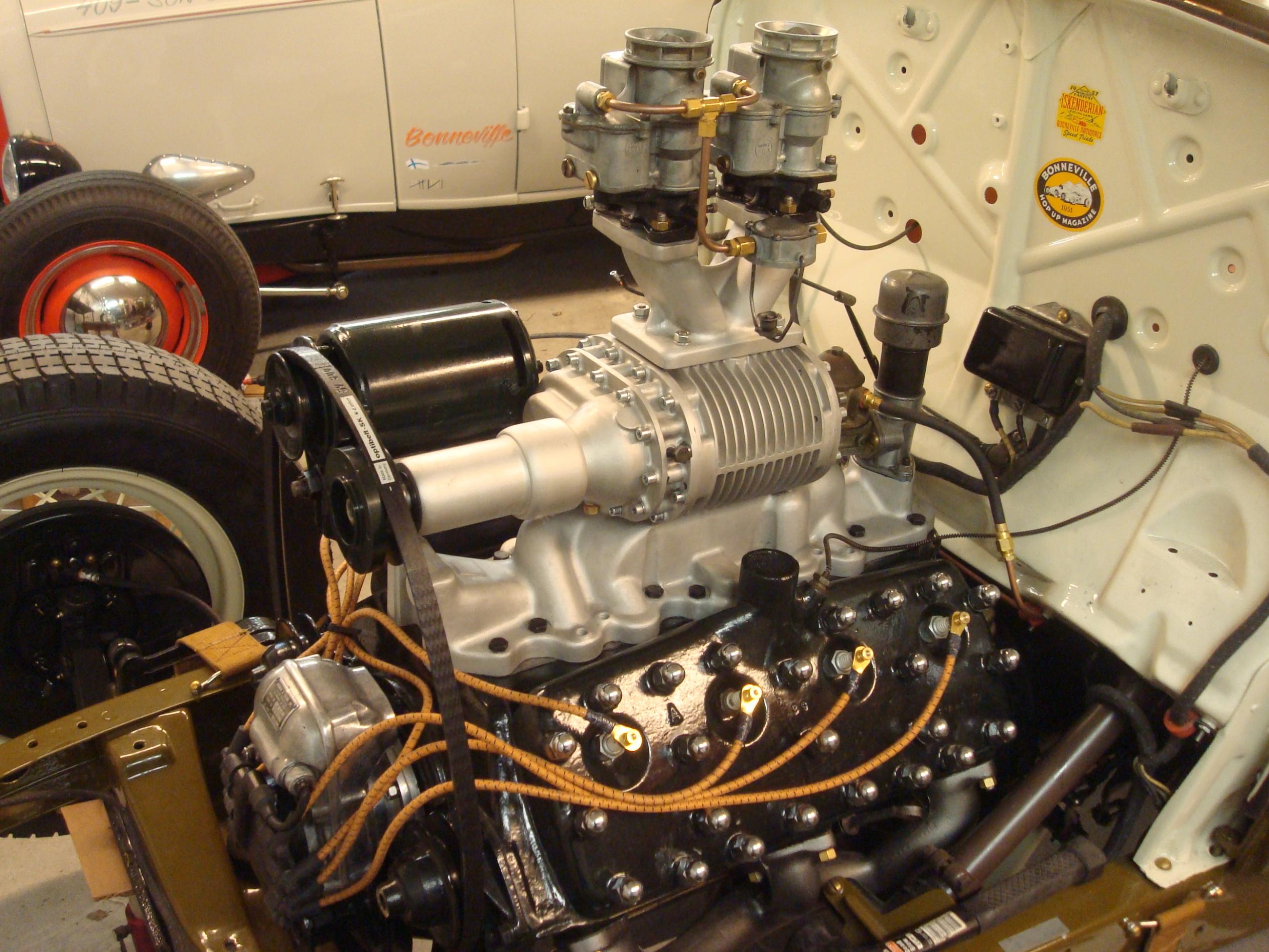

  18. fonti
    Joined: Nov 28, 2006
    Posts: 495
    fonti

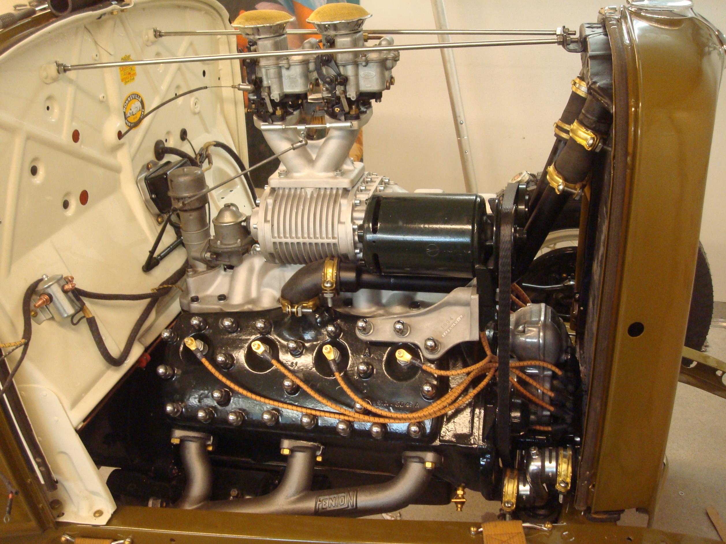

  19. This is hot! I love it.
    The colour, SCoT blower and old army belt straps.......awesome.

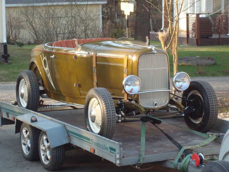

  20. AULIZ
    Posts: 1,783
    AULIZ
    Thank You Sirs.
    Not "trailer queen quality", but try to make it good to drive and have lot of kilometers/miles this summer.
    This ScoT is small but very good condition. Maybe get some horsepower more,...hope so. but if have good torque thats enough for me.
    Rgds,
    AULIS

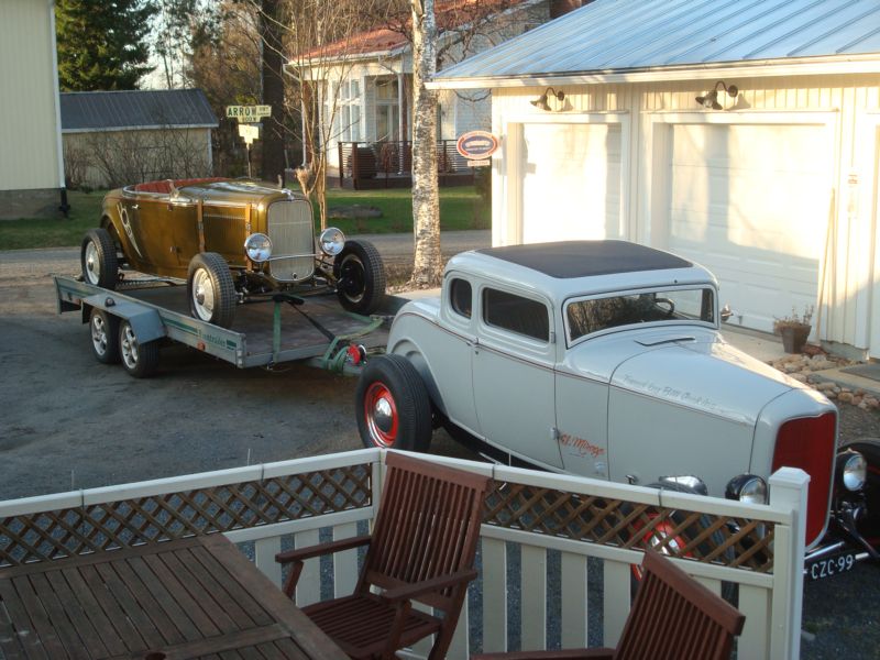

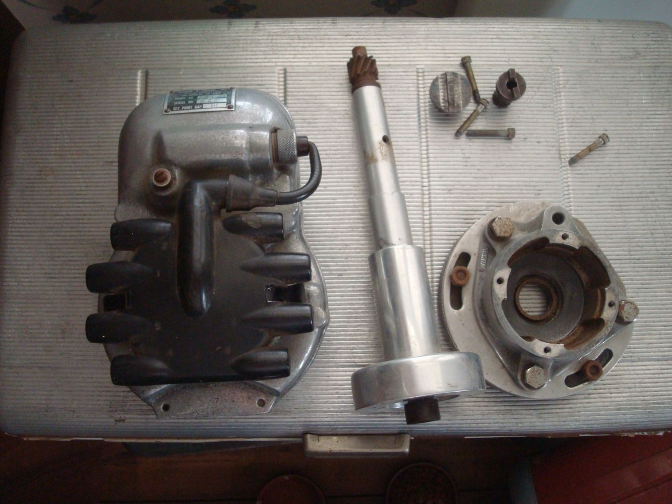

  23. AULIZ
    Posts: 1,783
    AULIZ

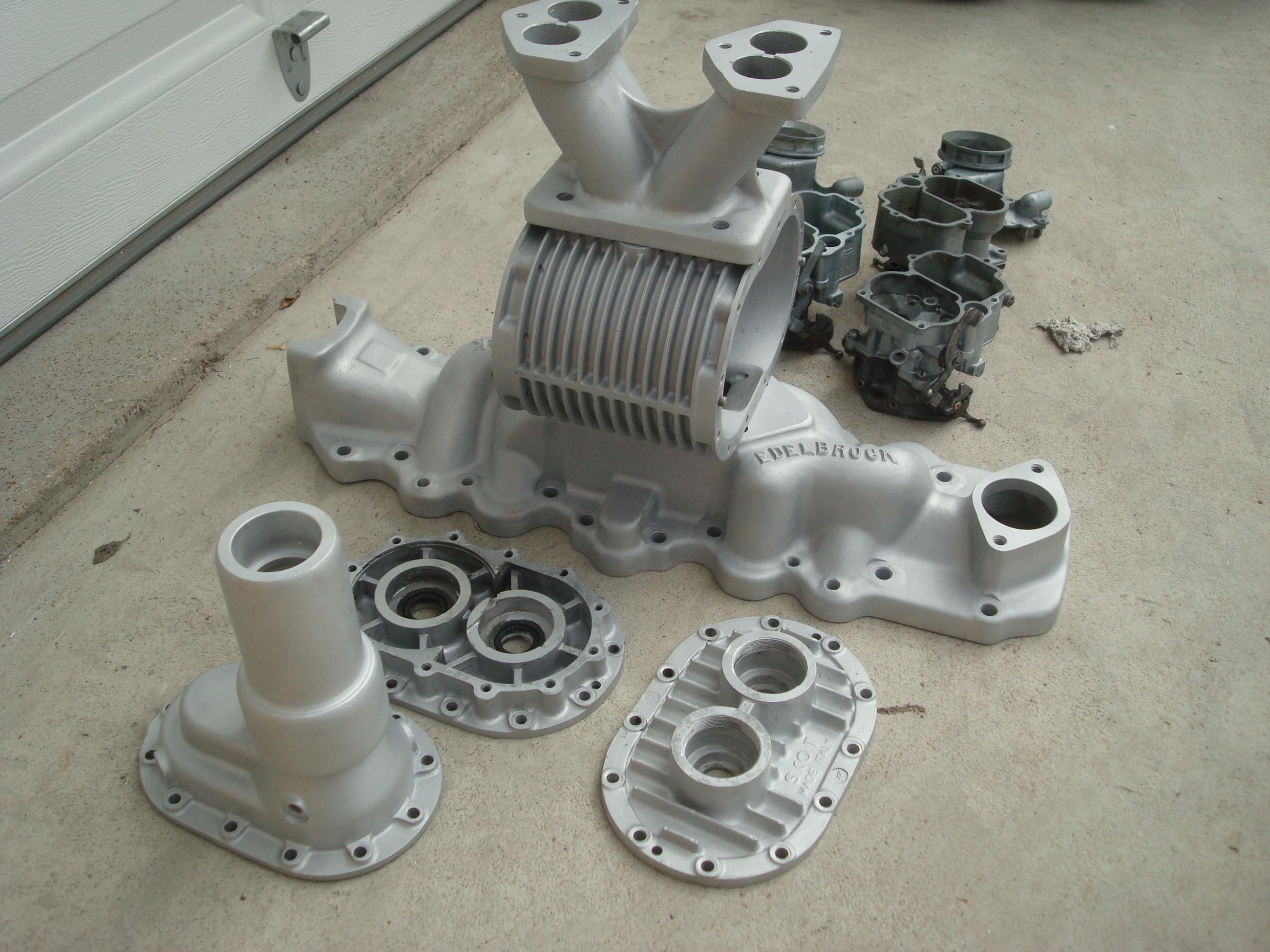

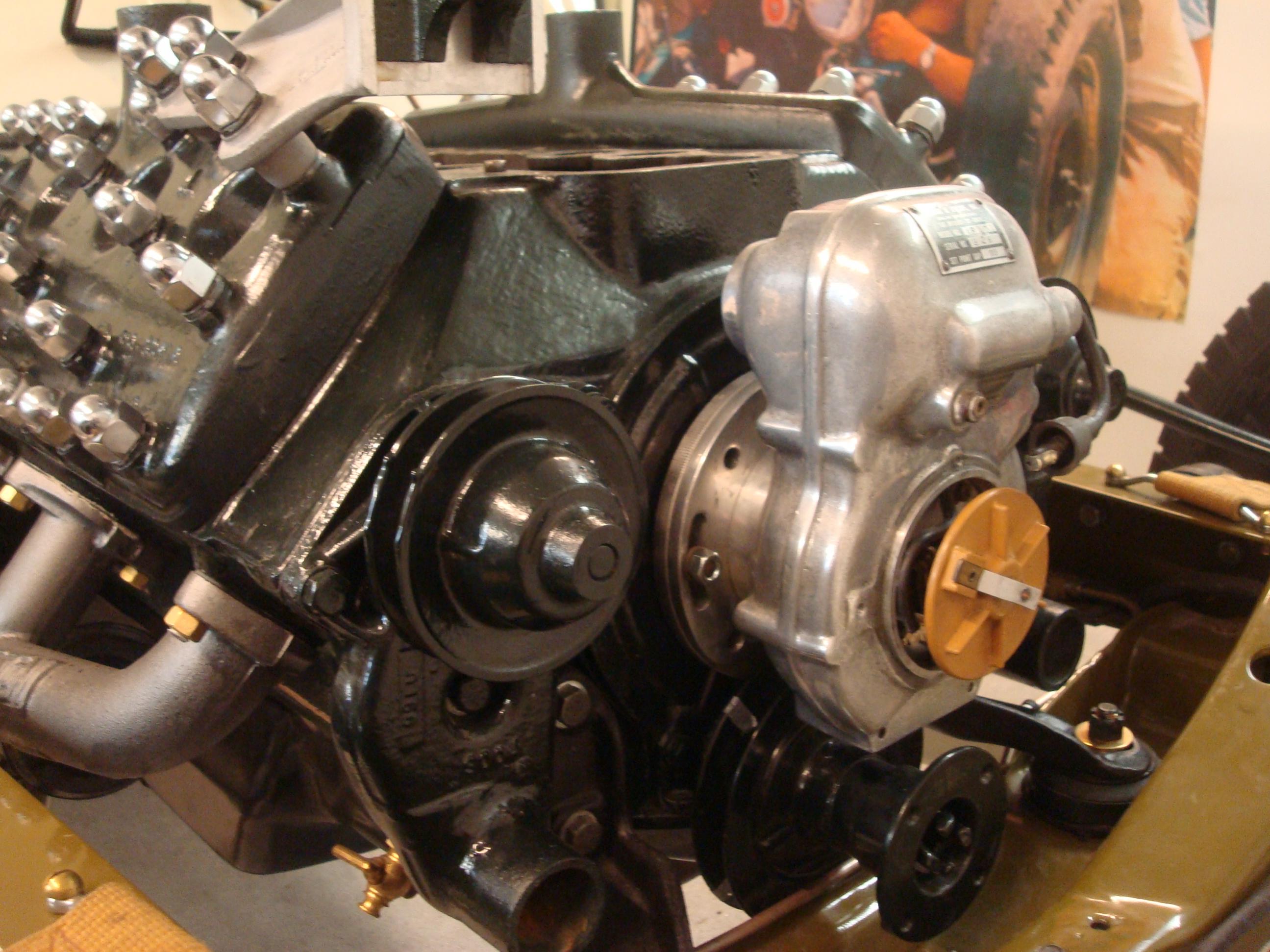

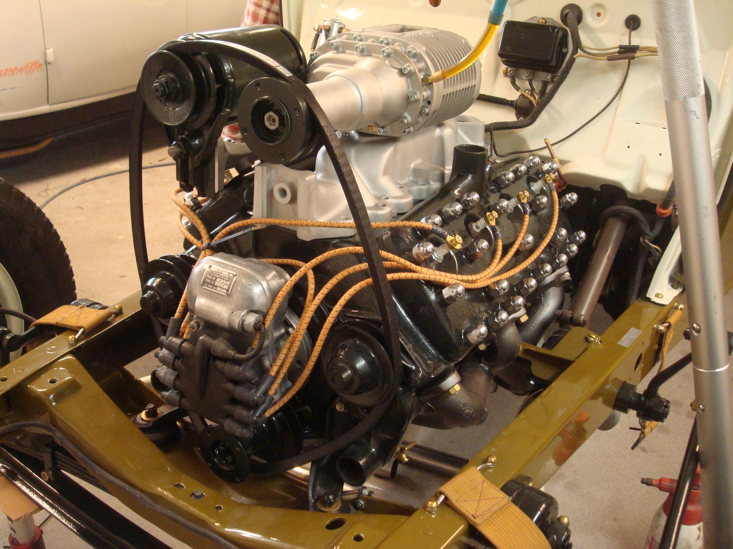

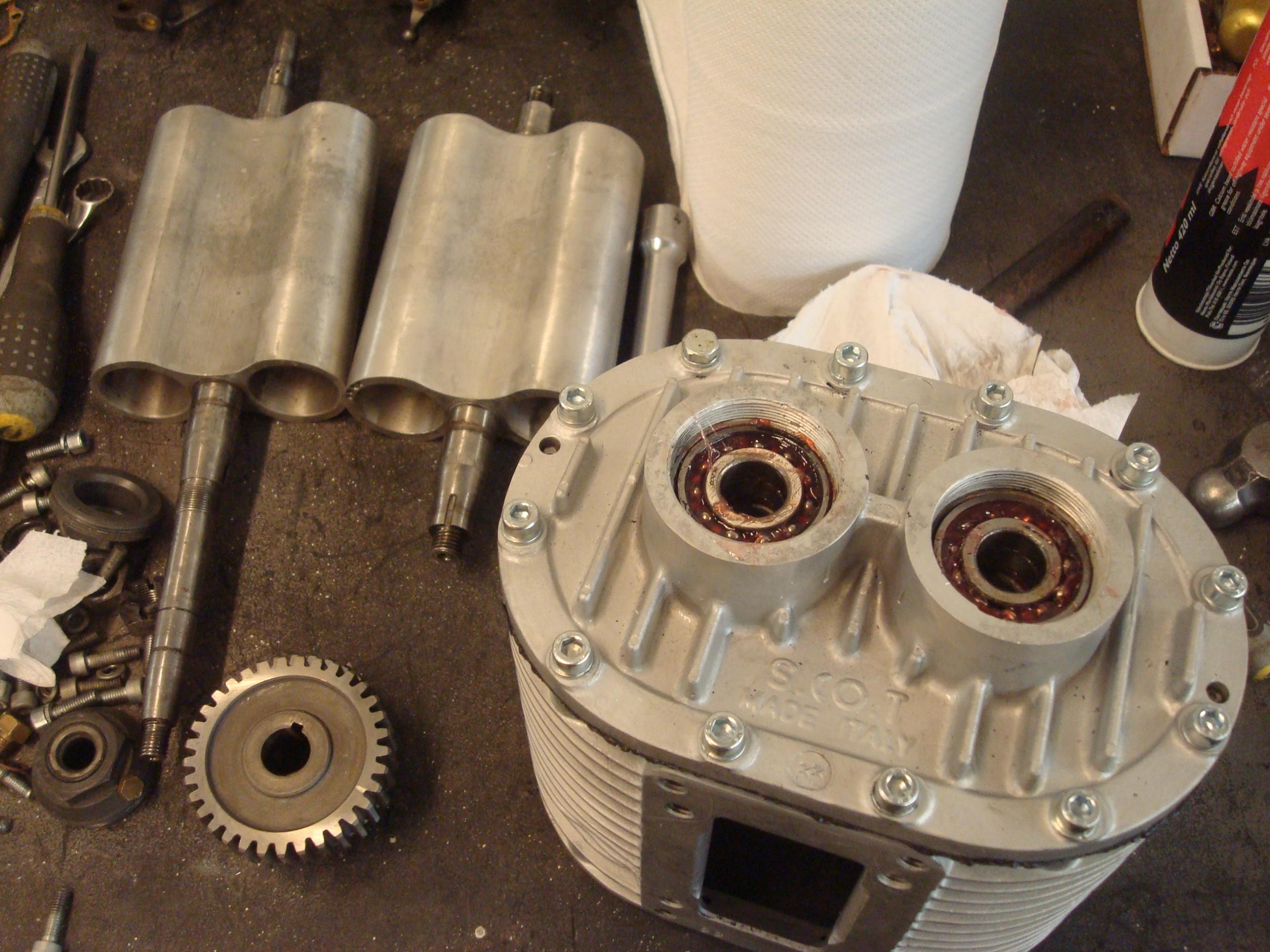

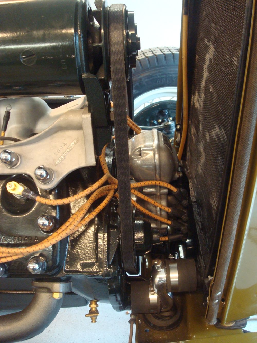

    Intake and blower stuff are sodablasted.
    Jr ScoT is going together. I can say that ScoTs very good quality.
    Small tolerances and all fits perfect (if compare old 4-71, 6-71,..).
    Harman&Collins Magneto is working fine. Machine jobs are made and now
    adapter fits perfectly. Made same time new bearingbronze to support drive parts
    and made space for seal too. Gives nice 1/2" long spark. I leaved it old outlook, not polish too much.
    Aulis

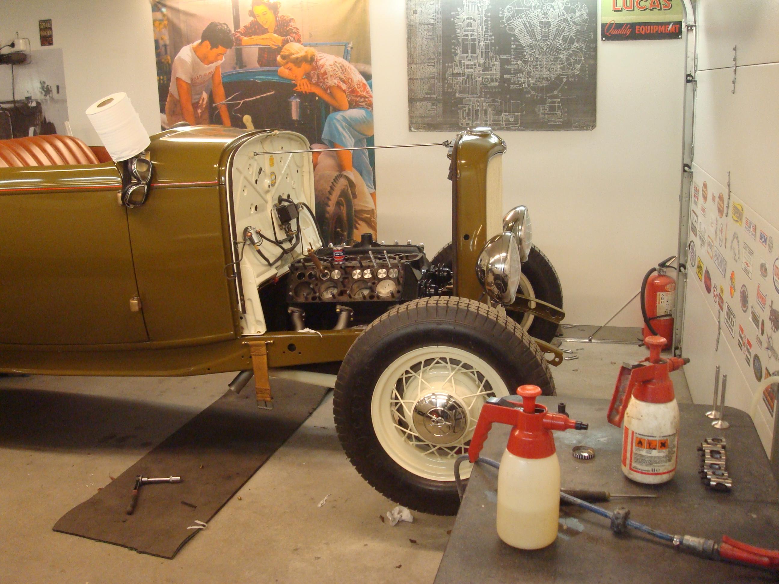

    slowly going foward.
    Rgds,Aulis

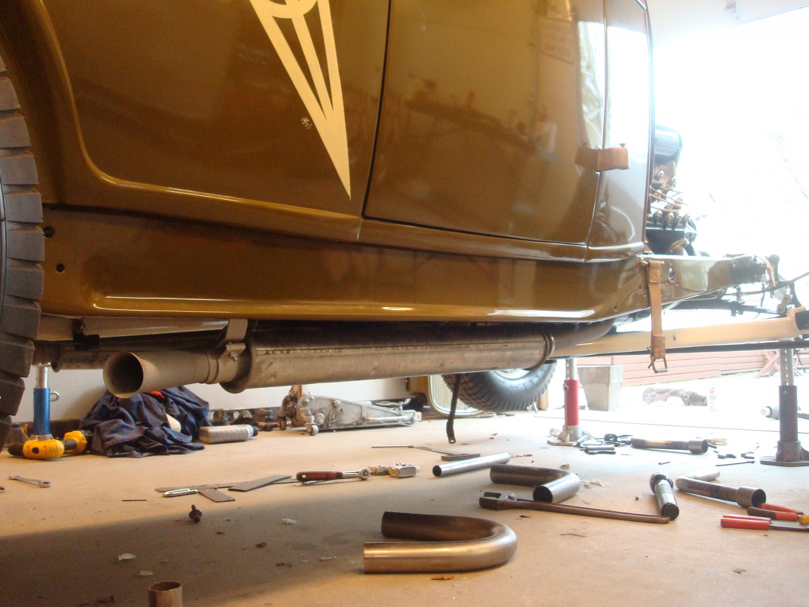

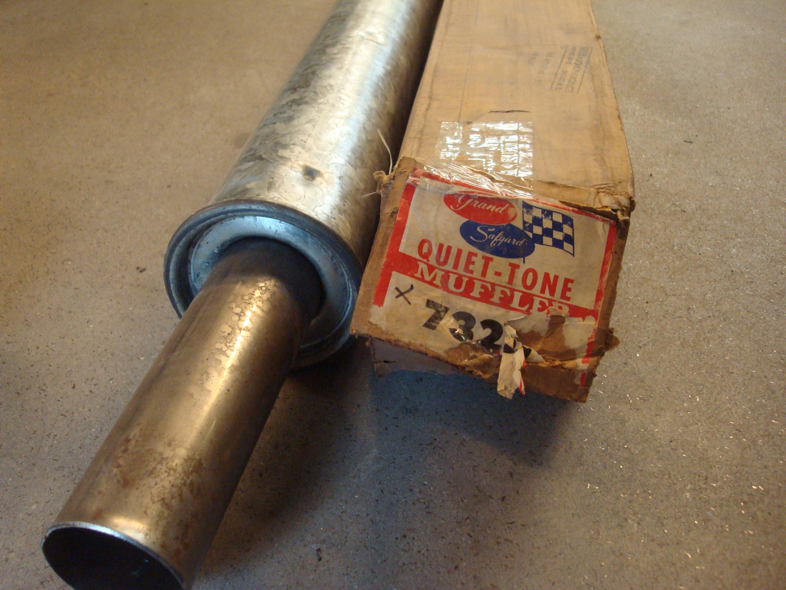

    Exhaust tubes ready. Like old days, no need to hide mufflers up,....
    Aulis
