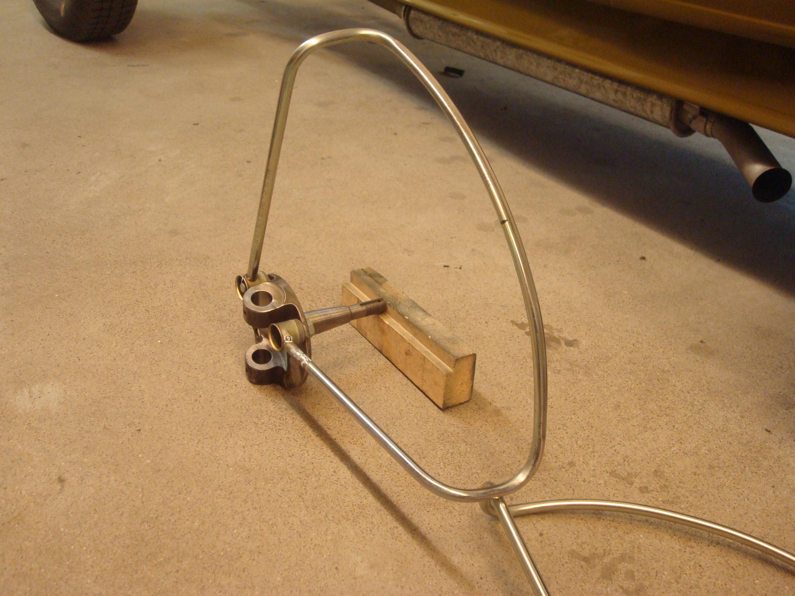

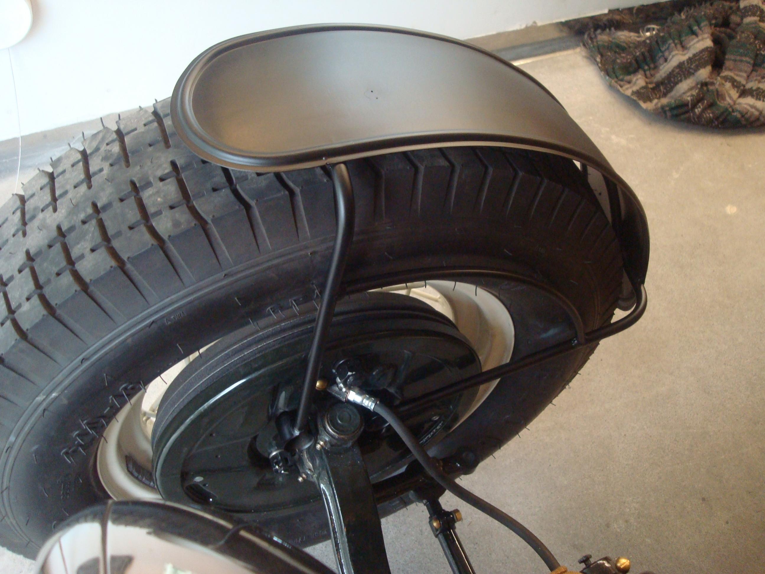

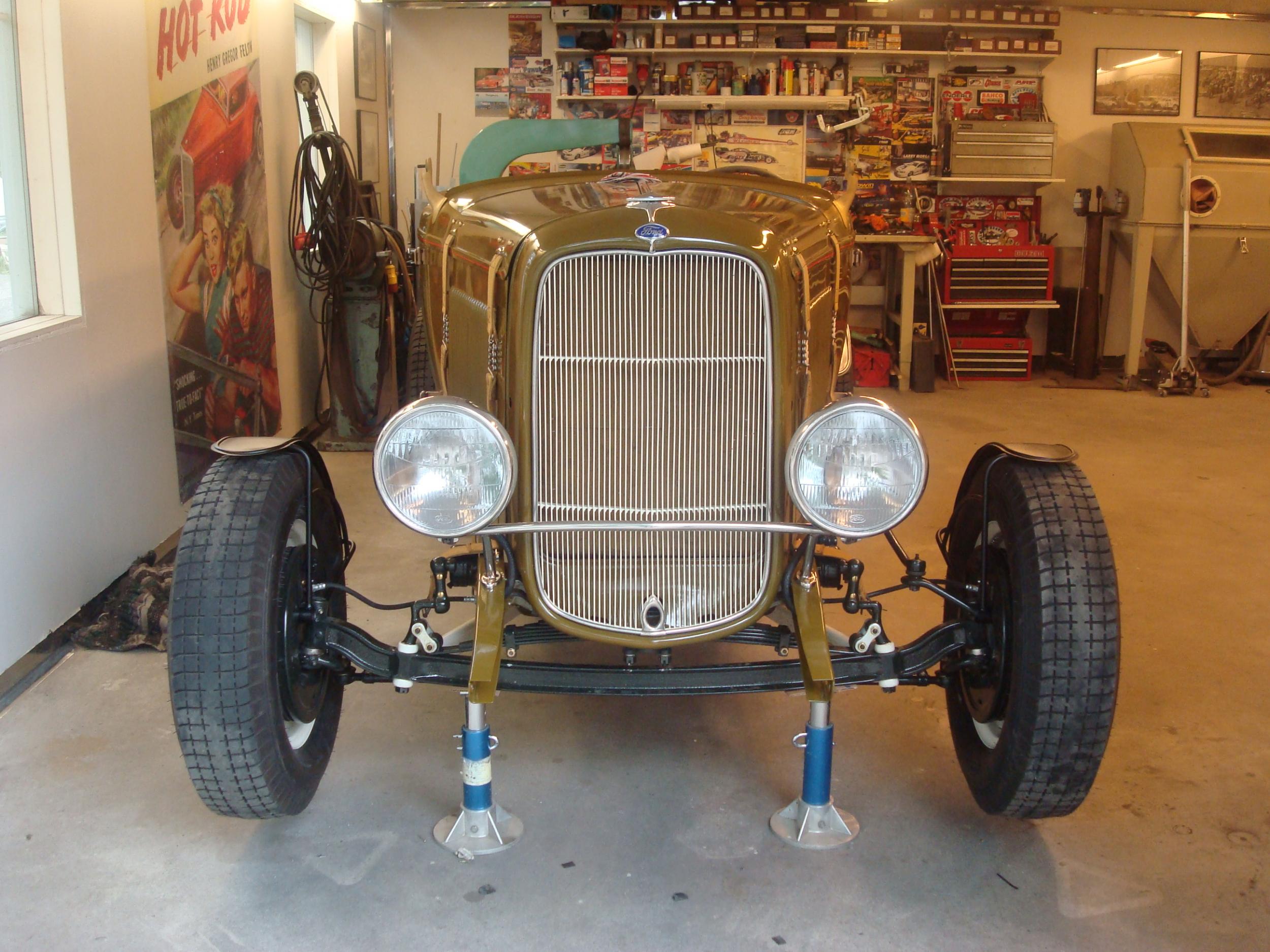

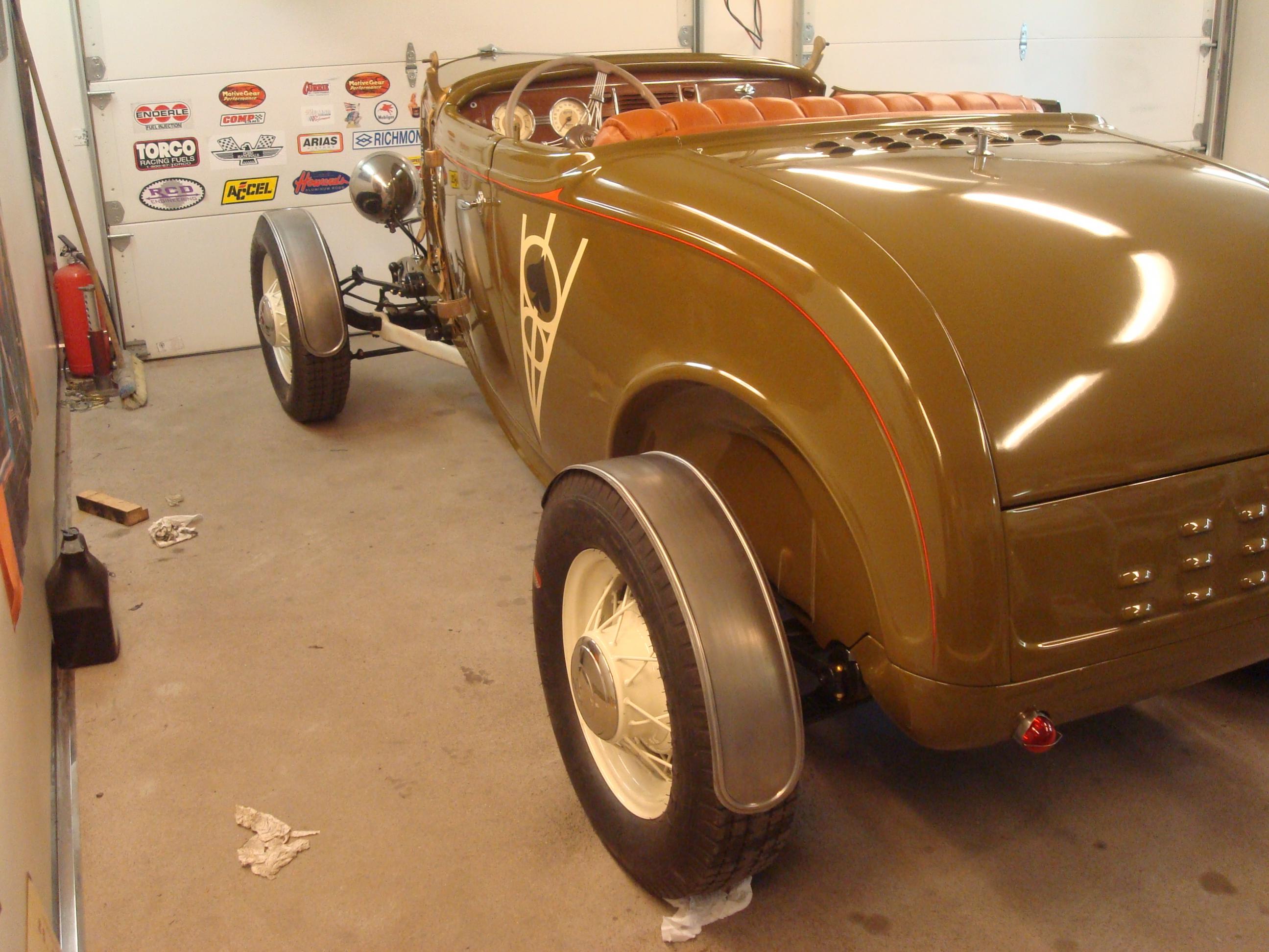

    Today I made front fenders ready. Still takes one day to make rear fenders brackets (hydraulic tube 12mm). Make all so that not damage paintjobs (backingplates, spindles,...).
    Good thing is that after get registered I take fenders off and hope that not need to use those after this case.
    Rgds,AULIS

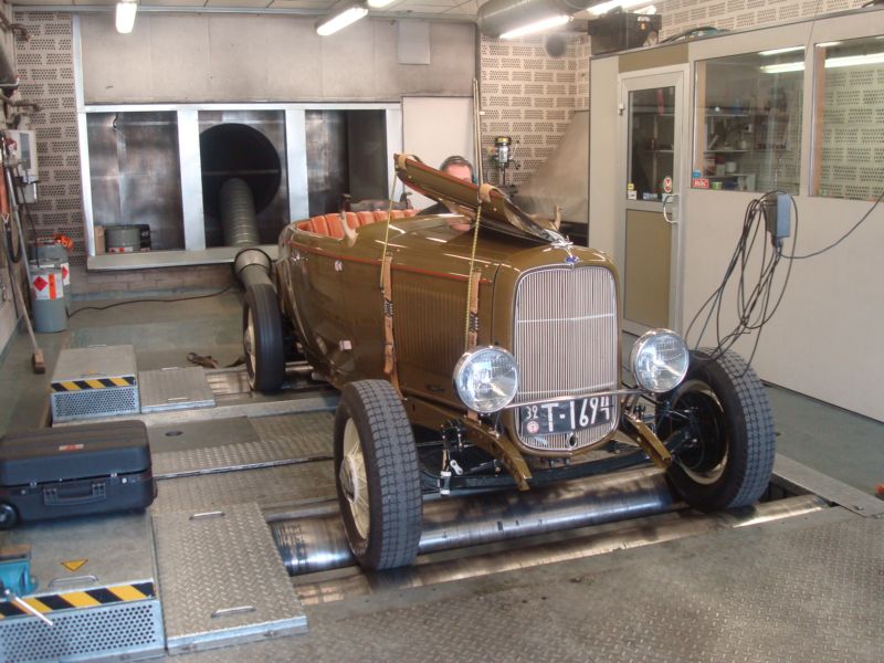

    Engine has been dyno.
    Runs great.
    Aulis

    So what numbers showed up on the dyno?
  24. AULIZ
    Joined: Oct 28, 2005
    Posts: 1,783
    AULIZ
    101,7hp (must be under 102hp due to our law,....) !!!
