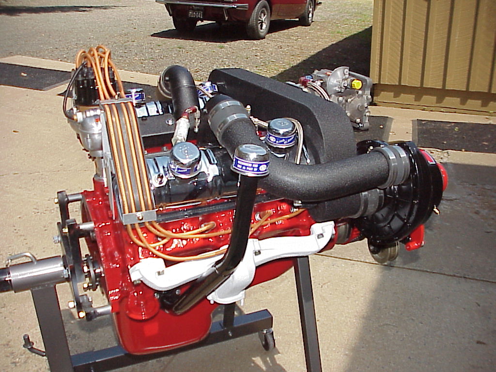

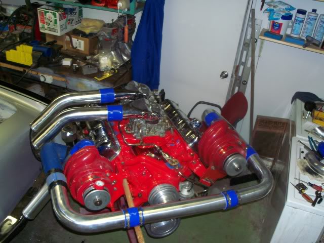

    I recall Carol SHELBY pulled 2 x AC Cobras aside and added twin Paxtons to each 427FE and can imagine what they'll do to your engine. Very low Rockne production numbers by comparison to other manufacturers at that time.
    Lots of information here:-

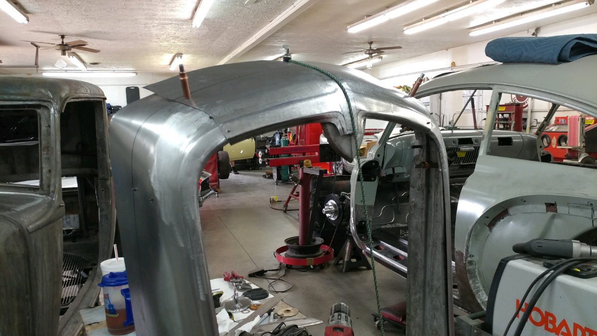

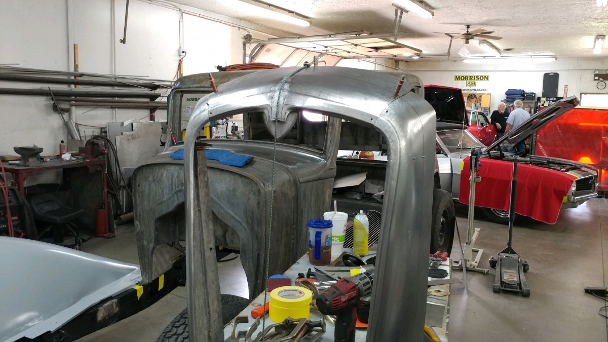

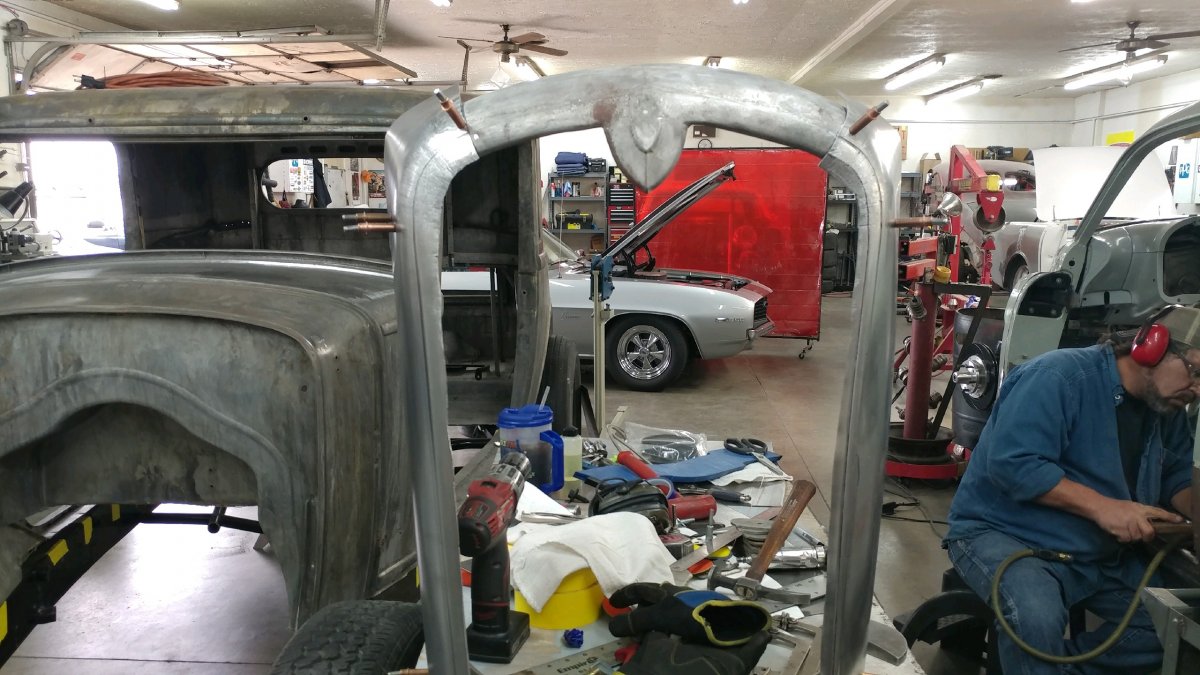

    Tim Robbins with Lo Man Rods has been working the metal on the Rockne. The pictures below show him basically remaking the original grill shell. After stripping it it looks pretty rough. It has been widened and slanted and a lot of the welds were still present. With the addition of the Flying R being added back onto it it needed reworked anyways since it was previously smoothed. They are going to put the insert in it again to see if we want to add the bars in the middle of the grill shell or not.
    IMG_0084.JPG IMG_0082.JPG IMG_0085.JPG IMG_0086.JPG IMG_0087.JPG IMG_0089.JPG IMG_0090.JPG IMG_0091.JPG IMG_0092.JPG

    Most of the floor is gone now. Cross member gone and Studebaker engine is on the way for mock up. Work is continuing on the grill shell as well. Ready to get the car on a ch***is jig.

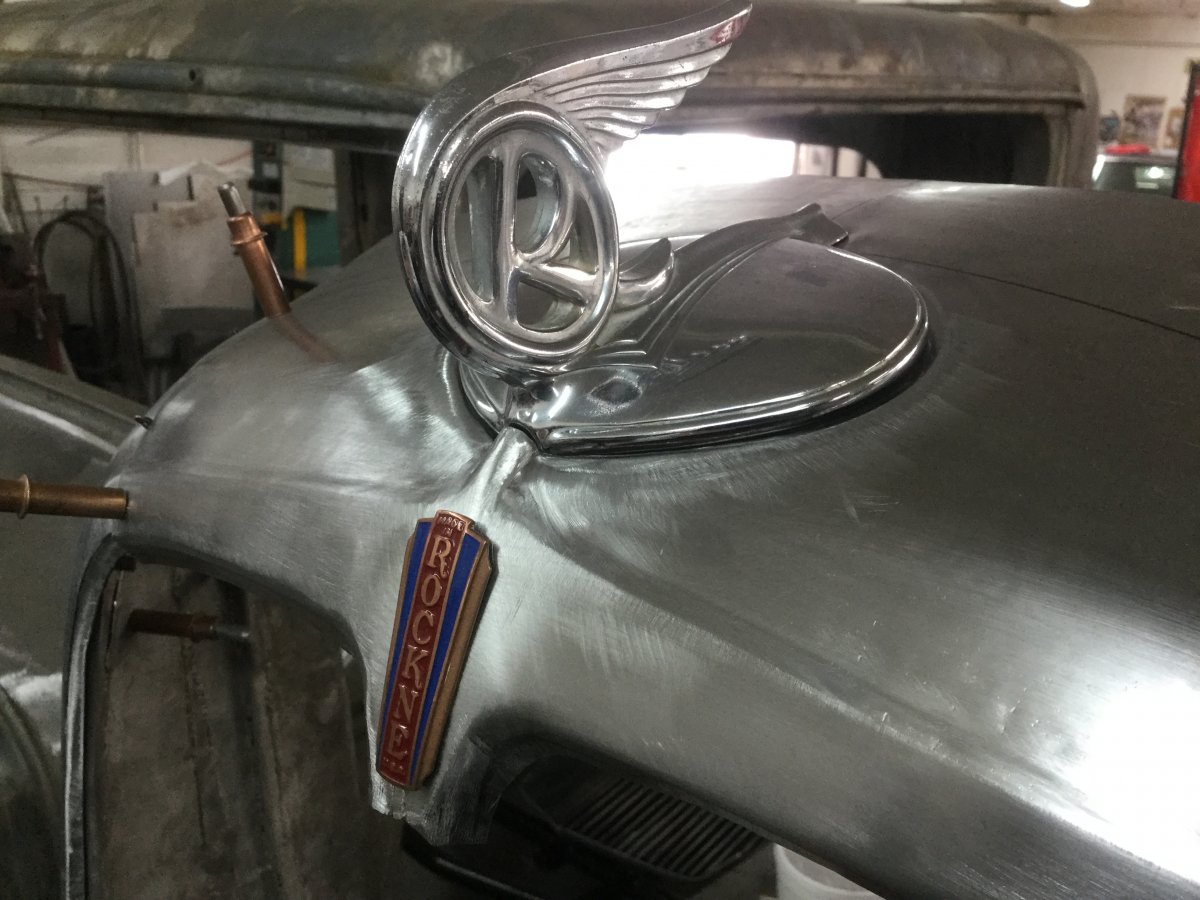

    IMG_0093.JPG The top of the grill shell is taking shape, bead is forming and the Flying R is getting positioned. We are making the top and center for the emblem the way we want it to look.

    The top of the grill shell is taking shape. It is slightly recessed with a lip around it. To me the entire grill shell is going to be a piece of art with all of the work done to it since it will be completely new and reworked off of my previous shell.

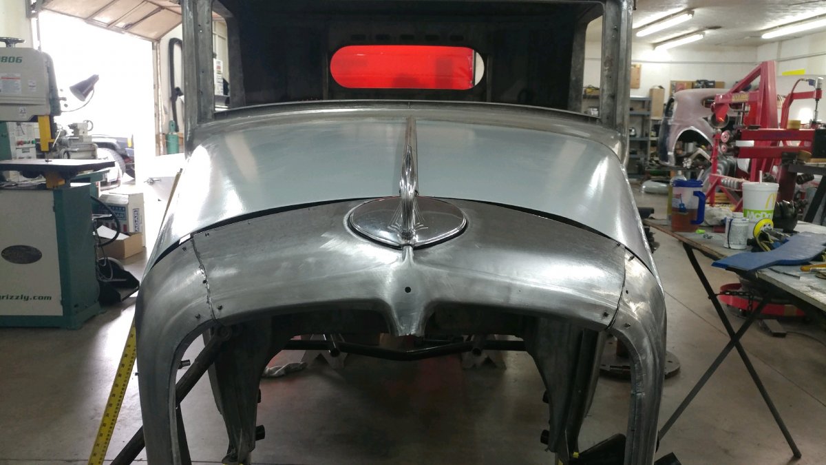

    The shop is continuing to work on the grill shell and now the hood area to tie it all together. Still a lot of work to do.

    The grill shell is now nearing completion. It is stepped in on the sides and can be shown with the mounted radiator. Most of the top and welds are smoothed. I will show a completed picture when done. I am going for the most expensive radiator shell award.
