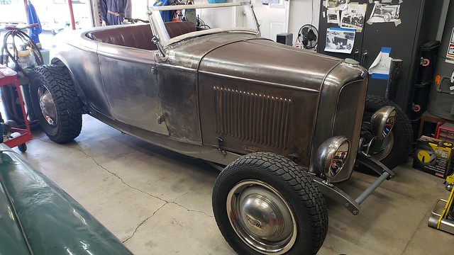

    Been fiddling around; got the front steel wheels on (just transferred the Tesla snow tires over for now) and mounted the headlights. Tried to mount the headlights in the location as if there was a bar going across in front of the grille, to put them about where they be if there was a cross bar. Looked at a whole lot of pictures to come to the conclusion that's where I preferred them. Oh, and I couldn't help popping on the wheel trim since they were just laying next to my work bench; pure silly vanity.

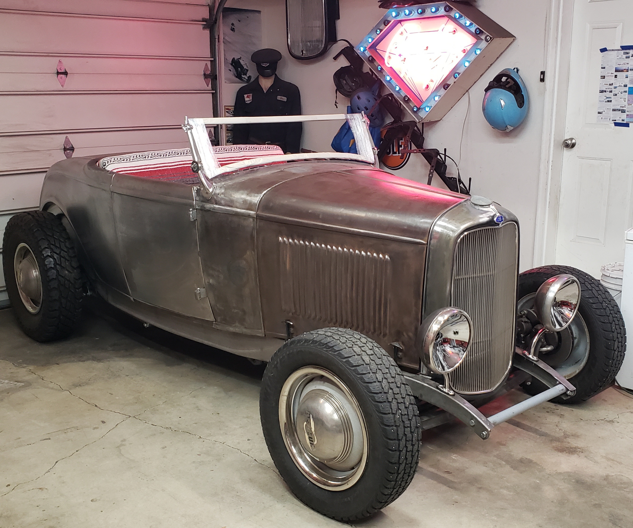

    Slowly plugging away; doing things with the family in the summer slows the projects down a little. Lot's of fiddling with fit and little things now that I've got it sort of built. Hope all your projects and endeavors are going well.
    Dumb question but it'd be helpful if anyone had an answer -
    My hood sides are cracked center bottom (both sides). I'm going to fix this soon, but they've both developed a bow due to this. I'm ***uming the hood bottoms should be arrow straight?

    The car looks great, pretty sure the sides should be flat.

    Deuce hood sides are flat.

    Yes, hood sides are generally flat, but when they are latched they may tend to follow the slight curvature of the cowl at the rear and the grille surround at the front.
    Make them look right on the car, when latched, with good gaps and correct fitting tops.
    Photo above looks good !

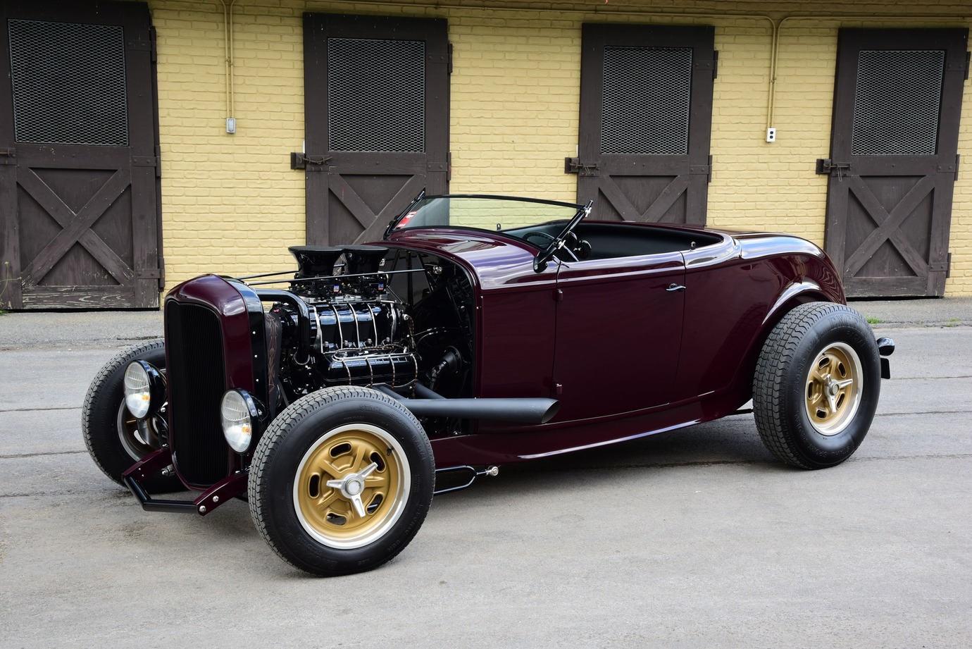

    When you say red I immediately think of the McGee car, a gold standard in the traditional world of deuce roadsters but you are right the bright red and black frame will be somewhat polarizing with people, not that it matters, your car, your choice.
    I do think something in the dark (black) cherry with black frame would look good, pretty sure I've seen that combo before.

    This is called oxblood.
    Check out the black front and rear spreader bars.
