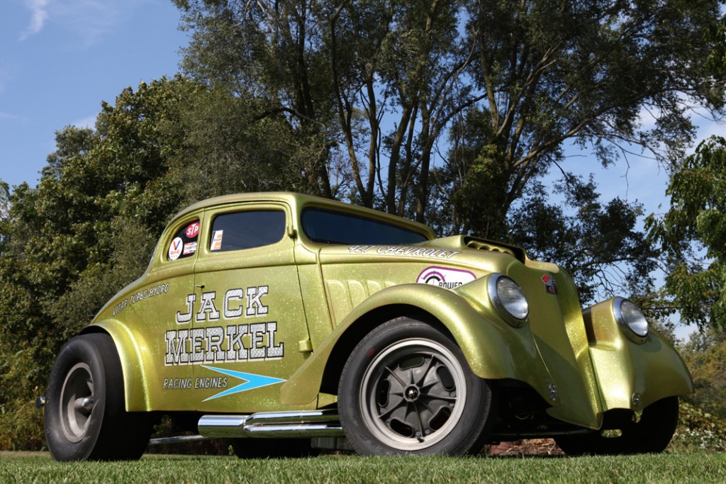

  10. 1934coupe
    Joined: Feb 22, 2007
    Posts: 5,338
    1934coupe
    This was the old Jack Merkel car after he sold it. Now Ron Norman has it and it is completely restored. It was mostly restored by the guy that bought it from Albers & Minnich. It will be at the Melt Down drags coming up along with all Ron's restored and cloned cars.
    Pat

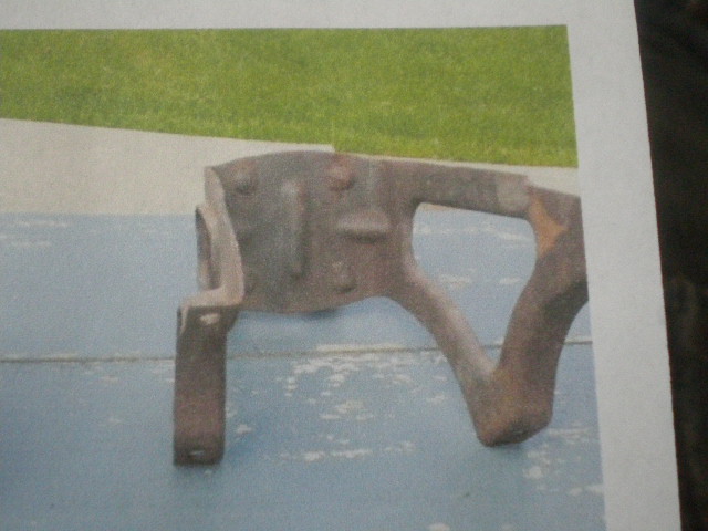

    Building a '33-'36 coupe and am trying to find a spare tire bracket to align the rear panel to the floor at the proper angle. Does anyone know if the coupe and sedan are the same? Heres a picture of what I'm looking for. Any leads would be appreciated.
    Norm

    I don't remember my coupe having that bracket. In fact I am 99% sure it didn't but that was 50 years ago and I am suffering from an advanced case of Partzheimer's. As I recall it just had a (1/4"?) thick round reinforcing plate in that bump with a couple of studs welded in. Is your car steel? If so, all you need to do is drop the panel in the opening and it should align itself. Oh, and be sure to have the trunk lid installed for up and down alignment.

    I think the one with the welded studs was '36, but maybe the bracket was sedan only. A lot of my knowledge is from the sixties also. Maybe someone else will refresh both of our memories.
    Norm

    I believe that bracket was for coupes only. My 34 coupe had one and my 36 sedan did not, I believe the reason was the sedan had more strength since the spare tire hung off the entire back of the car where-as the coupe had a small panel that was not attached to the roof or trunk lid for support. In the sedan I kept my tools in that area behind the back seat back which hinged. It was a decent sized space.
    Pat

    It must be a year of manufacture thing. My coupe is a '36 like you sedan and it didn't have the bracket. They did the major restyling of the front end, moved the location of the gas filler, redesigned the door handles, etc., in '35 and that is probably when they designed out the bracket that was used in '33-'34.

    There used to be a yellow 35 or 6 sedan at a shop alongside the highway in Pearblossum, CA that we p***ed on the way to Palmdale and LACountyRaceway. I took a closer look at it one day and it had one of those spare tire braces in it. Made a mental note, but can't remember if I looked at windshield frame to identify year. No idea where that body disappeared to.

  20. 1933-1935 coupe and sedan up to about serial number 42000 used a spare tire mount bracket. It is bolted through the floor to the crossmembers on the frame. There is no sense bolting it to the floor as it wouldn't line up the rear panel. There is an insulator between bracket and the panel it is not flush to the panel. All 1936 coupe and sedans have a plate attached to the panel as willys36 stated. The studs that p*** through the rear panel have a step after the threads so the wheel and tire won't touch the body. Also the floor in the 36's doesn't have the holes for the bracket to bolt to the frame. I lost all memory on my laptop so I no longer have pics to post.

    My thought is the bracket with the "correct" thickness of insulator will give me the correct mounting angle for the spare tire panel. I have most of the layout issues completed and could do without it, but I tend to be ****. I would like to use most of the sedan panel to form the one for the coupe.

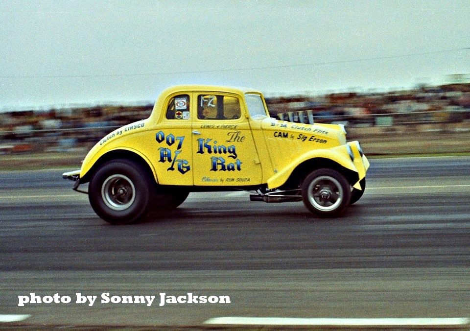

    Photo by the Great Videographers and photographers, The Jackson Brothers.

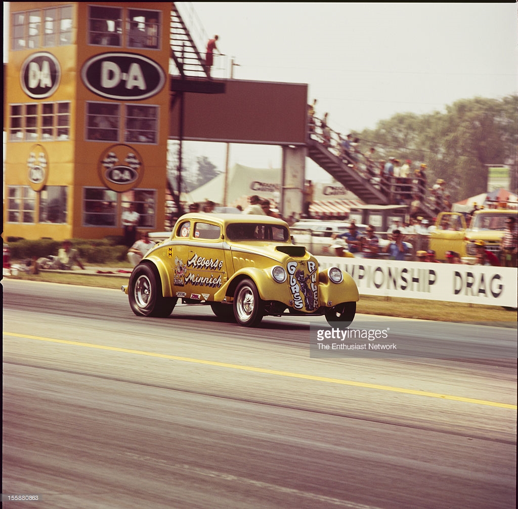

    I think he's talking about this pic.

    That's it . that's my dad driving at mission by the looks of it.whos got this pic?
