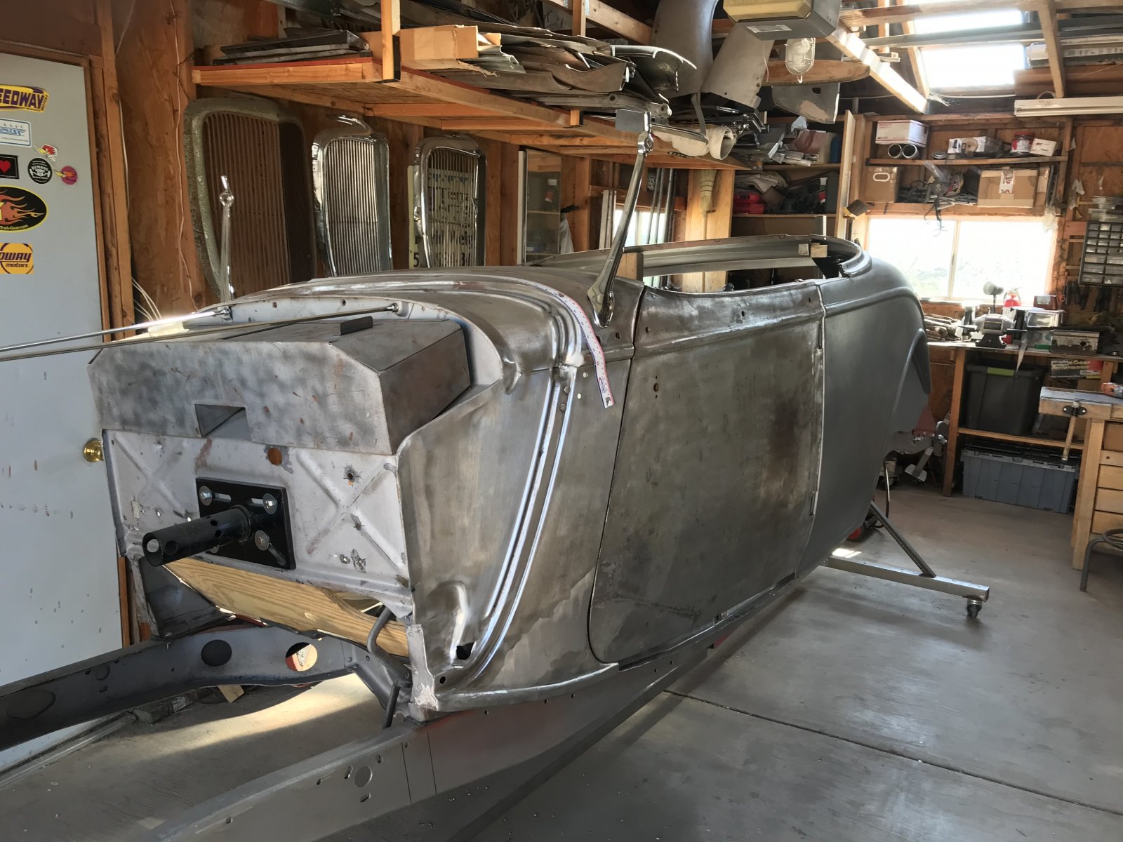

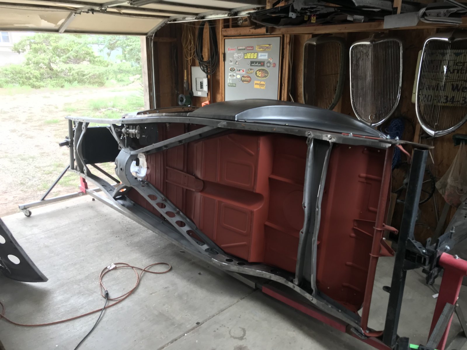

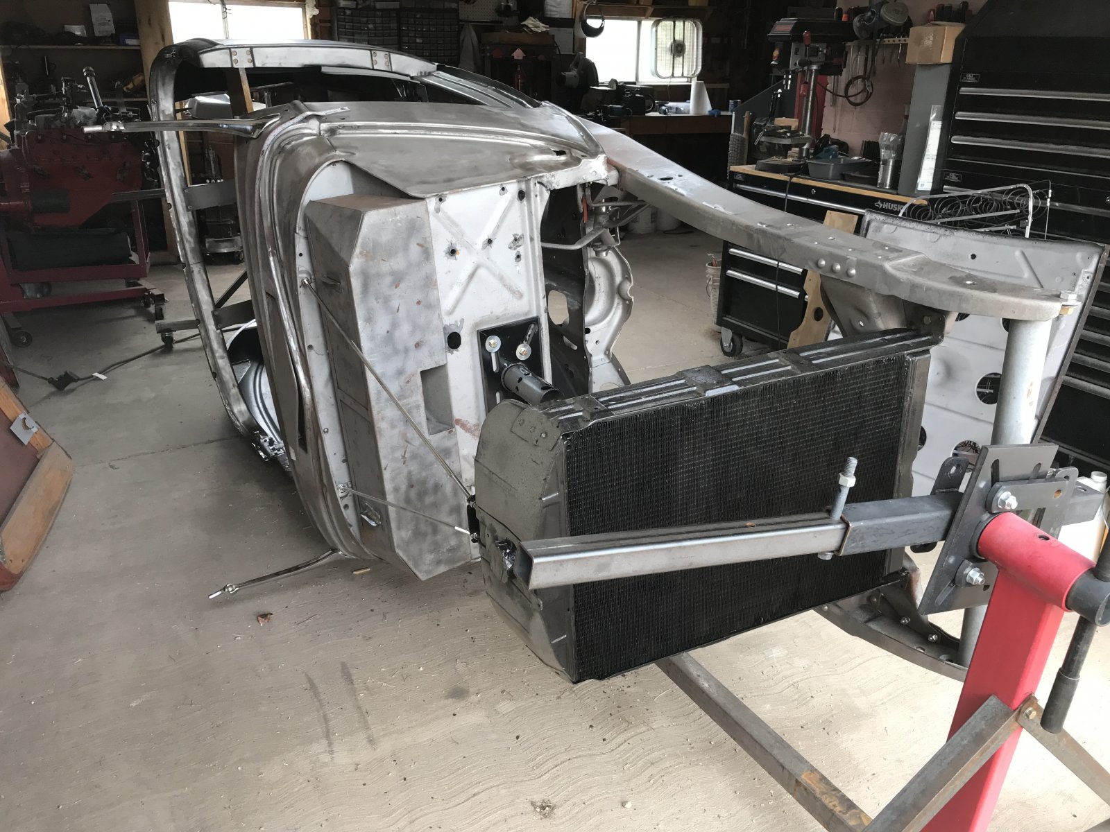

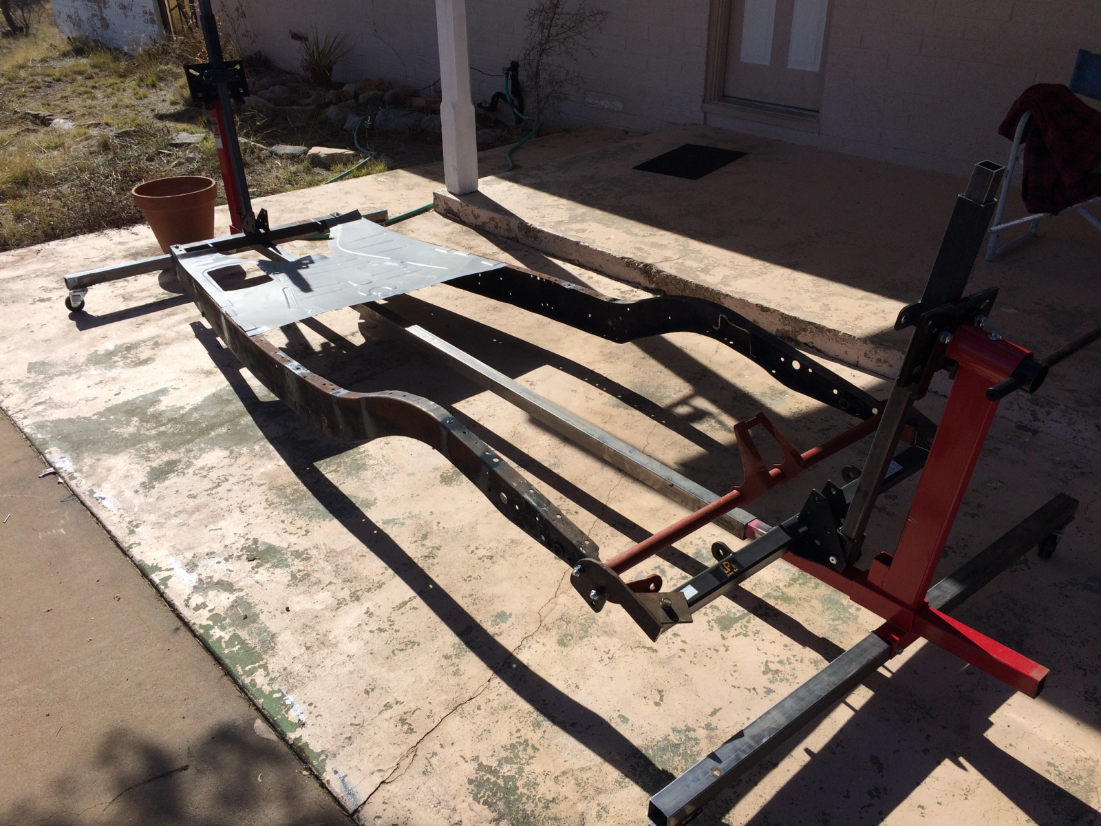

    couple harbor freight engine stands and some 2X2 tubing
    loudbang and Stogy like this.
  2. Do you find the stands will hold the weight? Do you have any issues with binding on the while turning it around like you would if an engine was on it?

  3. Elvis100
    Joined: May 21, 2016
    Posts: 677
    Elvis100
    Seems to be doing fine, I’m probably close to the max weight that I’m going to be. Once I finish fitting the doors, the body will come off and I’ll use it to paint the frame. I did replace the lower horizontal with a longer piece and installed some angle iron gussets. It’s not up high enough for a complete rotation, but I get a very stable 95 degrees.

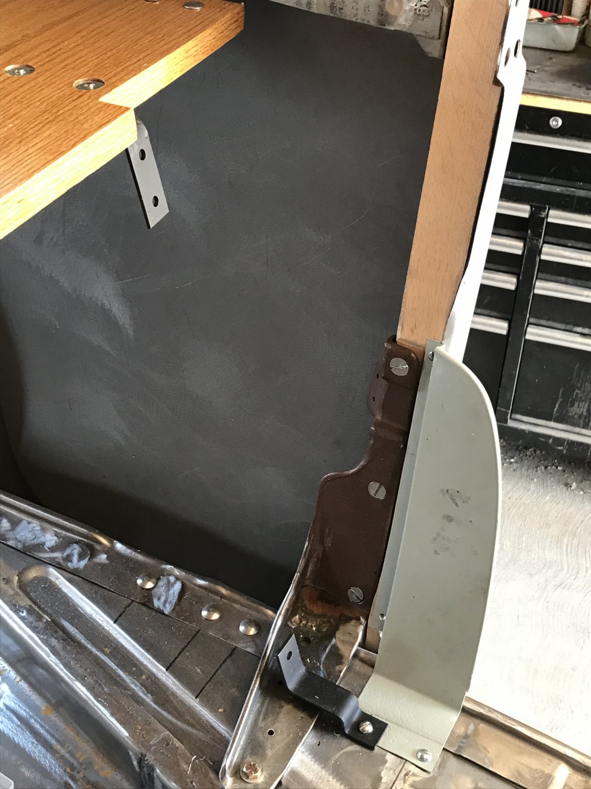

    Posts: 677
    Elvis100

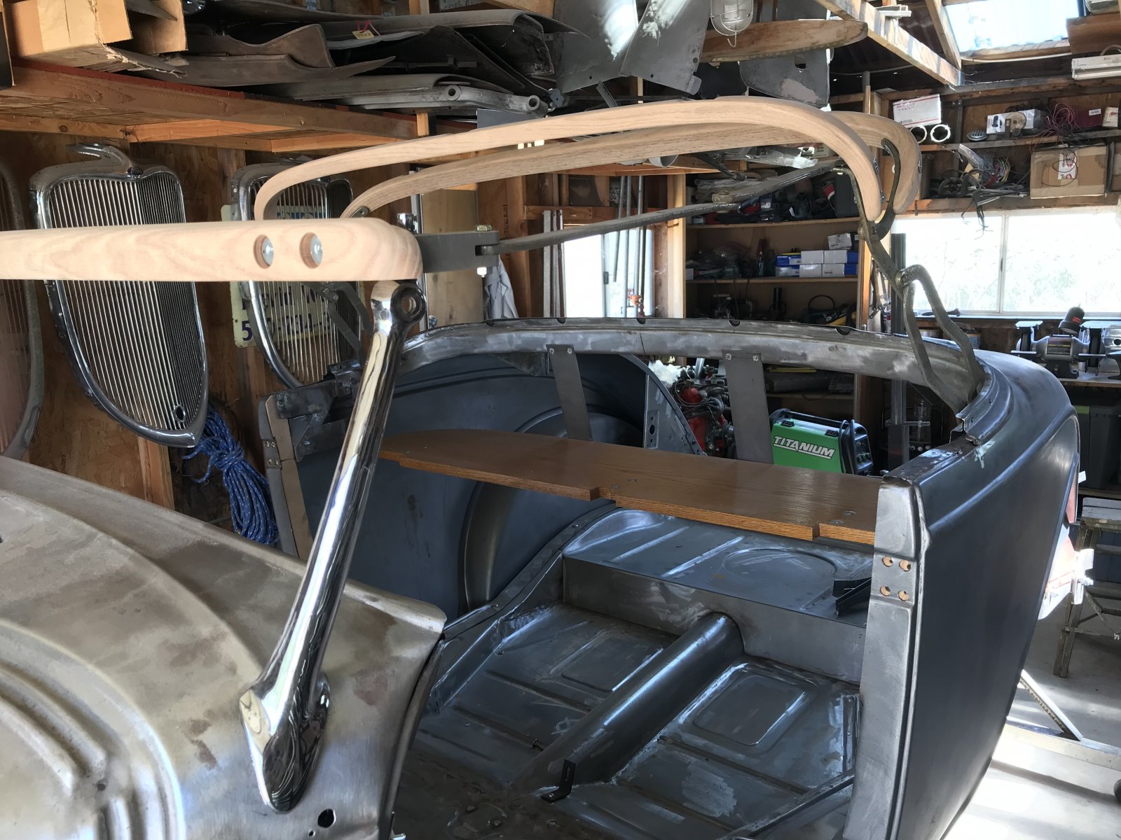

    I had to remake the wooden b-pillars to get a better fit. Unlike metal, you pretty much have to start over. Once I got them installed, I did a test fit of the drivers door. The lines are looking much better. I ended up moving the top of the B out about 7/8 inch on both sides.

  6. Elvis100
    Posts: 677

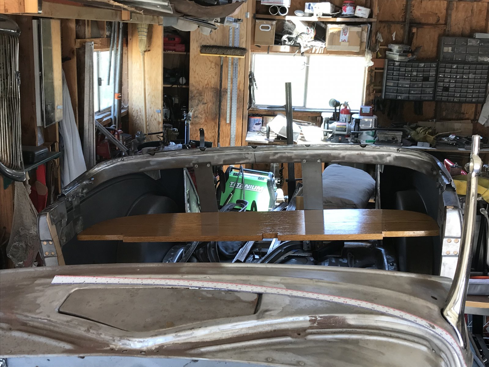

    Elvis100

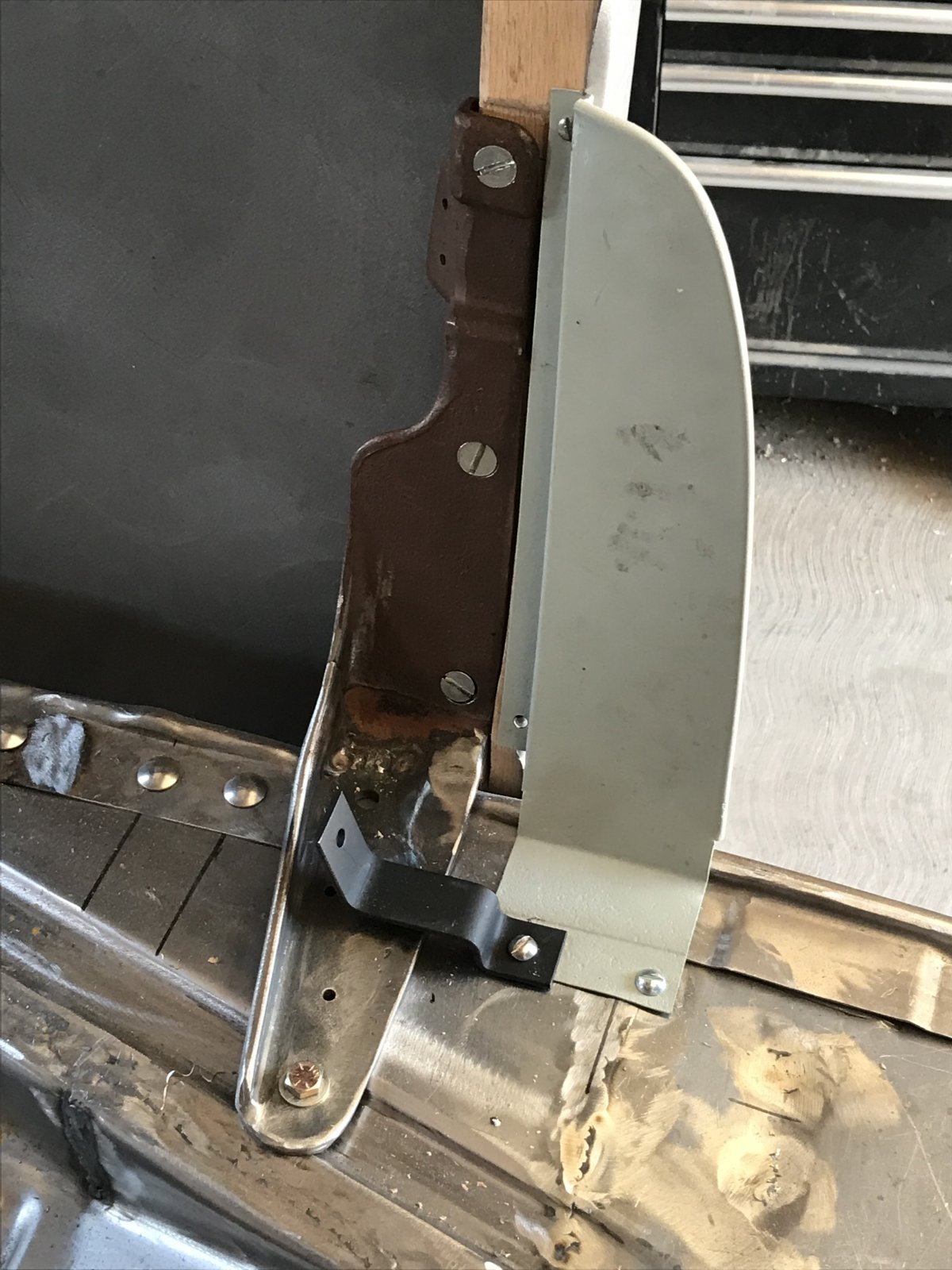

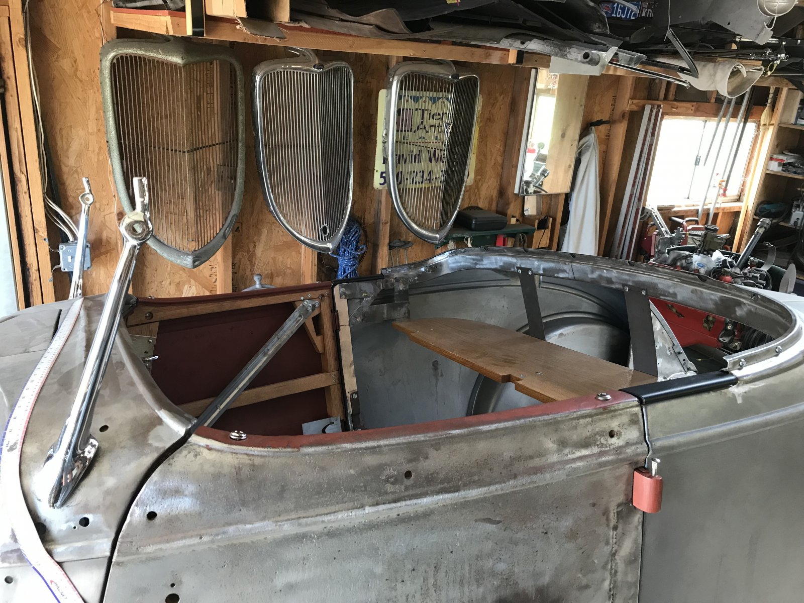

    Got the “hoop” rear surround installed. Instead of riveting the b-pillar upper brackets, I made 1/4-20 bolts with waffle heads to resemble the ford rivets. This will make it easier when I take it apart again. Also, got the package tray sitting in position….now I have a place to pile tools.

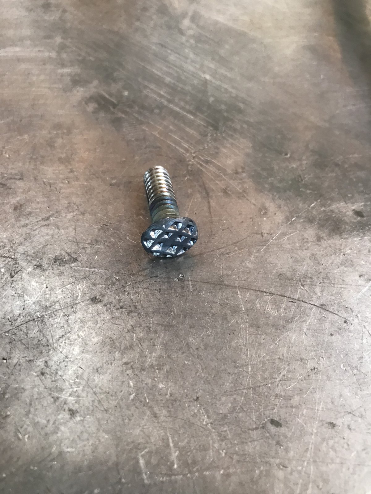

  8. loudbang
    Posts: 40,342
    Nice, can you explain a bit on HOW THE HECK YOU "MADE" these awesome bolt heads. :)
  9. Elvis100
    Posts: 677
    Elvis100
    Thanks.
    I chucked up the threads of a 1/4-20 bolt in my drill, profiled the flats off and slimmed the head down using a angle grinder with a flap wheel. Could also be done in a lathe. I used an anvil with a hole just a little larger than the bolt and set it in the hole so just my new round head was showing. Heated to red hot with oxyacetylene torch and waffled it with a waffle patterned rivet set.

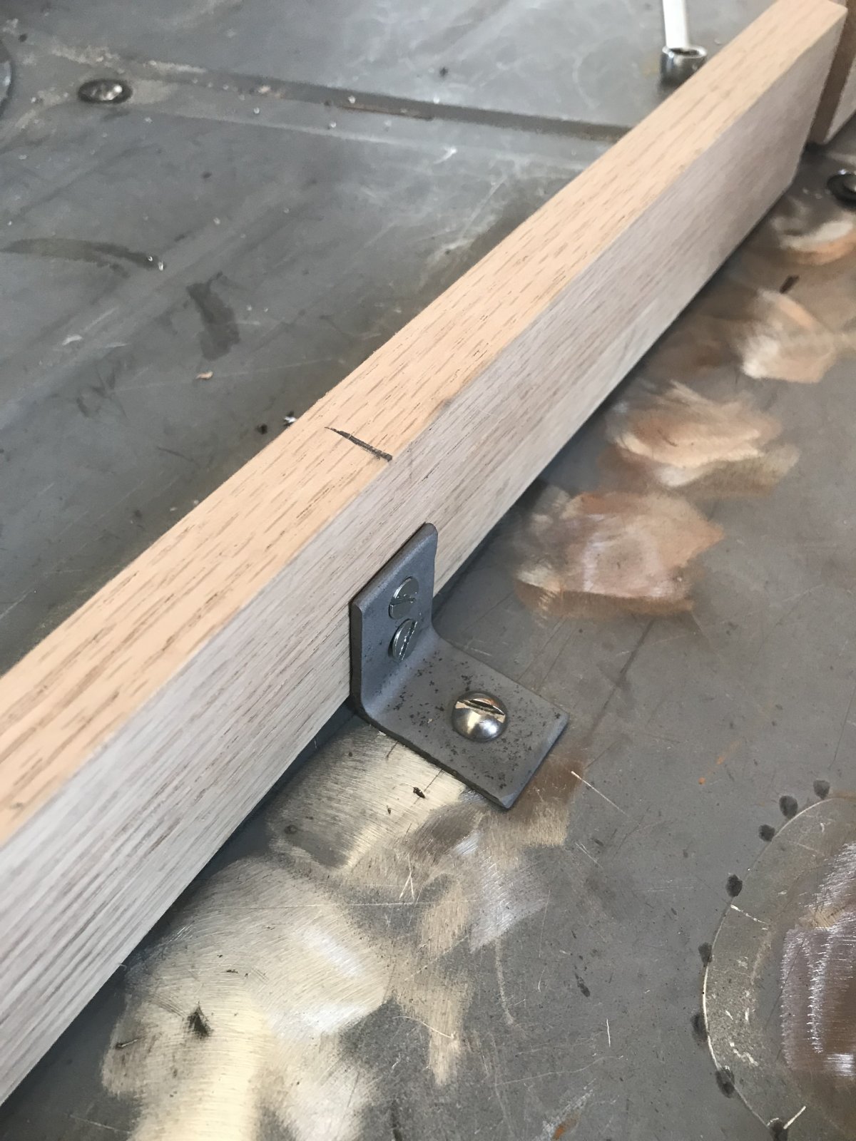

    Made the seat riser and the small L-bracket that mounts in the center of the seat riser. The metal pegs align with corresponding holes in the bottom of the seat cushion and fix it in position. I guess you could put a tool kit under the seat.

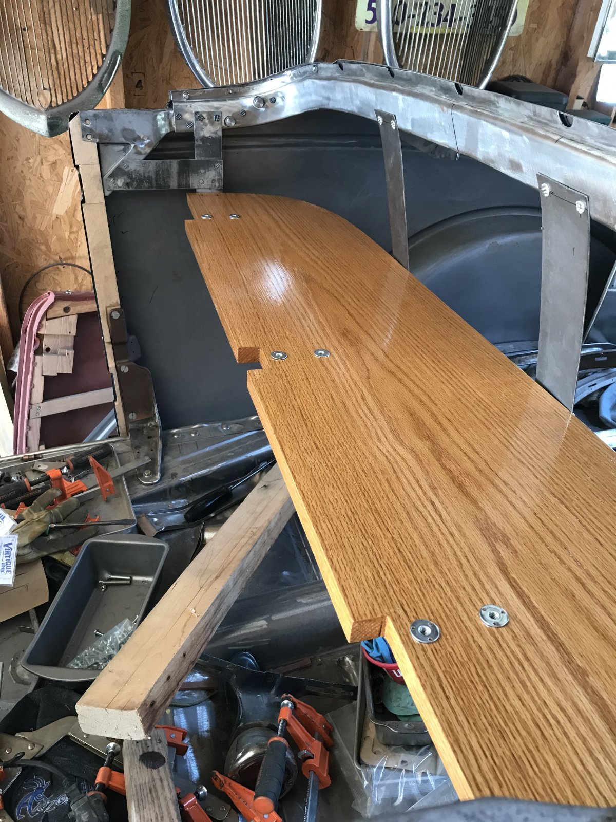

  15. Elvis100
    Posts: 677

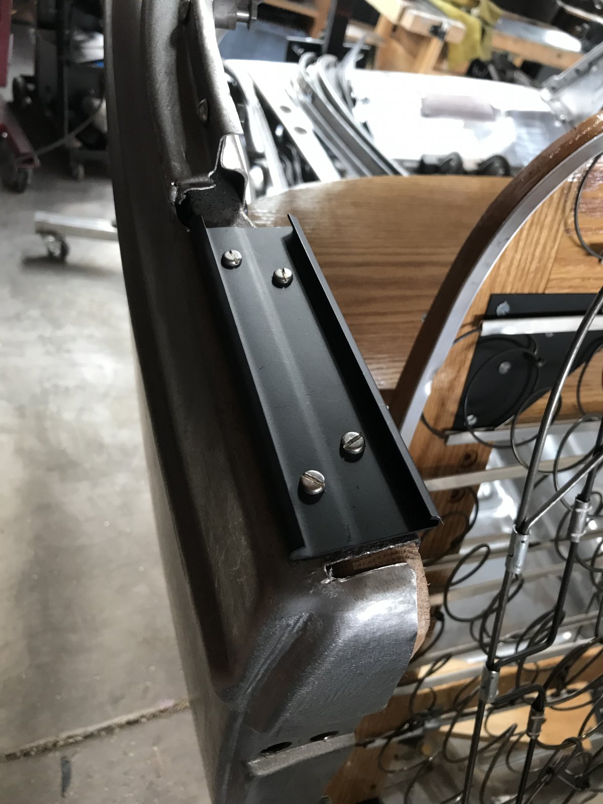

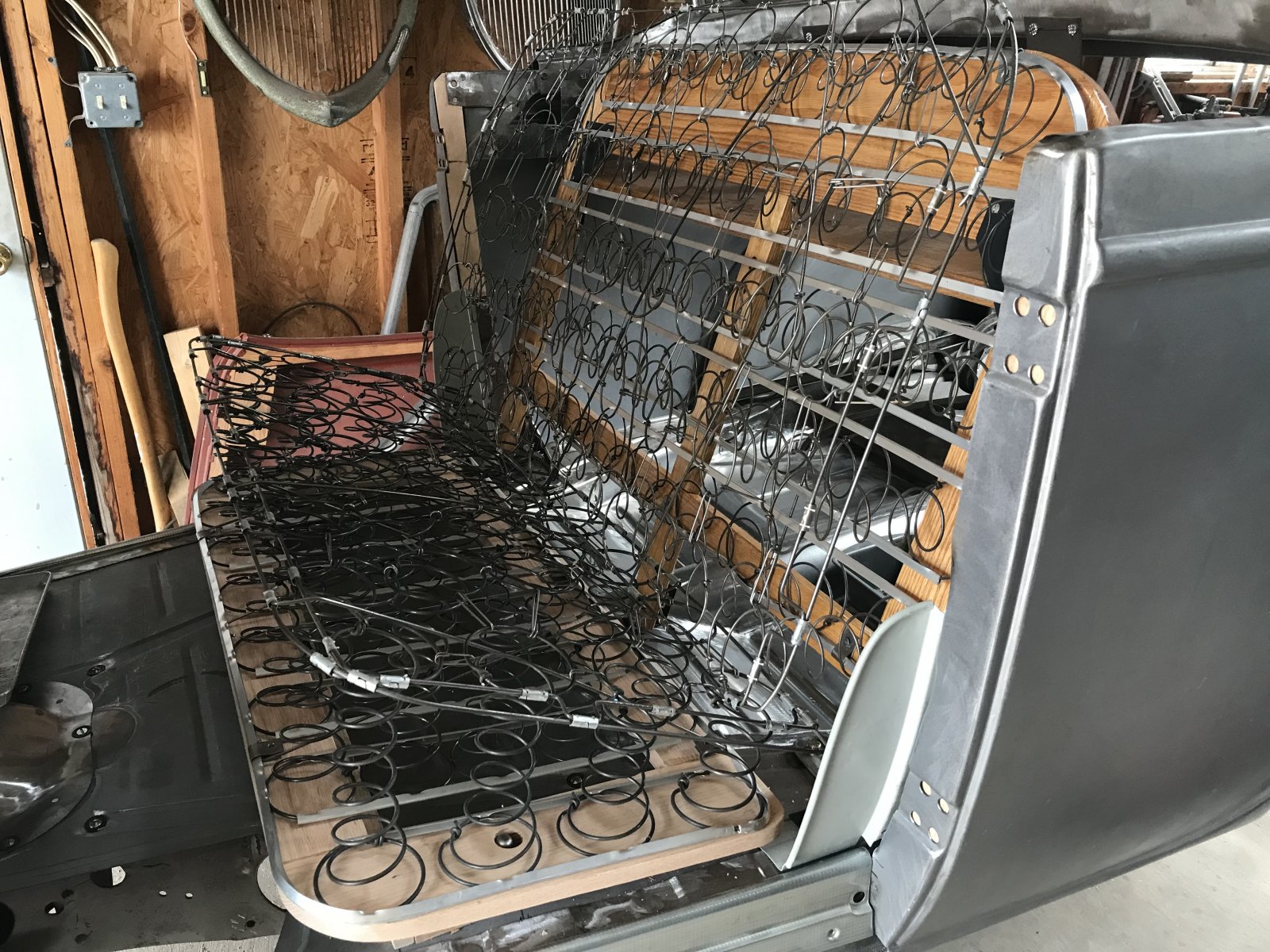

    Elvis100

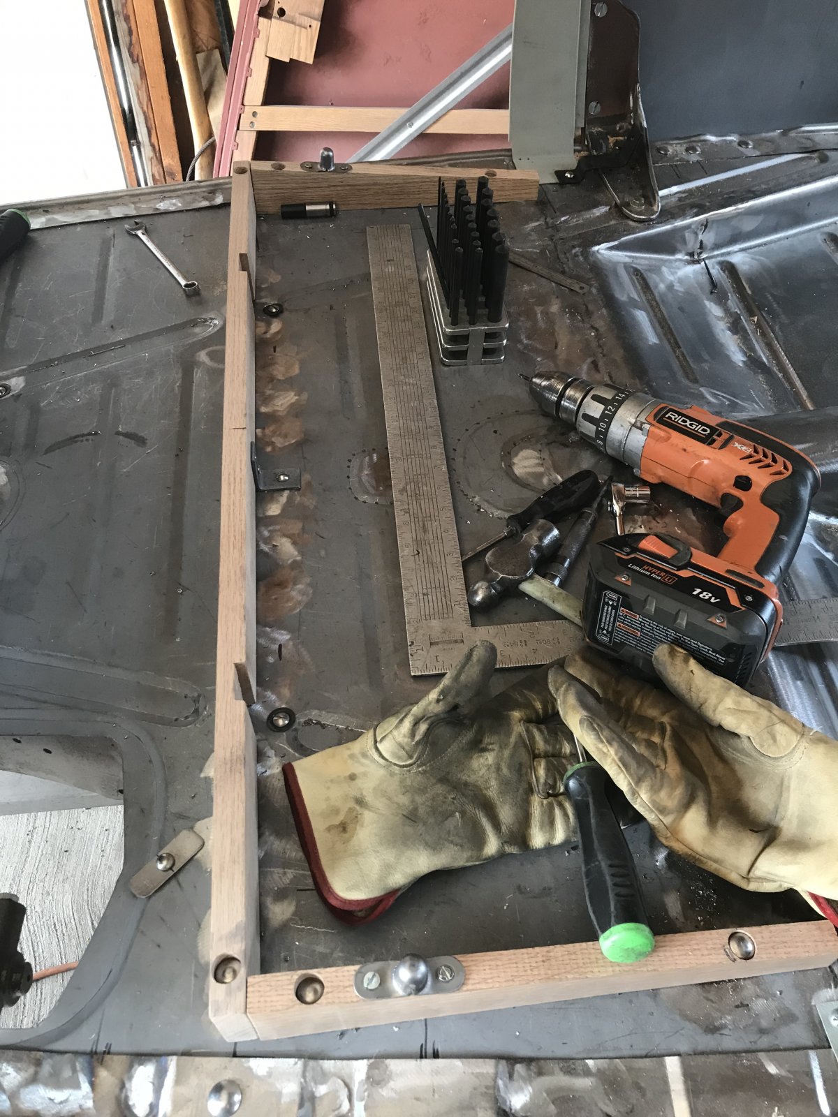

    Installed the strengthening brackets on the seat back (another excellent reproduction made by Bill Monzo) and the seat back springs. Got the first coat of varnish on the seat bottom. I’m only doing two coats on the seat parts because they will be covered. I’ll do at least one more coat on the package tray once I get closer to final assembly. Rotated the body to weld up a couple extra holes I drilled mounting the seat riser. Was a good opportunity to completely clean up.

  18. Elvis100
    Posts: 677
    Elvis100

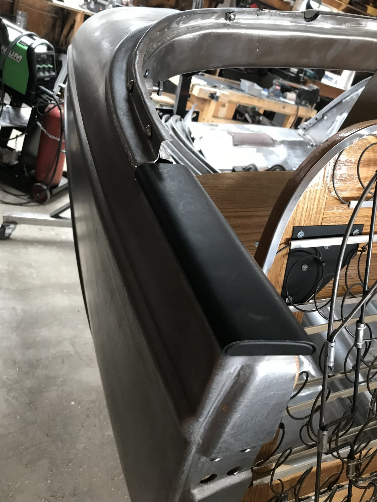

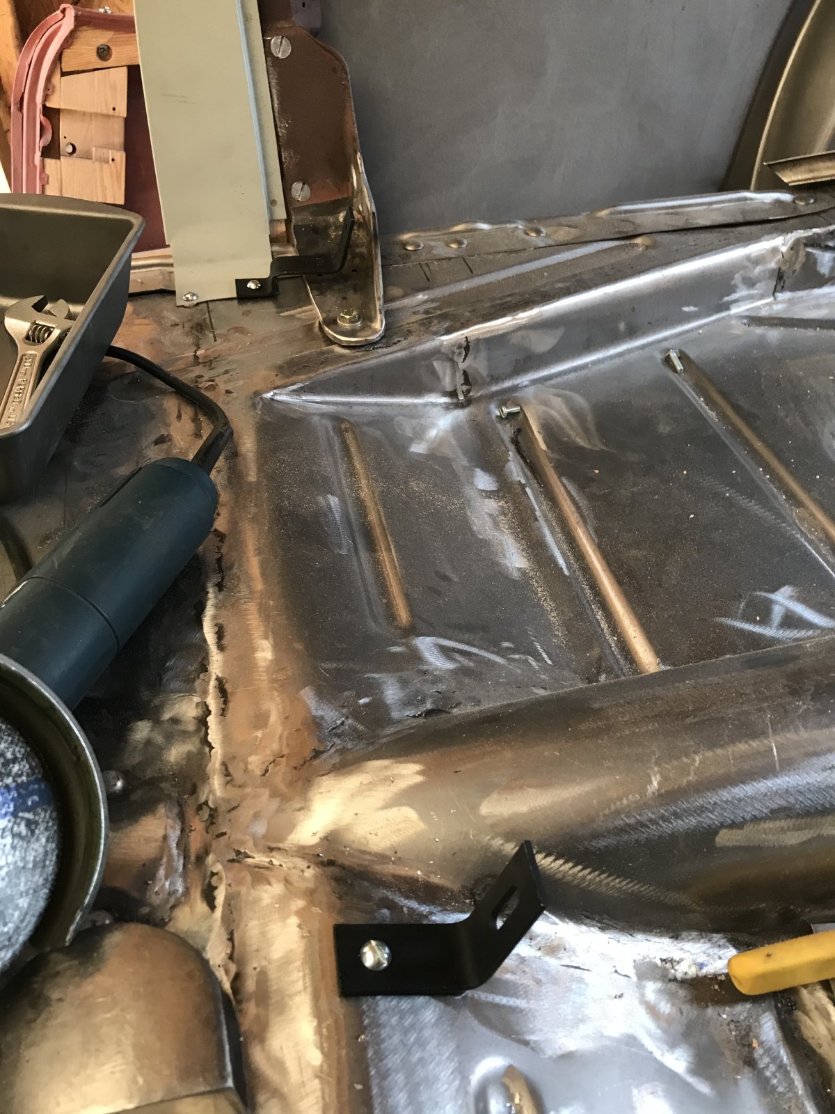

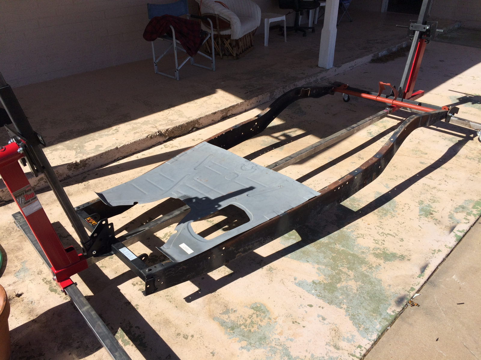

    Finished welding those holes on the floor. Did the second coat on the seat bottom, I’ll attach the springs and take the seat to the upholstery shop tomorrow.
    Installed the quarter panel caps. These snap over a keeper on the top of the quarter panel just behind the doors. I have some originals that have been through a meat grinder, so I’m using these reproduction caps also made by Bill Monzo. Really excellent!

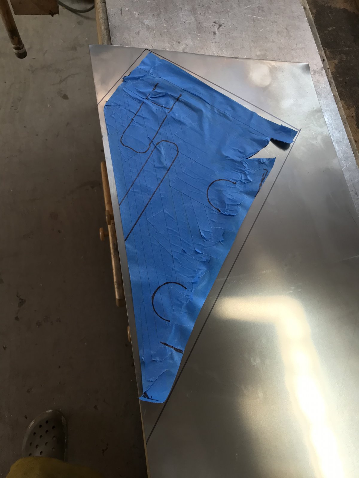

    Elvis100

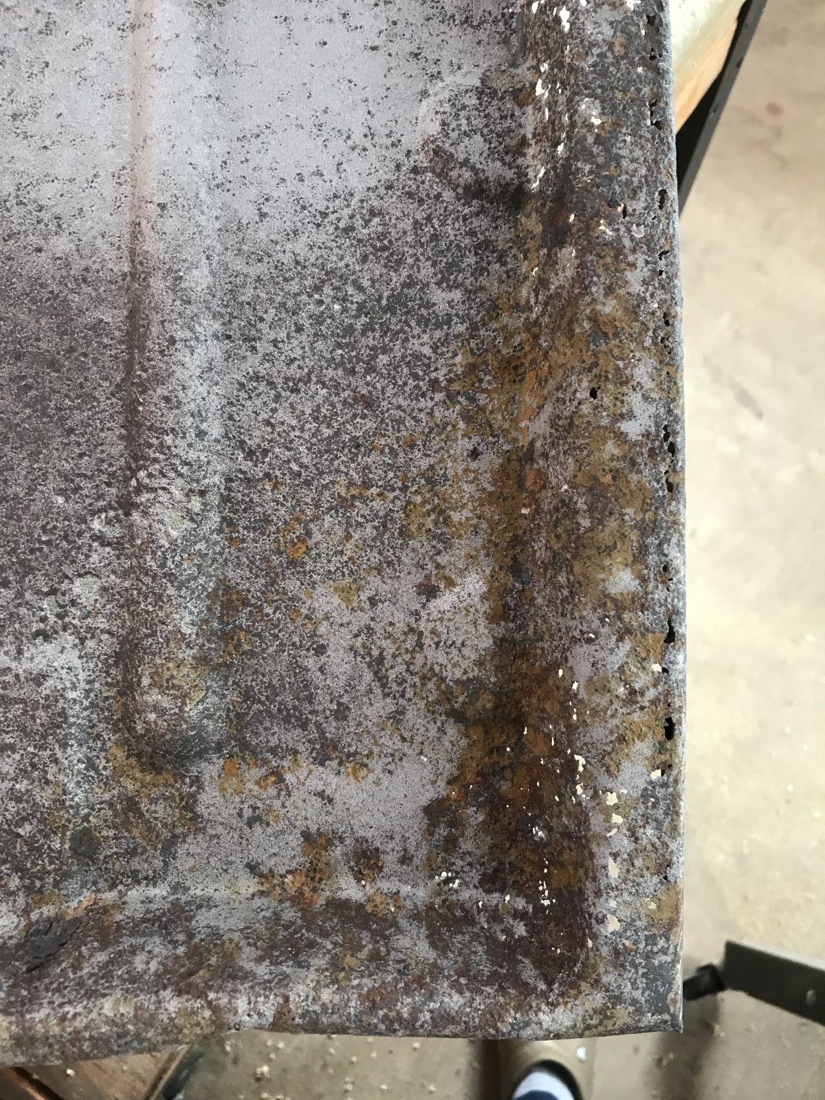

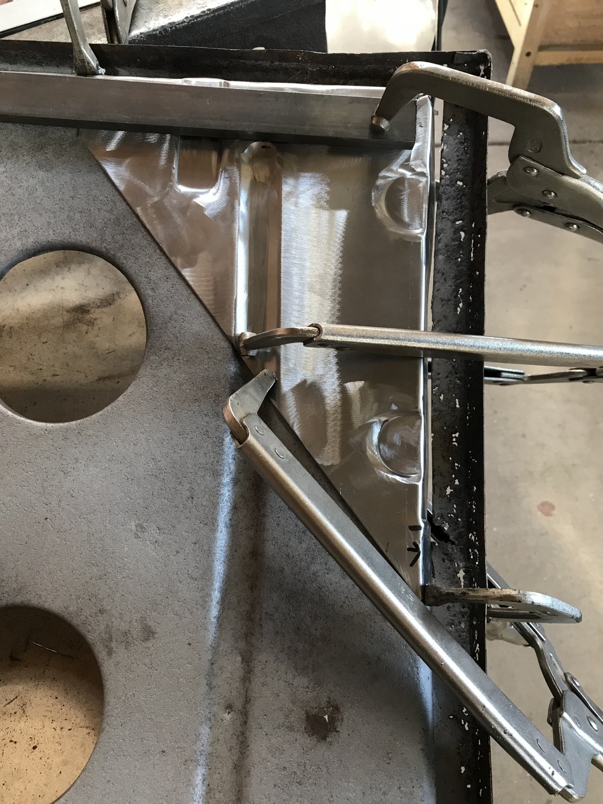

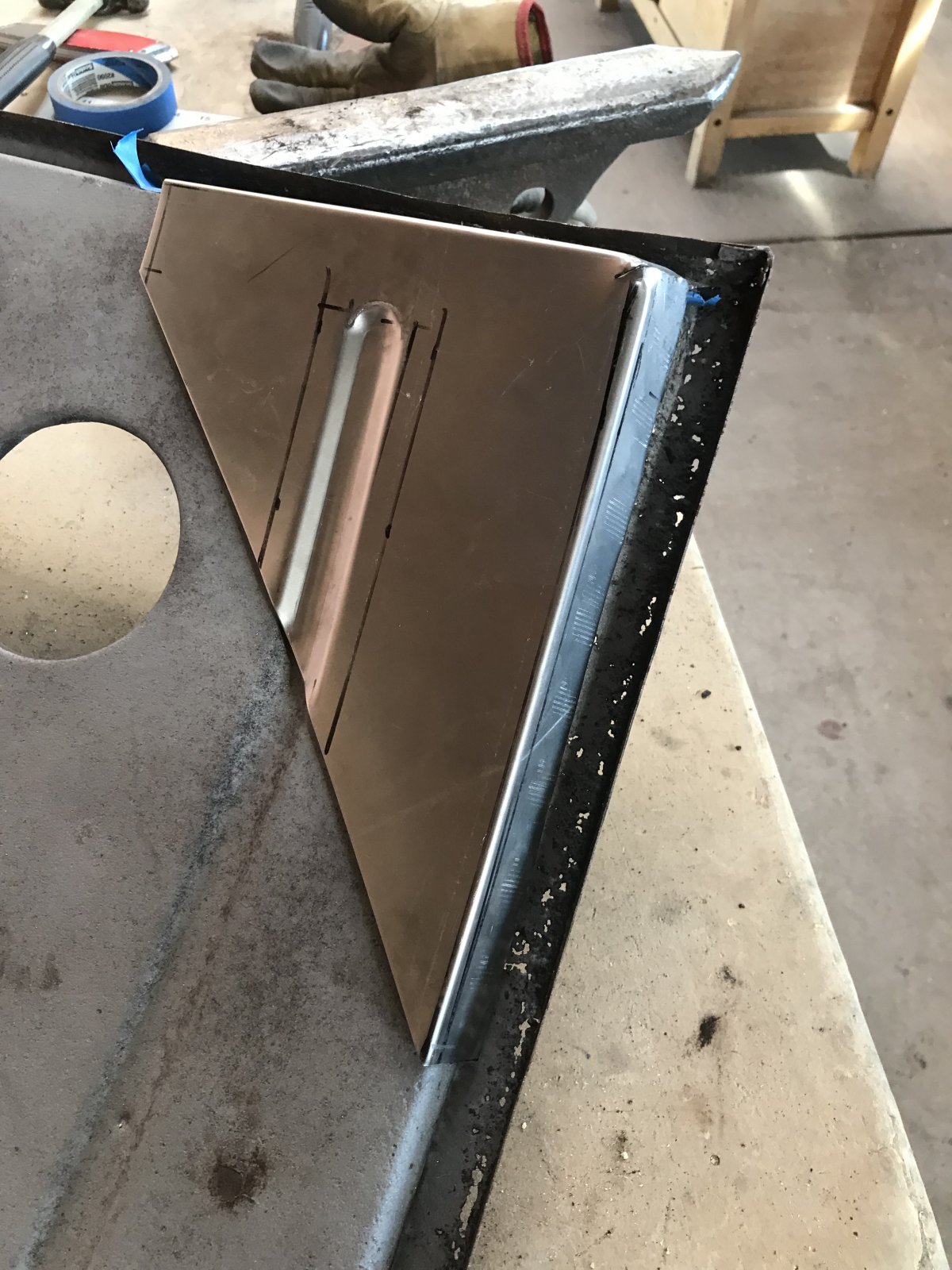

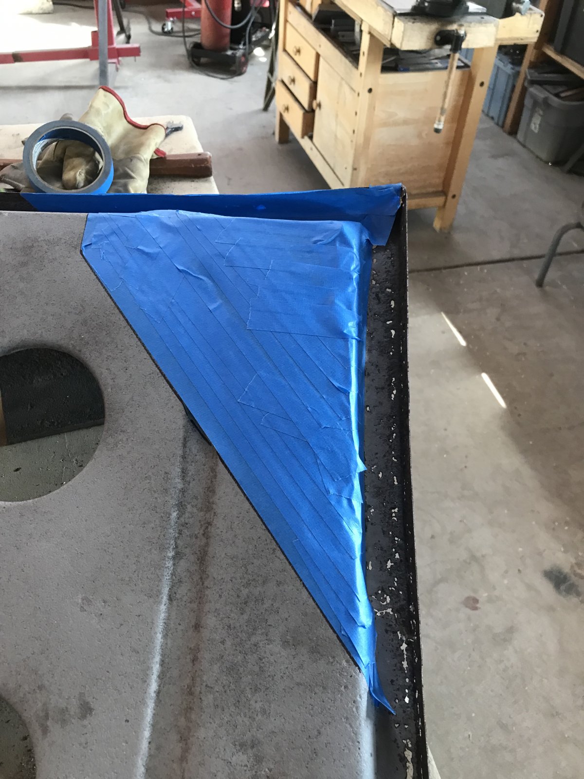

    The bottom and edge and corner of my trunk lid inner are a bit lacy. I’m going to make the patch in 3 or 4 parts.

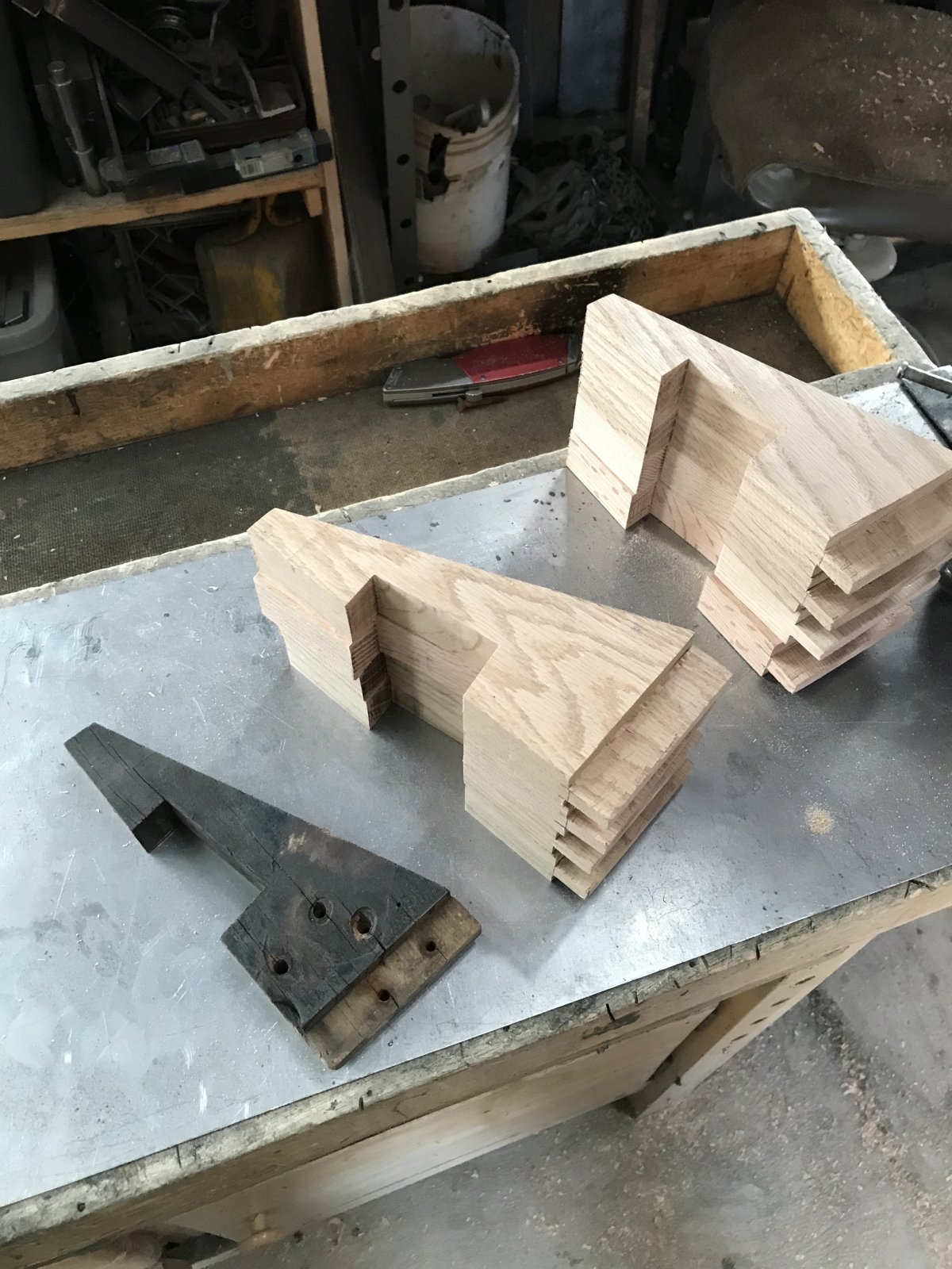

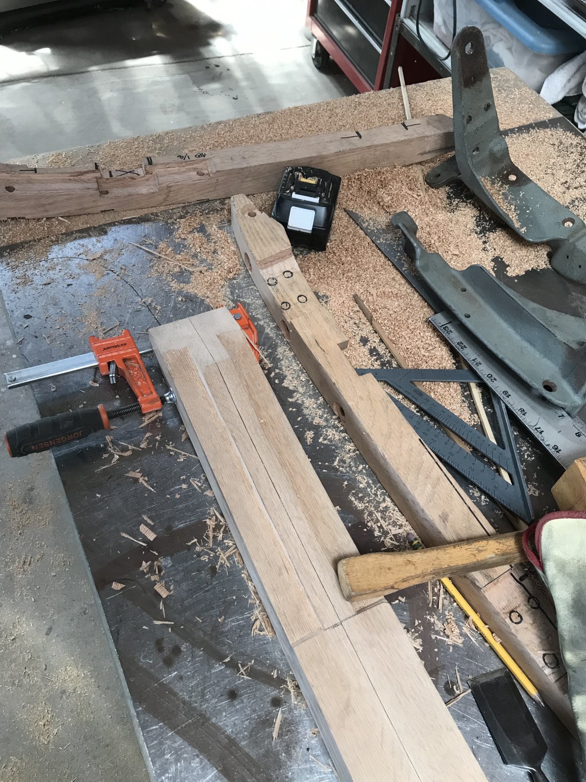

    Easing back into it after vacation. Made a small batch of top bows and set aside one set for myself. Don’t worry, I’m going to make some stainless steel top irons for myself. Just checking out the chop

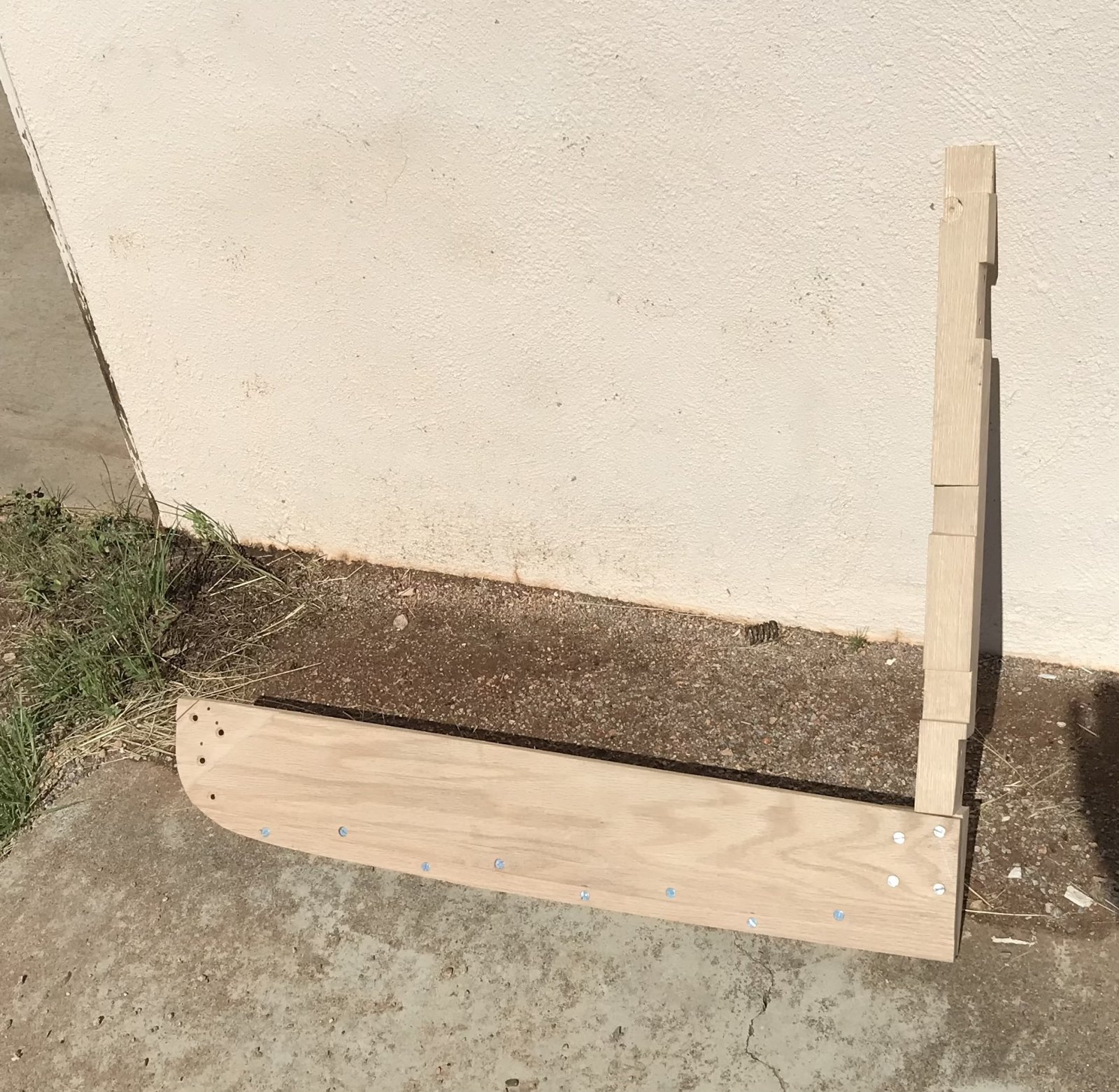

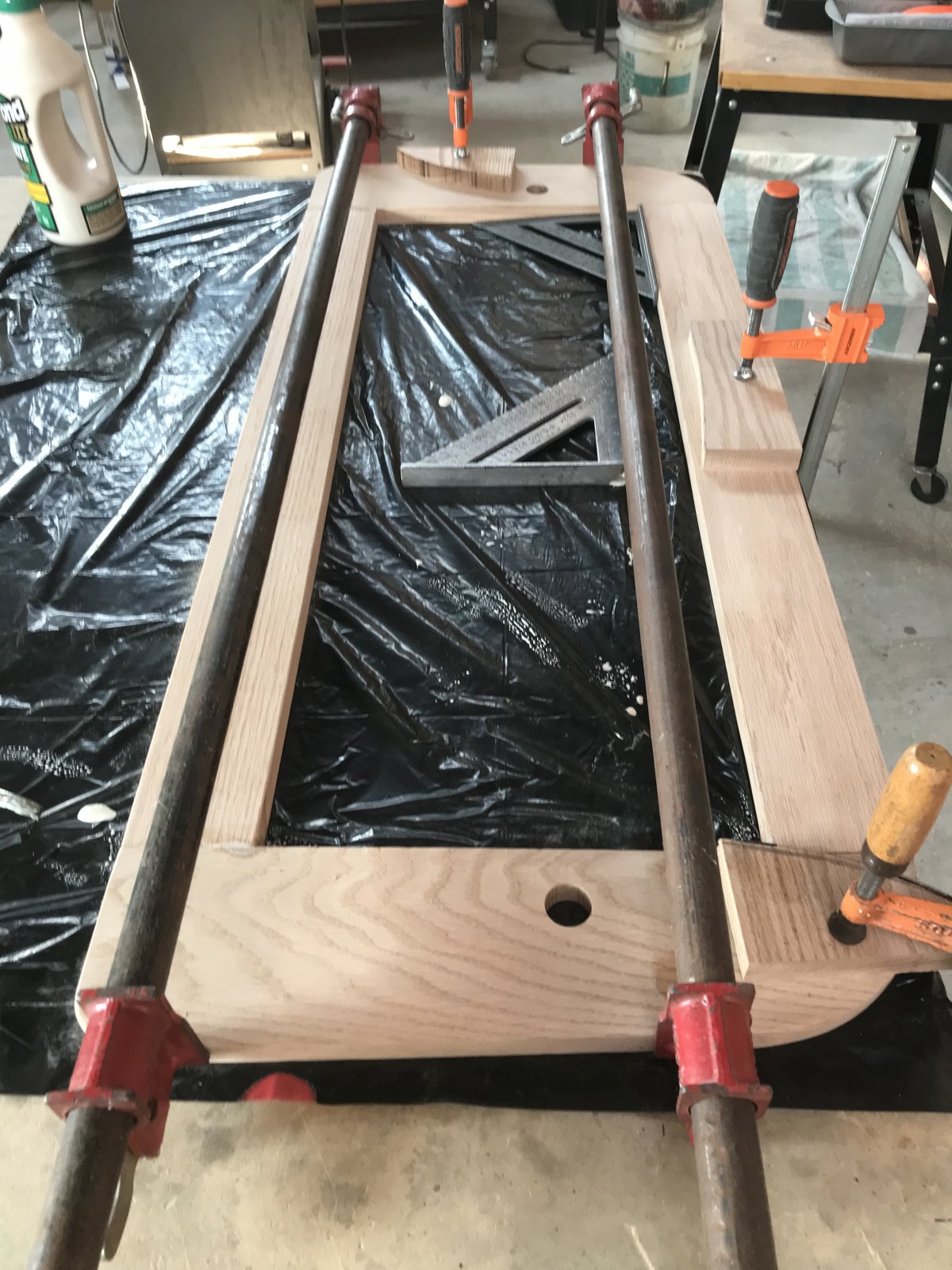

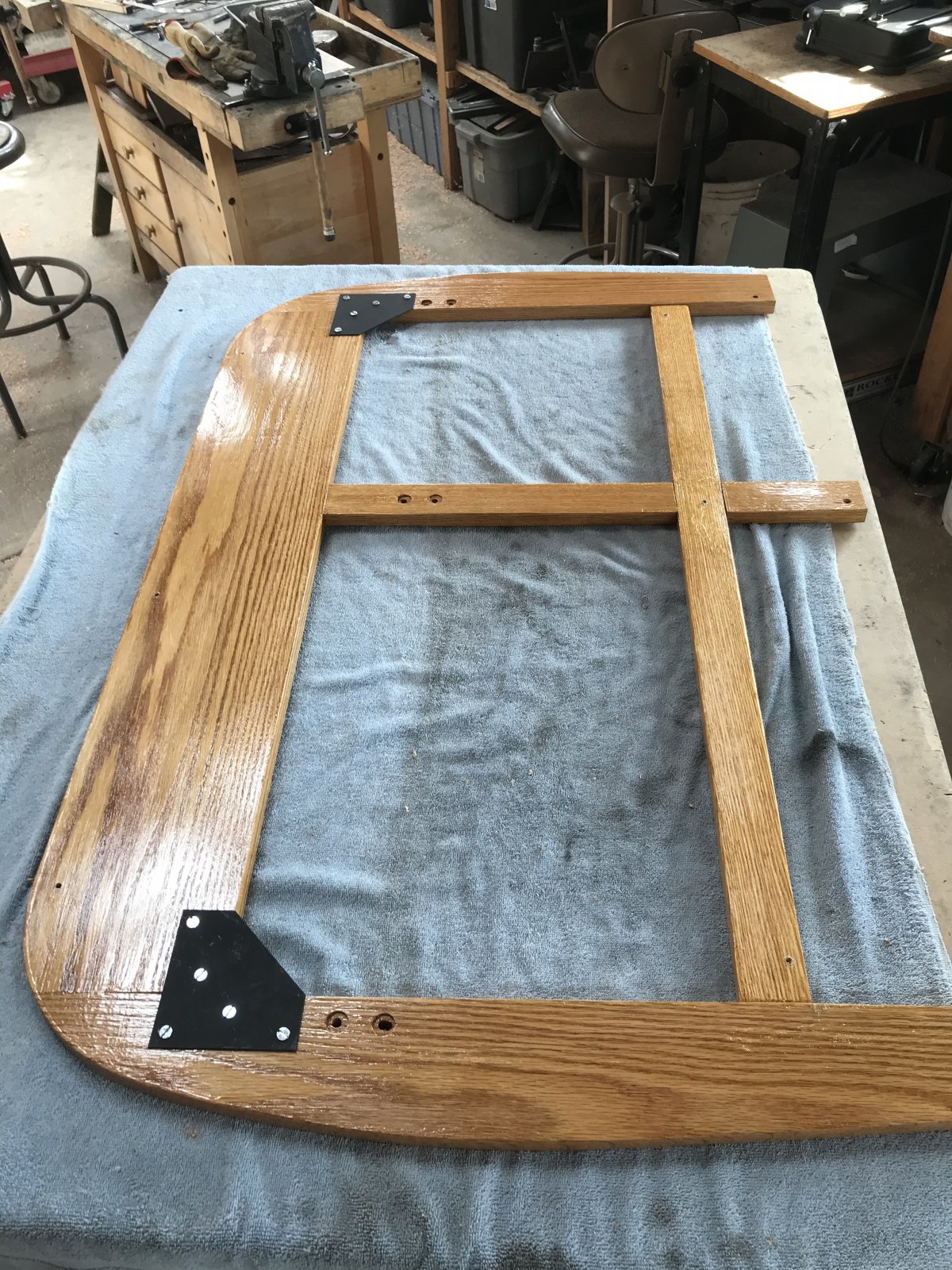

    Elvis100

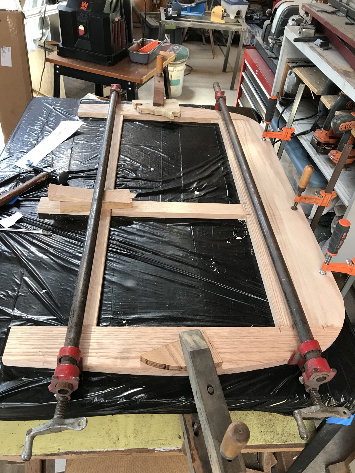

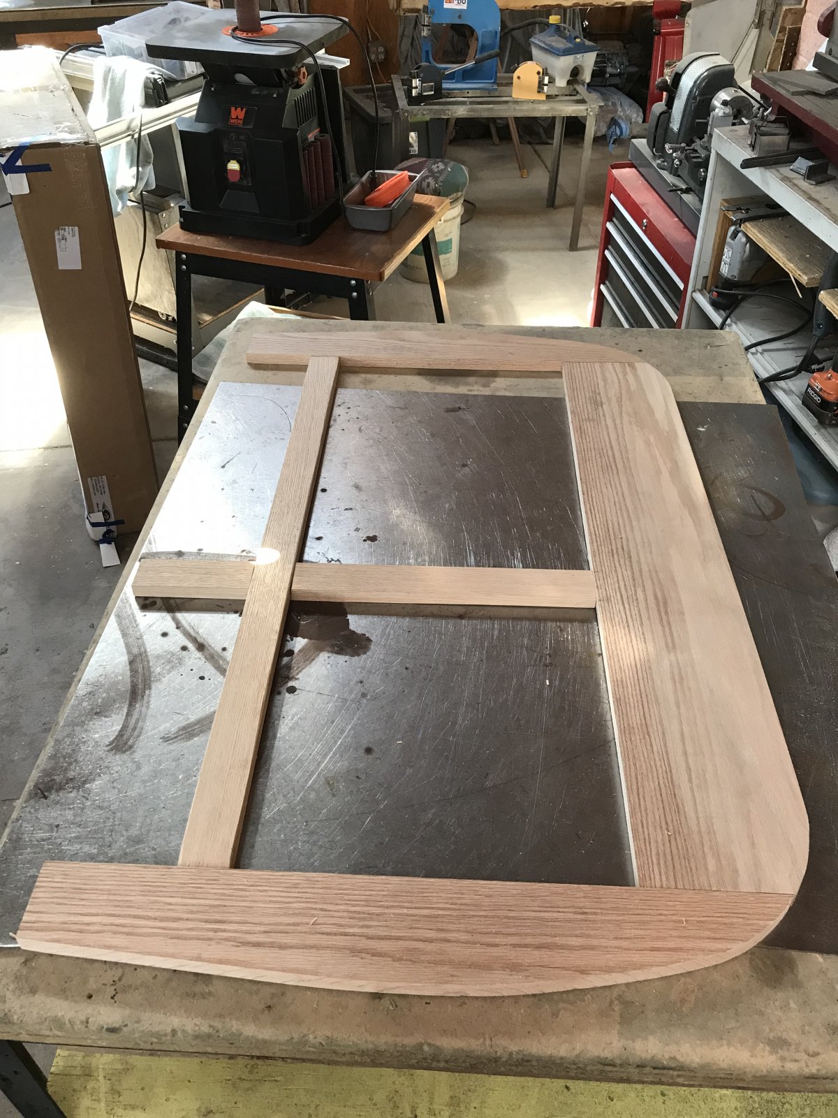

    Here is another side project that I just finished up. The rear and bottom wood for a passenger door for a friends car out in California
    el Roach, brEad, loudbang and 4 others like this.

    Working on some more door wood and heading out to Hershey PA today
