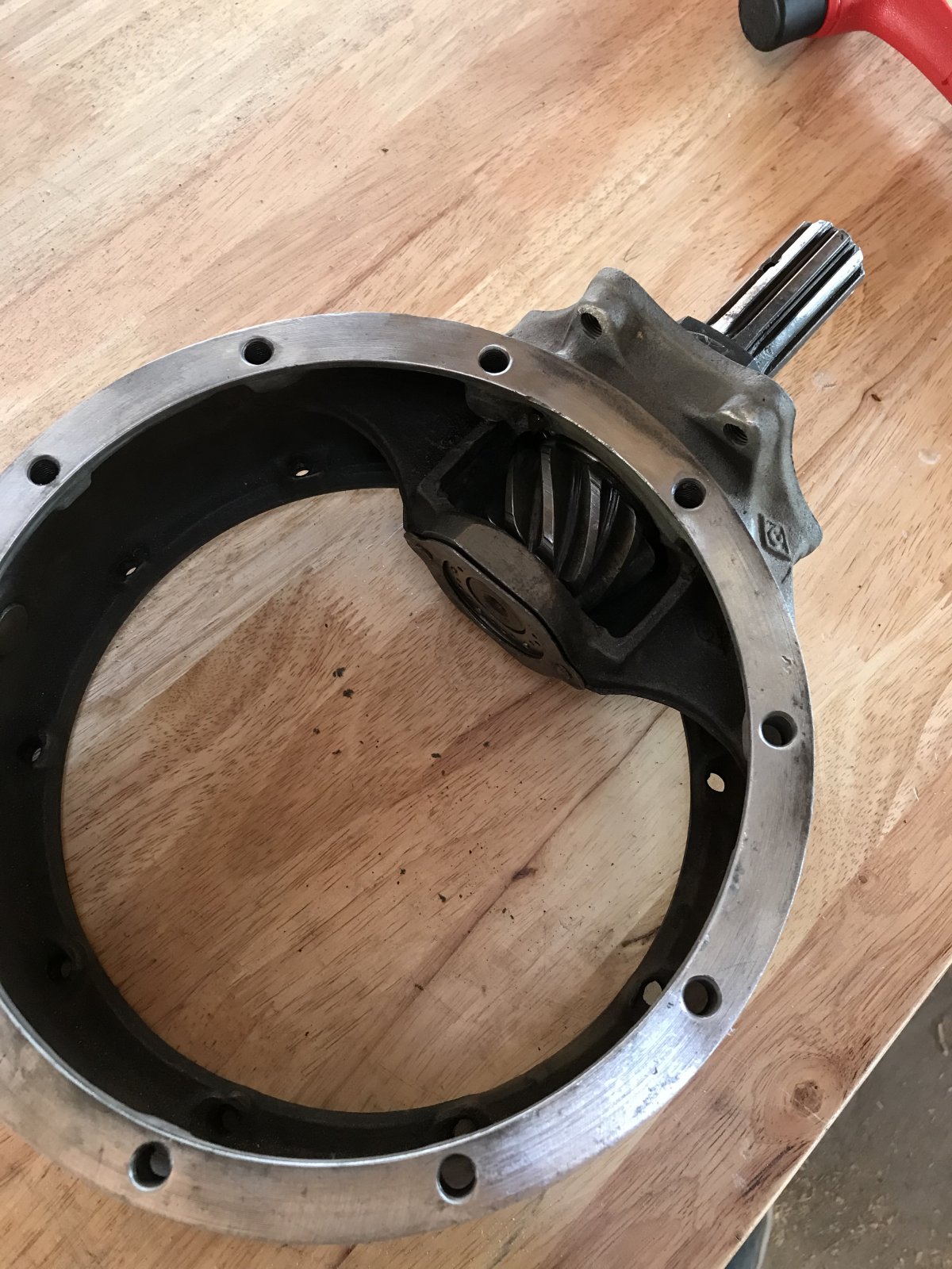

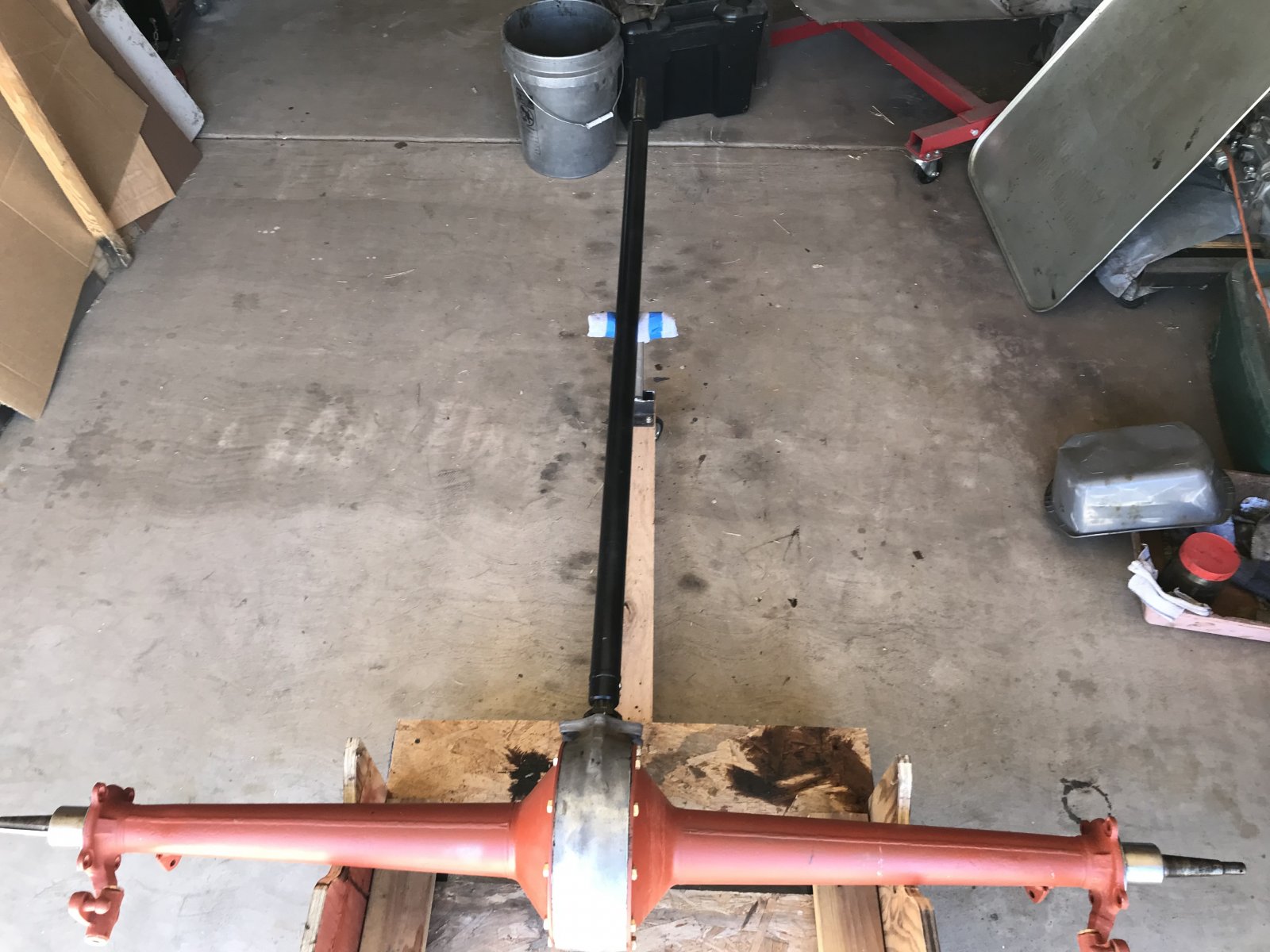

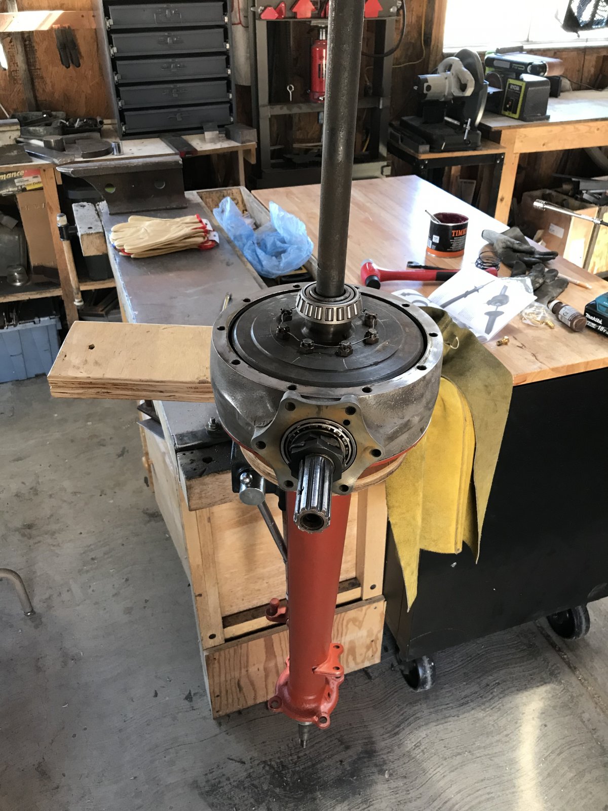

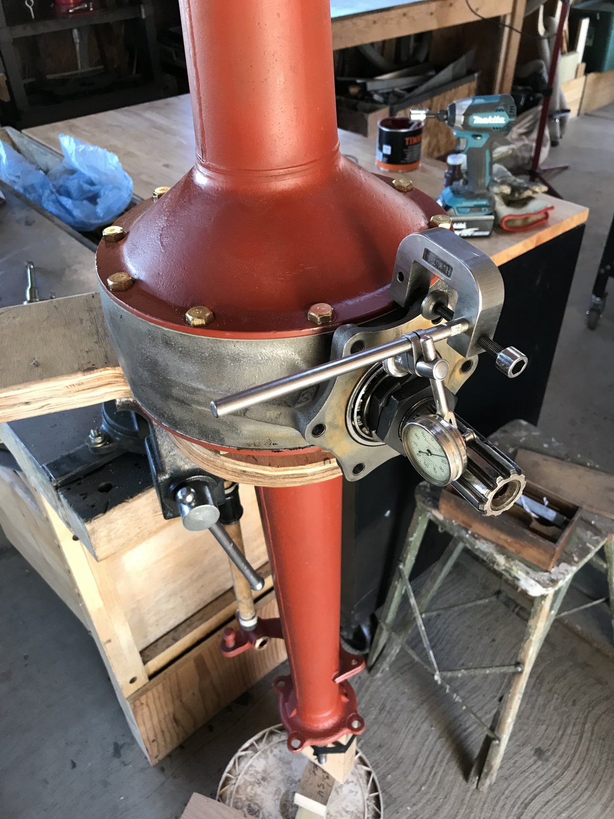

    Got back out in the shop today. Started by installing the pinion gear in the housing. Got the axles installed and the backlash set to .007

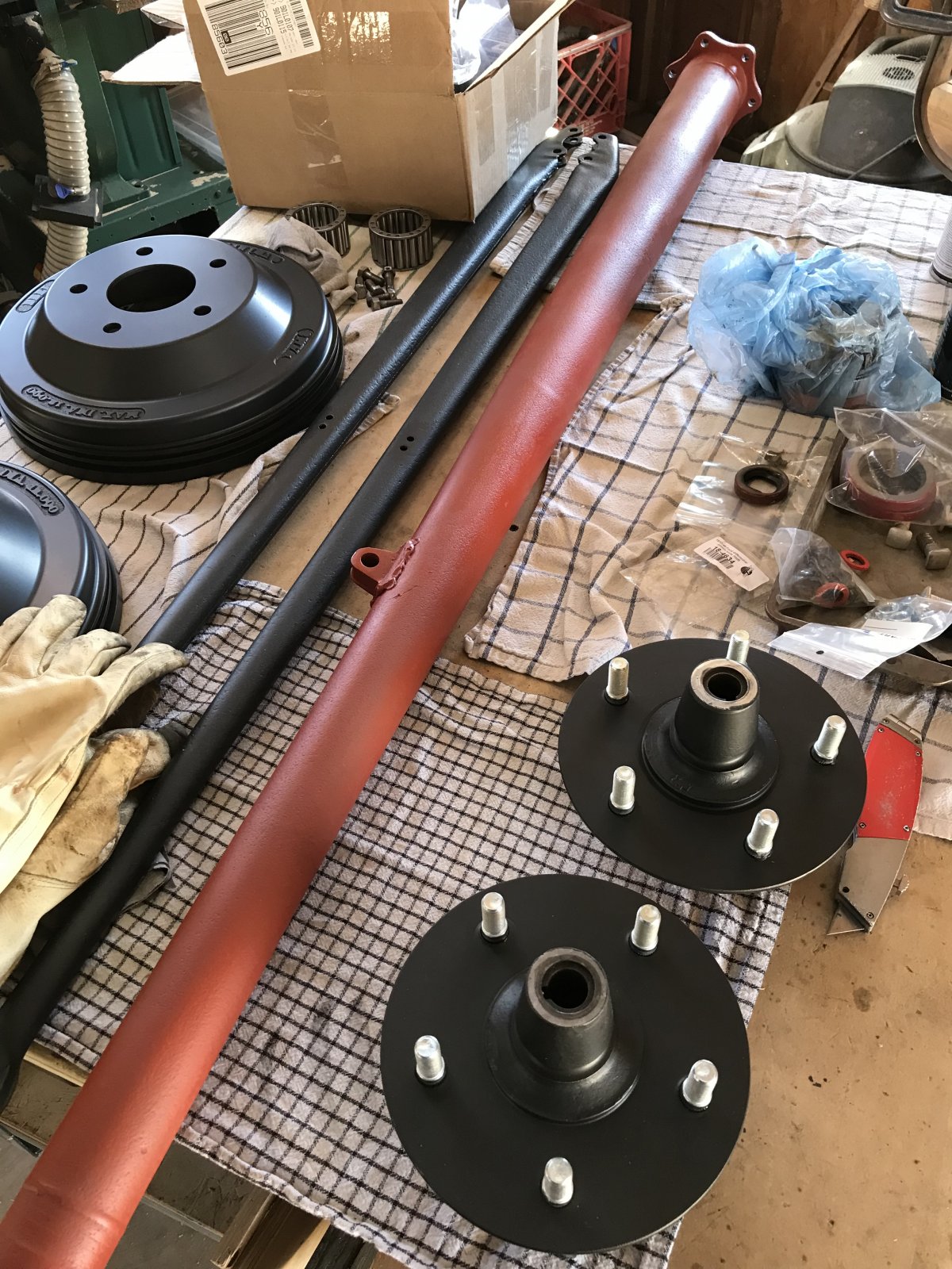

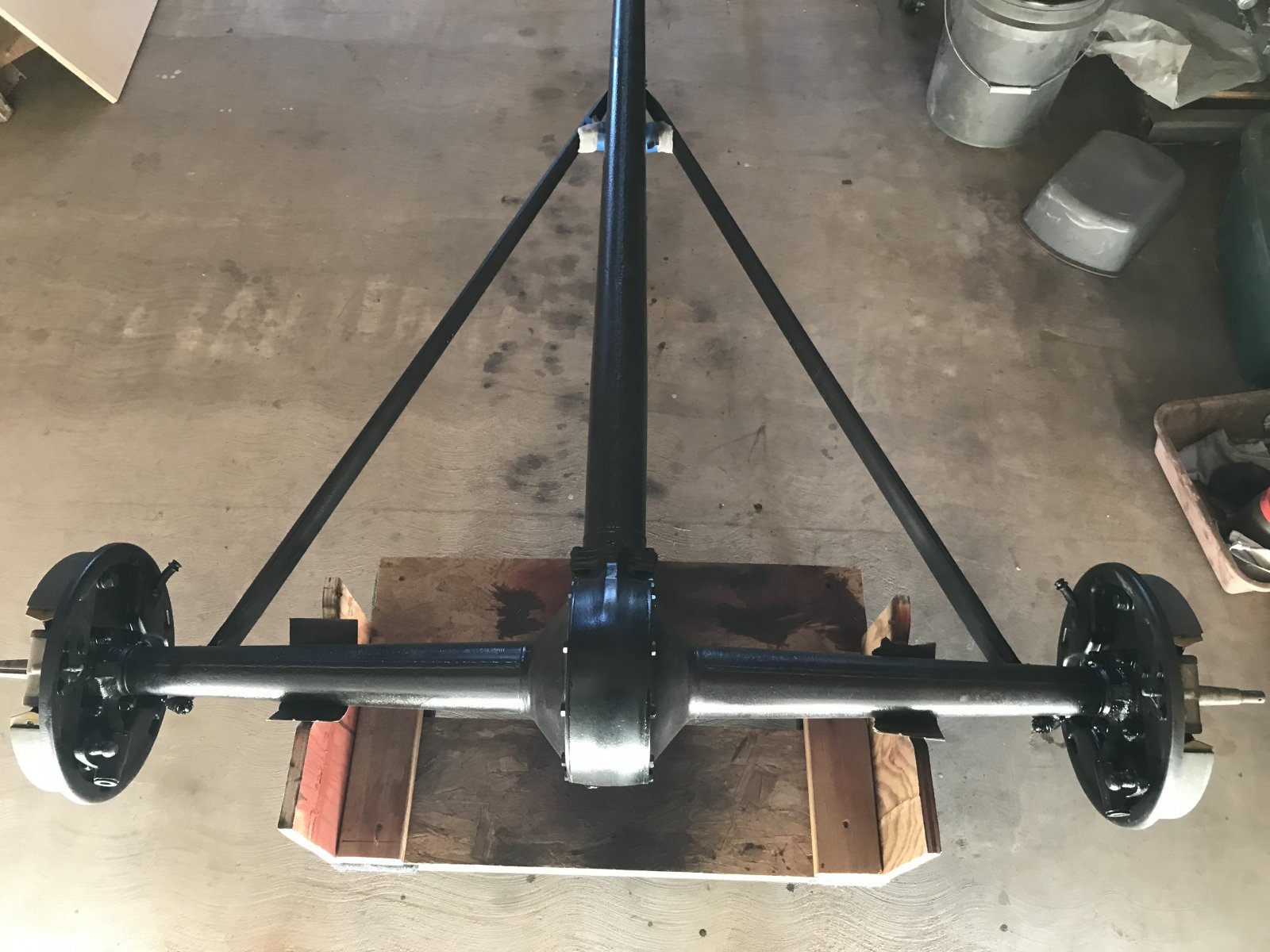

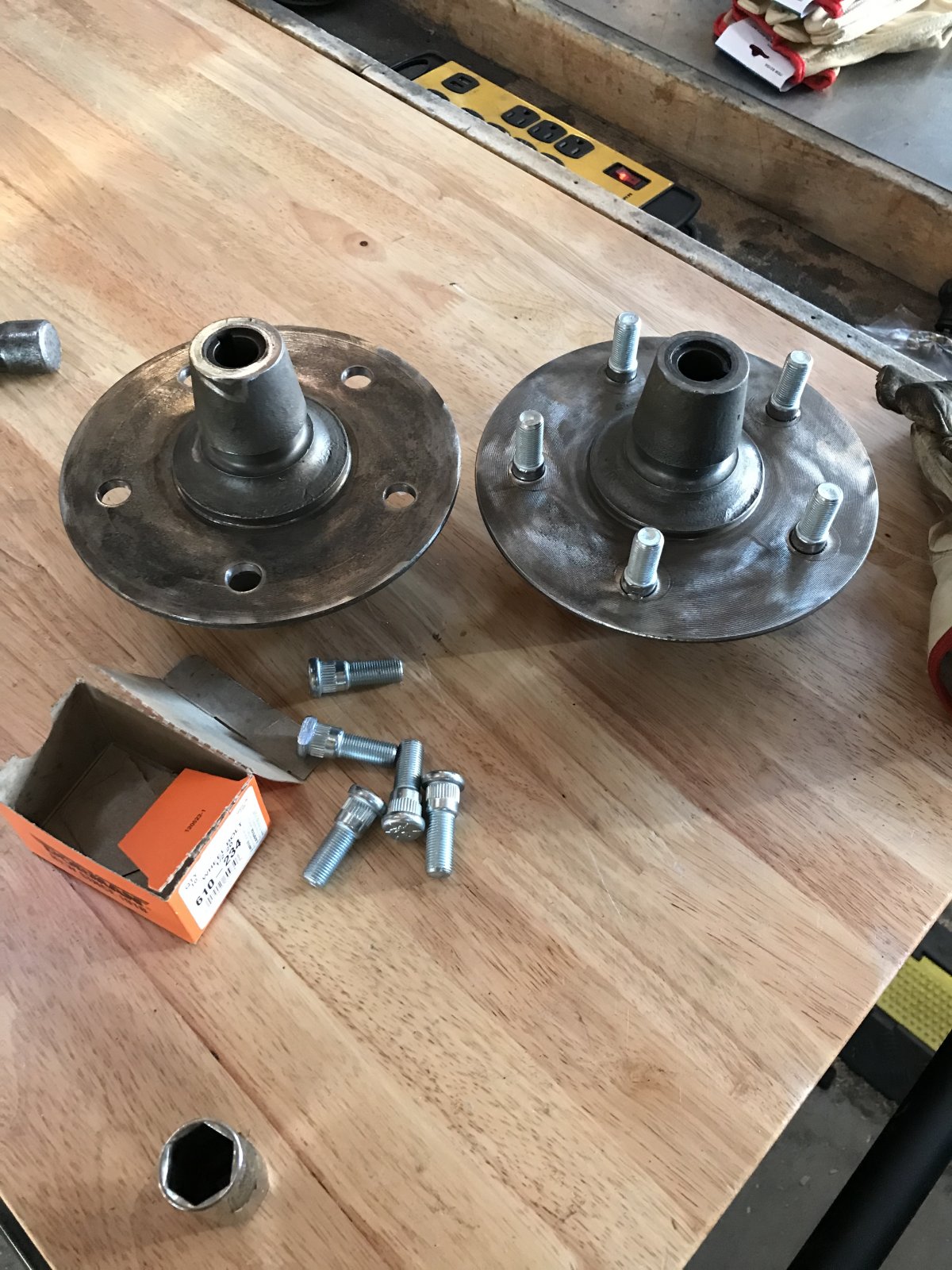

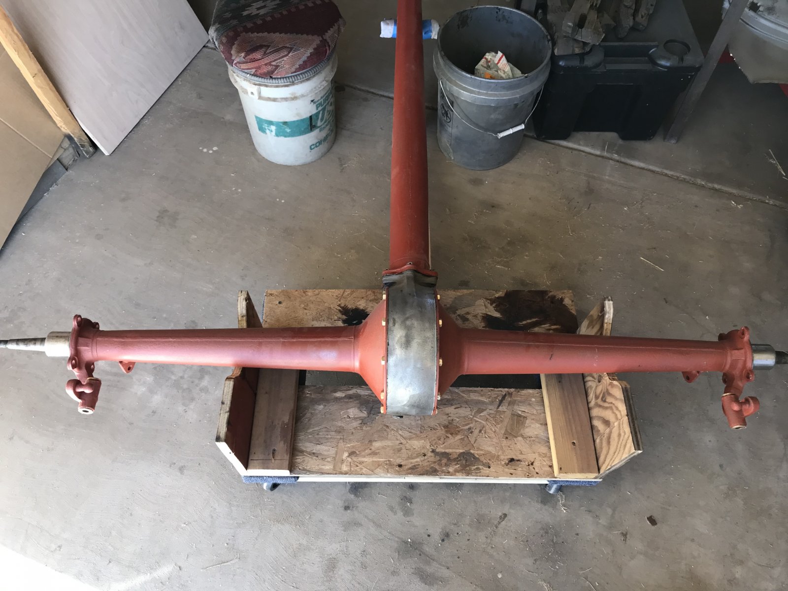

    More work on the rear end. Installed new studs, cleaned and painted with a polyurethane coating. Cleaned and painted the new drums. I’m using Steel-it coating

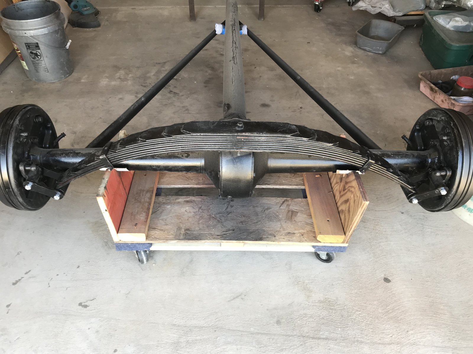

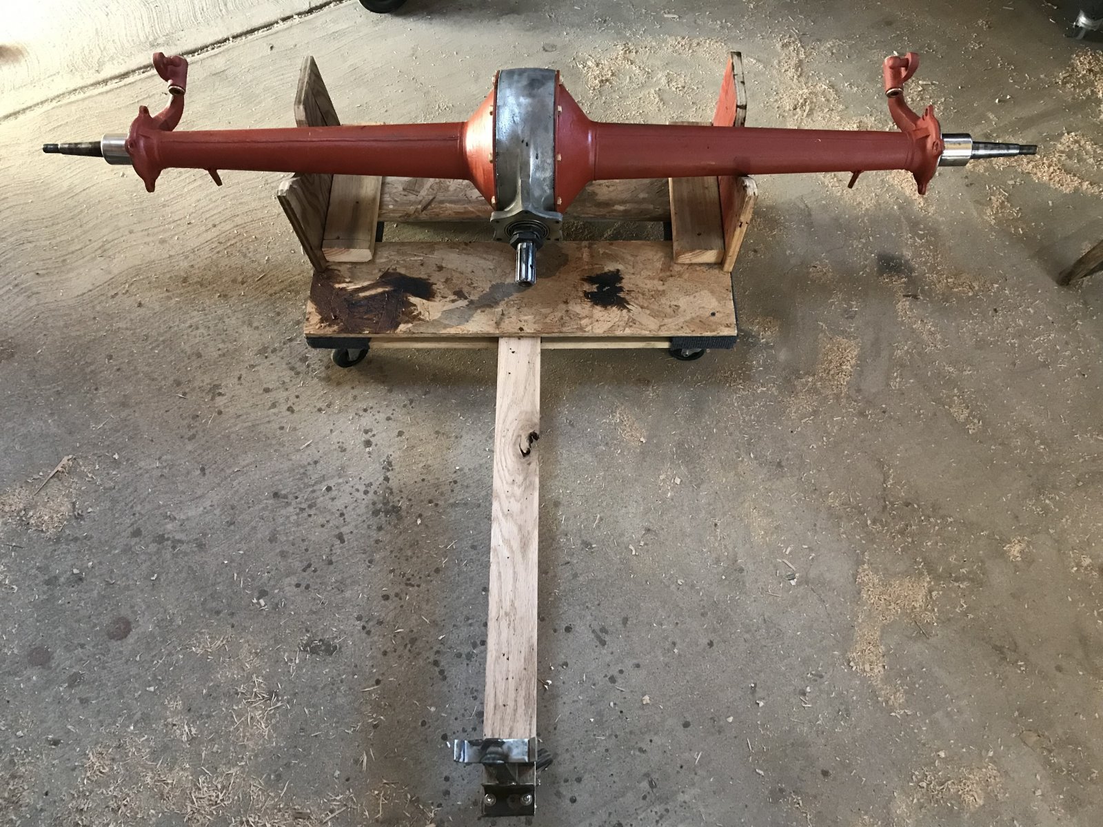

    Rear end back together

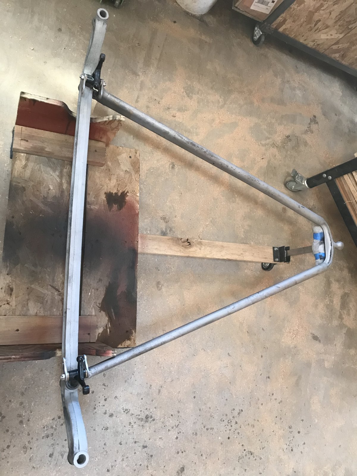

    Elvis100
    Got the left running board and left rear fender fit. Had to fill and re-drill a few holes. The reproduction running boards and reproduction frame rails didn’t play nice together. Got the right running board and fender offered up and I’m going to have the same issues.

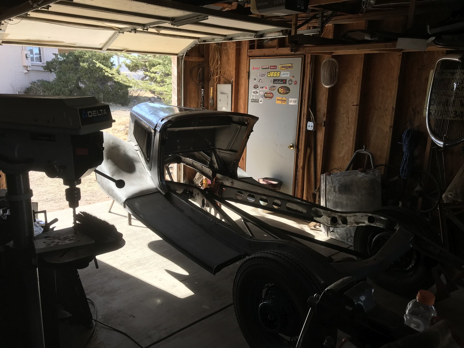

    Made a body dolly out of some old frame rails. Completely disassembled the body in preparation for the running gear test fitting

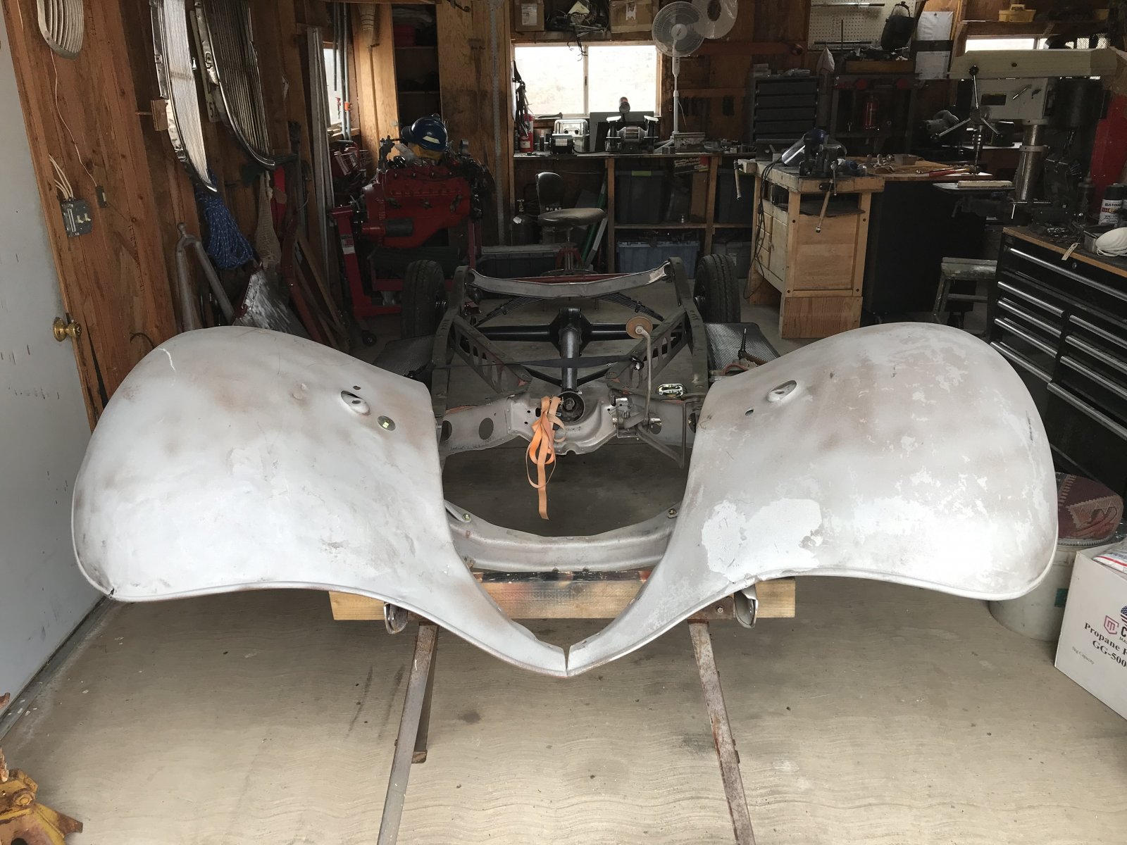

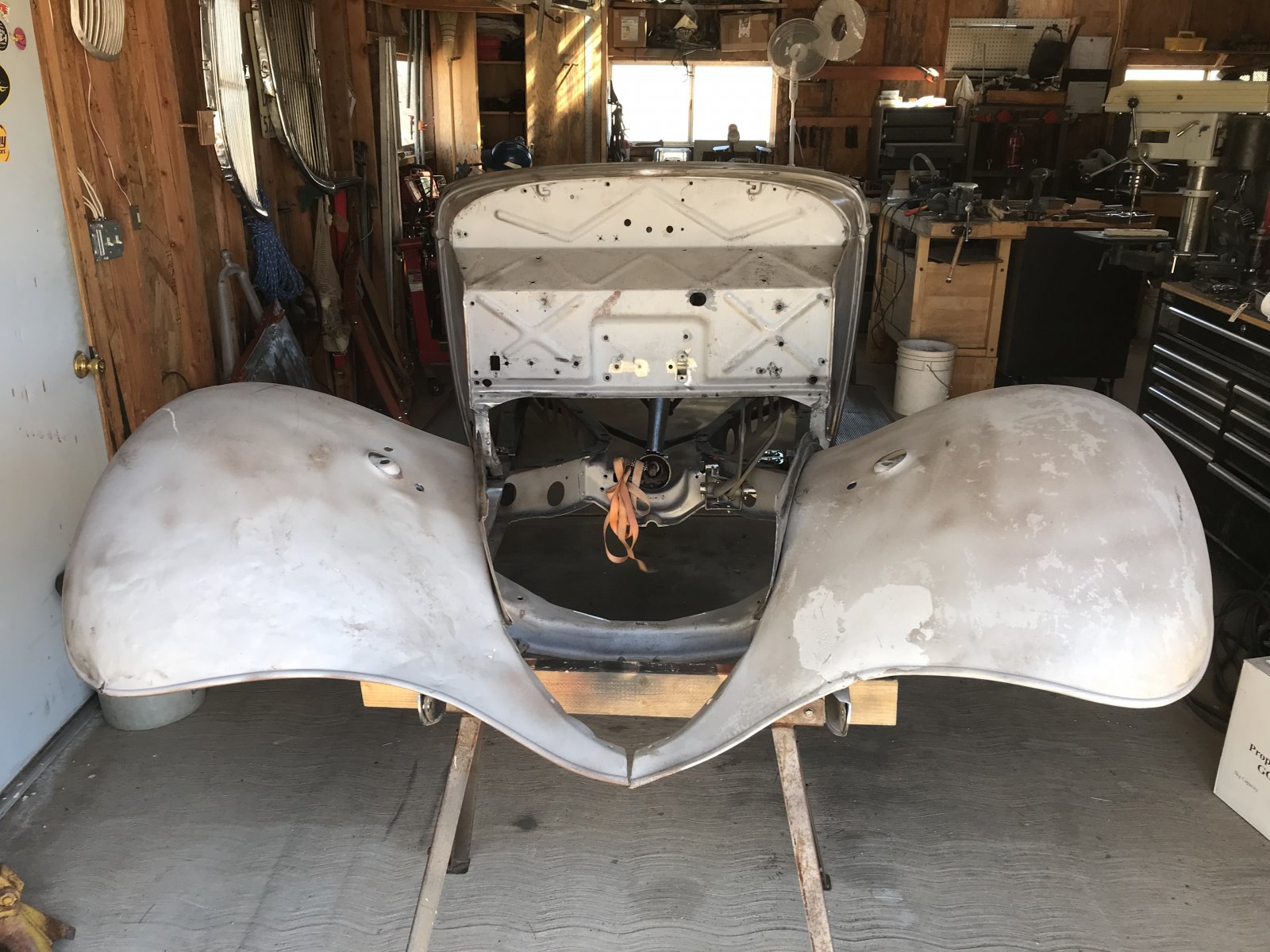

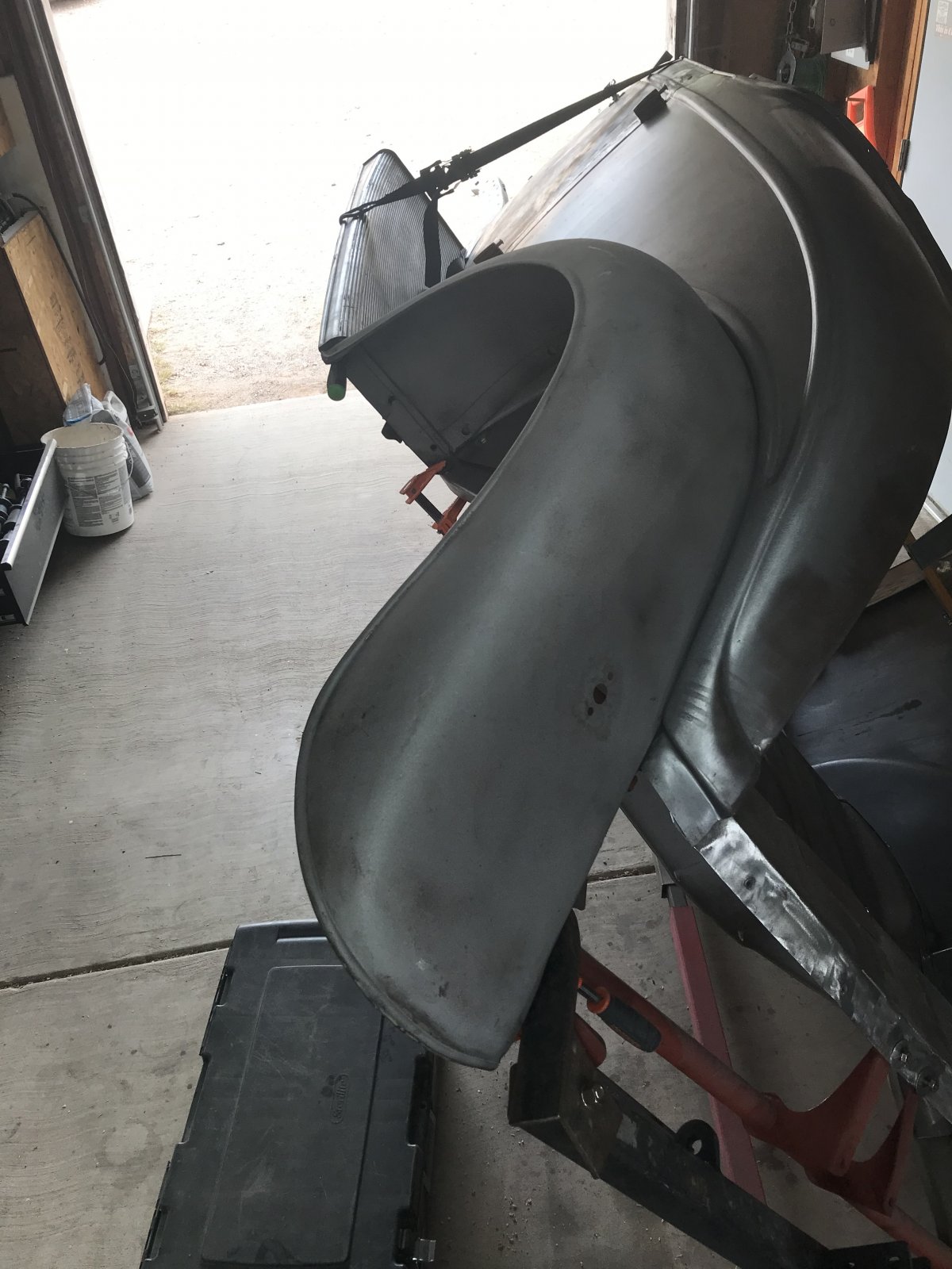

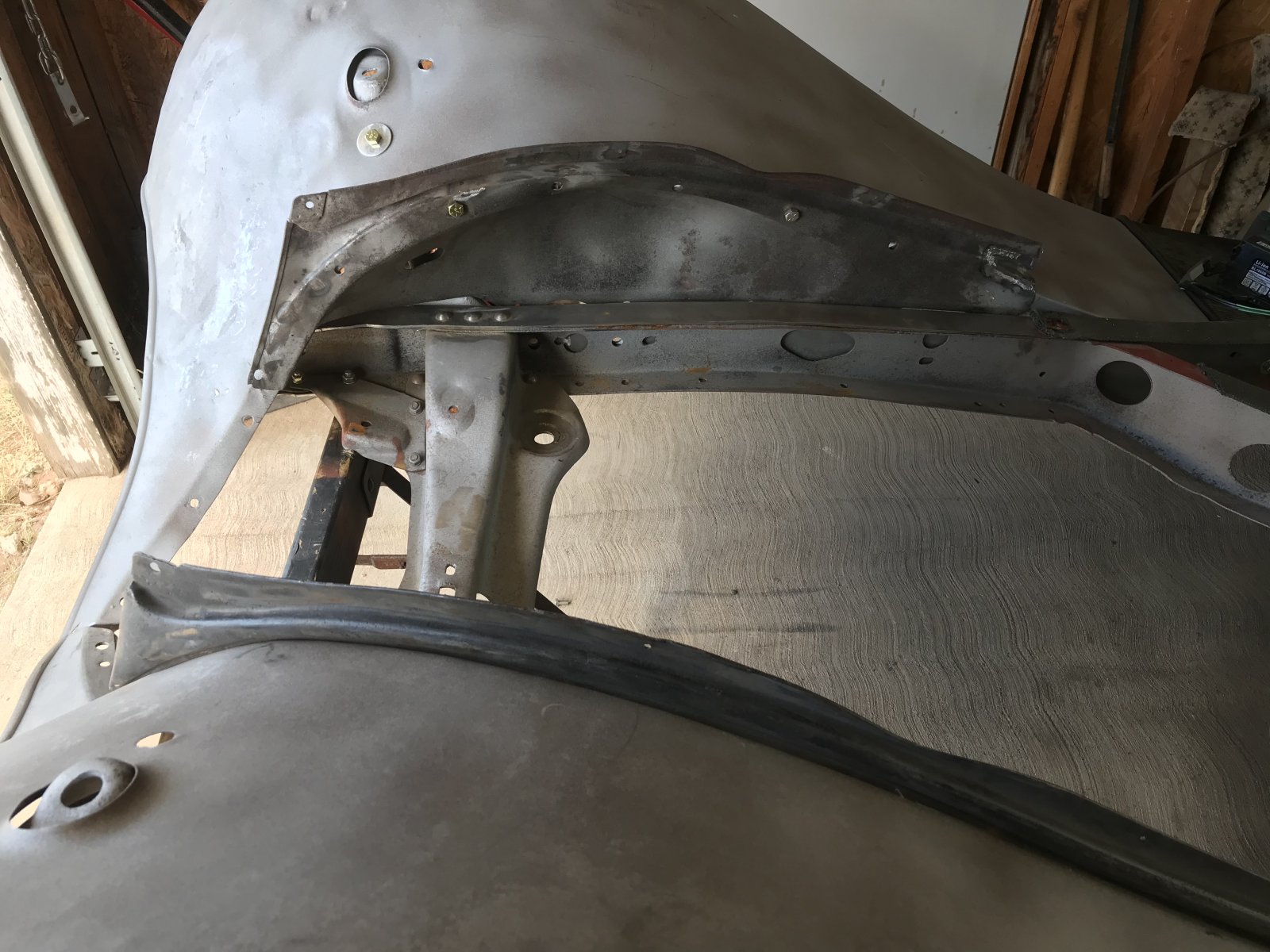

    Worked on fitting the front fenders, they need a lot of work, but they are original and I can do most of the body work on them later

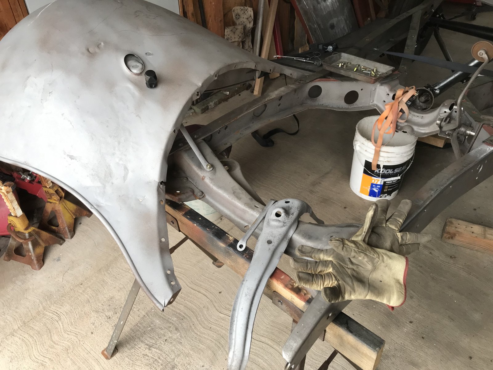

    More work on mocking up the front end sheetmetal. Wish I had some better inner fenders.

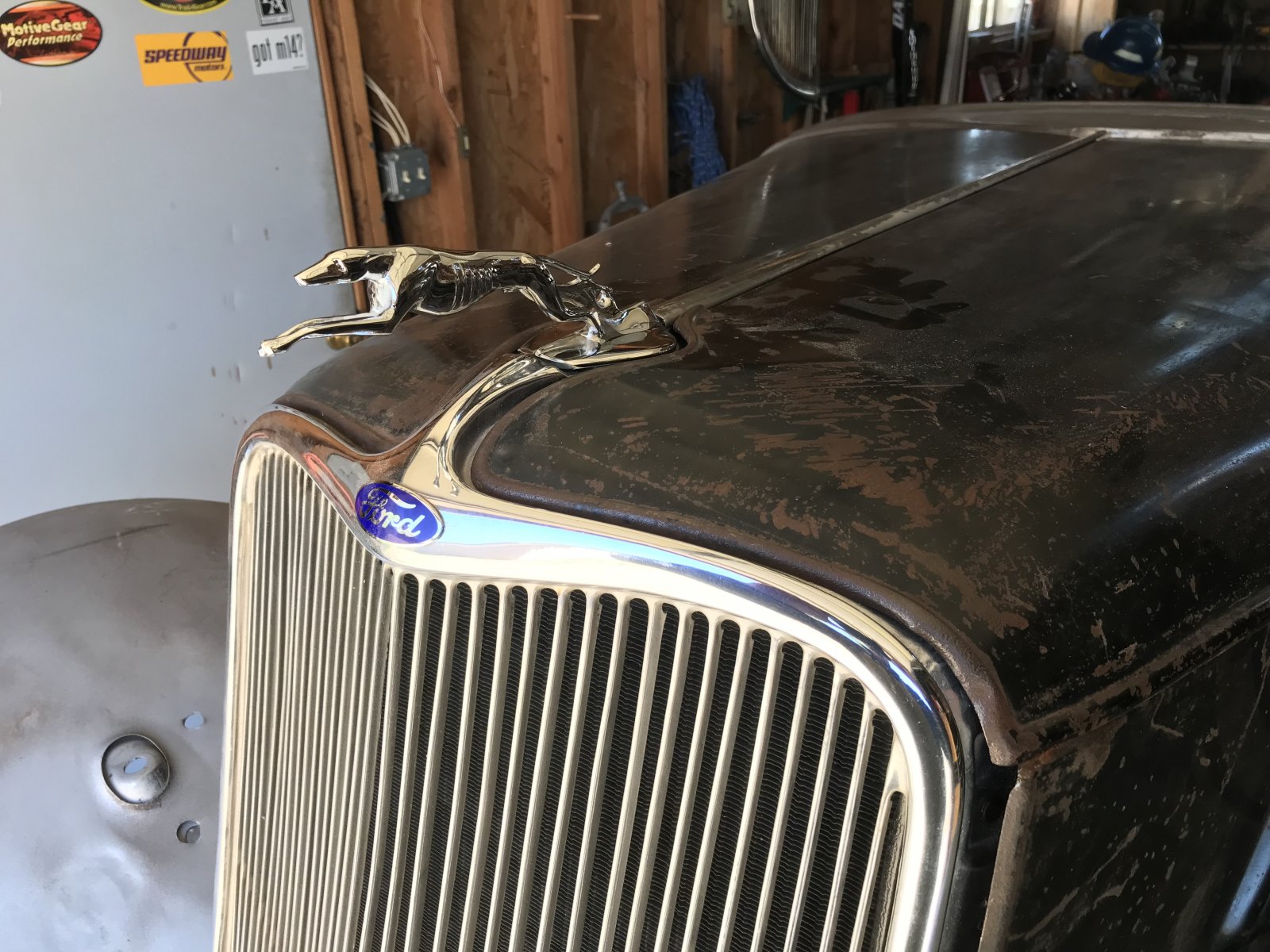

    Got the grill shell fully attached to the radiator and had to put on some jewelry. Next I’ll get the inner fenders lined up and bolted. The the right looks good and the left needs to come up in the back about 1/2 inch

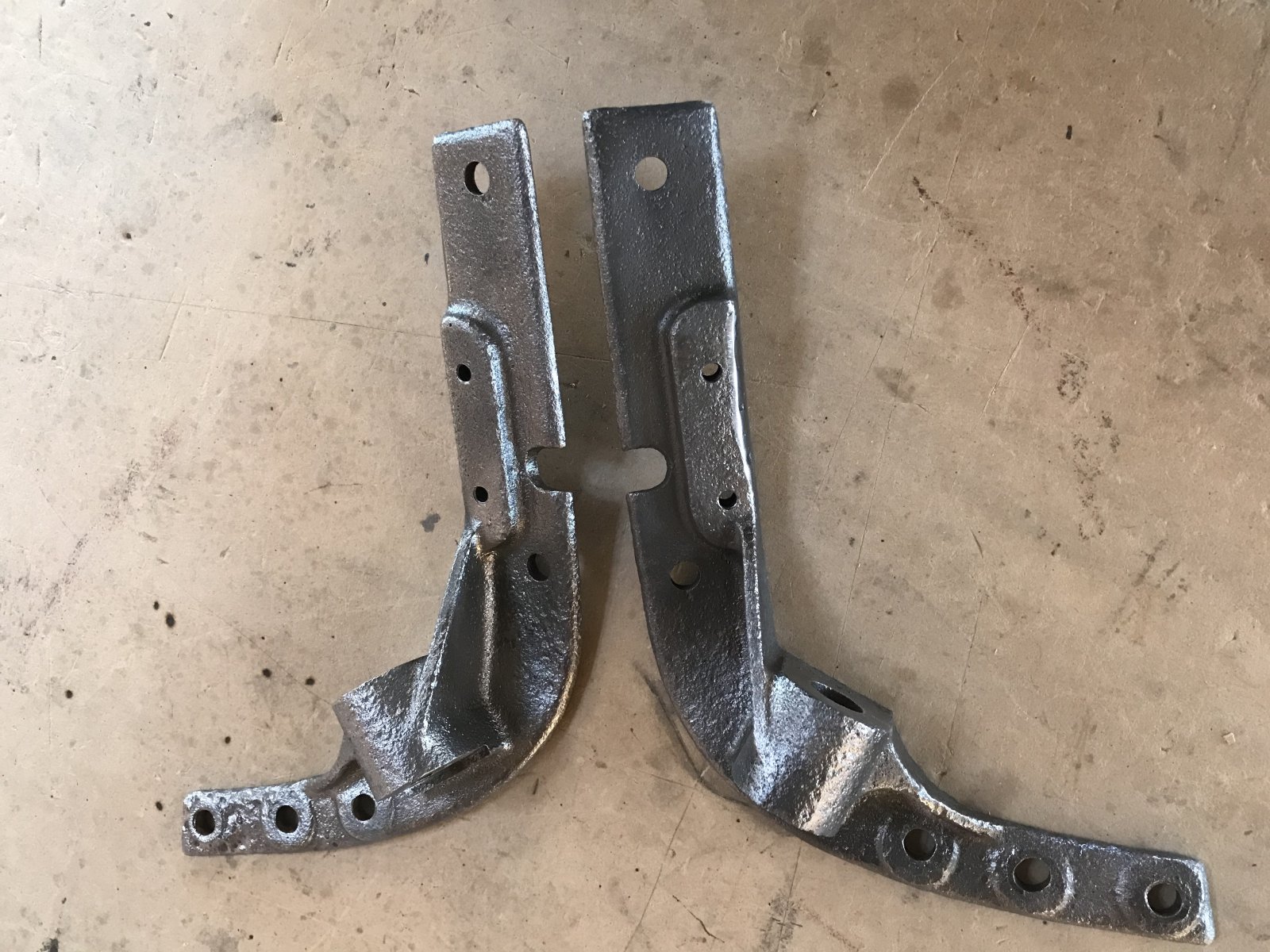

    Got these A-pillar castings on instagram. Cleaned them up in Evaporust for three days and gave them a coat of Steel-it. They are nicer than the ones I have for the 33.

    Finished mounting the front inner fenders and started mocking up the front end. I’d like to say the rearend cart was designed with multi uses in mind, but it was just a happy coincidence.

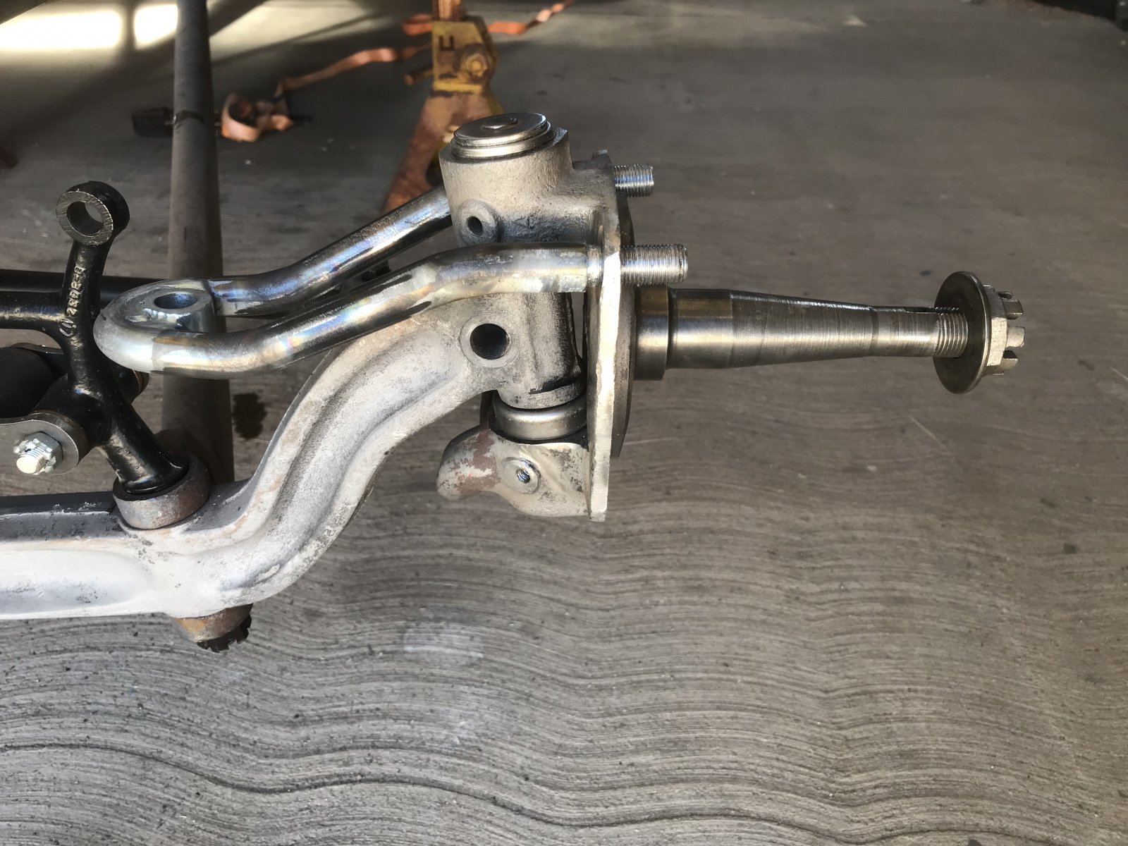

    Dropped the steering arm and spindles. Installed the front shocks

    Looks like later shocks you are using, no? did the bolt holes match up?
  23. Elvis100
    Joined: May 21, 2016
    Posts: 677
    Elvis100
    Yes, bolted right up. I believe they are later replacement shocks made for 33/34. The body looks like a 40 ford, but the arm is dimensionally 33/34.

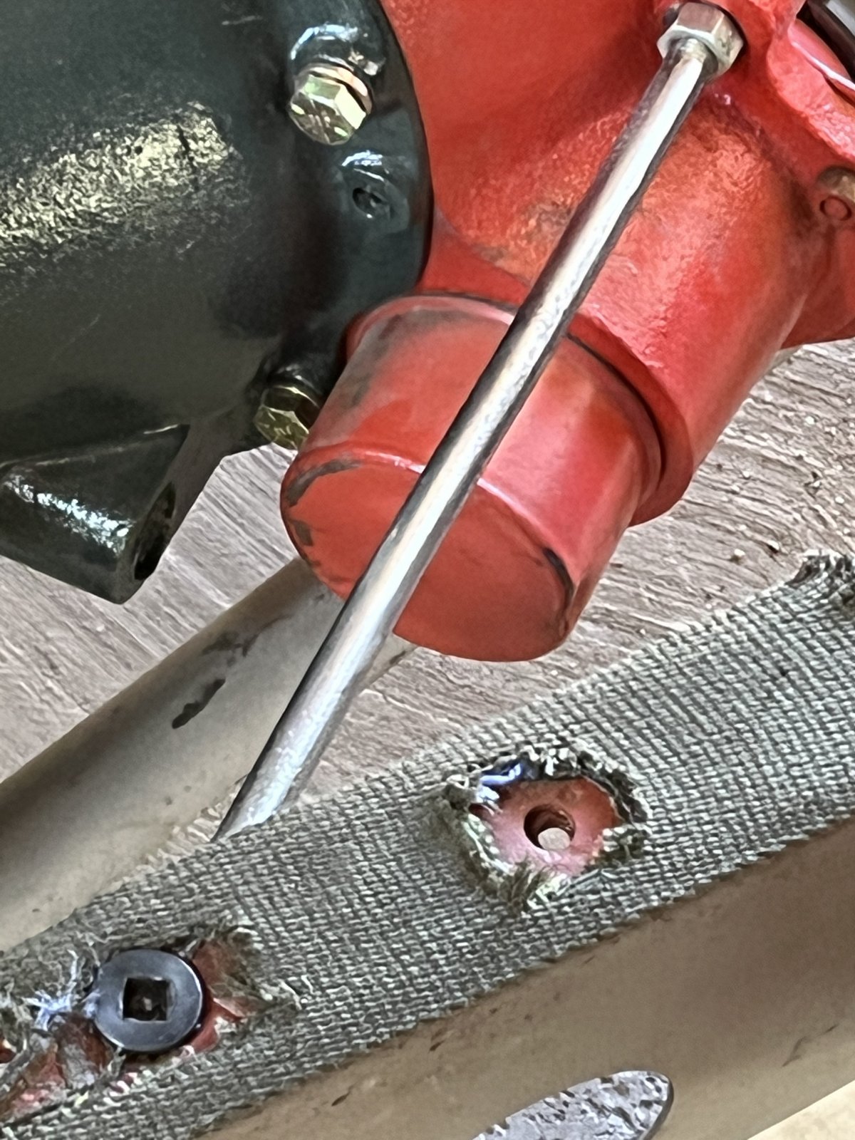

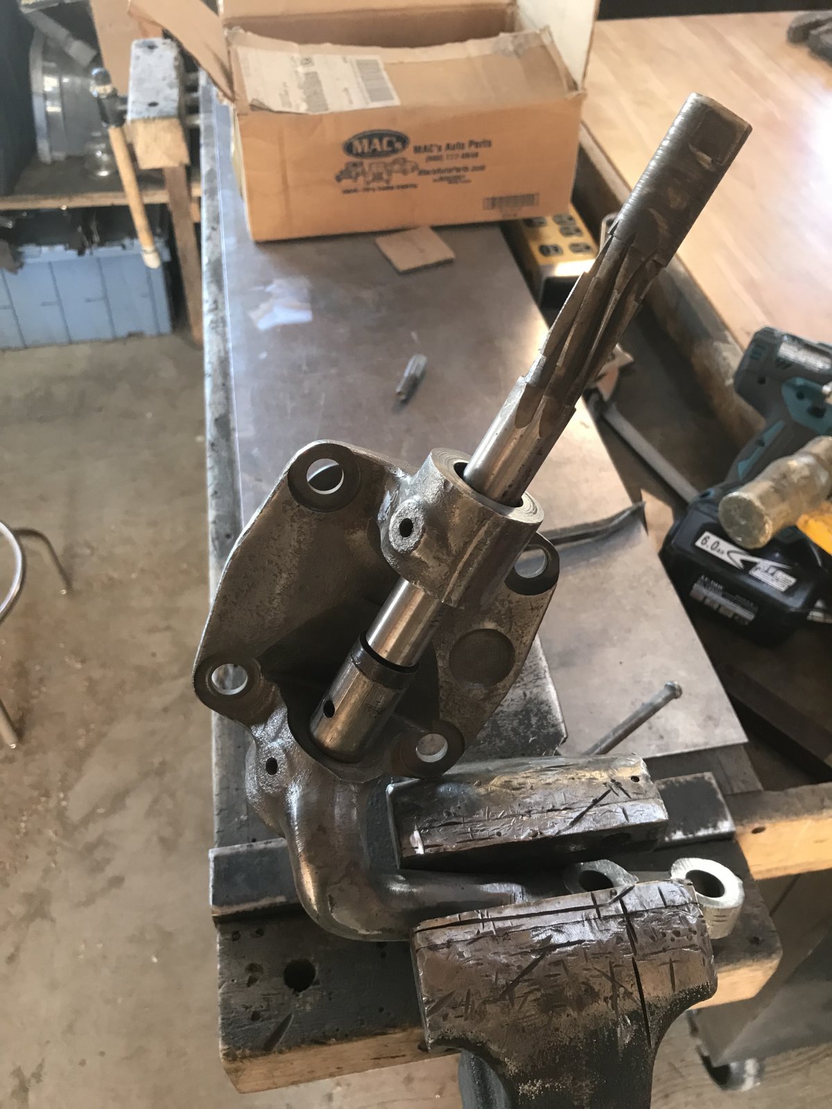

    Update on the pedal conversion:-( . Unfortunately this modification looks elegant, but does not work. When depressing the clutch there is too much force exerted on the shaft that is also integral to the brake pedal. Result is not ideal. I have some other ideas. More to follow

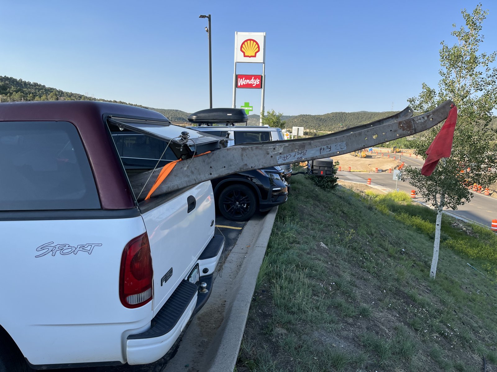

    Two day round trip to Trinidad Colorado to pick up a frame for the 33 off Craig’s list
