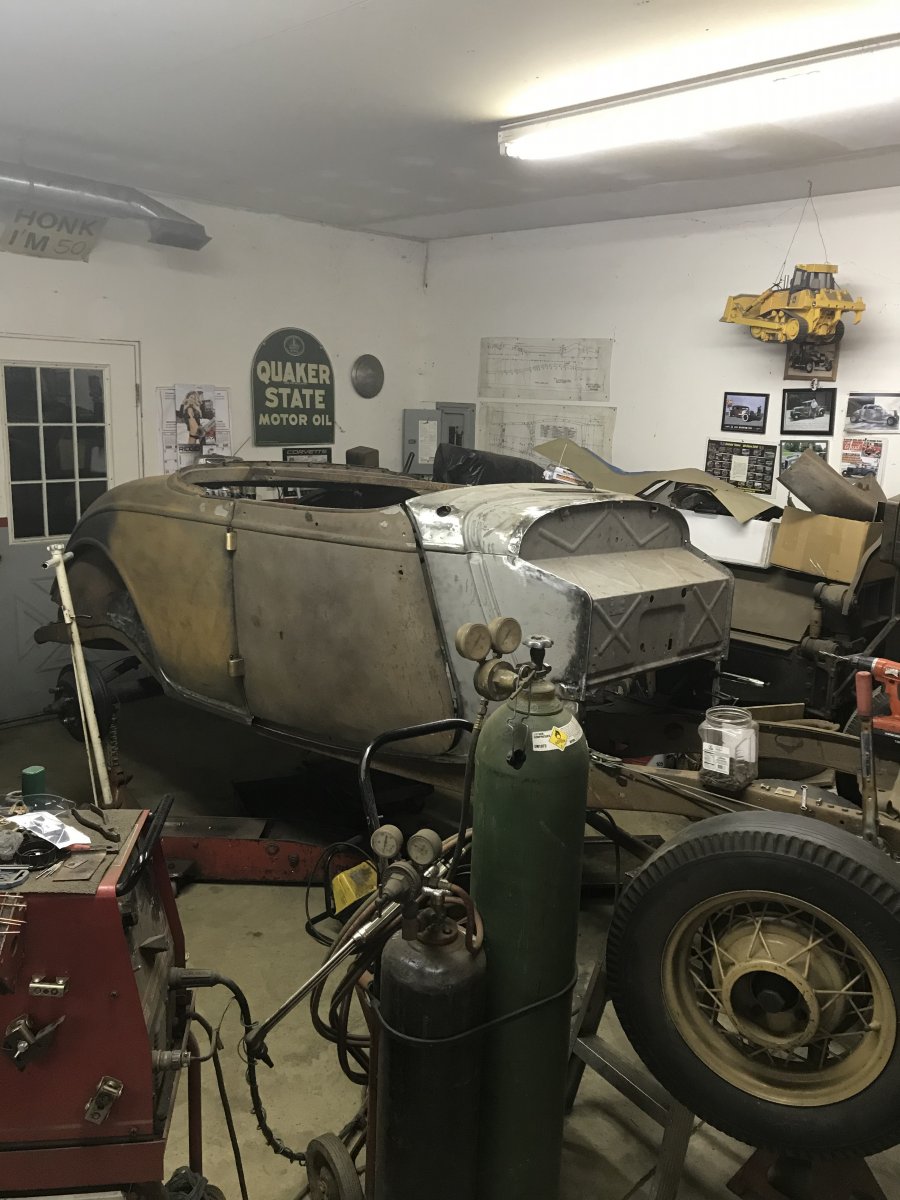

    Got the wooden structure screwed together and the hinges installed.

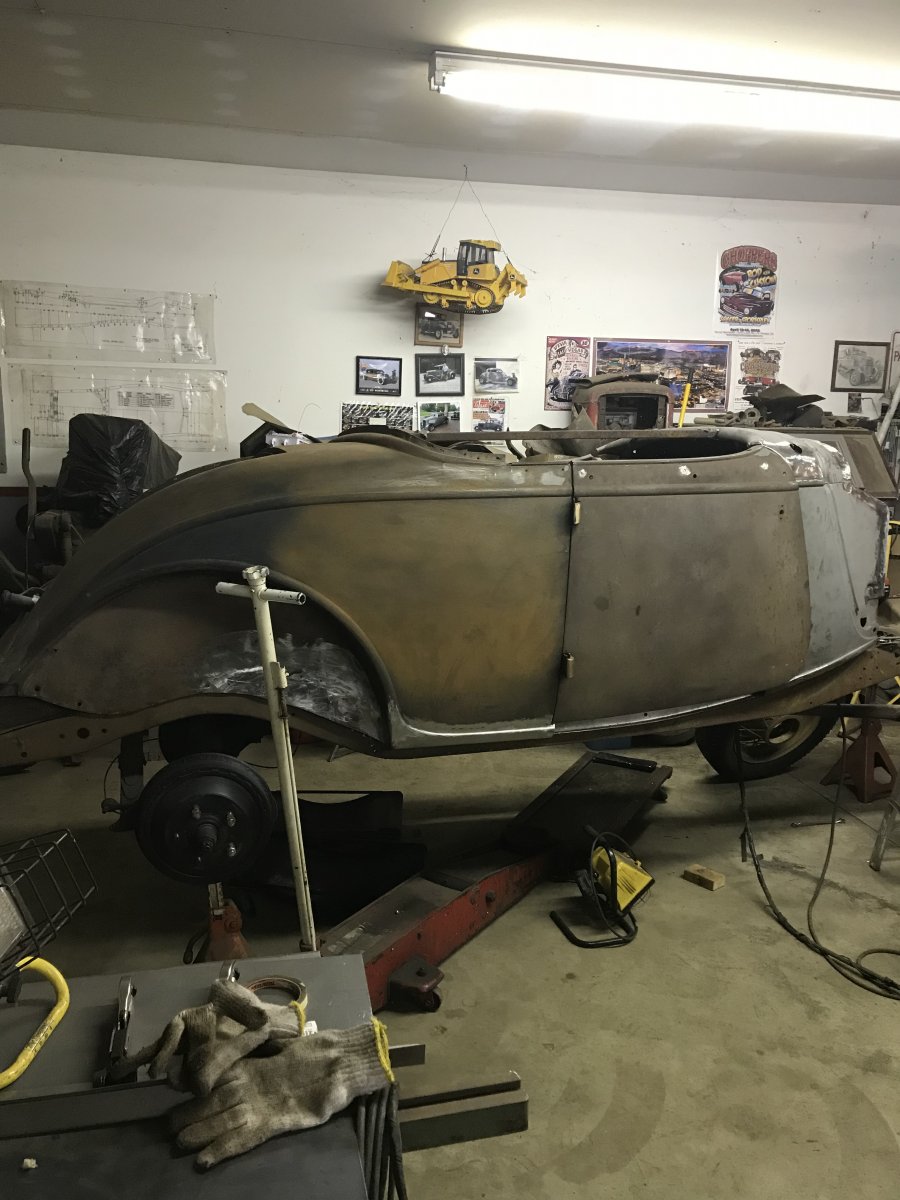

    The wooden part of all the doors is officially done. Two coats of linseed oil and they are reinstalled in the doors. These will go on the shelf until I get them swinging....then do the body work, I’m thinking about trying leading.

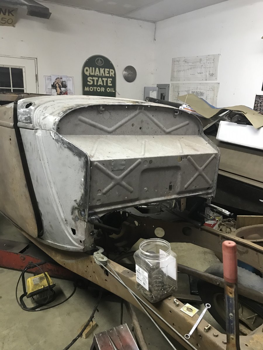

    I got back on the roadster the last couple days. Made the b-pillar wood and made an extra set for a fellow H.A.M.B’er. [​IMG][​IMG]

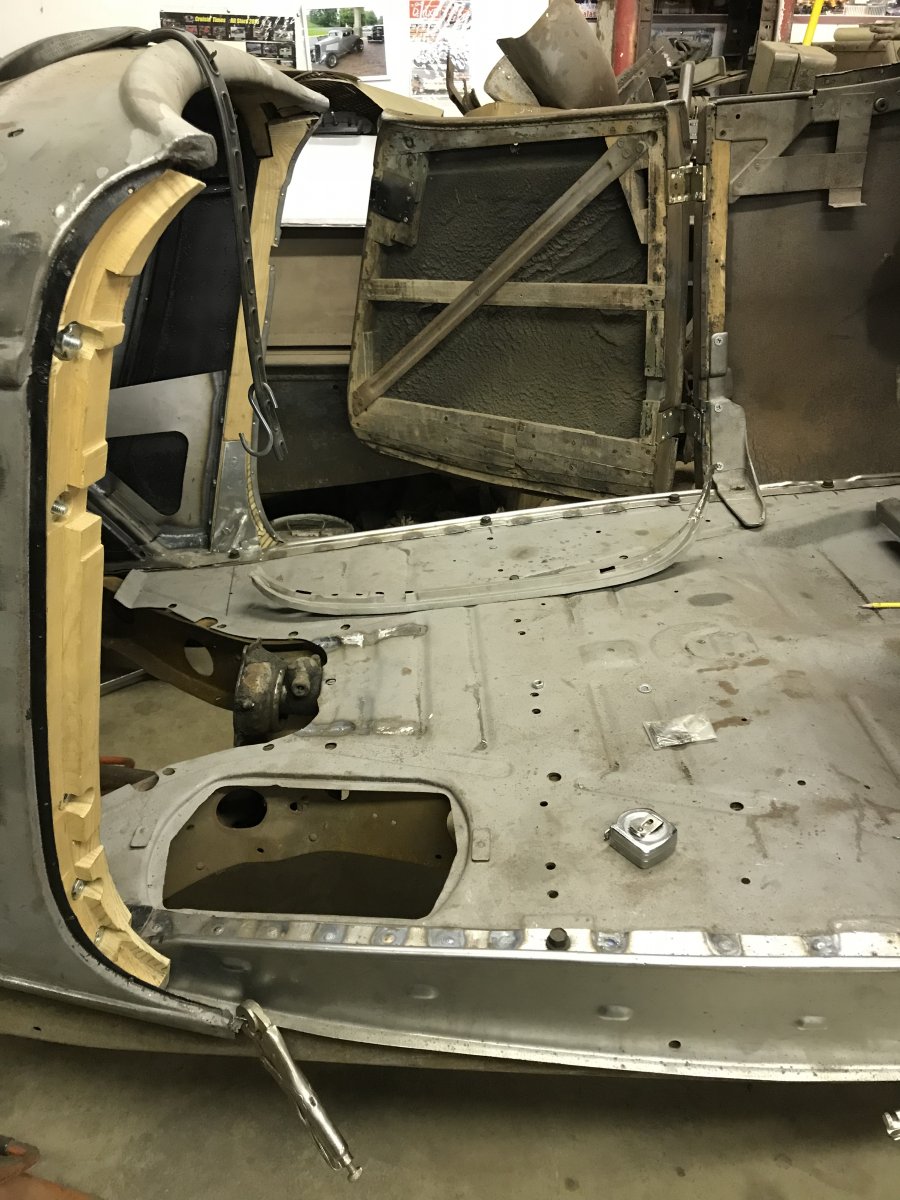

    For some reason I can’t find this style 5/16-24 t-nuts. I have enough original ones for the project. I had some left over from my 3-window.[​IMG][​IMG]
    I was able to get an original set of b-pillar castings from a friend in California. These things are cast from unobtainium, so I was very surprised to get an original set.[​IMG]
