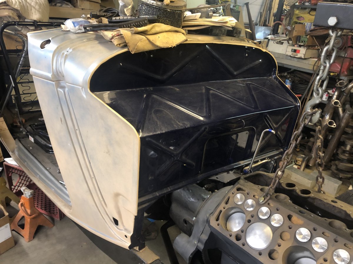

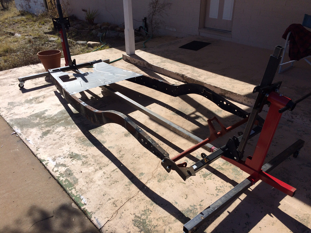

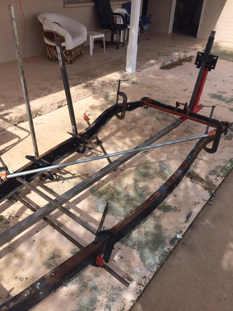

    Changed gears a little today. Built a body rotisserie for both the roadster and the coupe. Still have to strengthen it with some diagonal braces and an X in the frame
    I used 2 harbor freight engine stands and some 2X2, 1.5X1.5.
    brEad, Stogy, chryslerfan55 and 2 others like this.
  7. Elvis100
    Joined: May 21, 2016
    Posts: 677
    Elvis100

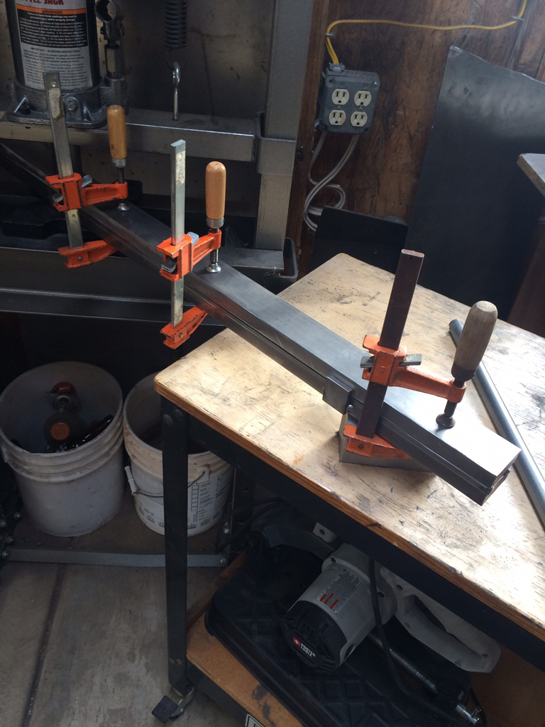

    Spent some time trueing the rails and squaring the fixture. The rails deviated a full inch minus and almost an inch plus. I used square tubing clamped to the outside of the rail and a little leverage. Once I got it all straightened out it was only 1/8 out of square. I’m going to add at least one more cross bracing.

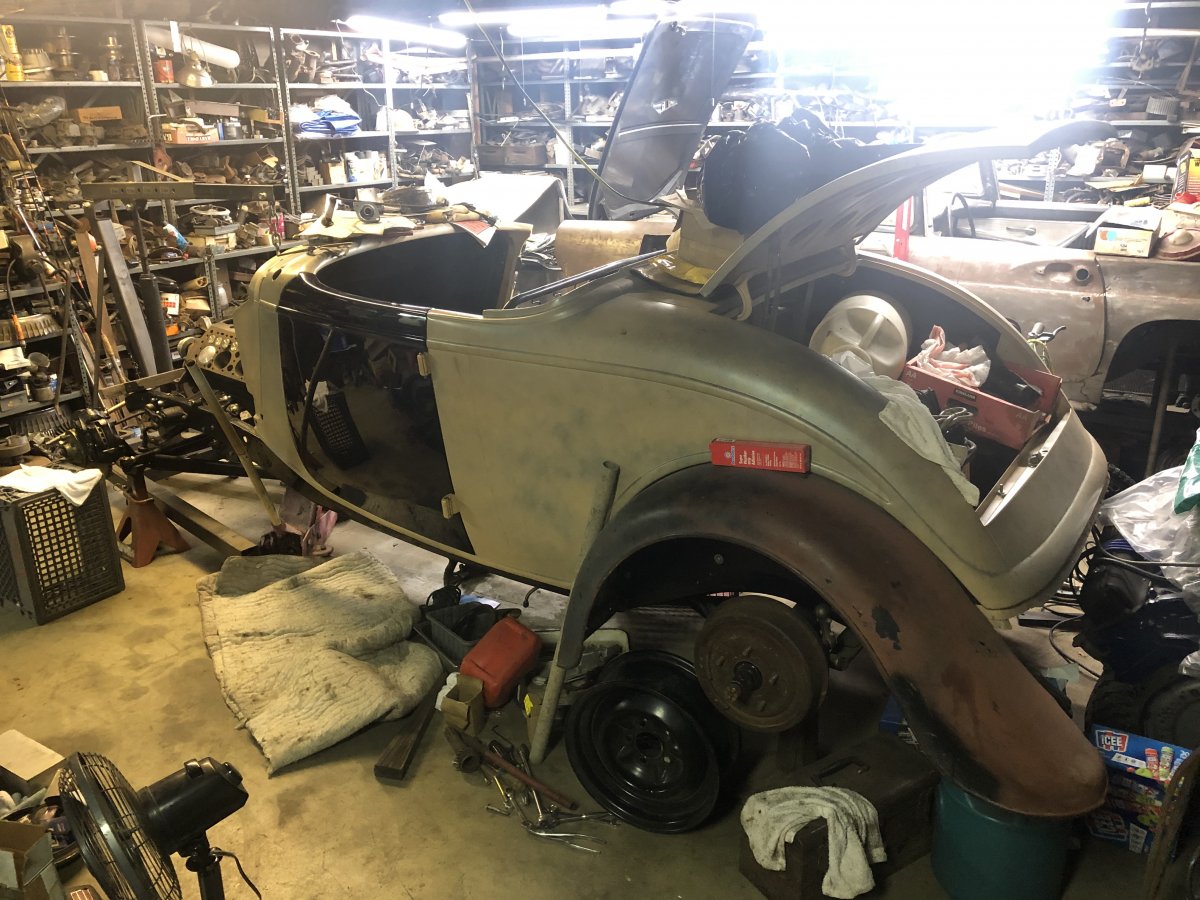

    This is my buddy George’s 34, he’s owned since 49.
    It’s been apart for a long while, but he’s working in it, I go over and lend a hand when he needs me. He’s had some pretty impressive 34’s in his time. Elvis, your work on this project and thread is awesome and inspiring. “THANK YOU” for posting the progress pix as it comes along. Are you doing a coupe as well? 62072A63-6481-4170-88F3-DA5E7479825D.jpeg 34FF0963-2524-4A59-90B3-9CC46B60F541.jpeg 0C314E14-8689-4B87-B8D7-D620ADBB9712.jpeg AA5AF199-07D3-4FFB-9A97-A40AE3636BB2.jpeg 9512D313-2BE1-4218-A995-BDA656E14F18.jpeg 3850A337-698A-4561-A8F5-E0DE81F94773.jpeg

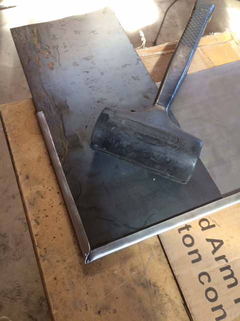

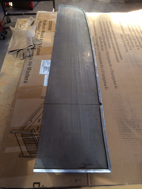

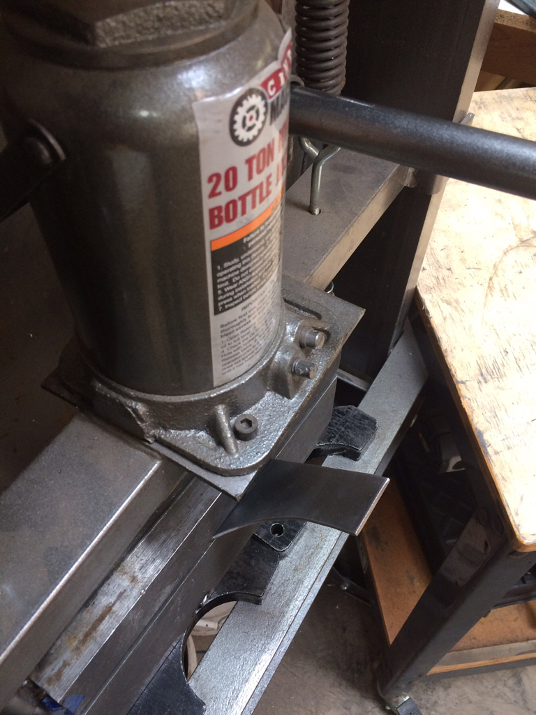

    The original die I used to make the door braces was only 4.5 inches long and left marks every 4.5 inches. I wasn’t 100% satisfied with the result. I made a die to press the entire length of the groove. My mild OCD is satisfied

  12. Were those cabinet clamps strong enough to draw the metal into the die?
  13. Elvis100
    Posts: 677
    Elvis100
    No, I just used them to fix the metal in the die. One of the pictures shows the end of the die in the 20 ton press. I had to progressively feed it into the press. The metal is 16 gauge
  14. I didn't think there was near enough force. Thanks.

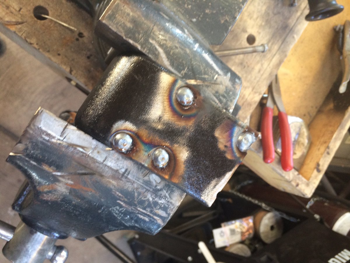

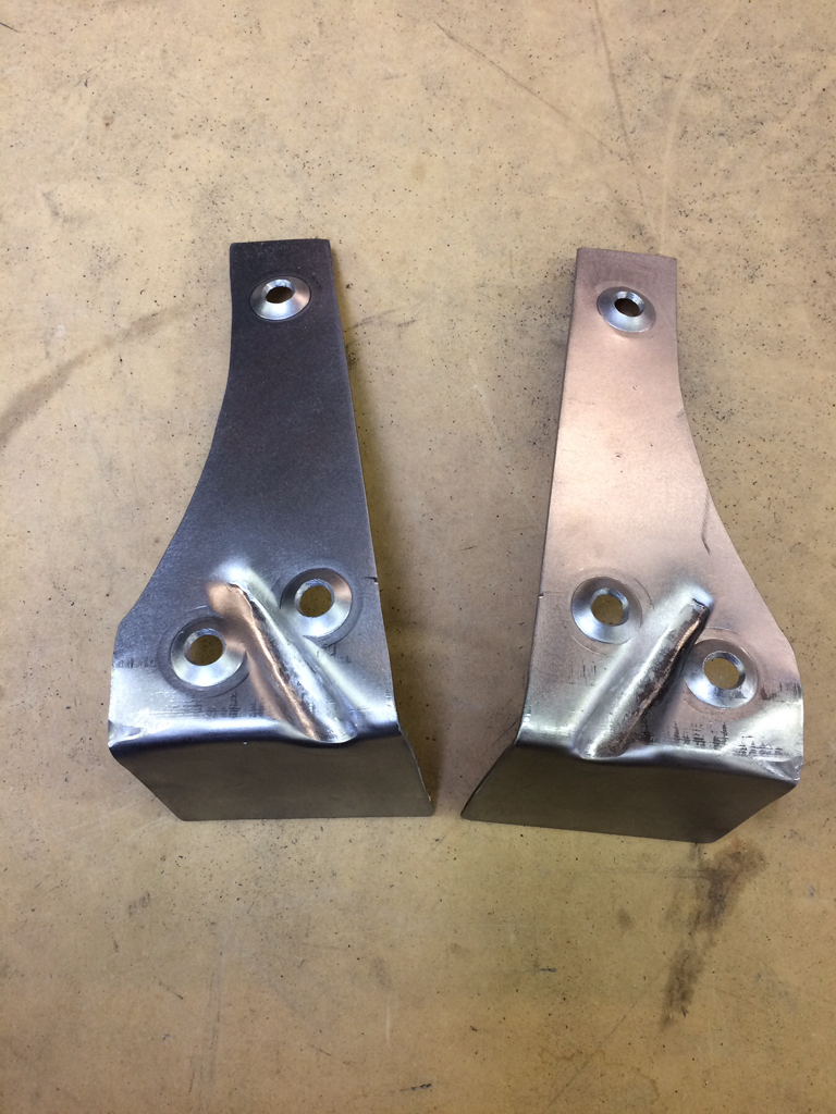

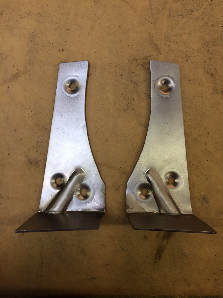

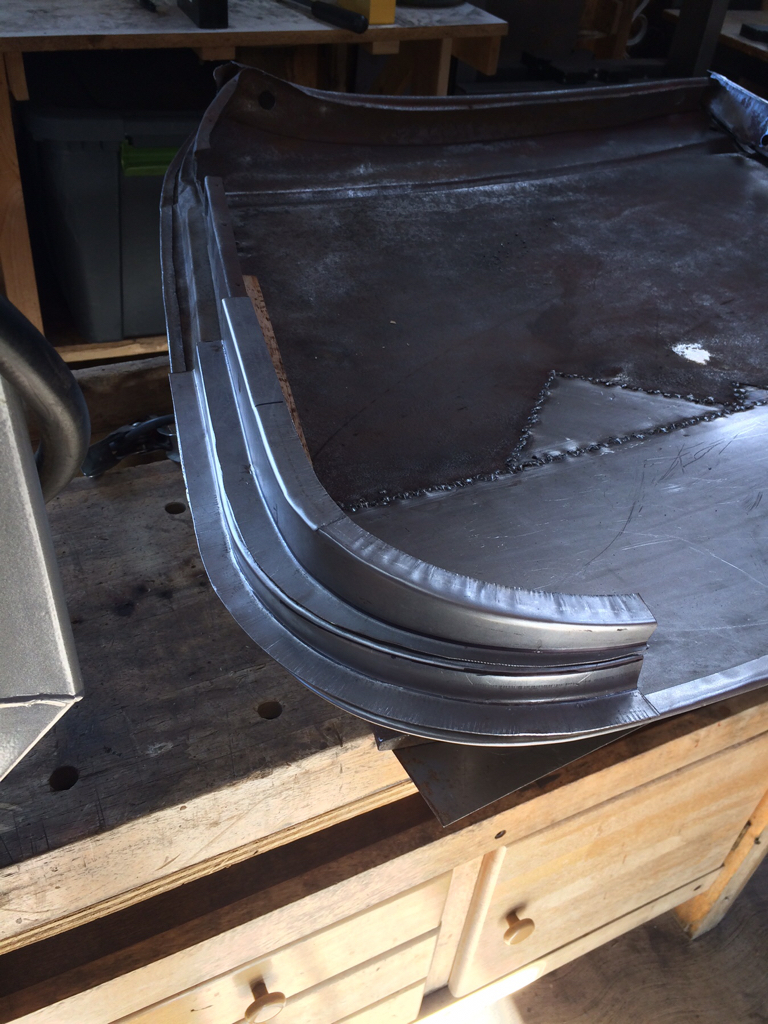

    I had one original A-pillar mounting bracket that I repaired. I made the second one by welding on the gusset, but I never liked it. So after some head scratching on how to make them I came to this.
    I made a die with both left and right positive and negative of the gusset. I first pressed the angle of the bracket then the gusset.
    I used another die to press the three countersink mounting holes

    Wondering about the die in these last pics, was there a female used as well. Someone should be there to just see & record all of this talent. I can’t wait to see this project completed.

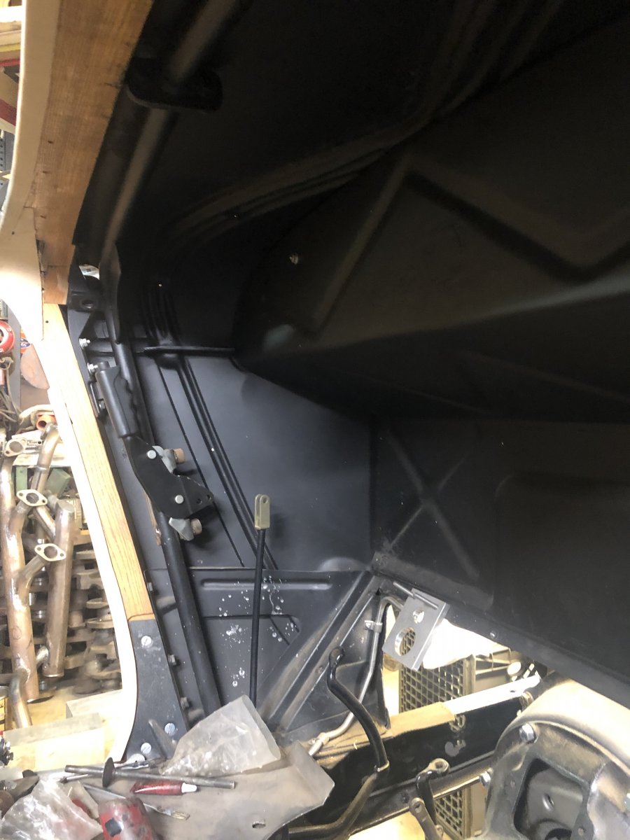

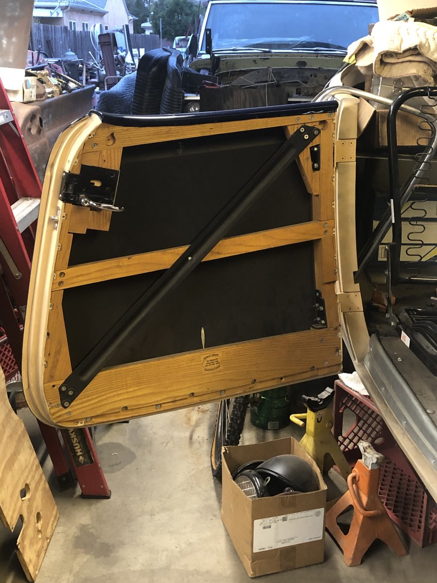

    Did my proof of concept on using 1948-52 ford pickup hinges. They took a little modification. First I flattened the inner hinge half. On the roadster the hinges are on the outside of the b-pillar and door tins, the hinge half’s are flat against each other.
    Before and after
    I then trimmed it to length filled all the holes. Then drilled new holes.
    Dimensionally they are about 1/16 of an inch taller, I polished the difference without issue. The stop on the outer hinge is smaller, this will cause the door to open further. Since it has a check strap anyway, this shouldn’t be an issue. The hinges are steel and about half the cost of the ones available on MACs.
    brEad, Stogy, chryslerfan55 and 3 others like this.

    Posts: 677
    Elvis100
    Thanks, I’m still figuring this all out. There is a positive and negative die, I had to modify it a little so it didn’t crush the gusset

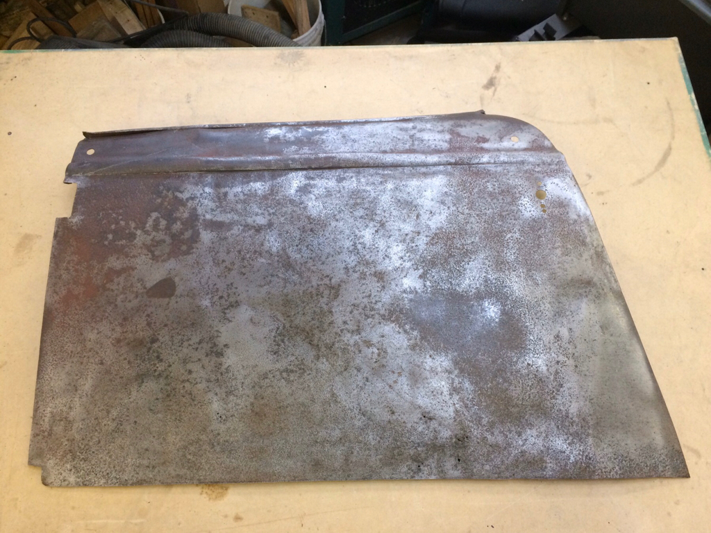

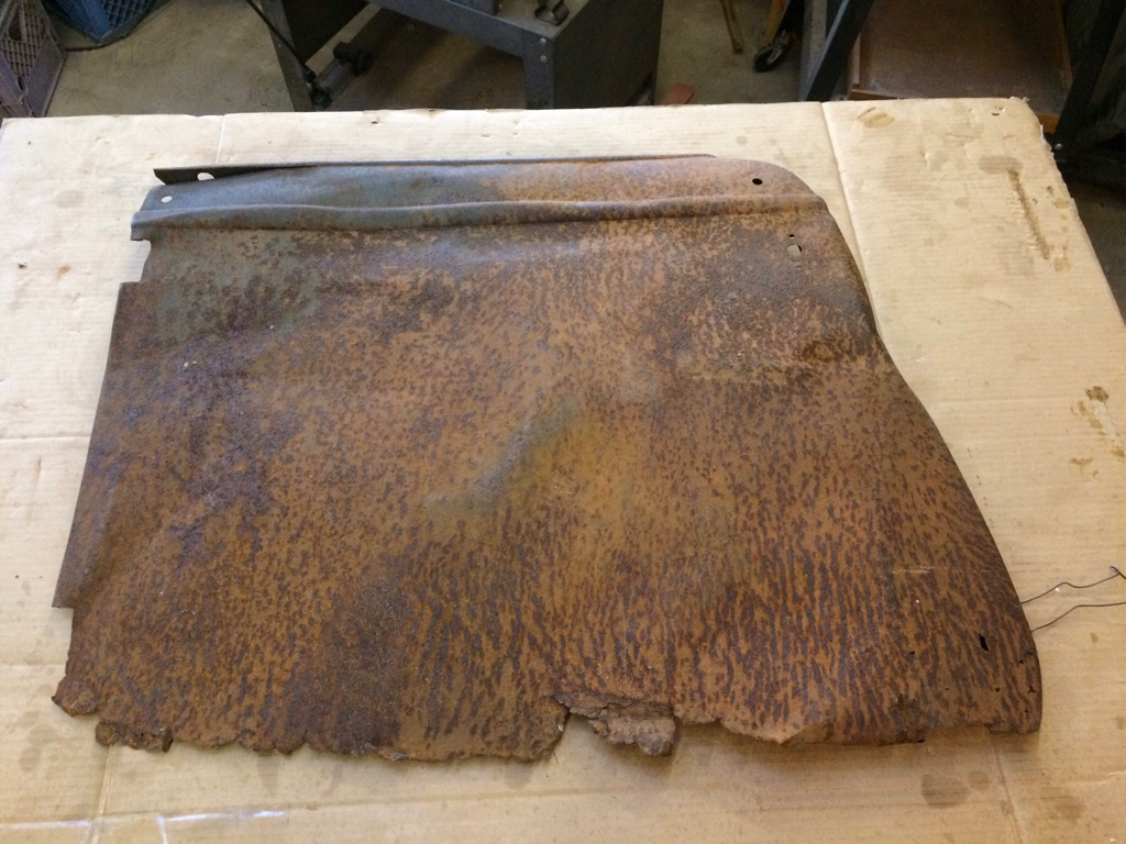

    Took a little time to fabricate a gate for my father
    Got back on the extra project doors. A lot of time banging pushing and still more to go. I started with the worst of the two.
    I used a door patch panel for a three window coupe...roadster are not available
    Still a lot more work, but it is actually in the shape of a door now
