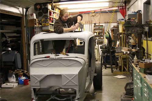

    We got the body back on the frame last night. My dad got the mounts moved and everything primered.
    We spent the rest of the night getting the roof ready for it's fabric.

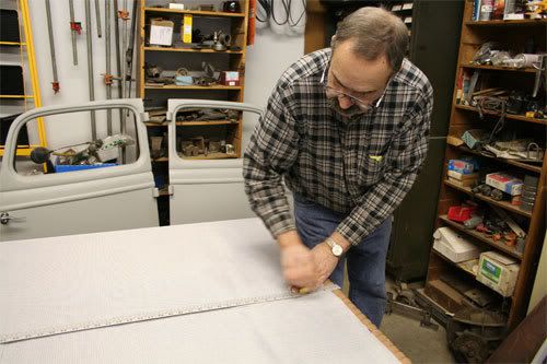

    This is Harry. He owns an upholstery shop here in town and agreed to use his awesome skills on the coupe. First, he checked out our work of gluing down three layers of thick mat where the staples hold. Then he layed out some untreated canvas.

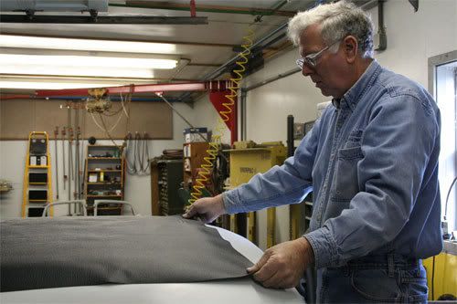

    He stapled the sides first, pulling as he went and left the corners for last. This minimizes puckers.
    He listened to the sound the canvas made when he slapped down on it with his hand. It sounded like a drum. It looked and sounded okay, so he trimmed the excess canvas with a razor, about an eighth inch from the staples.

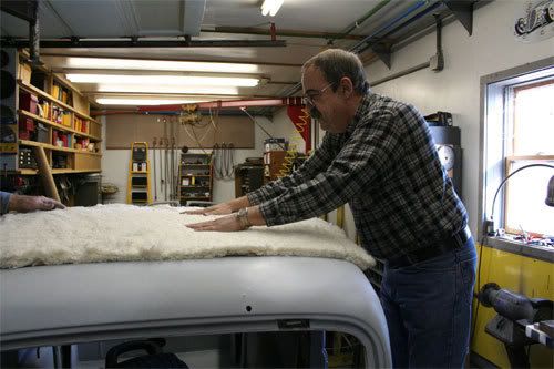

    Then he rolled out some unrefined cotton. He pointed out the seeds to me. This cotton has layers, which he easily pulled apart to get the thickness he wanted. He layed it on top of the canvas and felt the thickness across the whole top with his hand. He found a low spot and added a little more cotton to that area. He was a real master at work.
    Instead of cutting the cotton, which would leave a step in the material, he held one side with a flat hand and pulled to tear the material.
    He worked his way around the car, tearing the cotton to shape. He mentioned that factory cars used this same canvas and cotton and to be weary of upholstery kits that include a cheap foam.

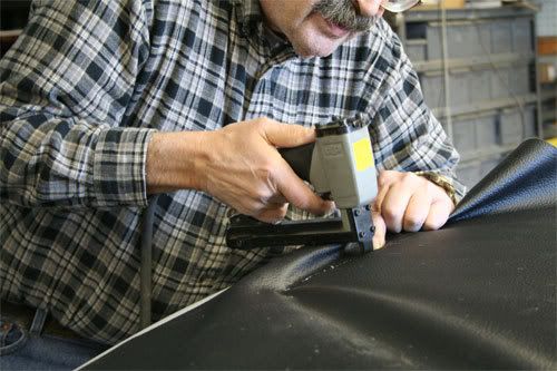

    So, with the cotton all ready, he measured the space for the final black material.
    They layed the black material in place and he began to staple the sides like he did with the canvas.
    This is Mike. He, Harry, Malcolm and my dad swapped car stories.

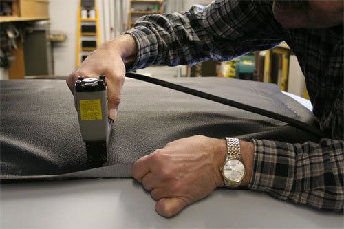

    When Harry was ready to staple the corners, he took out a heat gun to make the material softer and more maliable. Be careful not to heat the material so much that it becomes shiny.

    So, with everything stapled, he was ready to trim the black material, just like he trimmed the canvas.
    He did his final check by looking at it and listening to it.
