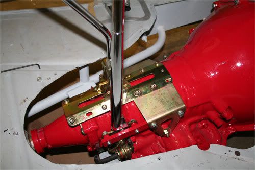

    We got some pieces back from being powder coated so we could ***emble the shifter and emergency brake.
    And then slowly cut out the holes for the interior piece.
    Harry made this shifter/emergency brake boot for us too. It's almost scary how well the whole thing is coming together.

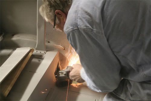

    Then it was time to bring in the big guns. This is Bobby K. He's a professional welder and made quick, nice work of the welding needing to be done on the body pan. Thanks Bobby, you rock.
    My dad did some grinding...
    Then some more work and a little coating, and the underside of the car doesn't look half bad.

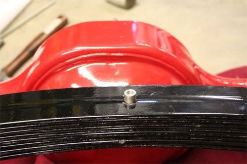

    This last week, we got the rear end housing back from being powder coated at Source One, here in Lincoln. They did a really nice job and it looks spectacular. We got the leaf springs all tightened down and secured. It's scary to see how much pressure those things endure.
    My dad painted the pumpkin to match the rear end housing and we shoved it up in place.
