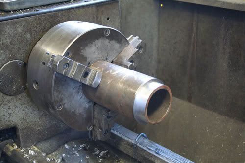

    The rear tires were going to s****e against the leaf spring shackles, so we made a bigger spacer for each tire. He started out on the lathe and created a holder out of a pipe. The band-sawed pieces were mounted and secured, and then the outside diameter was cut down uniformly.
    Then the pipe was taken out, the were pieces secured and the inside diameter was cut down to be uniform and to fit the correct size we needed.
    Here's the final spacer mounted with the rear drum.

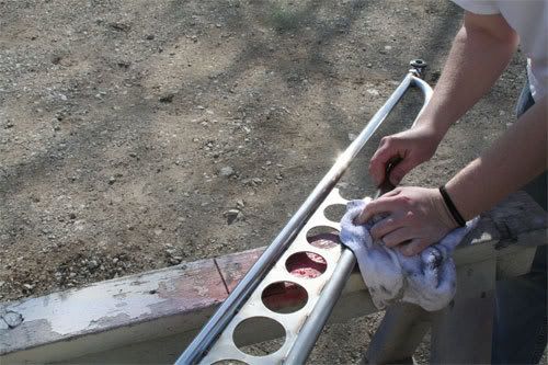

    It was so beautiful outside on Saturday, that it was natural to be out there sanding something. We took 600 grit paper to the radius rods and made them shine.
    My dad set up the buffer and really made them shine....

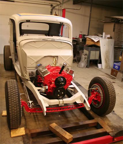

    Last night, we mounted the tires, put the transmission and engine back in place and moved the car to the lift so we could continue to work on the underside without laying on the floor.
    And that's where she stands as of right now. Thanks for checking it out.

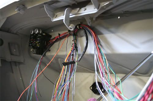

    So inside the car, we attached a fuse panel to the firewall. We also cut a hole in the fire wall for the wires going to the engine area.
    Then we started to identify and separate specific wires that we needed to work with first. In this next photo, we had just identified, re-grouped, cut and put shrink tube around the wires needed for two of the Weather Paks for the gauge panel. The smaller group had just gotten all it's ends added and snapped into the Weather Pak connector.
    This next photo shows the progression of work (bent over looking into the firewall from the front seat - ouch.) He did quite a bit of work regrouping the wires which had come from Painless wire tied together. Some wires needed to be rerouted and organized, so he clipped the Painless ties, regrouped and re-tied. A lot.
    The two single paks laying to the upper right of the fuse panel are for the future tach and possible accessories. These paks will keep them prepared and protected for us until we can use them one day.
    The shrinked group closest to us is for the ignition switch. The other two are gauge lights and gauge power wire groups. At this very moment, Tim was preparing the wires for the head light switch.
    Then he measured how much wire we would need to reach the firewall hole and cut the wires leading to the engine area.
    The two looooong shrink wrapped groups on either side of the freshly cut wires are will go to the back of the car. One group will lead to the battery, one will go to the taillights.
    Just wrapping the engine wires totally shows the difference in clutter.
