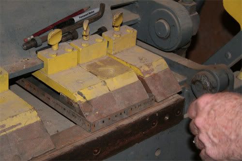

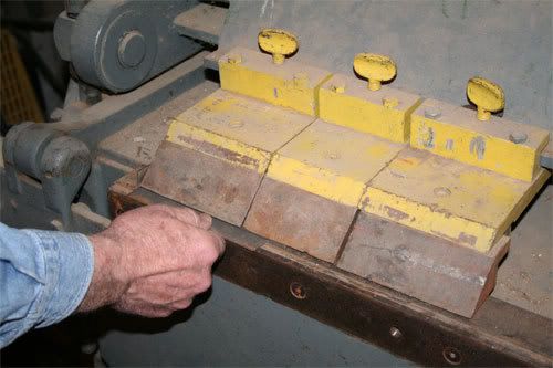

    The battery boxes we've come across so far seem too bulky, so my dad opted to just make one. He started with a steel sheet and cut notches into it.
    Then on the trusty Break, he bent the metal sheet where he had marked it.
    It gets a little tricky towards the end, but if you slow down and think about the process, it'll come out alright... the second or third time.

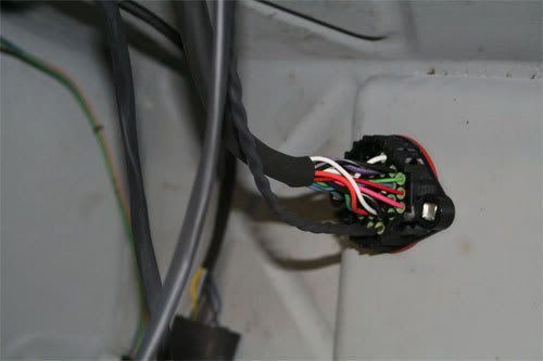

    So Tim finished up the wiring that will live on the outside of the firewall. Headlights, grounds, alternator, horn, etc.
    This is the connector that hooks to the connector on the inside of the firewall. Notice the different wire ends... this is the female side. The other connector will clip into this one, so there will be contact with the male ends.

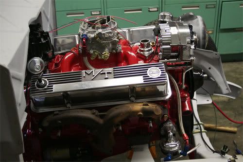

    Here's a good shot of the engine as it was progressing. Fills out a bit, doesn't it? I've gotten so used to seeing the plain red block holding it's place on the frame. Getting close... goosebumps.
    This shows the new fuel lines coming up from the fuel pump to the carburetor. The PVC tube and vacuum advance tubes were installed. And the new spark plugs, with which I learned to properly set spark plug gaps. And... I got to practice eight times.
