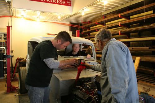

    Now the exciting milestone... Malcolm poured transmission fluid into the transmission:

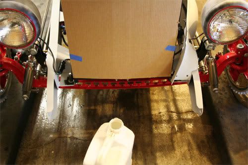

    My Dad poured water into the radiator. Uh, a good idea if you're not completely sure that the radiator doesn't leak, or that the water pump isn't leaking out of it's gasket... or say, Jess didn't check to make sure that the big gaping threaded hole in the block didn't have a threaded plug in it.... Needless to say, water cleans right up. Anti-freeze does not.
    So, water in the radiator? Check. Transmission fluid? Check. Oil? Check. Gas? Check. Battery on? Check. Giddy girl in the driver's seat? Check and check. Turn the key and... vroom, vroom baby. Wicked awesome.
    Malcolm continued to add transmission fluid and I sat in the driver's seat, gleaming that I no longer had to make the engine noises myself.
