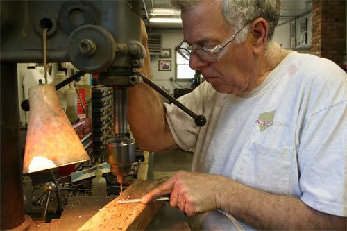

    My dad did the bending of the railing:
    Once the bend was sufficient, he measured and marked locations on the rail for evenly spaced holes.
    Then drilled them:
    Once we had a few holes drilled in the body and a couple screws holding the railing piece down, I drilled the rest of the holes into the body, using the rail as a guide. Then pushed stainless steel screws down into place and loosely tightened the nuts. In all, it took three sections of railing to complete.

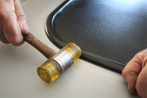

    May 1st was another beautiful day. We pushed the coupe back outside to finish the roof. The objective this evening was to install the rubber/plastic finishing strip onto the metal railing we installed the night before. Our only objective, because we simply didn't know how much struggling this strip would require. We started in the middle of the back of the roof top. A little heat help us make the first curve, but we were super cautious.
    After some trial and error, we figured out it was easier to get the plastic piece to start by pushing it in from the side...
    ...then pushing it in from the top. A few nuts had to be loosened from underneath to allow the strip to grasp the metal railing and look level.
    We kept working our way around until we met up with where we started. Warning me that this stuff is notorious for shrinking in the sun, my dad cut the end a little long and pushed it into place. Gorgeous.

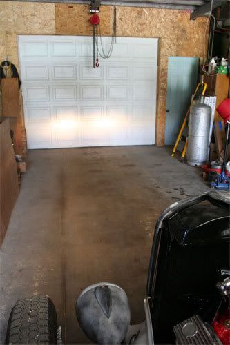

    Friday night was filled with finishing the smaller details like filling the tires to the correct psi, fixing the dzuses and attaching the moons, adjusting the headlights....
    After dark on Friday night, my dad pushed my mom into the p***enger seat and off we went down the driveway. I was so giddy. On Saturday I sanded the grille's shell while my dad did some metal work on a new ignition switch area in the dash. Tim came over and we worked on the hood a bit. Sunday, Bill and I ventured down the driveway in the coupe, this time we went to the corner of the section and back.
