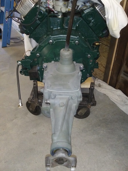

    I have yet another quandary id like some input on.... i have the 303, flywheel, clutch etc, i have an olds to flathead adapter plate and a 37 ford 3 speed floor shift trans...one option is get a ford 3 speed to driveline adapter and run that however i feel like the weak link is the 37 flatty 3 speed. So...advice? Ditch the 3 speed and go another route? Bendtsens bell? Has to be mid 50s period correct...also to run the ford 3 speed i think i have to buy a model A truck clutch i think? I have an olds clutch at the moment....the pitfalls of running an olds with a manual...
  18. You will tear that 37 tranny apart the first time you launch that 33. Drive like an old lady and it will most likely last quite a while. You might consider a Lasalle, Packard or a Buick that has a Olds gear conversion. All those choices are $$$ but a safer bet. Here is a Buick on my 324.
  19. 41rodderz
    Joined: Sep 27, 2010
    Posts: 6,540
    41rodderz
    from Oregon
    Another way maybe an Olds using a GM transmission . If you want to stick to the fifties there should be a few 3 speed transmissions out of cars or trucks . Or move your sights to include the 1960’s offerings in 3 and 4 speed transmissions . Rock a Muncie :)

    I dont mind saving and spending to make it right, drive train needs to be right... what year Buick is yours out of? Was it already set up for floor shift?

    Yeah that may be the route i end up going, really depends on what i can find. Theres a floor shift lasalle locally but its like 1600 bucks! Thats almost double what i have into the car...im down to spend money but i cant spend that much! I REALLY want it to stay mid 50s but in the end id rather have it on the road than not so it may be out of my hands
  22. Oliver, when I began my build 10 years ago I was all about staying with a 50's style. Picked up a 37 Lasalle and all the parts to make it work. Over the next few years during the rebuild of the Lasalle it became clear that parts were getting really scarce and expensive. Midstream I switched over to the Buick Century 6 bolt top cover tranny, converted it to use a 57 Olds gear gut and tail stock, changed out the bell housing to a 51+ piece which are readily available and never looked back. @Paul and @F&J both use the same set up and have been happy with it's performance. The 6 bolt century box is getting hard to find but they are out there. Donor Olds trannies are easier to find.
    Or as mentioned above there is the GM conversion using a Muncie etc. Shifter location will most likely not be in the same forward spot as a vintage tranny. Another thing to think about.

    Yeah ive been doing used tranny searches and thinking long and hard about this...if i do go gm, i saw a contraption a fella made to move the shifter forward. Thats nkt my fiest choice though. I think i will be hitting swap meets, get a list of trans together to hunt for and search as i do metal work

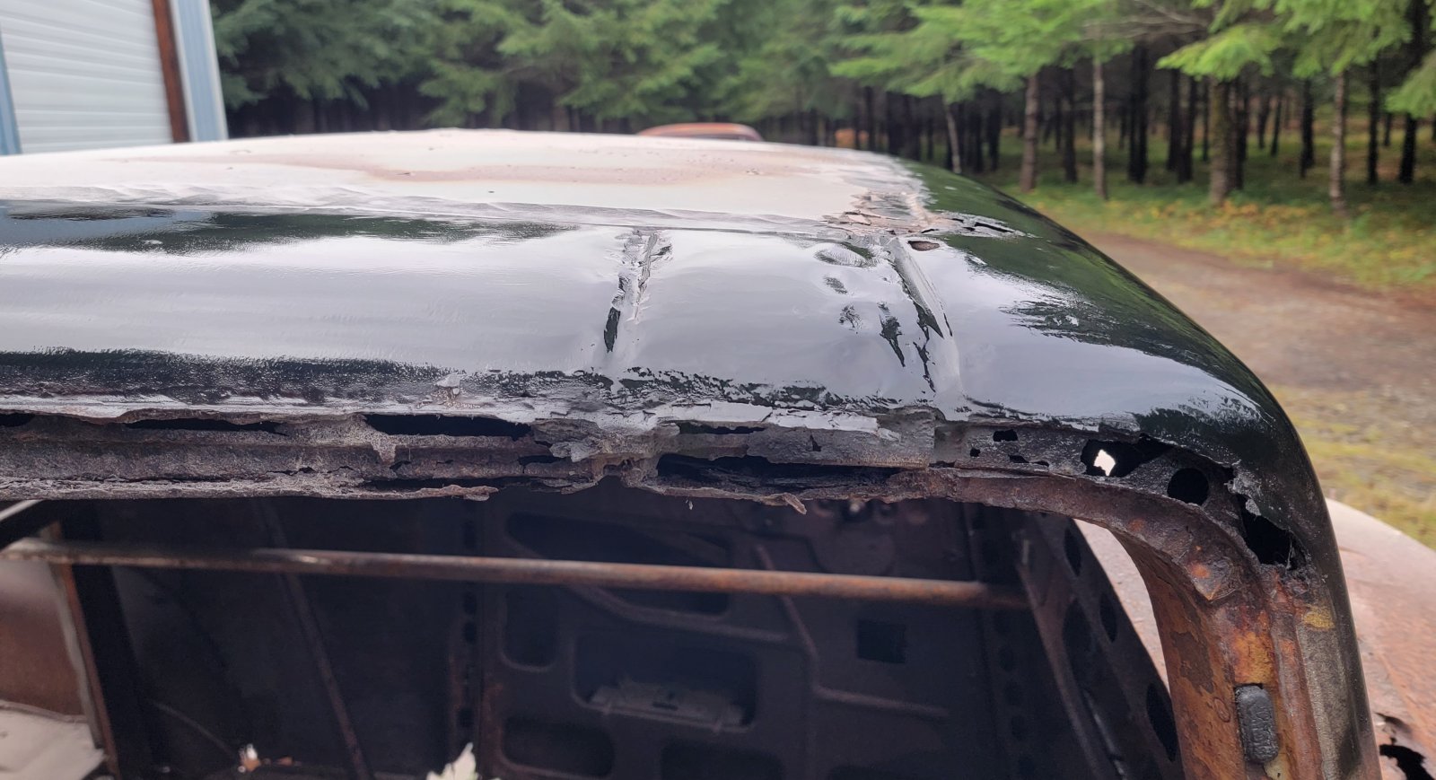

    What a hatchet job.....mustve been 50 gallons of bondo for the price of 1 day 20211118_132713.jpg
