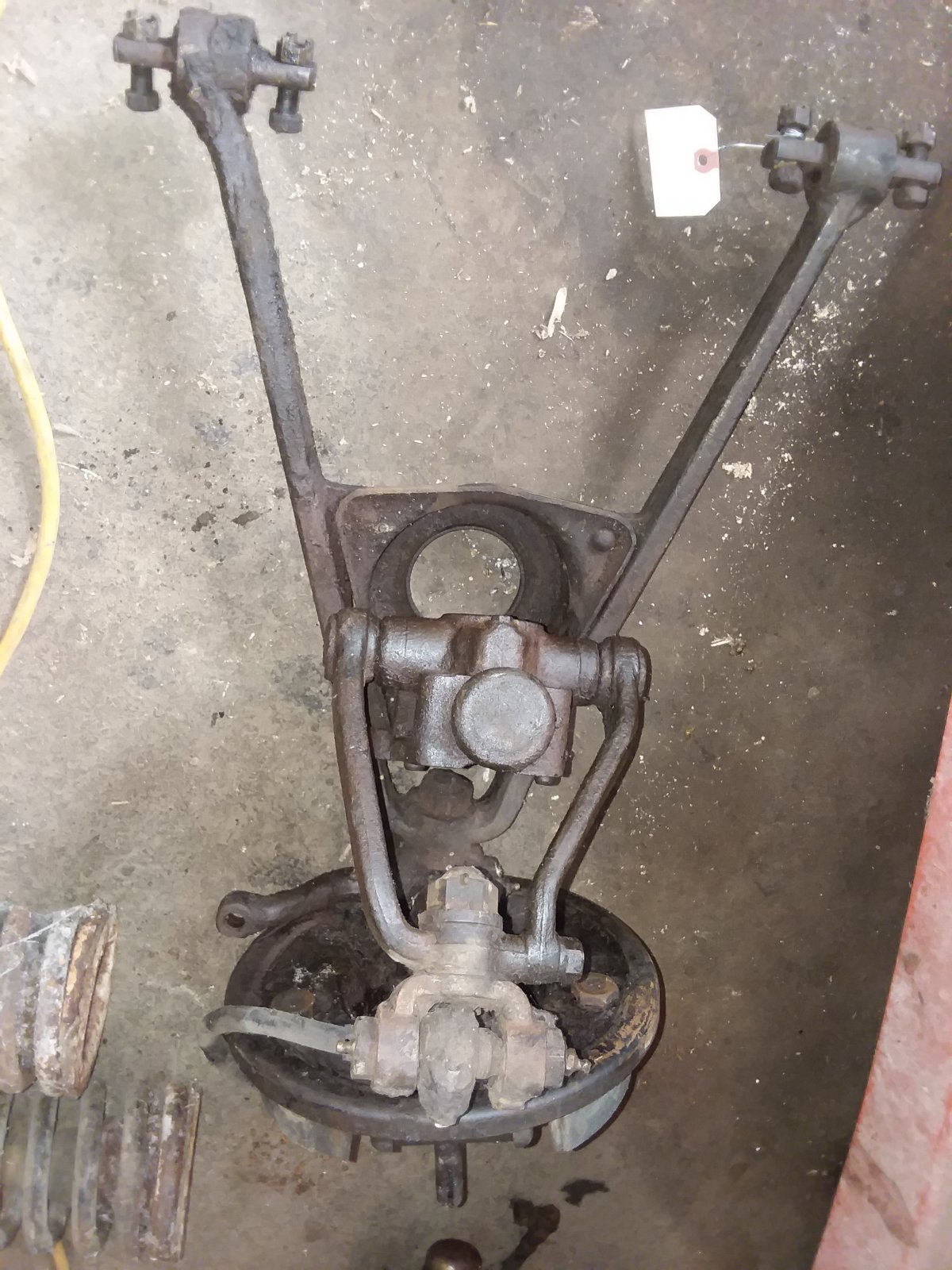

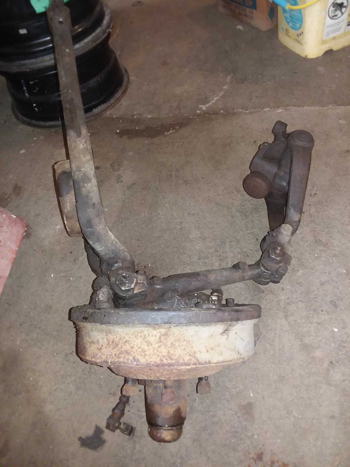

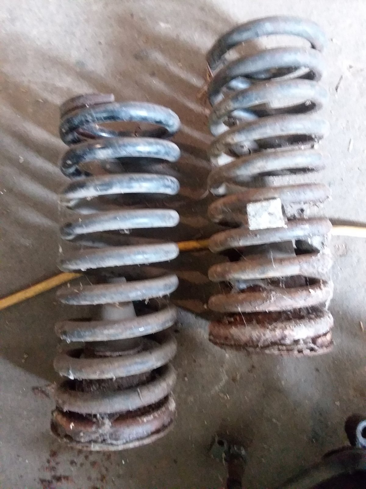

    pics of 34 ind frt suspension 20170727_103318.jpg 20170727_103336.jpg 20170727_103258.jpg

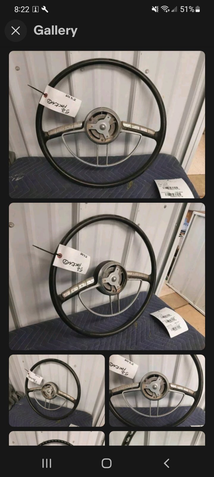

    Well today i decided on the steering wheel im gonna run. Been thinking long and hard about it and since i cant afford a 53 olds wheel.....this one spoke to me! Itll look sweeeeet in there. Its ordered and will be here soon!
